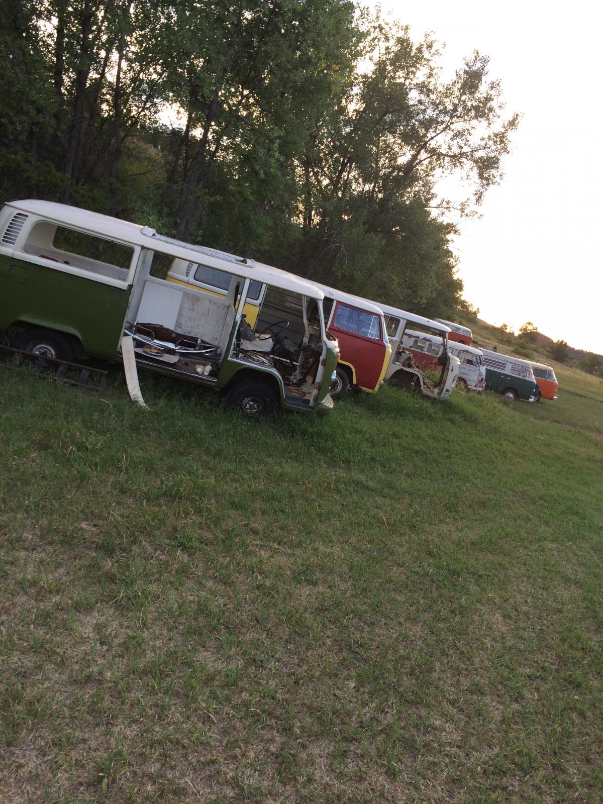

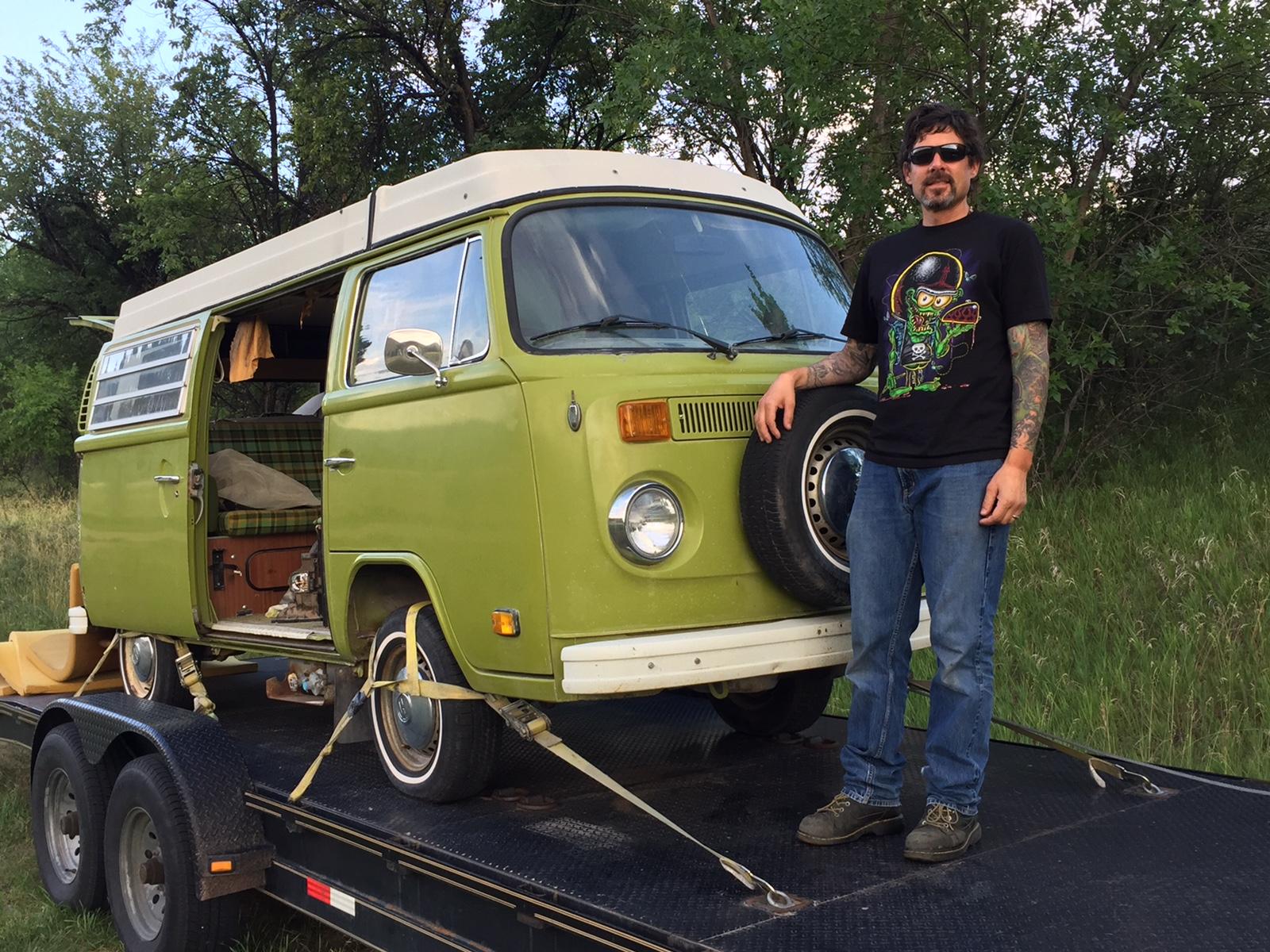

A few days later we head to Kevins and look at the buses at his house. Theres 3 or 4. I remember a white tin top westy with blue plaid, was neat but spoken for. A few others. Remember, I just met Kevin and were having our first conversations here. He says he has more at a stash by his Dads so we head over there. I really wasn't prepared for what I saw. There was a line of buses. I couldn't believe my eyes. What the heck dude! He's like yeah I find buses and sell parts and fix what I can etc.
Im thinking that all these buses are really too far gone for me, but that one on your trailer isn't.
He says ah man, I just got that one a few days ago. I said, well sell it to me and don't even get it off the trailer here and drop it off at my house. He informed me it had a blown motor and has sat since 95 or so and do you know what your getting into, etc. I've rebuild old Harleys and and pretty versed in antiques in general and how to care for old stuff and feel i could take this on. I don't think he really wanted to move it so fast. He said it was the nicest one he found all year and wasn't sure what to price it etc. We spoke at length that night well past dark and ended with a handshake. She was coming home!
Now were starting to get real busy working the Rally, setting up and all is a killer. Im adding this all during the busiest time to my year, and I don't care. We focus on getting the details arranged and in the meantime I take Cat and kids to check it out. Am I crazy and or stupid I ask. Cat says no, Ill help you. The coolest thing she could have ever said. These are pictures of that day. It sprinkled and there was even a Rainbow. Was a great omen and Blessing!!!

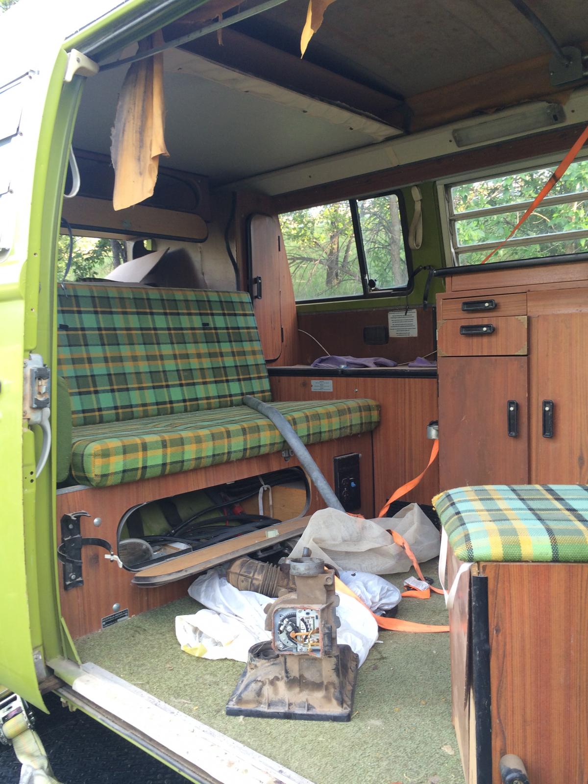

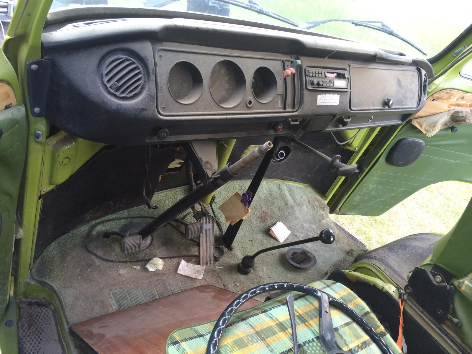

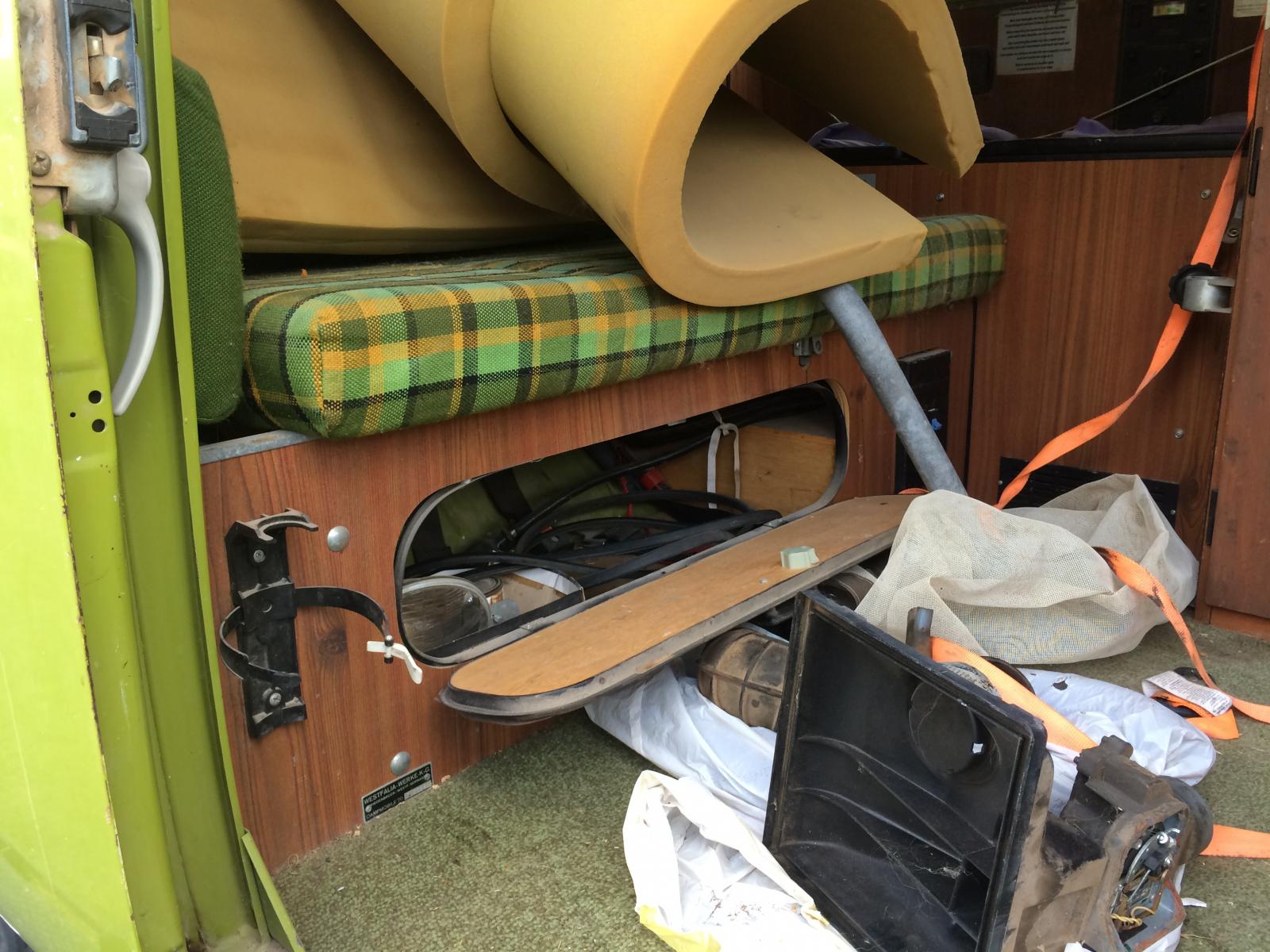

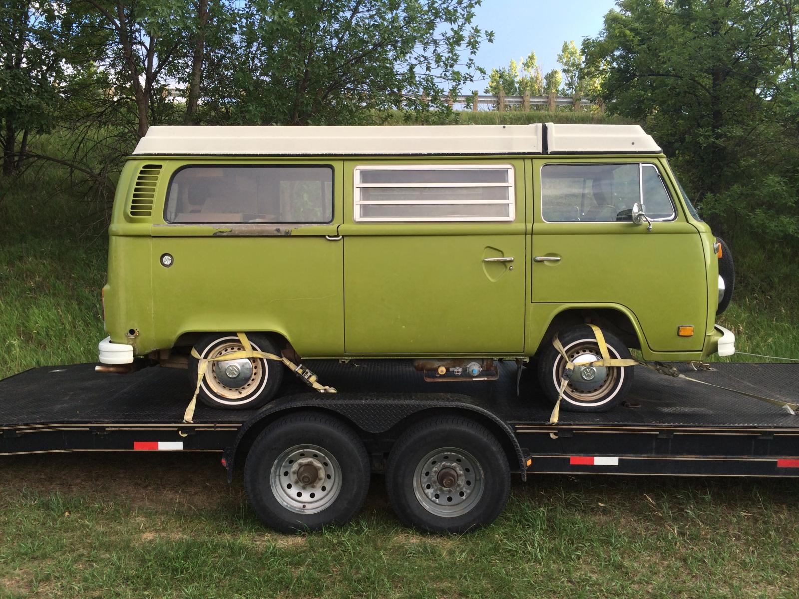

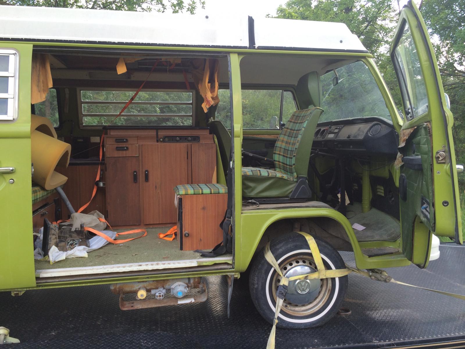

As you can see from the photos, theres a solid bus here, but still has a lot of dirt, rot and repair needed. Don't forget, a seised motor Crying or Very sad
The interior is pretty shot, steering column disassembled, motor in sad shape, but there is almost zero rust and pretty solid OG paint. From what I can see, not the worst, not the best. Motors can be repaired and interior worked, but I'm not too interested in doing metal and paint so I think this is a great platform and worth stepping up for.

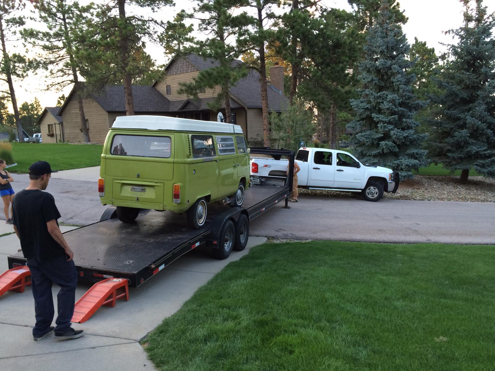

A few days later Kev delivers the bus and we get it backed in the garage. Some of my neighbors walk over with concern saying who's got that green van we saw go by? I do! OH where is it? In my garage, Id never leave it outside, its outside days are over. Several come by to look and make faces like they ate something sour and were pretending it wasn't. Okaaaay they said 'good luck' with that you guys....

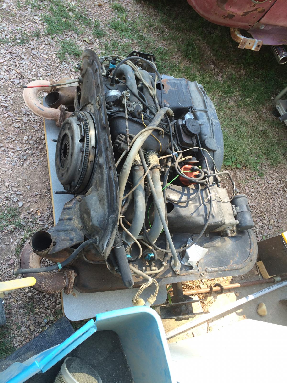

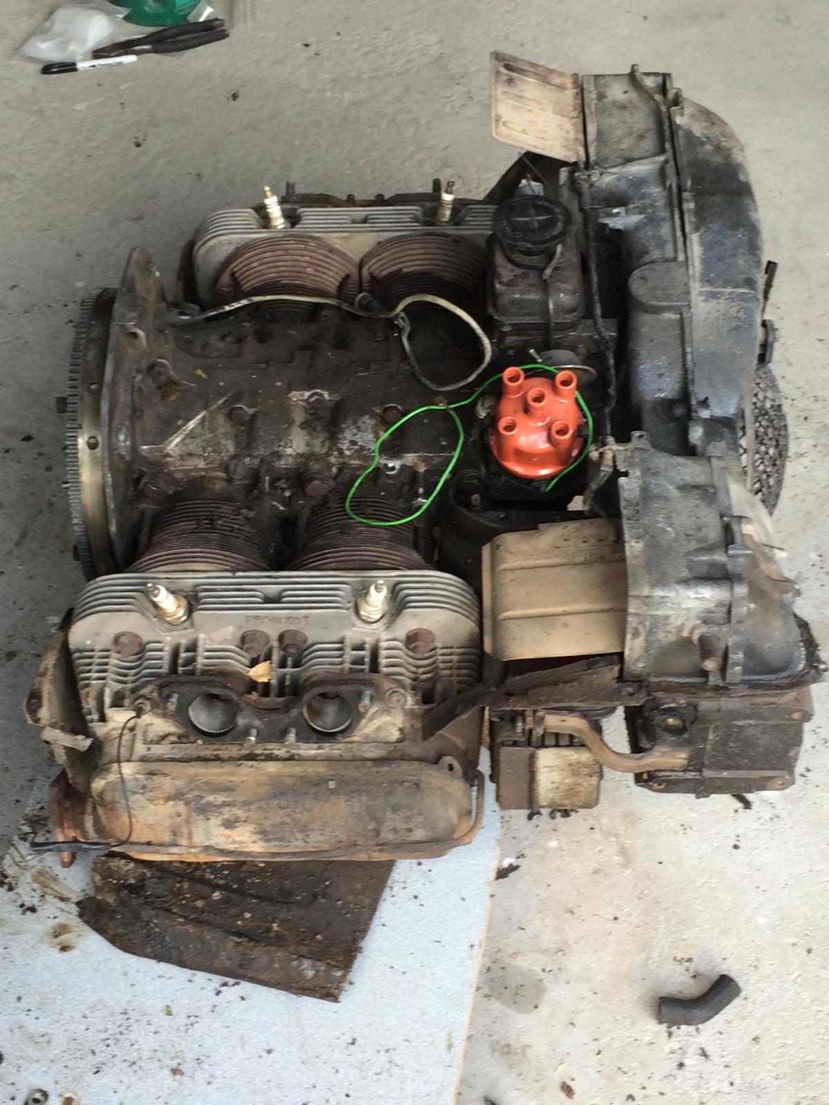

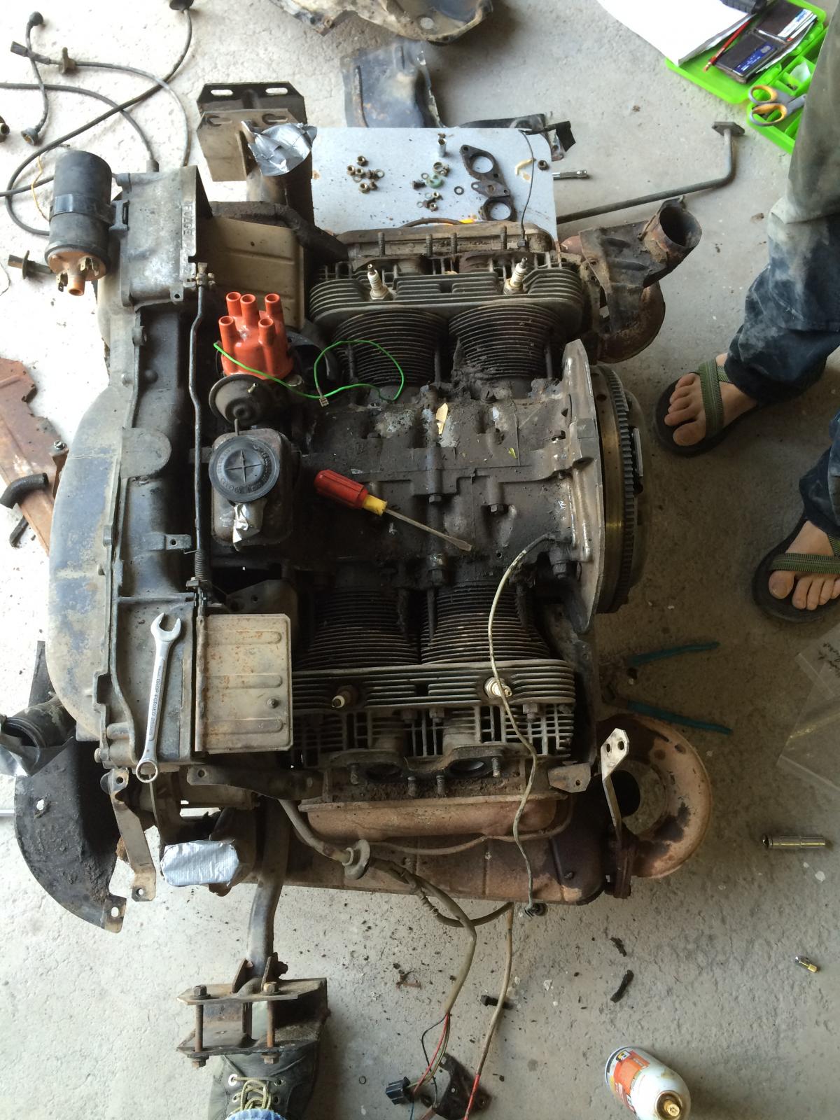

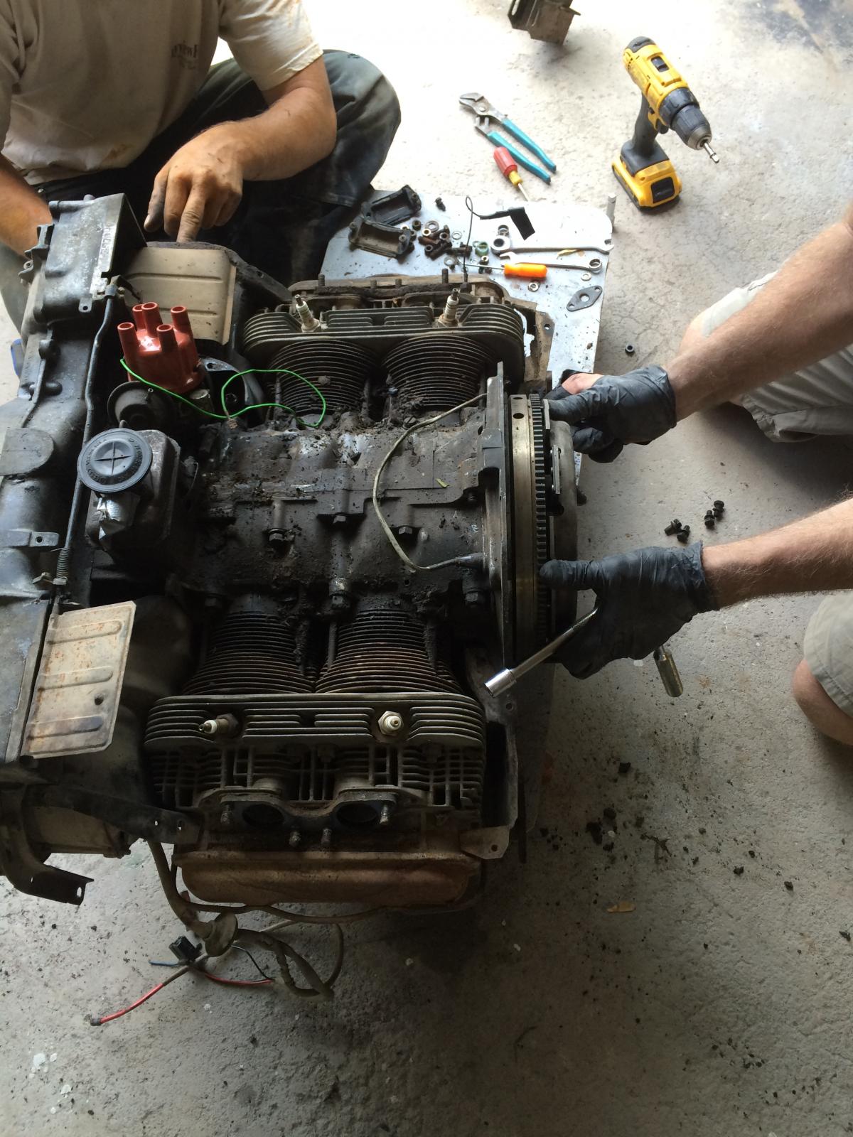

Like I mentioned before, the motor was seised and won't turn. The story was the last previous owner ran the motor dry on oil until she stopped. You'd love to hear Kevin rail on how theres no excuse for that!! Pull over and put anything into her before that happens and plenty of room in a Westy for an extra qt. he was heard saying a few times. Oh well I say. This bus shows 31k miles and if those are original all the better for me she broke as that put her in a time capsule.
Kevin had already been in contact with his pal Brian about reworking the motor before I came into the picture and there was a little chatter about what they thought and asked what my thoughts were going to be on the subject. As much as a motor sounds like important talk, I'm pretty much only thinking about the paperwork at the DMV and the fees and taxes and getting all that behind me.
I will say though right here that from the very onset of this project it was to be a stock-ish rebuild. I wanted to stay original as possible within reason as well as listening to advice from others who have come before me.

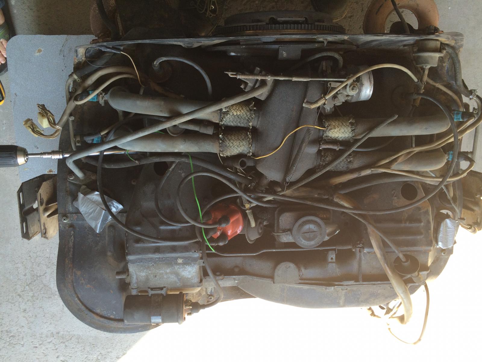

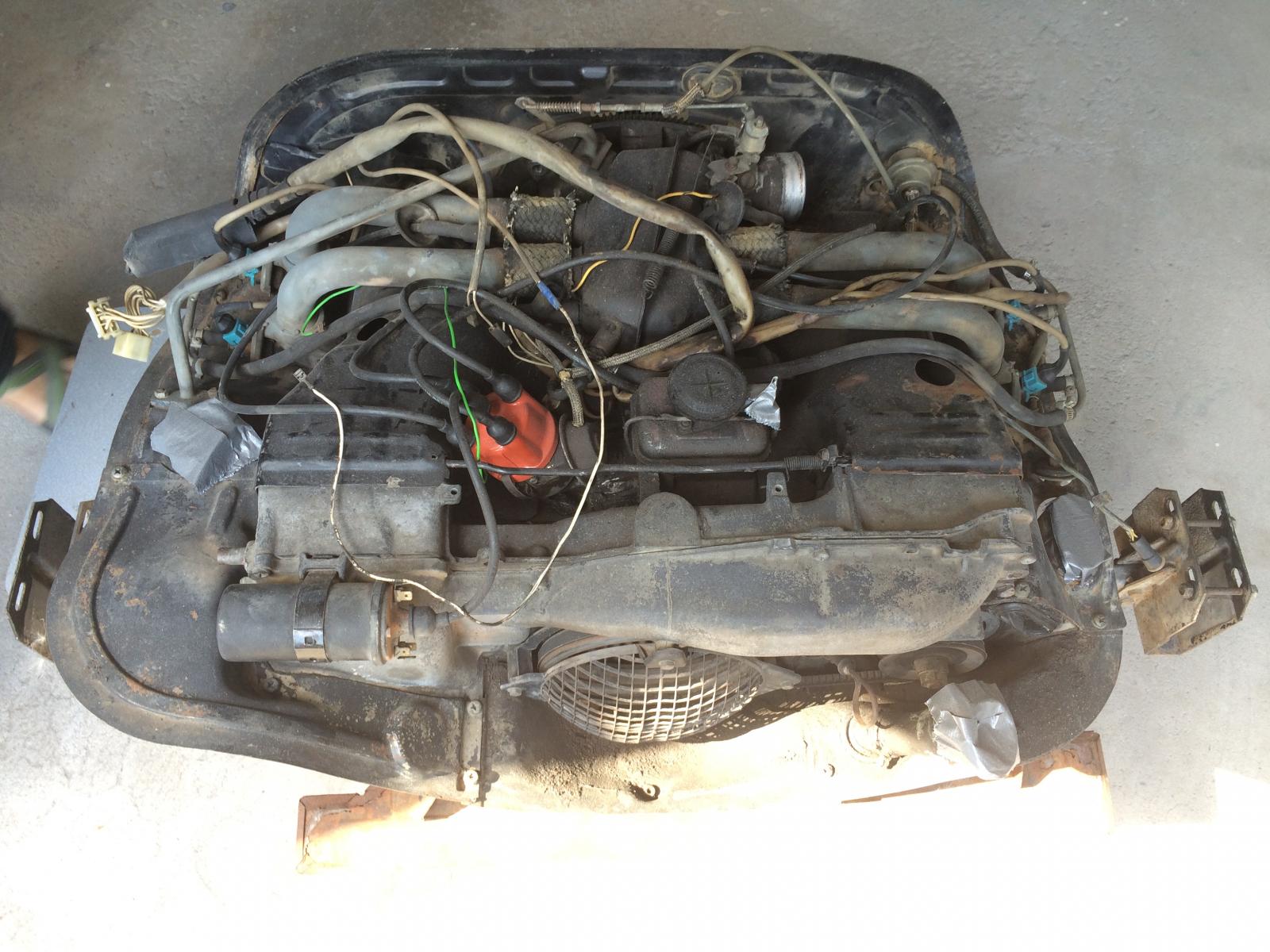

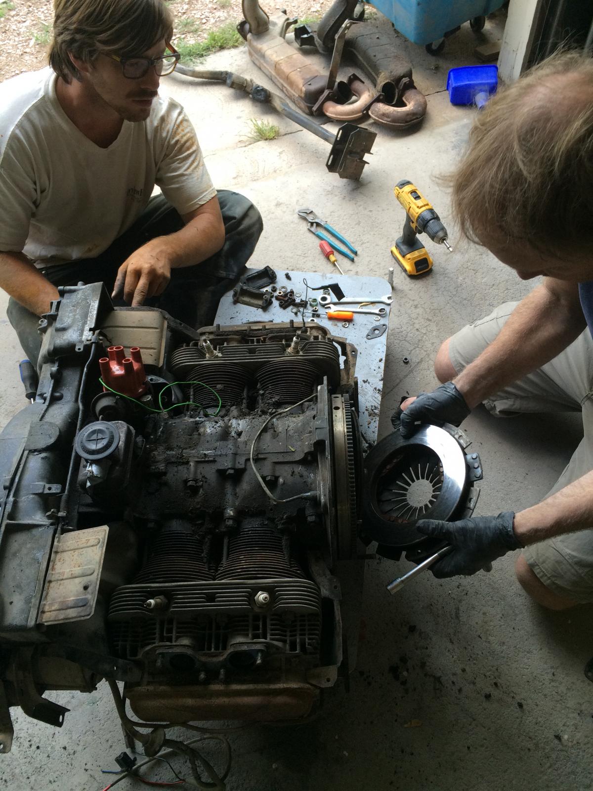

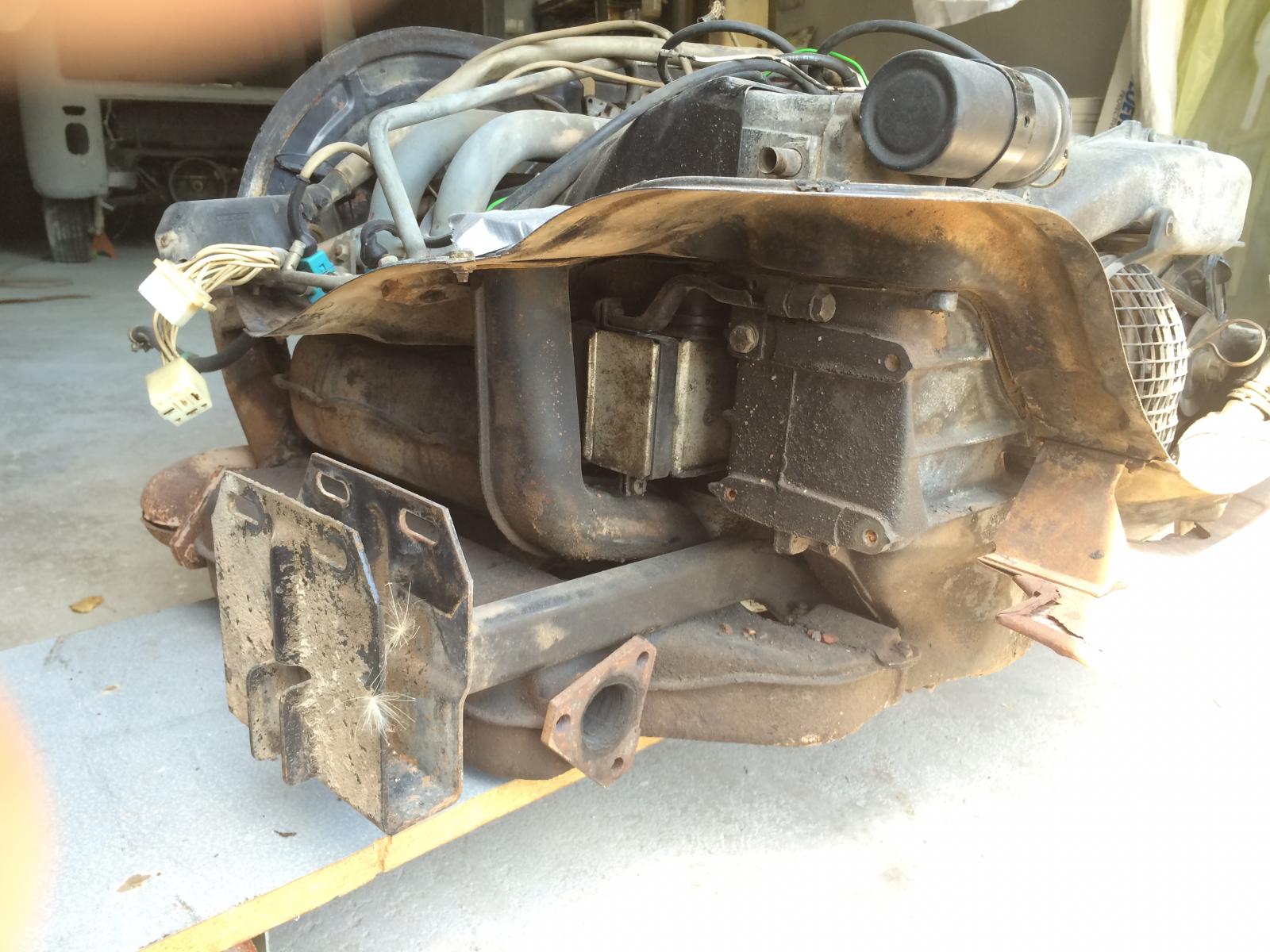

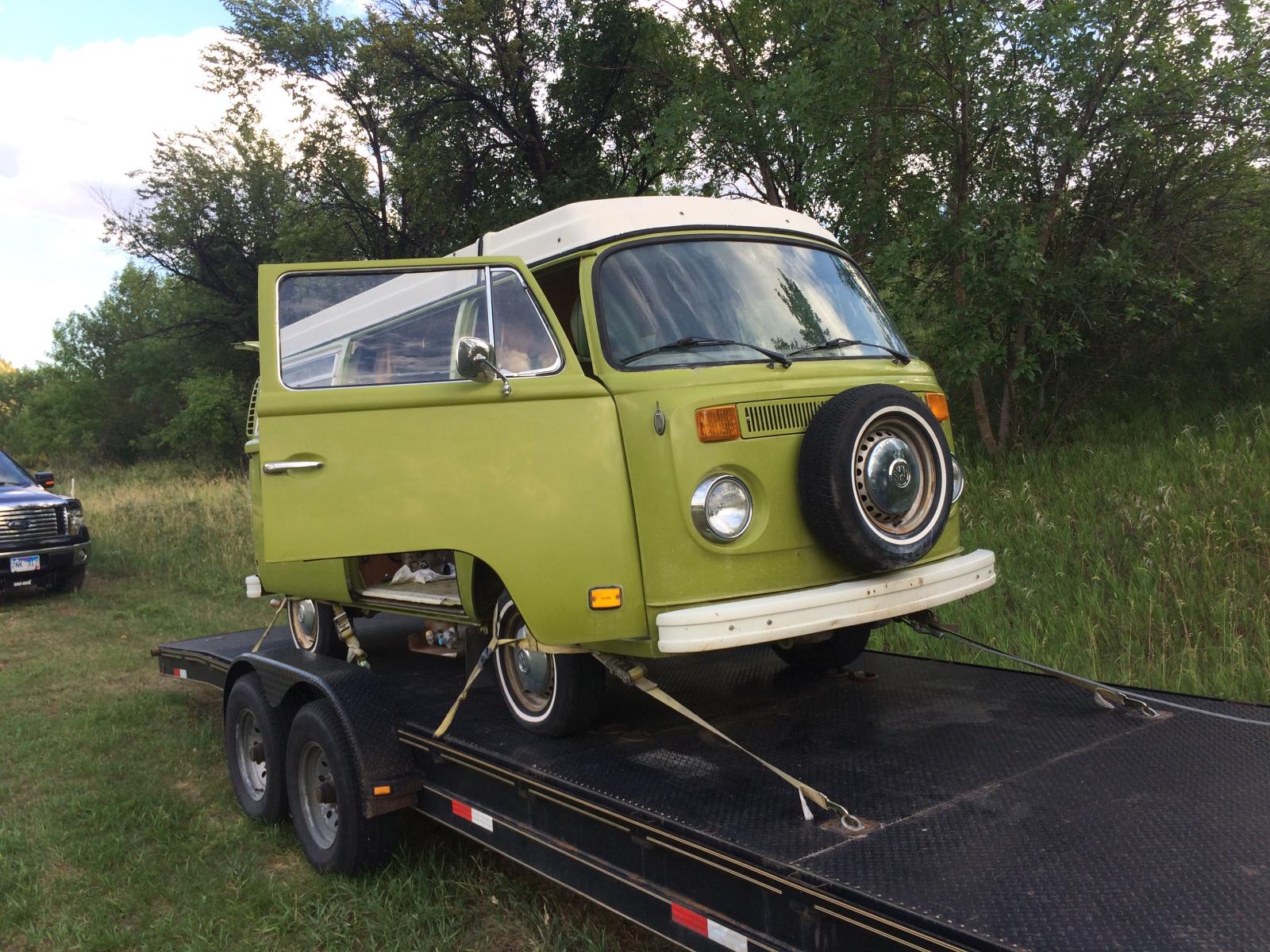

Kevin suggested we go ahead and pull the motor while its still on his trailer and he can back his truck right up to it and load it easier. Better than dropping it in my garage on the floor without the proper jacks. I hate to say I was a little uncomfortable with that as I sure would have liked to see it come out, but being slammed at work I just couldn't make it. I resigned to just trust in my new friend and the situation. This pic Kevin sent when he was removing the motor.

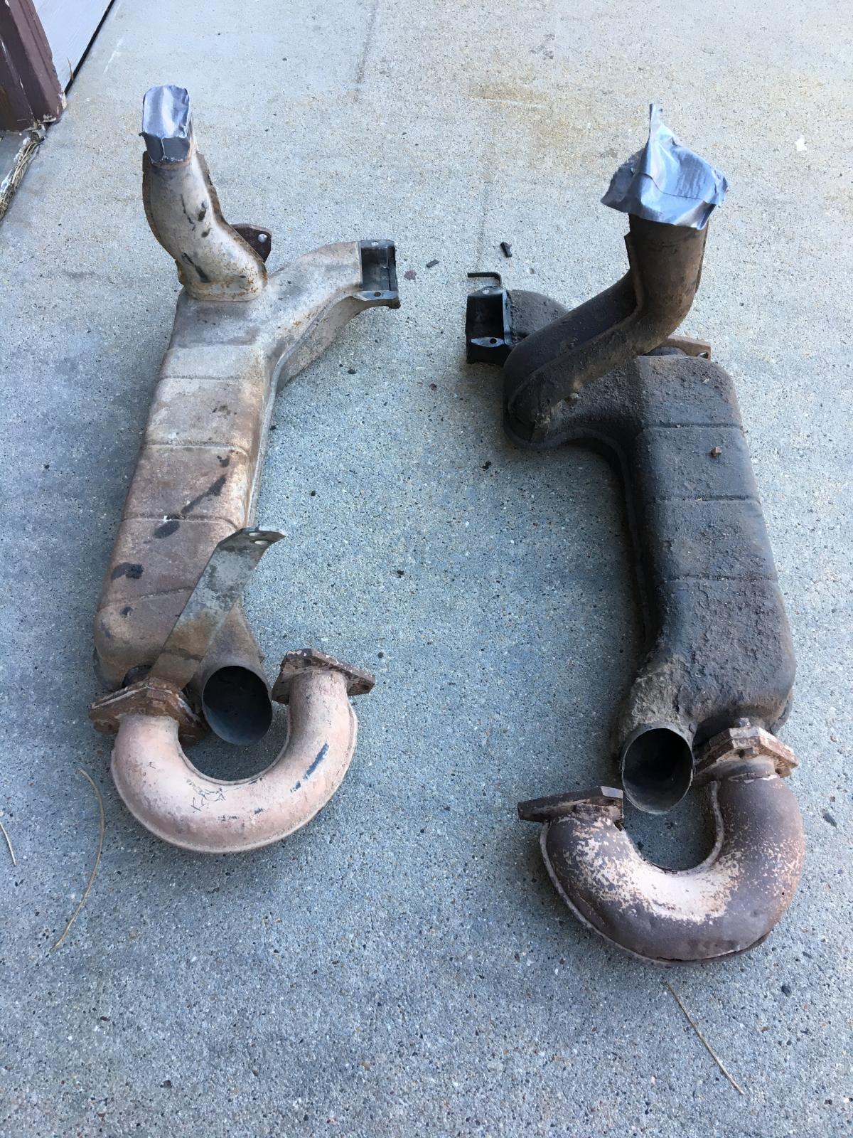

Pretty crusty, huh. The motor went to his place where we plan on stripping it there as Brian only wants the core.

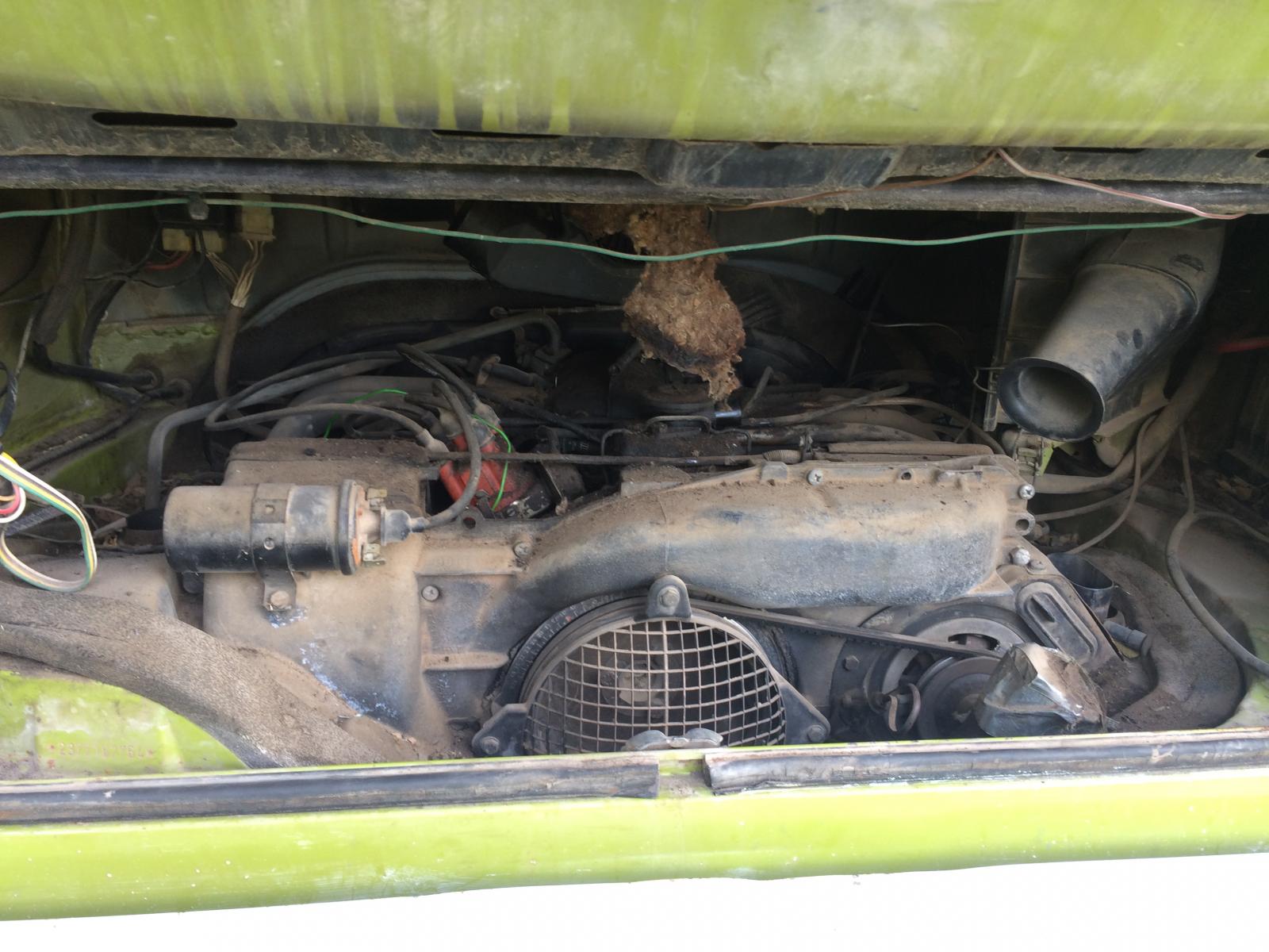

You know, when I was younger my 69 had a type 1 motor and with the problems I was fiddling with I thought it to be a inferior motor to what we called a 'flat' motor at the time. The guys with those seemed to be going home more predictably and I had some sort of envy of those bus motors at the time. I felt stuck with my choices though and powering through them, but little did I know then what I've learned about the type 4 and how tough its going to be to service.

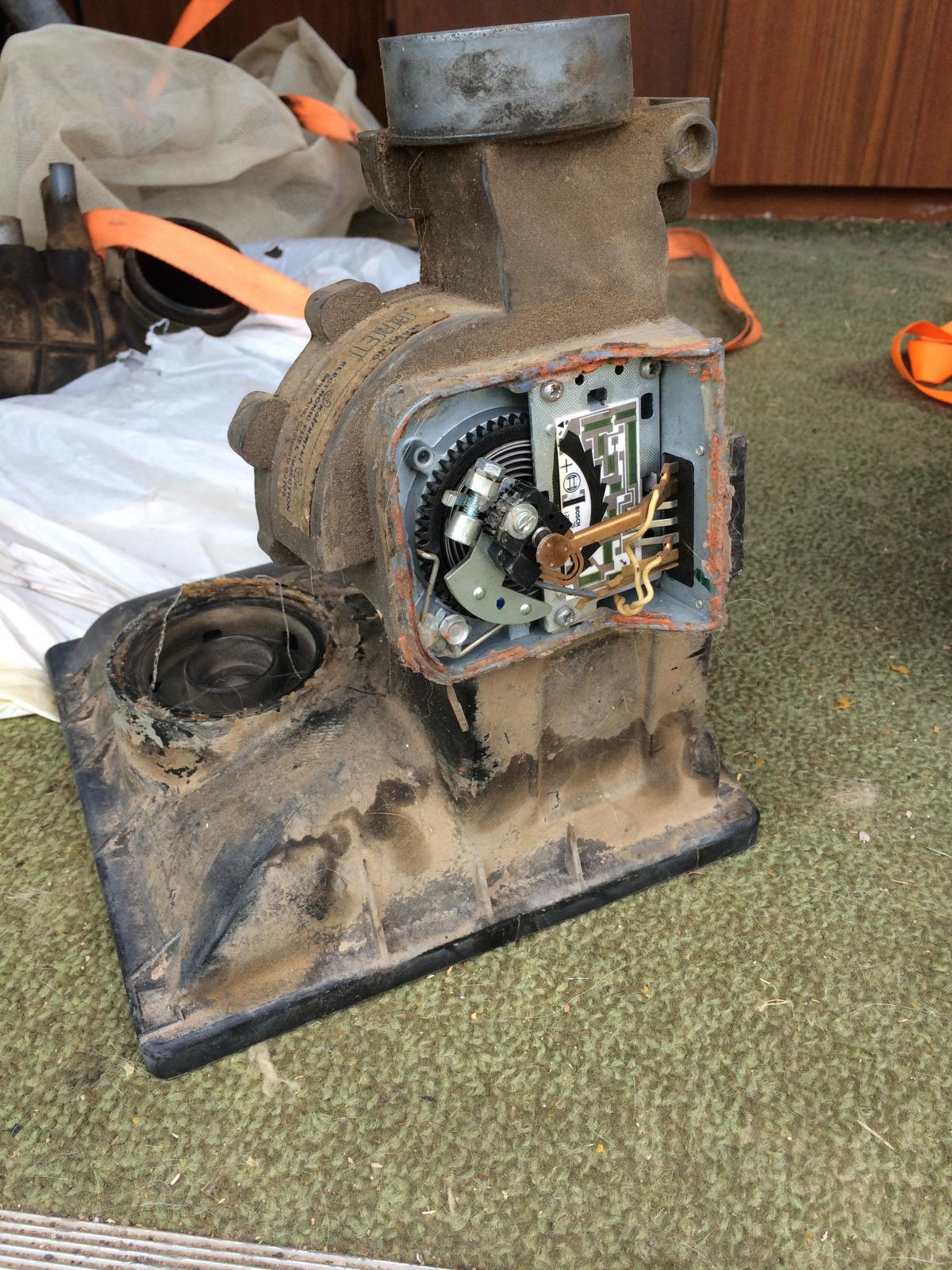

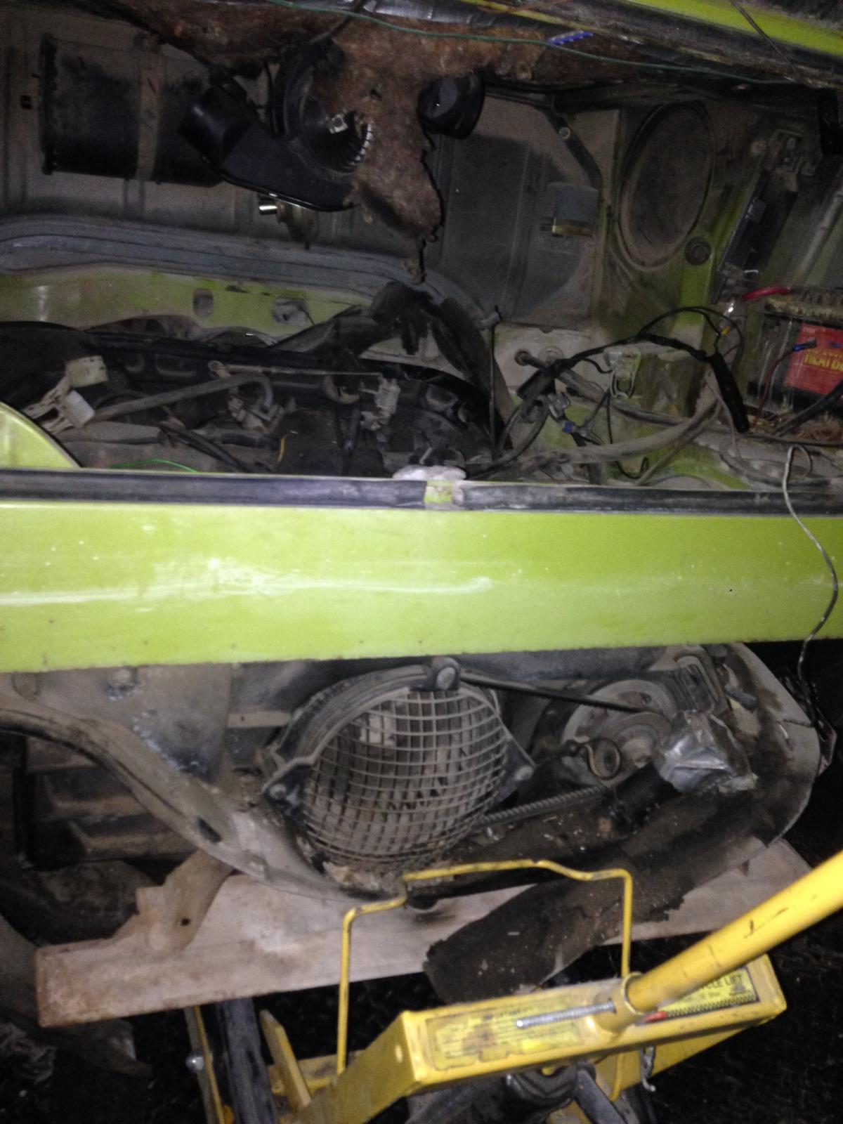

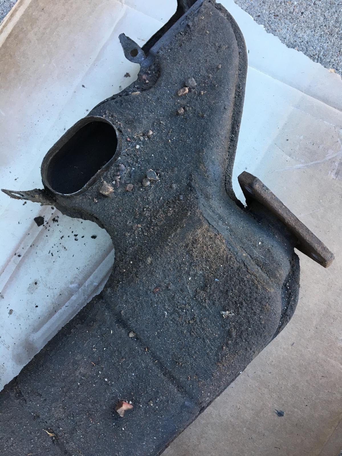

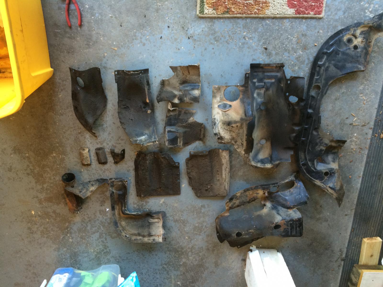

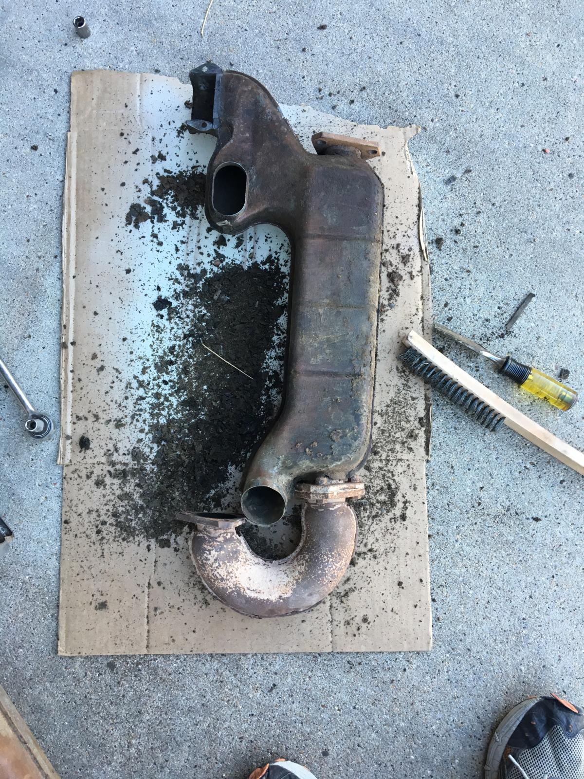

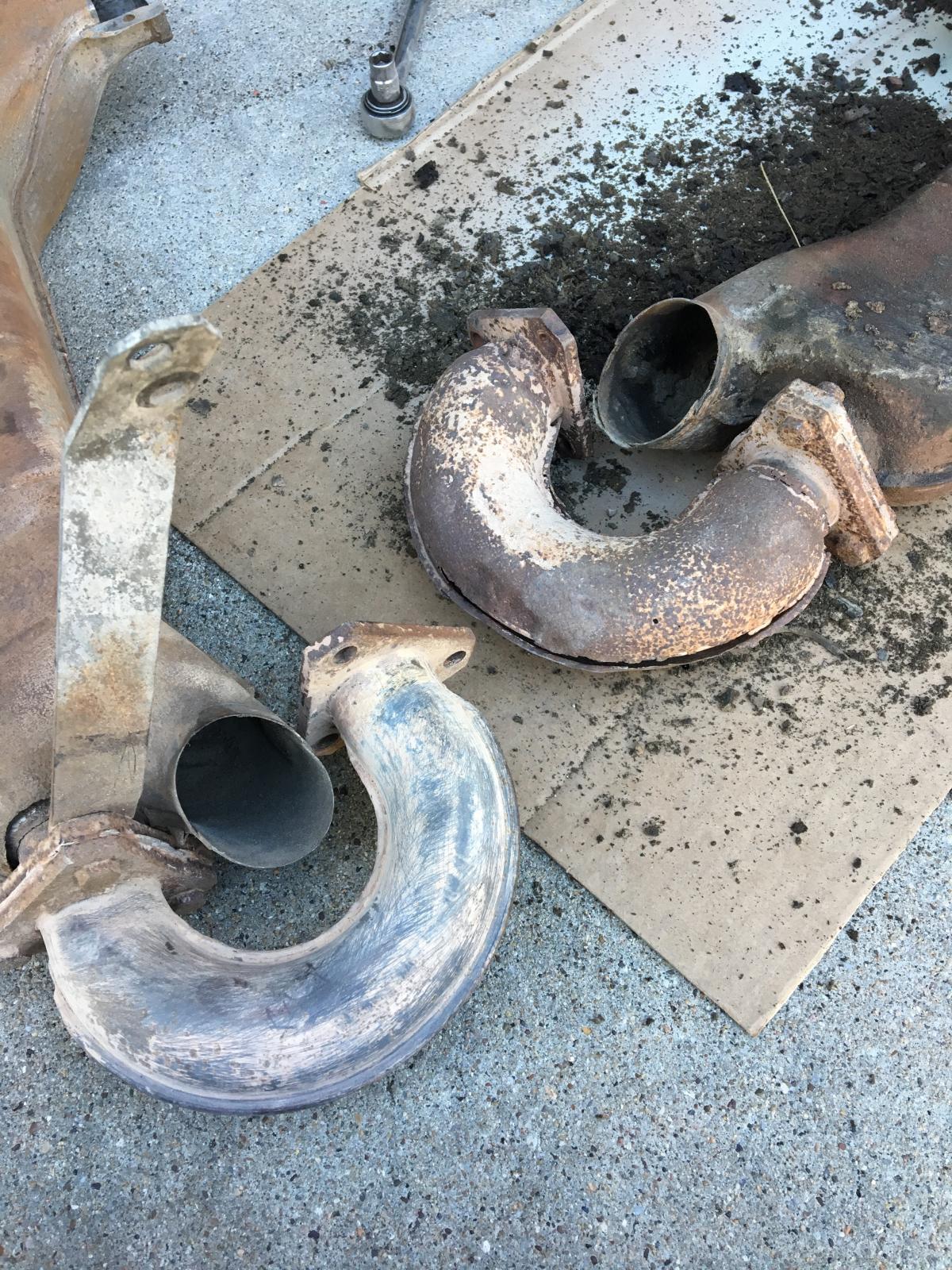

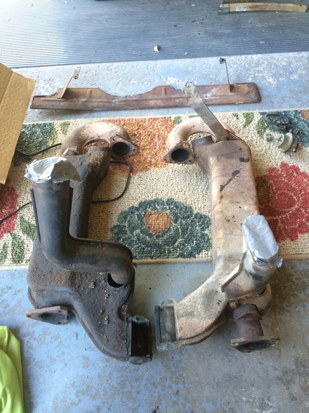

Looks like something had burnt on top but not for long. Engine compartment ceiling material was showing signs of a fire. Not so sure yet what was going on but I will verify that in its time. Machines usually leave behind forensic evidence when they fail and hoping it will tell its tale when we get to digging.
With this all taking place I think the first good, easy and obvious thing to do would get this machine on some new rubber that would hold air. Something I can roll her in and out of my garage on. I have a great tire guy and after a few Samba searches I ask him to land me 5 Hankook RA08s.

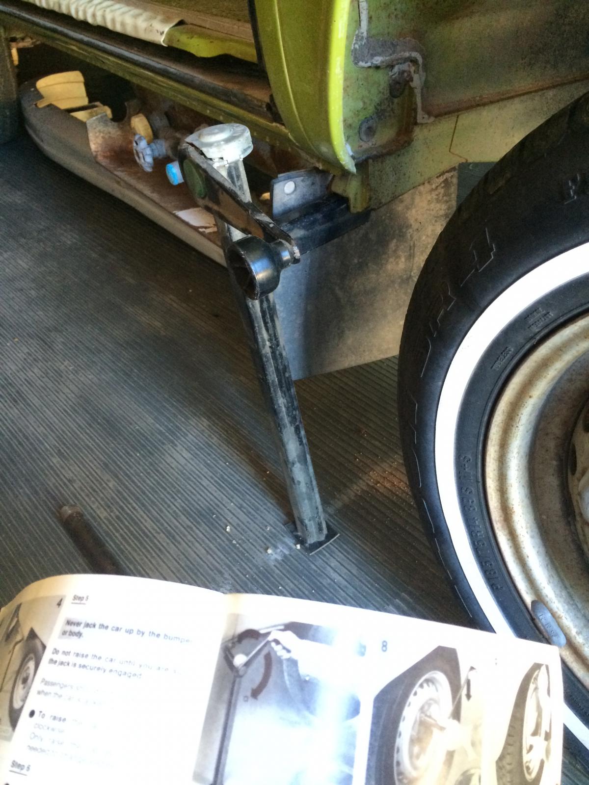

I'll admit, Im new at this, but the bus has a period owners manual and with its original jack I get the tires off.

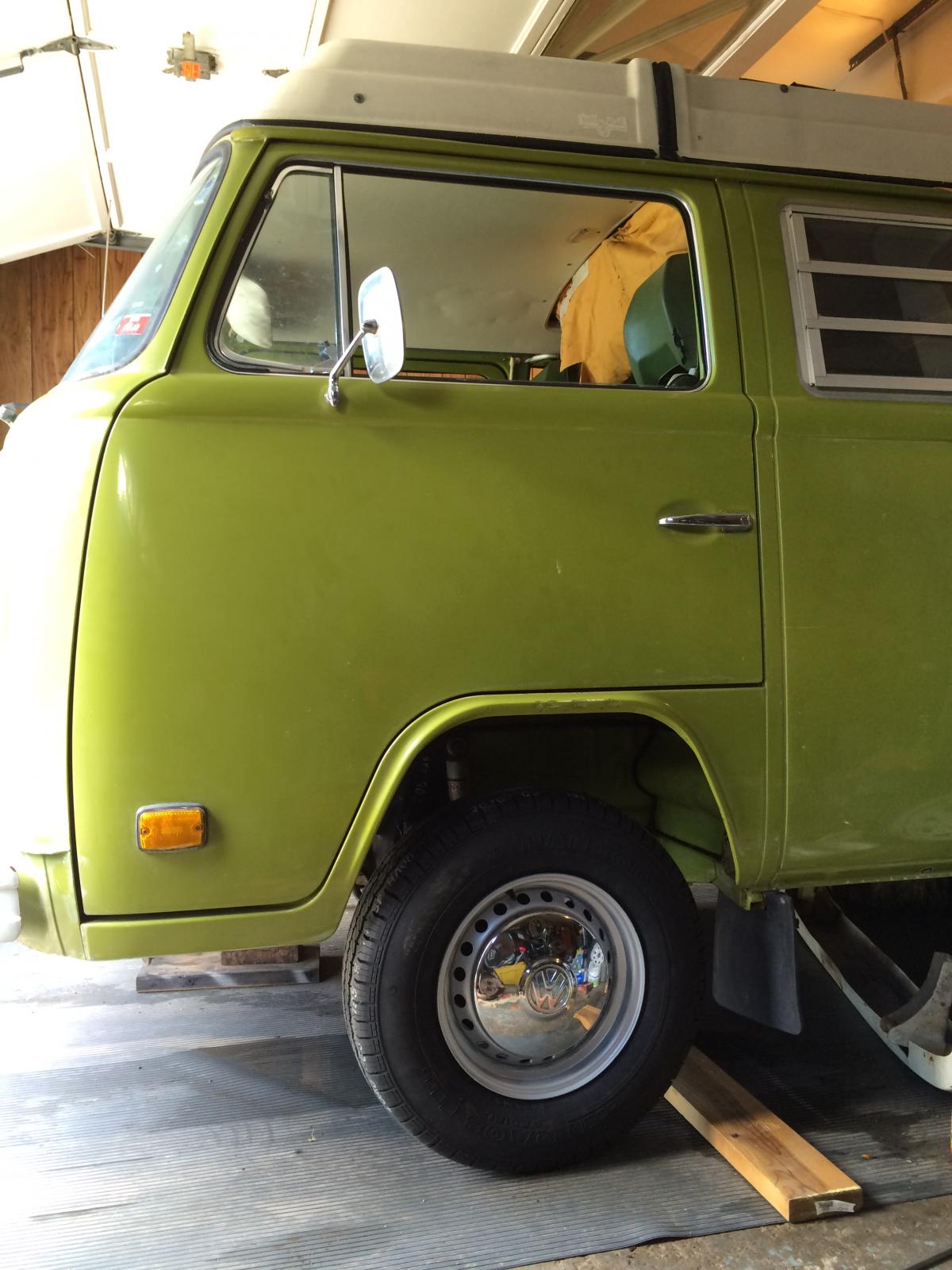

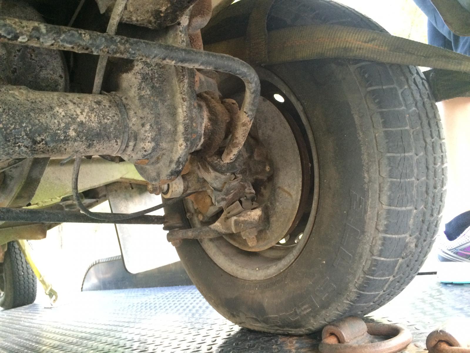

At this point Kevin would like the tires so he has an extra set on hand for when he's towing a bus onto his trailer in the wild. They were OK rollers and probably fine shipping tires, but I go with quality tires in this point of my life having messed with bologne skins enough times to know better.

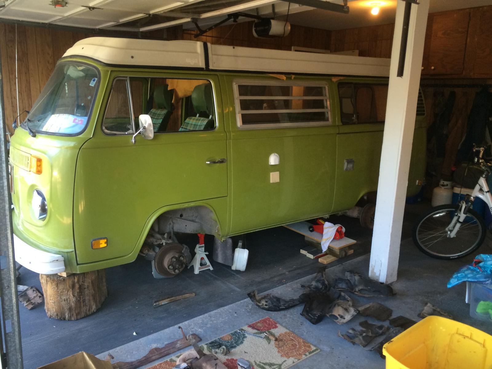

My Dad lets me pick up a few jack stands and I use everything I have to stabilize the bus including my wood splitting base I tucked under the front beam and wedged with 2X4s etc. I didn't want it to wiggle at all with kids around. This really made me nervous and when I dropped off the wheels to get powder coated I stressed my situation.

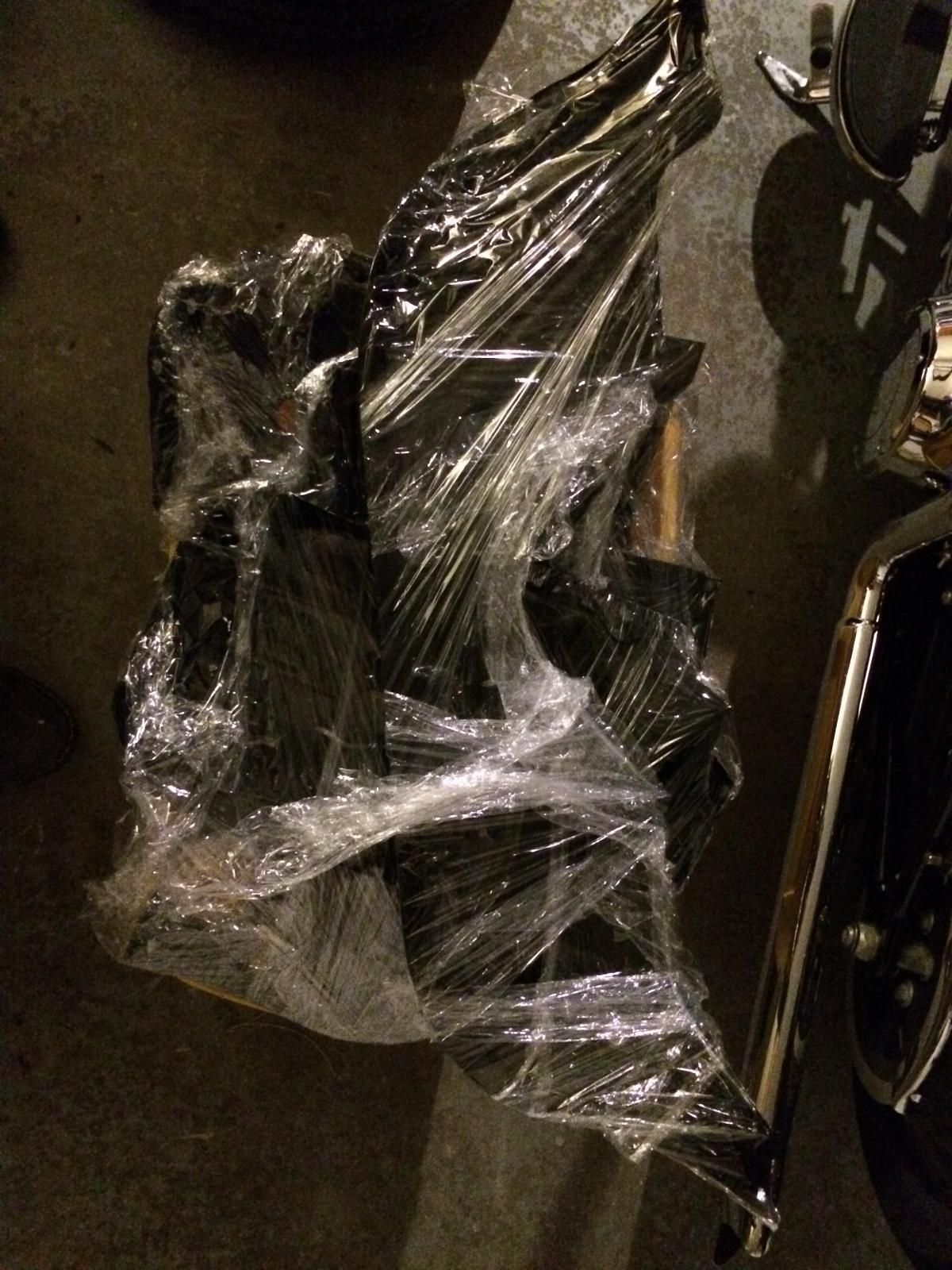

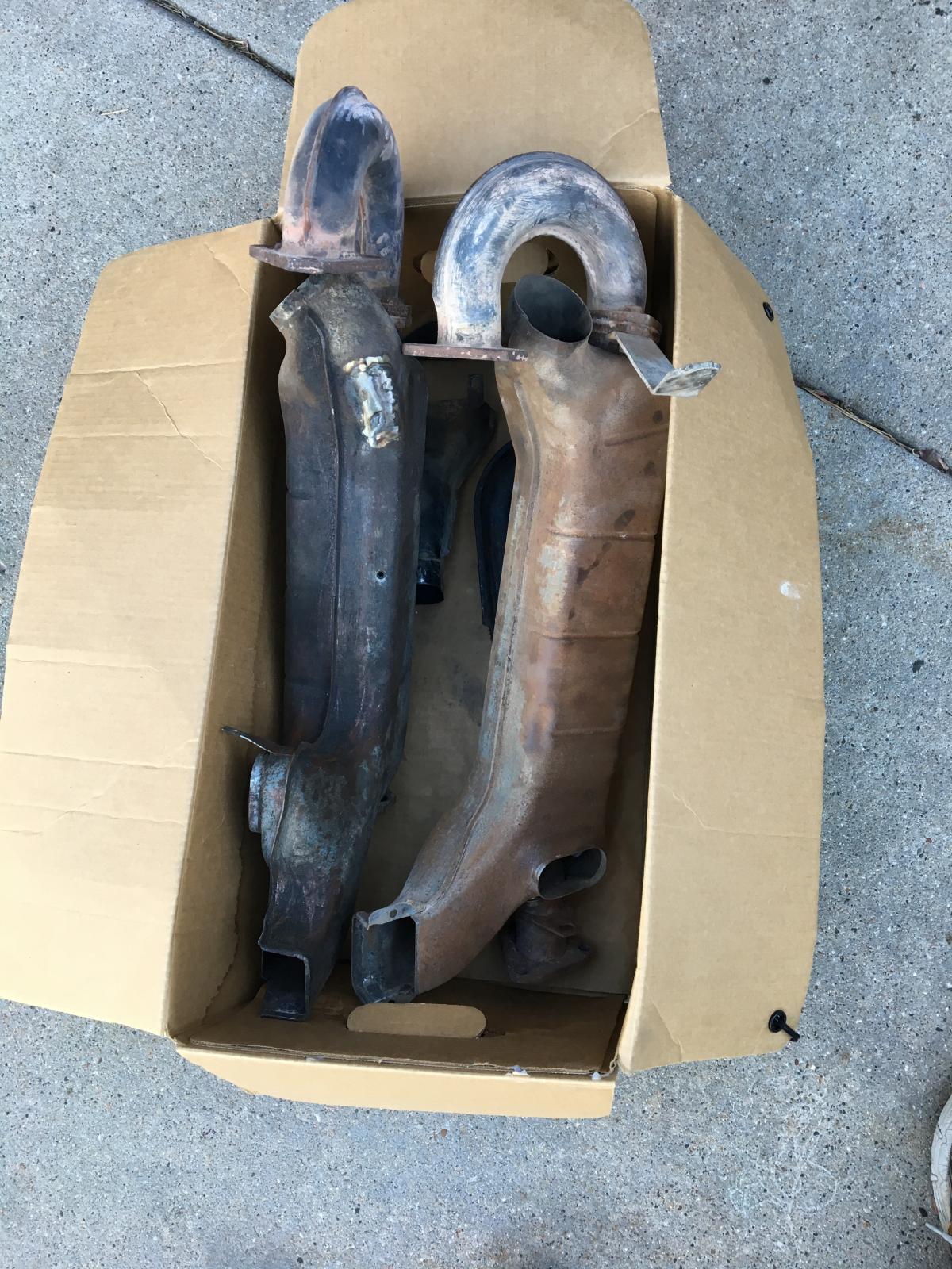

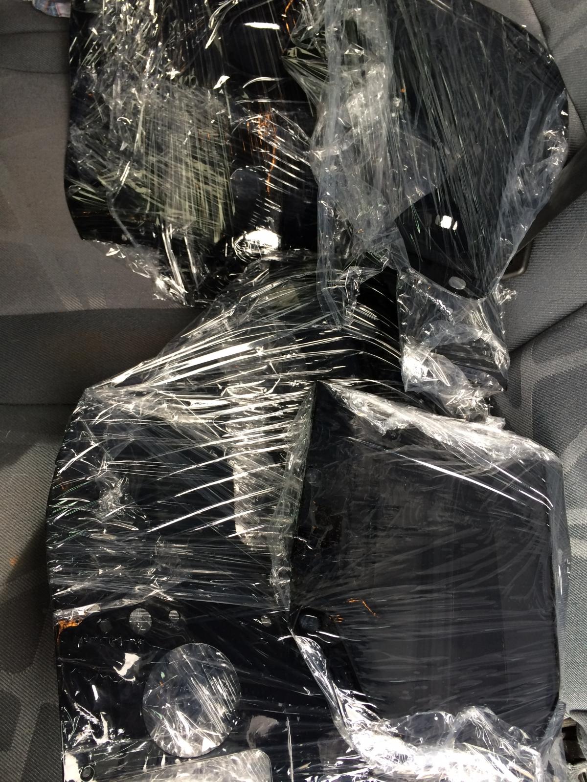

Black Hills Powder Coating guys really got interested when I said what I was working on and showed them some pictures. They said they'd have them taken care of soon. They specialize in custom railing and color and said if they don't jump on the sporadic hot rod pieces they build up, so they strive to just work them right away. Cool! We settled on a color pretty close to the original finish and it was like a day and they called me and I ran them right over to the tire shop where they mounted them for me while I waited. Both the coating guys and the tire shop guys seemed genuinely interested in helping. This was the first time I noticed that folks get a gleam in their eye for a bus and sort of get into the process with you.
I wash the hub caps one night in soapy water and touch of liquid soft scrub. There are a few dents and scratches but the rust spots and film came off. I could replace for sure but I want as many original parts as possible and a little honest wear won't bother me a bit. So Yeah, I want new rubber and weather resistant wheels paired with already dented caps, just for using, which I plan to do.
Now that the bus has some new skins on hand I realize I can't just put them back in that crusty ol wheel well........OOPs, I scratched a little spot on that undercoating and it just fell off revealing some minty green,,,,,,

I started by using slices of wooden window shims to scrape out the chunks of caramelized grease and dirt cake. Chipping that away I then hit with a bit of a brass bristle brush and dawn dish soap water and buff it out with rags like a shoe shiner. The rubber boots around the bearings are all cracked, bummer. They don't look easy to swap. But thats not my mission today. The undercoating just basically falls of in places when I scratch it with the dull wooden chisel I made and finishes up with a little thumb nail picking and a bit of sponge work. I don't want to spiderweb the paint, but I like the look of the green showing and after two hours, its time to jump in the shower and head in to work.
The next morning I finished it out. I don't have a full photo of that but I like what is happening and the factory printing was revealed etc. It occurred to me then how nice and practical it was to have the break line solid/soft juncture right there where you could get to it. But yeah, I'm looking at shocks, breaks, boots, you name it, thats all gotta come in the future.

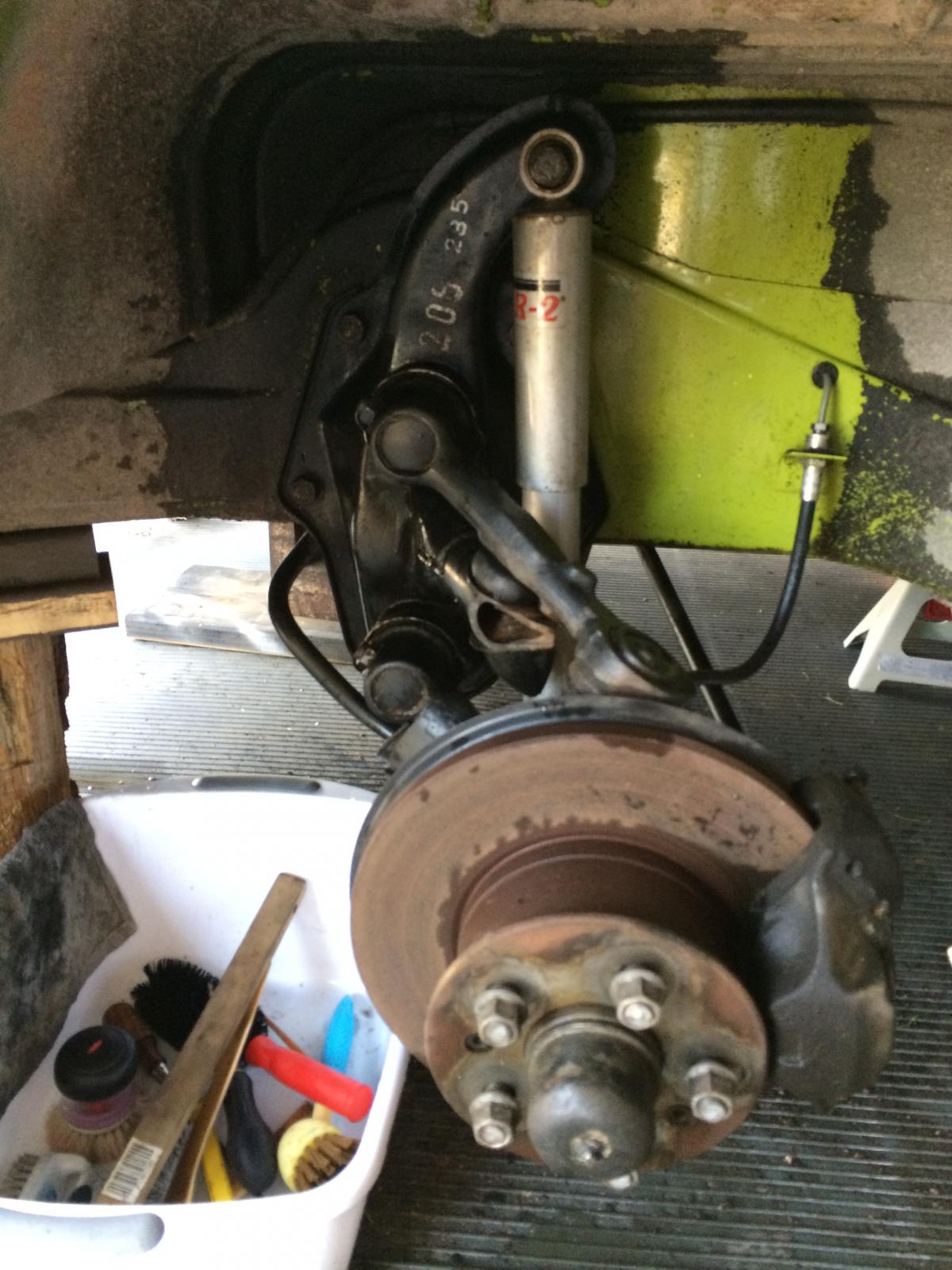

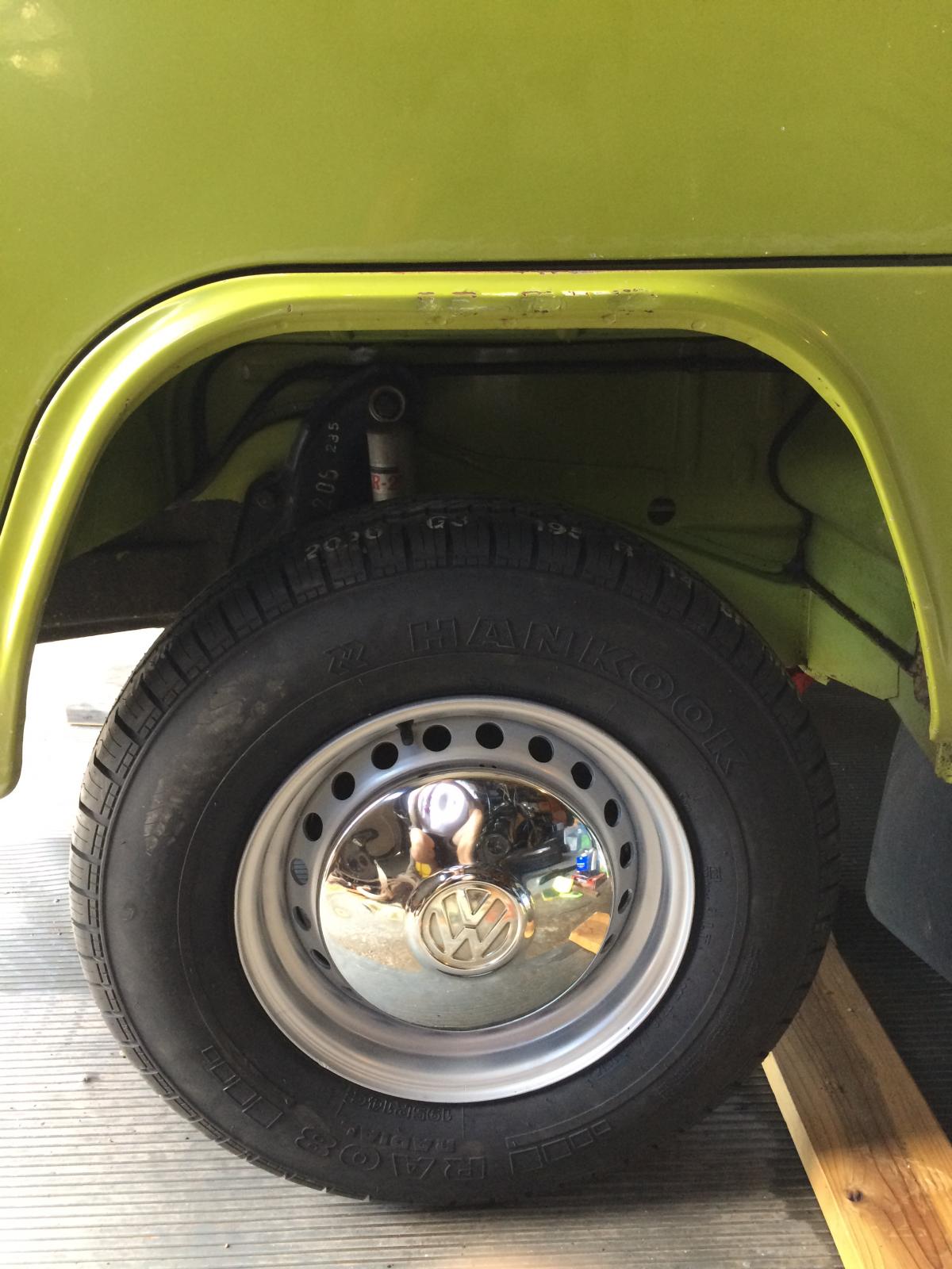

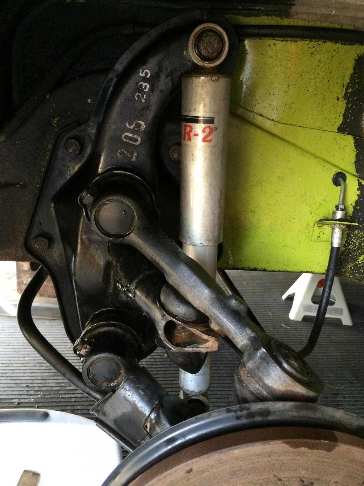

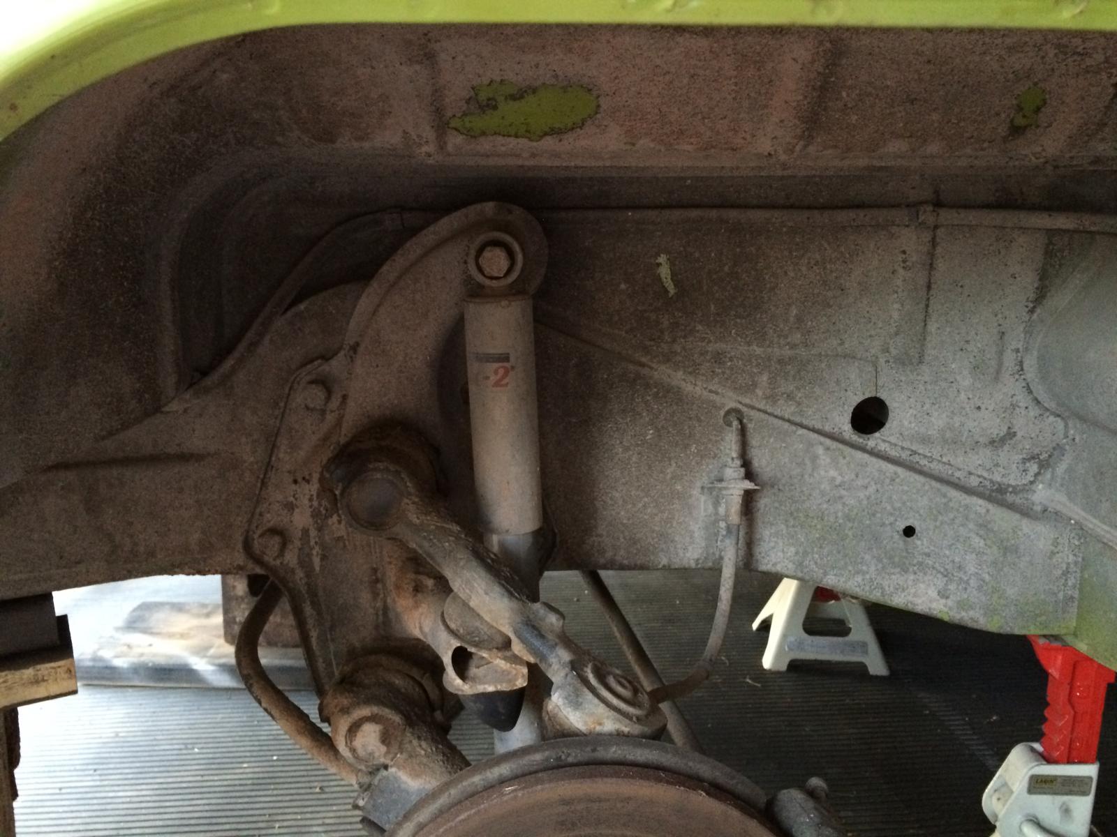

I feel better with that wheel on, but I now have 3 more wheel wells tapping my shoulder. My traps scream working overhead like that and Im about good for 2 hours of that at a time.

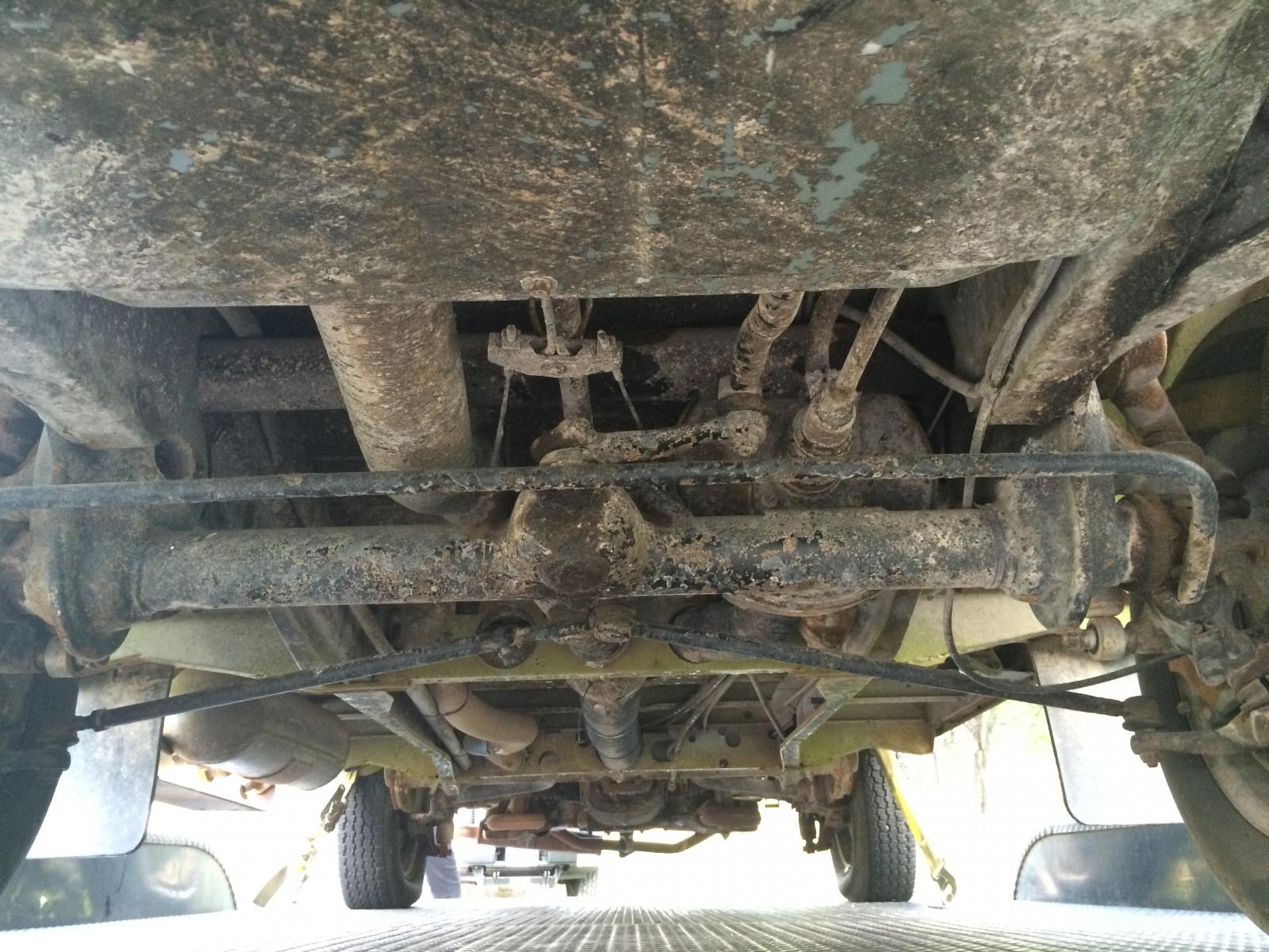

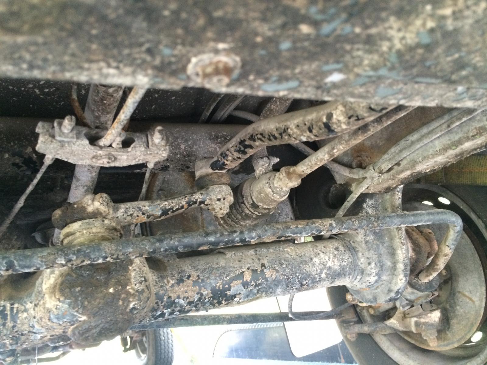

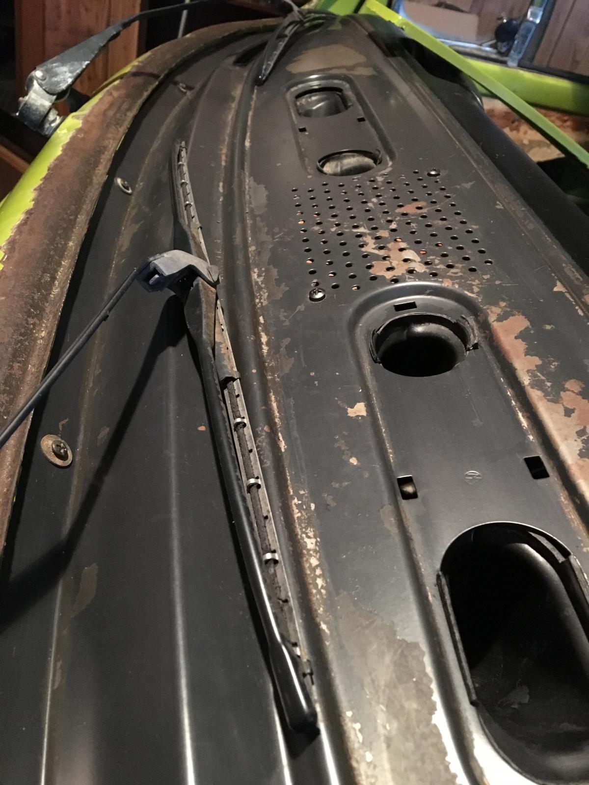

When you buy a vehicle, you want to get under it as thats where most of the problems lurk. These are a few of the underside I took when I bought it. Not really knowing what Im seeing it appears covered in an aging tar based undercoating in varying states of decay.
I don't know what to do with all that, I'm sure its gonna get in my eyes.
The next few days I got after the front passenger side and after that ordeal I decided to just put the rear tires on and get it off the jack stands and rolling again. Plenty of time to do those. Kevin giving a little jazzing about cleaning the wells but they look good I think.
The inside looks brutal and now that I have a weekend day off I'm gonna tackle the heavy dirt and mouse turds and see whats in these cabinets.

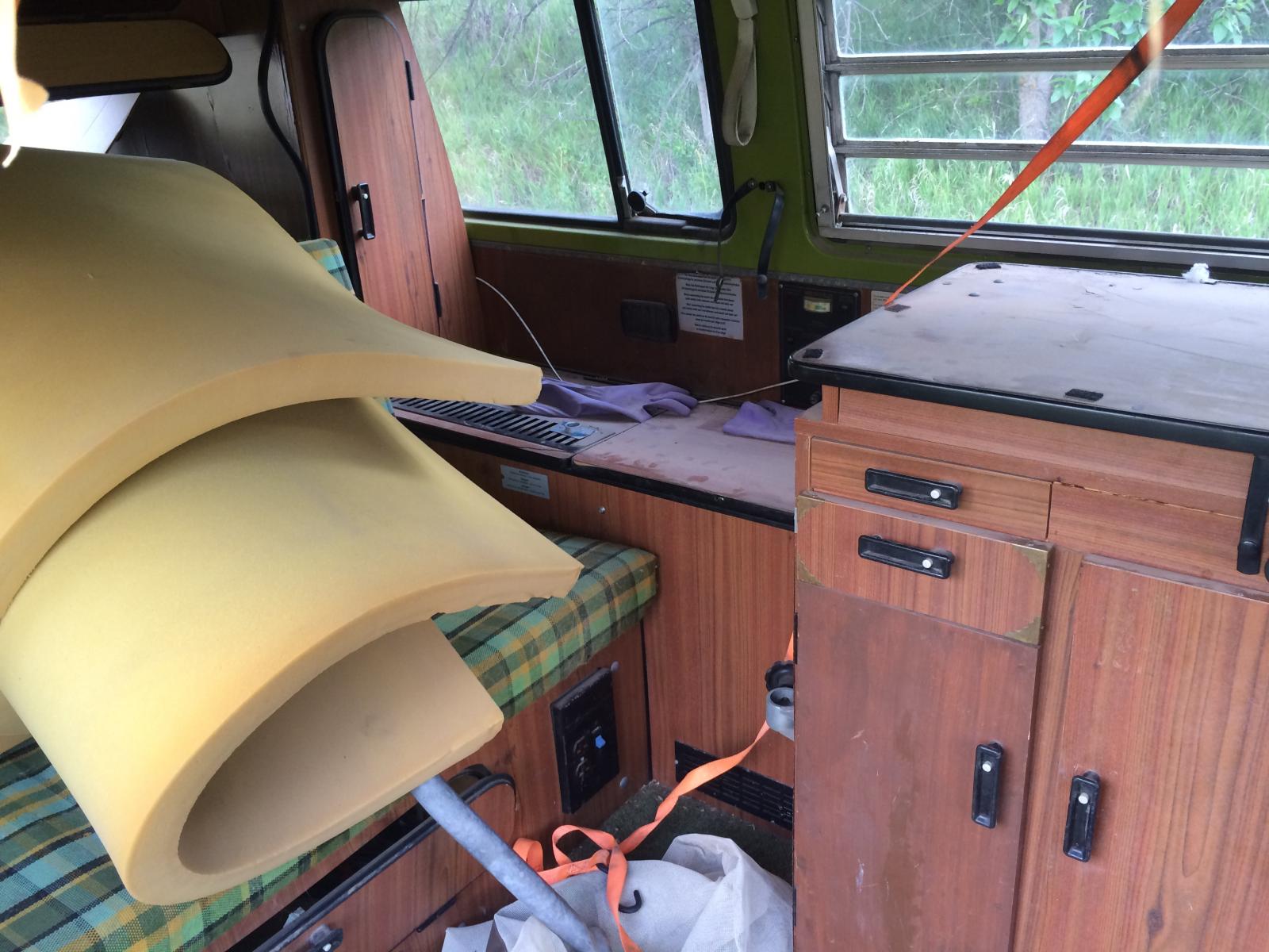

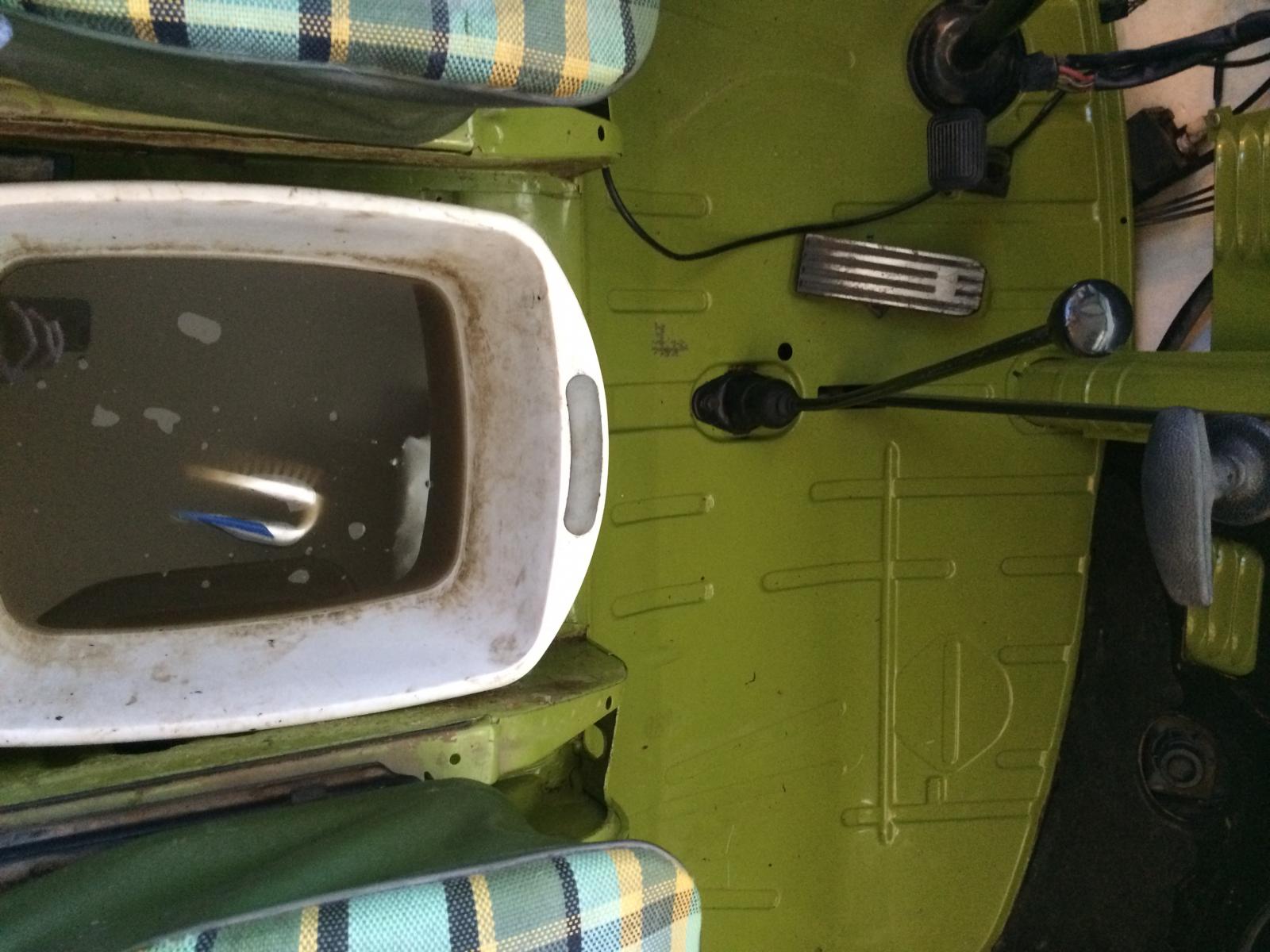

Some serious vacuuming has taken place. Looks like a dog had lived in the bus and someone left a lot of beer cans in the spare tire wheel well. Bits and pieces like half used match books, candles and fly swatters, etc. Another set of keys and, extra headlight, a few bucks in change and a nice city power extension cord. Also a few cans of old touch up paint and wood stain. There was a box with a tan canvas from Bus Depot and all the rubber seals was in a box. That had a receipt from just a few years ago, so I'm thinking someone was considering a refresh themselves.
There was a load of original receipts and services. Theres a lot of neat addresses on them from service stations to park passes. A few bill of sales...
Nothing really seems that trashed. Just real dry and laminate sprung...
Kevin said he'd would have liked to have had time to clean it but I said he would have gotten the change! I always say, if you want to really, really know something, clean it.

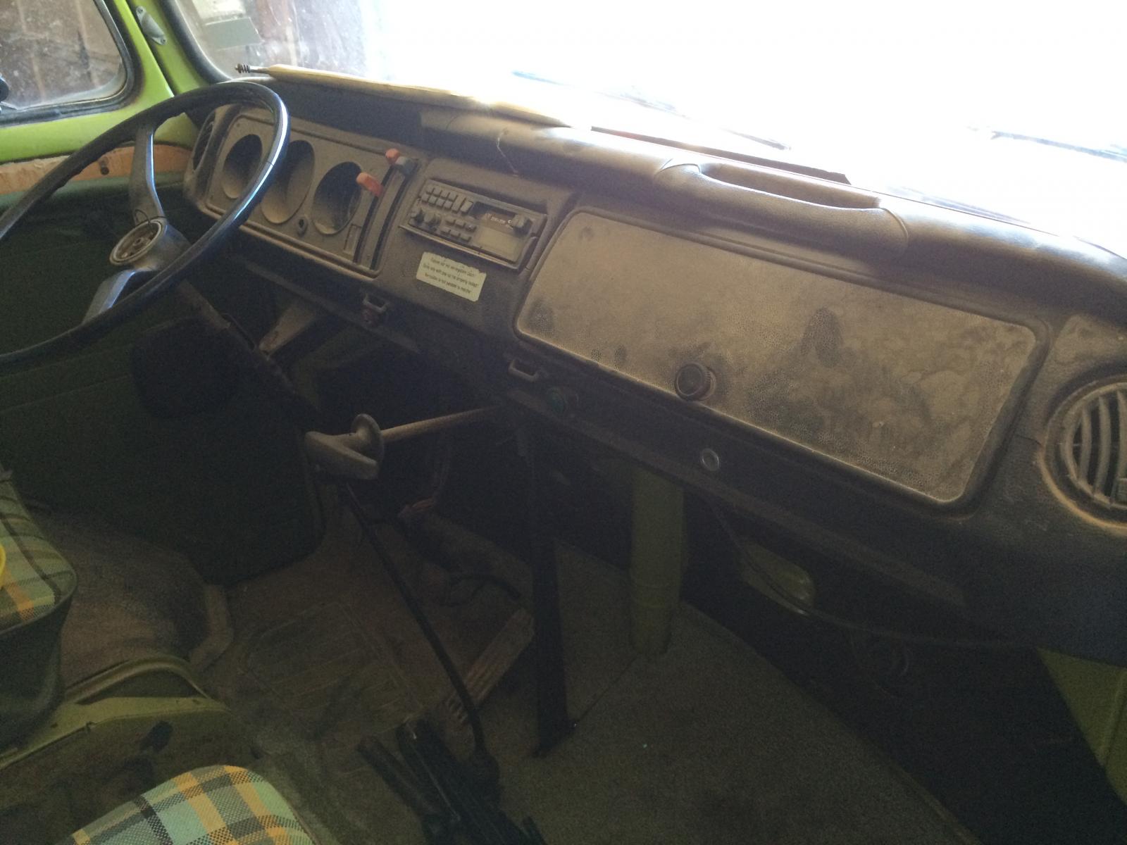

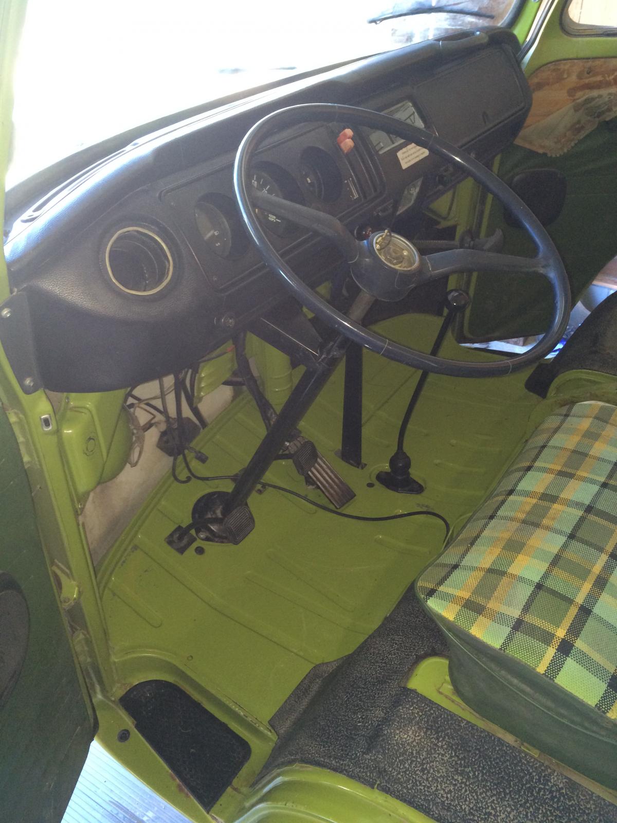

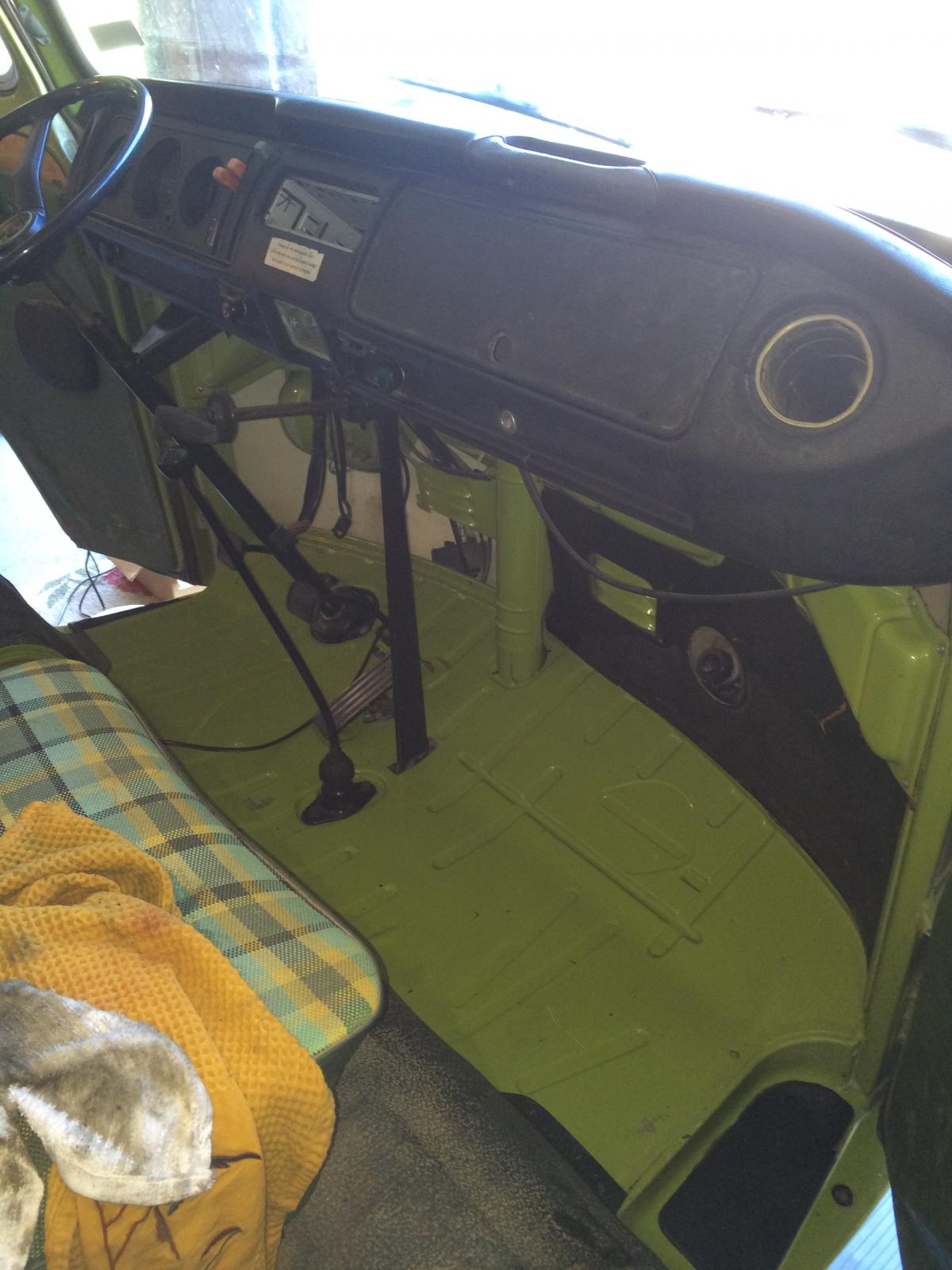

I want to be able to sit in the cockpit without getting all dirty and breathing any of the dust, so this in next.
Just a light wipe down at first with warm water to start softening up the heavy stuff. I think that the heavy particles can scratch your surfaces so I get those up first. Then I get a little soap going, like drop of Dawn to degrease then wipe down with a clean rag each time changing my water a lot. Then, when I think I have it clean, it dries and I can see more dirt and do it all over a few more times. I got turned onto Back to Black conditioner and liberal applications really make that dash look sweet!
This is several hours of cleaning and its pretty addictive when you see the results before your eyes. I just rub till my fingers are trashed and need a shower. The paper glove box was torn beyond repair and the toe kicks seemed pretty ratty, but I saved then anyway until I see whats out there...

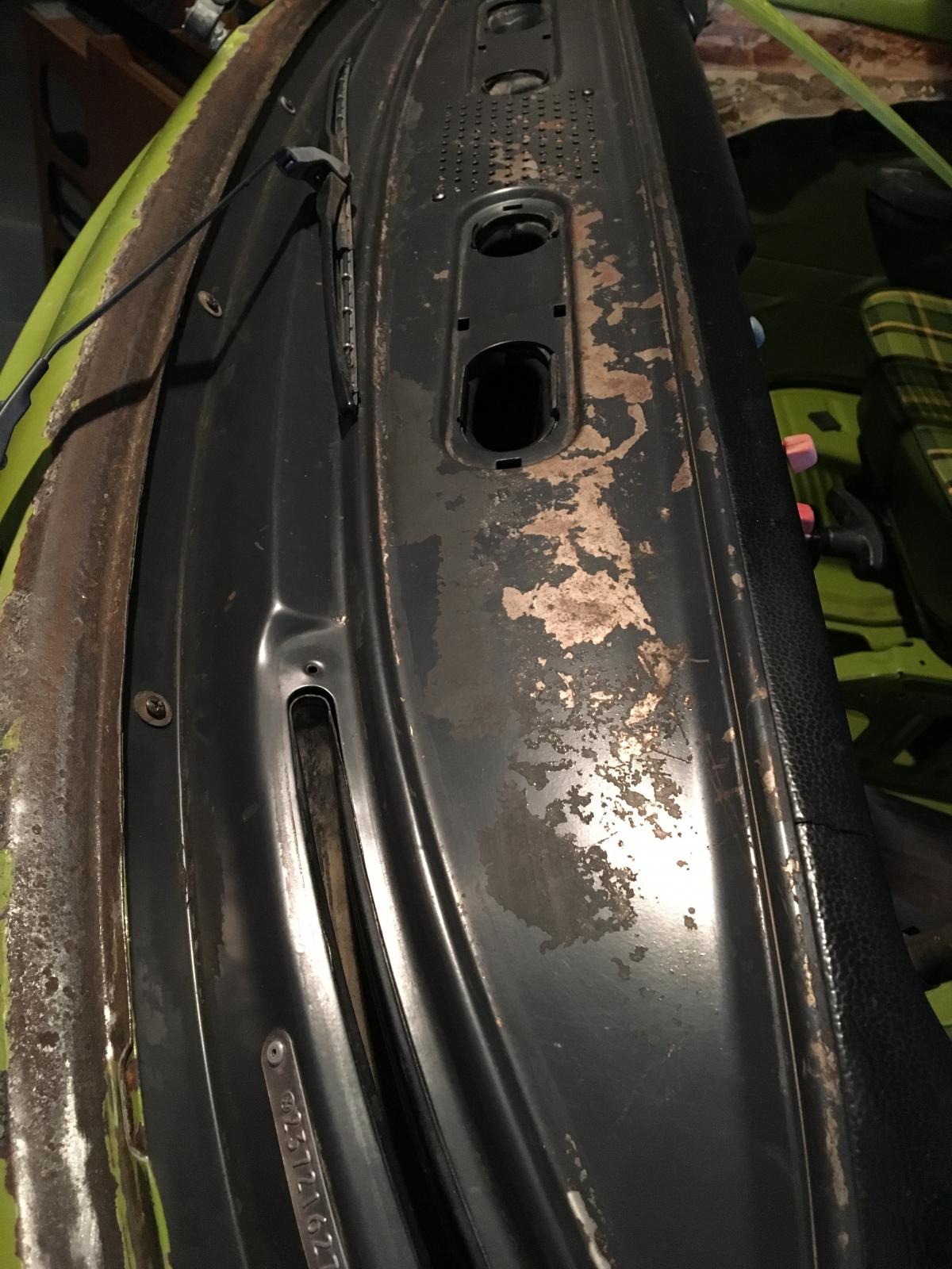

Im pretty disappointed in the dash though. Its surface is really ratty and a cleaning didn't do the transformation I was hoping for Sad . It just looks so bad tilted right at me when I walk by and I started to obsess about it. There doesn't seem like a straightforward way to remove it either so I just leave it alone and clean all around it the best I can.
The front glass is cracked from what looks like something fell hard on the nose right at the belt line and dented that too. Kevin jumped in the passenger seat and put his feet on the inside of the windshield and said 'catch this' and just pushed it out with his feet! Wow, who would have thought it'd come out that easy? He said he had to figure it out with all the windows Fiona had and saying he didn't have the money at the time to pay anyone to install them all, asked some glass guys to take pity on him and show him a few things. So that info transferred onto me right away. He has already sold me a new windscreen and it' just sitting on my floor in the basement and being the best place for that would be in the bus, I start thinking about this area wholeheartedly.

Wow. Really clean, rust free bus. That is one great find. Congratulations.

Somebody loved that one.
Maybe ball joint boots next. The four 'difficult' ones behind the front wheel/tires)
Then brake fluid color check, flush it all if it's too yellow or already orange.
Should try your best to keep the F.I. system intact. You mention burnt stuff?
You should be able to piece it all back together with Samba classified help.

I think its fair to say that a lot of what I'm showing you folks has already happened months ago and I'm just now finding the time to post. This bus has already come along some and I'm building this thread with a commentary so I have more than just a long camera roll about it. Along the way I whipped out my phone as much as possible (filthy hands even) but I wish I had done more so. Things Ive found and learned and certain trials. There are 1500 photos on my phone that directly relate to this project. Most of them as reference to how to put things back together that I disassembled and rather boring.
By all means I appreciate feedback and free advice.
I want to tell its story in its proper order and at this point its time to get together at Kevin's and pull the tin off and strip down the motor. Get a little greasy and see what's up there. This guy Brian sounds like a competent motor man and machinist from what Ive heard but at this point I haven't met him yet. Sounds like there are several projects ahead of mine and not a huge hurry, but until then I figure I can get the motor off Kevin's floor and back into my hands.

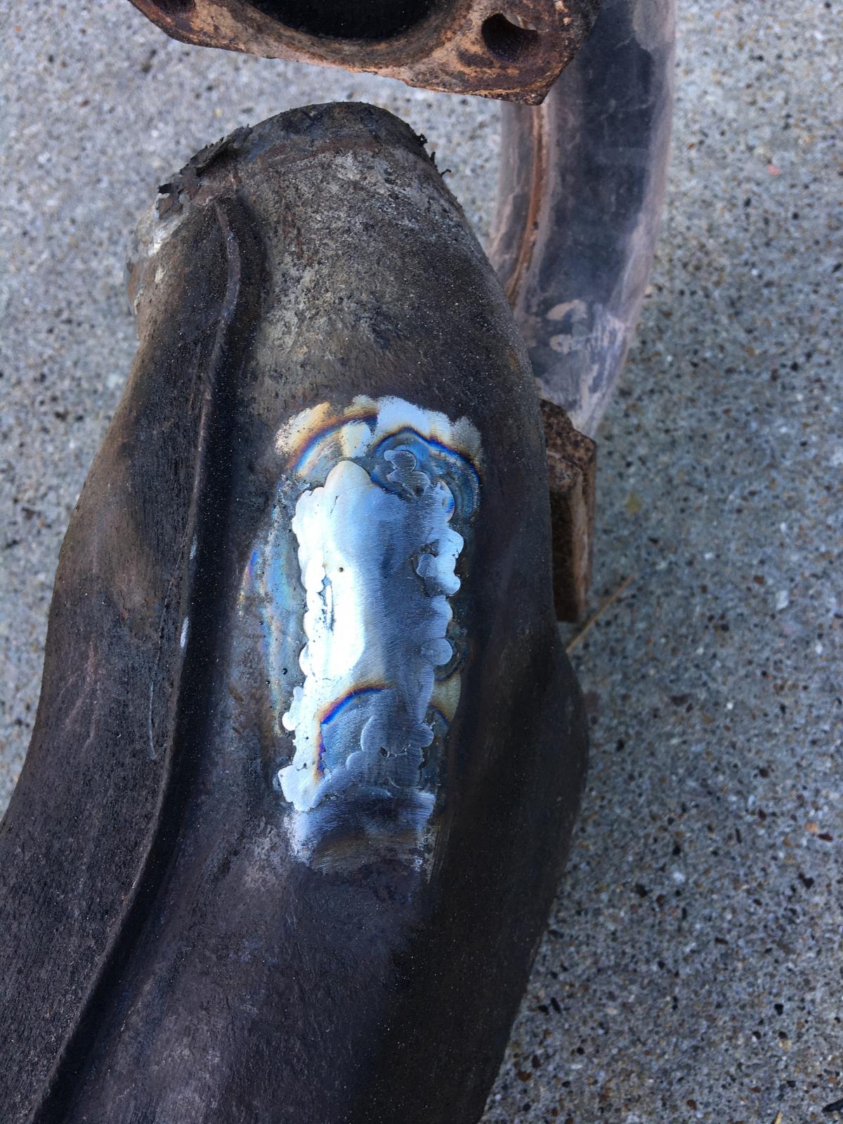

Its looks like the FI harness wire harness were melted on top and few other crusted bits. The Tin has some stripped screws and needed some Blaster and cussing but came off pretty decent. Cracked in a few places. I stupidly said can we just get rid of this tin? Oh heck no, they said thats what cools your motor. My bike doesn't have any tin round it, and that got a laugh, your bike motor isn't in the back of a bus! Ok, got it.
None of these guys are a fan of the FI but I'm just listening for now. In a box it goes. Lets see what the motor man has to say.
I did some searching on my own and found you just can't order up a type 4 from anybody just sitting on a shelf, besides this company called GEX. I even brought it up and they all said NO. Do some searches on the subject.....
Ok! Scratch that, so how about getting a sit down with Brian and get a game plan then.....

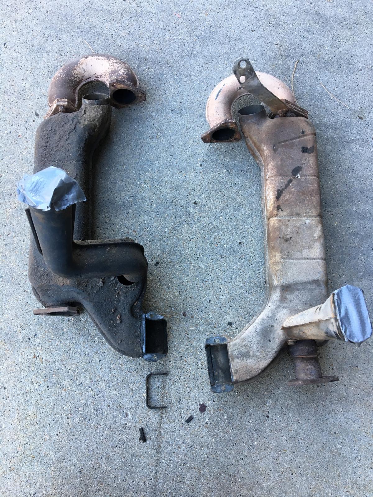

The Tin and Heaters come home with me to get cleaned and worked over. One of the heaters looks like it had an oil leak dripping onto it for a while. I wonder how this will clean up.
I got a few holes welded up myself. They look like they were sandblasted through from road dirt in a few exposed spots.
Off to the powder coaters they go. They said they didn't want to coat then because of the heat involved, but went ahead and sandblasted them for me.
They had the tin too.
I went with a gloss black with the logic being it would show and oil that gets on it he best. I could go with more of a matte finish sometime on a future build, but that what I did here.
In the basement they go!

You can buy a Camper Special type 4 kit from the Type4store.com
Keep the FI as it is much more drivable than dual carbs
