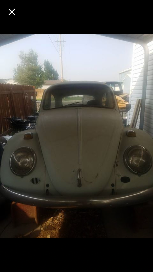

It's hard to believe, but I have kids that will be driving in about a year and a half. My wife and I asked the kids what they wanted to drive, and they al mentioned a bug, so the look for a project car started. I determined that I wanted one from the 60's, and after many missed opertunities finally came across this 66 bug.
The description stated that it started, but tha's about all. Went to look at it and was told it had brake problems. After a week of failed attempts to bring it home, we finally got home. We charged the battery and drove it many times around the back yard (brakes seem to work okay). It came with about 2 boxes of spare parts as well.
Now that the new year is starting, it is time to get started on tearing it down to see what we need to do. Here is the first day of actually doing something
My oldest standing next to it
We decided to tackle the interior first so we could see if floor boards would need to be replaced. Was very excited to see that other than seats, it looks like most of the interior pieces were scattered in the piles of rubbish in the back seat.
After a few hours of removing rubbish, mice nest and droppings, and tar board, we managed to get the passenger side cleaned, and the floor pans look amazing. Sweet victory.
Next will be the drivers side and then the dash and front trunk.
On a side note, there is a random bolt in the front hump that I can't figure out it's purpose. You can see it in the pic. Any idea what it is for?
Cool Project! Looks very solid!
The "bolt" you are asking about . . . Remove the shifter and look inside the tunnel to see how someone "FIXED" the shift rod bushing.
Parts are readily available to do the repair correctly.

Good score! That Beetle looks like a great start for a restoration. It's pretty rare to find a VW of that vintage with solid original floors outside of CA or the Southwest. Good luck with your project.
Some food for thought: There was a very detailed thread started on here about 5 years ago that chronicled a similar father/daughter build that might be worth reading. To make a long story short (thread is 35 pages), the daughter was very enthusiastic all the way thru the project but in the end decided that she didn't want the car after all. The question of just how safe is a 50+ year old car in the hands of a young driver eventually came up. Stuff like crumple zones, air bags, anti-lock brakes, etc. are nowhere to be found on an old VW. It turned out that the parents of the daughter's friends wouldn't allow their kids to ride around in an old car with no modern safety features and that pretty much killed the whole deal right there. Something to think about...
Here's a link to that thread: https://www.thesamba.com/vw/forum/viewtopic.php?t=524322&highlight=san+diego

First replace/install the cooling hoses from the fan shroud to the muffler/heat exchangers (your left one is missing). This will soon overheat your engine!
I would replace fuel lines (engine bay, next to tranny, and under the tank) and the intake manifold boots. A general tune-up/valve adjustment is a start. Change the oil.

Other than moving the fuel lines and fuel filter to avoid engine fires, what else can people see needs to be done with this set up?
Looks like you have an '009' mechanical advance distributor on that motor. These don't play well with 34PICT carbs. You'll probably be better off with an SVDA (single vacuum, dual advance) distributor. An original German Bosch '034' would probably be the best choice here. This was discussed recently in another thread on here:
https://www.thesamba.com/vw/forum/viewtopic.php?t=692765
You'll want to close up that hole in the breastplate just to the right of the crankshaft pulley and get the proper rubber seals for the fresh air hoses.
Install a crankcase vent hose that runs between the oil fill/generator stand and the air filter.
Replace the engine compartment seal (motor needs to come out for this).

Go up to "Technical" and pull up the original '66 Owner's manual in addition the electrical schematic wiring diagram. You may have a '66 converted to 12V. Both are "must haves." If converted to 12V, then look at the '67 wiring diagram.
Another good source is the engine/performance forum here that has an "engine guide" full of pics of different types of VW engines throughout the years. There's a nice one of a '66 engine in stock configuration. That will give you an idea of what one looked like compared to what you have now. Based on your pics supplied, there are many differences that need correcting.
Tom Wilson's book and the Blue Bentley manual are needed as well with your endeavor to get your '66 in tip top shape, best of luck and have fun!!! It also appears that some of the dash switches have been hacked, like the emergency flasher switch and the windshield wipers????
