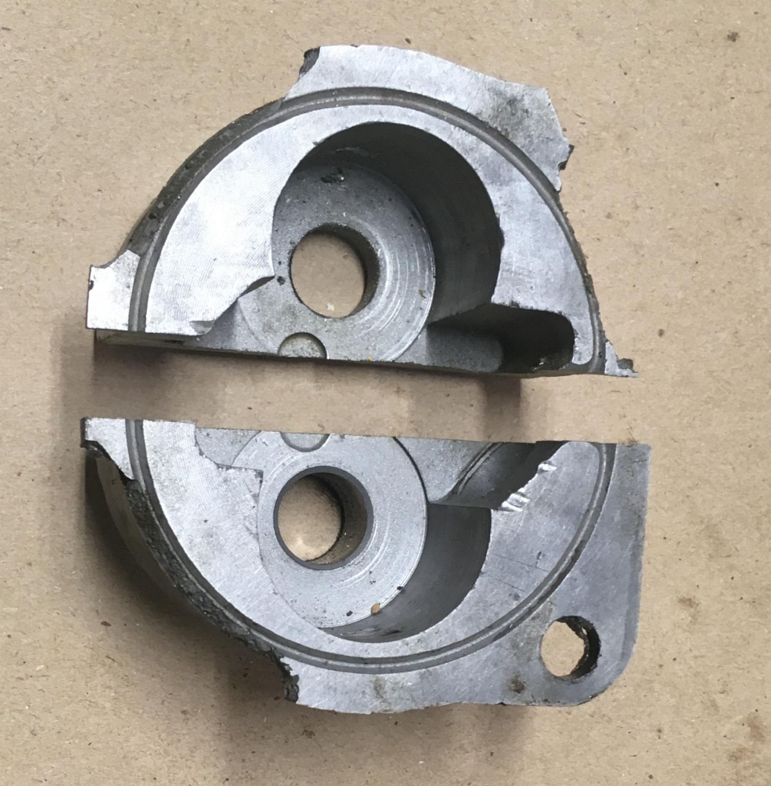

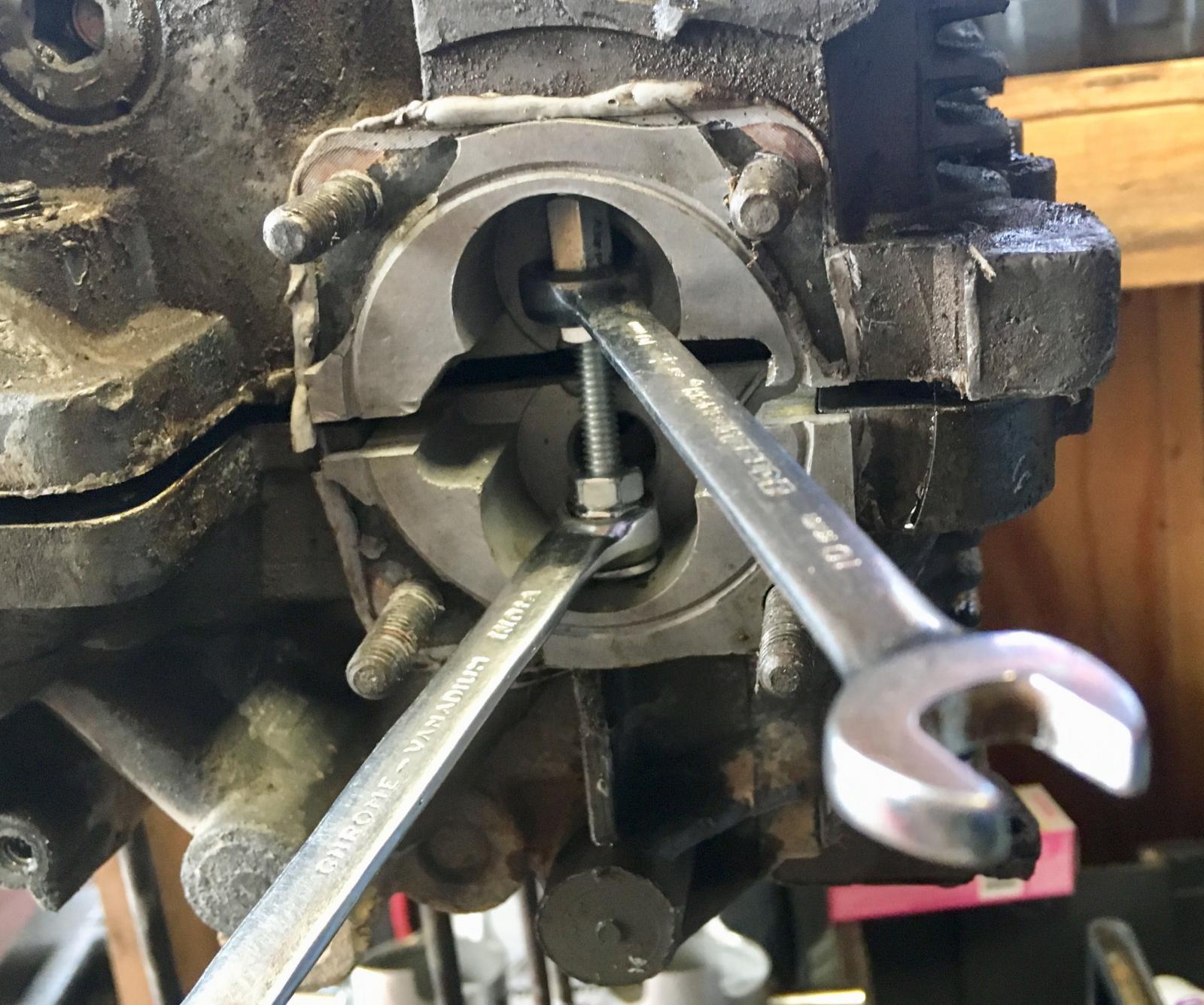

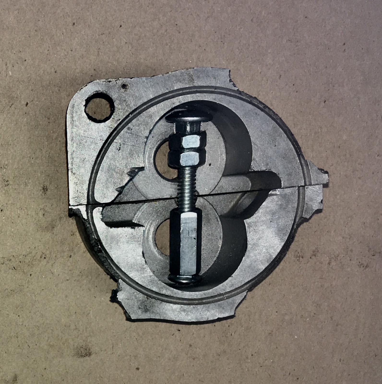

I had to split my case to replace the Crank and made myself a Case splitter from an old oil pump. Parts cost me less than $1.00

If it works and doesn't hurt anything, seems good to me.
I'm sure all manner of home-brewed leverage devices have been created over the years. Me, I long ago got pretty good at delivering well-placed smacks with a dead-blow rubber mallet to get case halves apart.

Well done. The simplest (and cheapest) home made solutions are usually the best, and you get free shipping, good customer service and full instructions on their use Very Happy !

40+ years never needed one but have seen more than one case damaged when excessive force was applied and they forgot the two hidden nuts behind and below cylinder #1. Have seen them used to advantage on cases that were shuffle pinned.
