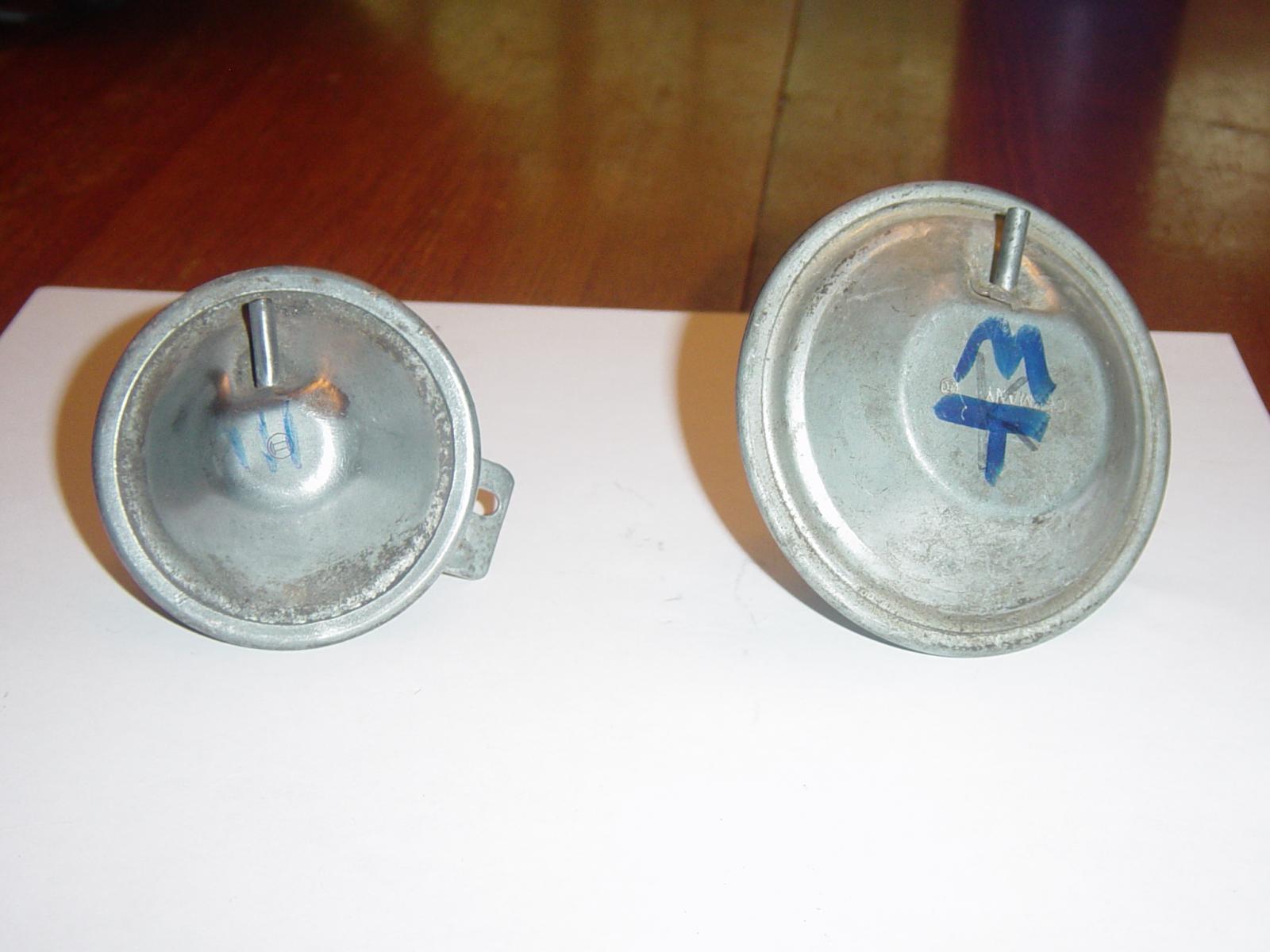

PostPosted: Sun Jul 30, 2017 6:47 pm    Post subject: Re: Recommended distributor for a 36hp motor Reply with quote
Vacuum canister comparison. On the left the 111 series used with ZV/JU 4 R 3(L) and the 111 905 205 M and N. On the right the 113 series canister used with the 113 905 205 K, M, T and a few others.
Helfen, please post your pics to the Samba gallery so that they will stick around for awhile.
