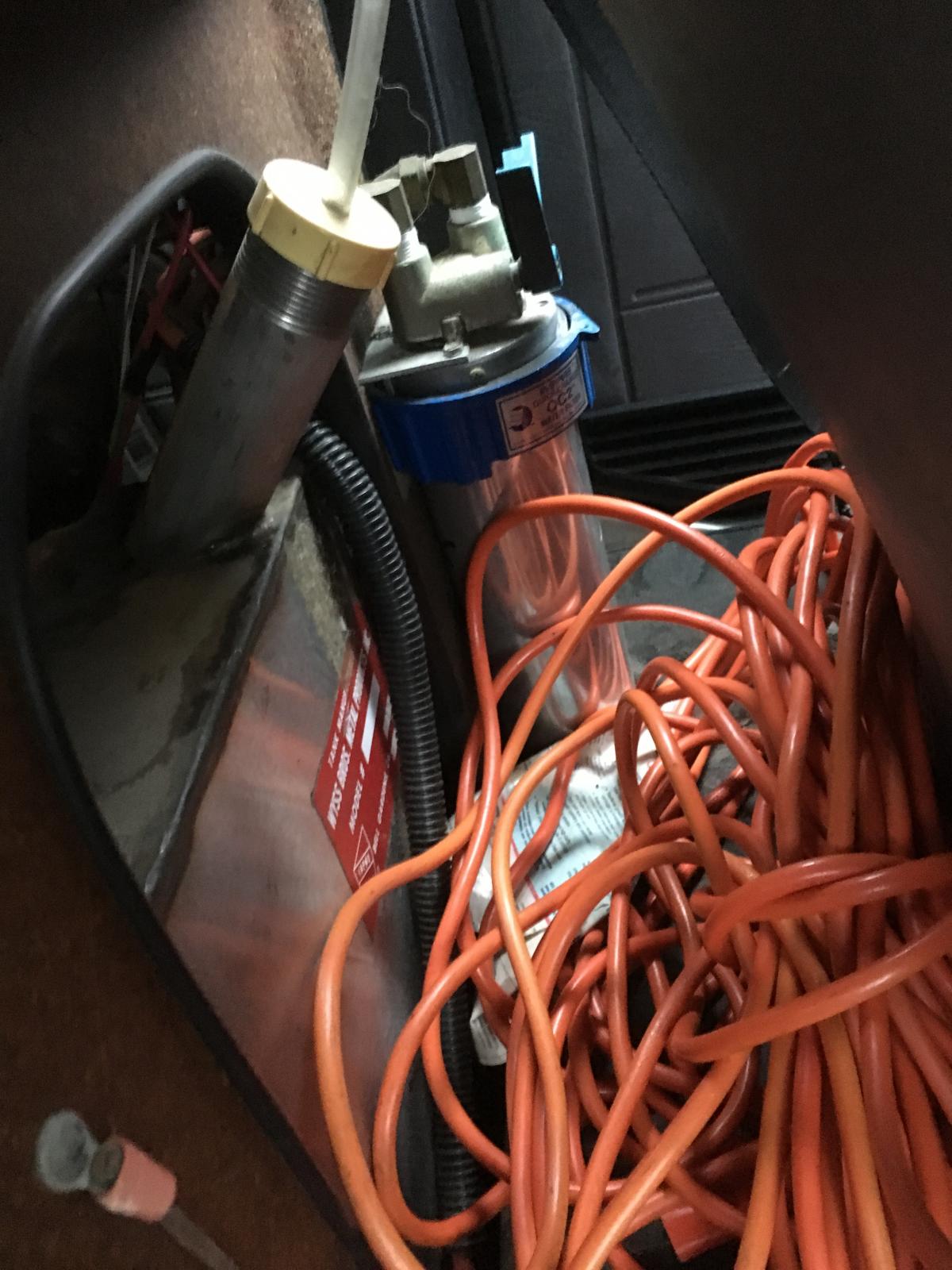

Here's the outside. Not sure which of these is the propane hookup. Guessing the second because the first looks like a garden hose fitting.
Here's up underneath. There's a metal plate blocking the view, just the gray water outlet showing.

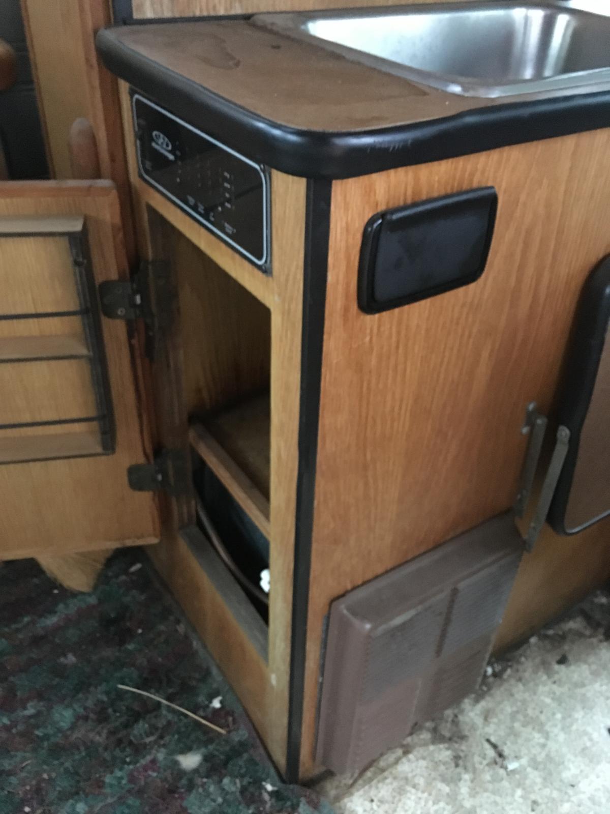

Here's how the kitchen is arranged in an Adventure Wagen. Photo is taken from the back seat passenger side, looking toward front seat driver's side.

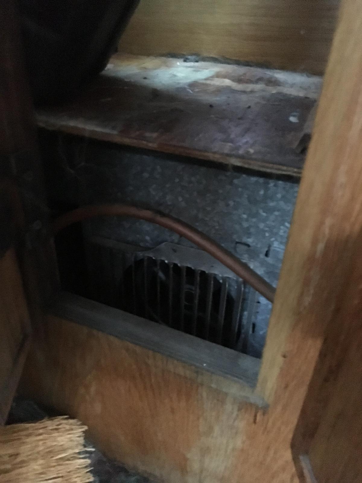

Here's the view inside the first cabinet. I think the propane tank is the big square metal thing on the bottom.
The cabinet closer to the side wall of the van shows the back of this tank and some kind of vent...must be the return for circulating air through the furnace?
Back to the front cabinet shown open in the kitchen pic above, the top shelf shows the p-trap for the sink and you can see through to what appears to be a different metal tank, and I believe that could be the water tank. It does have a water filter connected to it on the other side, right behind the driver's seat (pic with extension cord). (The sticker says IAPMO which certifies plumbing and mechanical parts, so could be certifying water or gas.)

the very most likely places that the propane will be leaking is at the Presure regulator on the tank.
the propane tank is underneath and you should see it peekign out like this.
the rubber diaphragm on the pressure regulator does age and when it fails it leaks out of the little weep hole under the plastic cap. it's a very standard propane component and shouldn't be too much $$ to replace. it's also fairly safe as it's AFTER the tank shut off valve.. which should be off, turns like a garden hose spigot.
now the shut off valves can and do also fail, they'll seep propane at the stem at times, and even if shut off.. to fix this you must drain off the propane tank and then a big RV service center can remove and replace the valve. they often require ALOT of torque to remove.. but again it's a fairly common issue on RVs.
parts should be under $100. and I'd say the labor should be under a $100 too.

that's some dodge sportsmobile van..
you haven't yet posted any pics of a propane tank.
so keep looking for something that looks like a big round long cylinder with valves and a hose either in rubber or copper.

The AdventureWagens have the propane tank and regulator on the passenger side under the sliding door.
Stolen pic - look below the slider.
