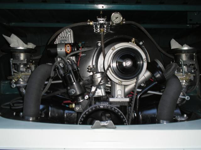

I wanted to be able to quickly remove my engine and have nothing attached to the chassis, including a voltage regulator, so I got an alternator and bolted my FP regulator and gauge to the shroud. Almost 3 years later now, no leaks or problems:
I used Rivnuts to mount the regulator, rivnuts are very strong and seal up the hole that was drilled for them, really well.
Nice, it looks clean.
Are you running a single fuel fitting off each carb? One of mine has a double, but thinking running each singles is more simple.

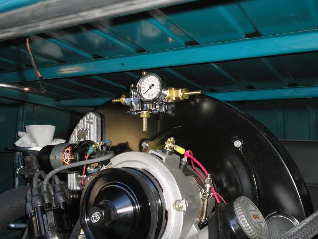

My mechanic friend added this set up to my bus engine. No holes were drilled. Small angle iron piece welded up.
I had a pressure gauge at the brass "T" fitting until the gauge started leaking. I just install it when needed now.
I know some folks don't like hoses full of gas above the bowl of the carb. Gas can drain back into the carb when the engine gets shut off.

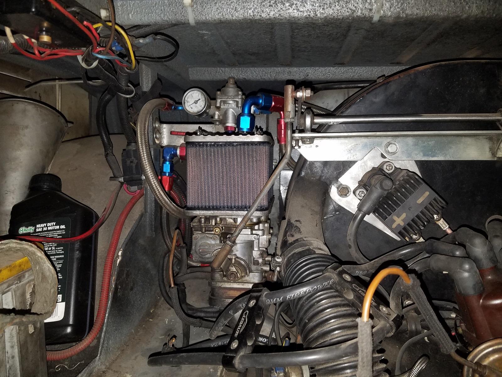

I ran my fuel line along the left frame rail so that I have the filter first out of the tank, over the trans and the elec fuel pump on the left frame rail just about over the axle. I drilled a hole in the vertical area just to the rear of that and mounted a Holley pressure regulator there with a 90 degree fitting for the supply, the left port for a gauge and the right port a barb to supply a T'd line to a pair of Kad's.
I would not want to put anything over the engine. I can't really as I spliced in a bay window access hatch. But for fire's sake, I would not put anything over the engine and by the fan would I want to suck it into the fan and then blow it all over the motor?
I had an Empi pressure reg that was not regulating too well and was also leaking fairly well. The set up above vas the version 2.0

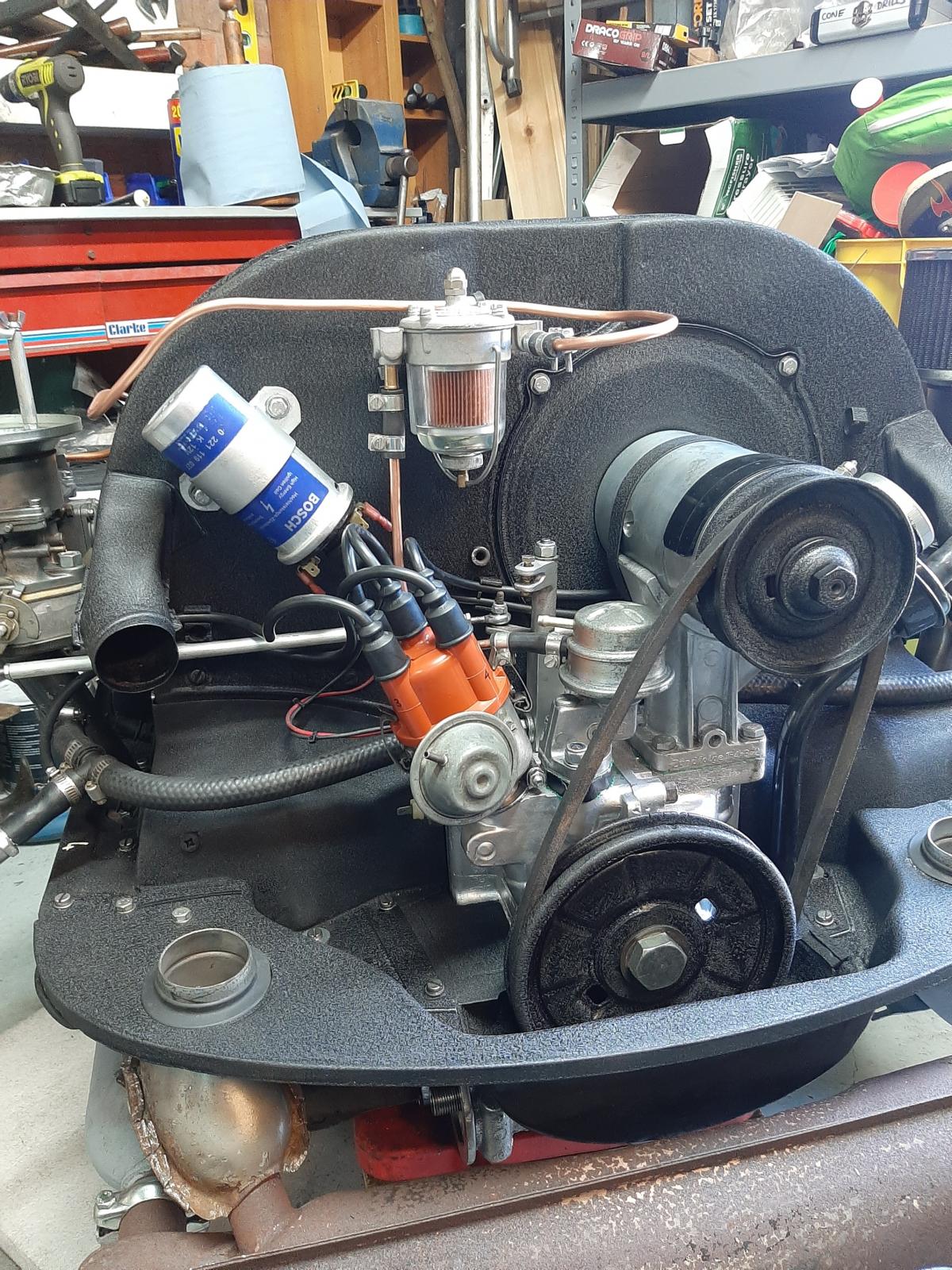

I just screwed my Malpassi Filter King straight to the Fan Housing using short fat self tappers - had no issues.
Homemade 6mm copper pipe Hard Line Kit into my Kadrons, using olives and BSP compression fittings straight into the carbs, soldered a T connector to the twin carbs behind the fan housing lip, just out of sight.
Ultimate goal was to minimise the amount of rubber pipe in in my fuel lines, and it also makes taking the engine out much easier, with only the Fuel Pump Inlet to remove.
