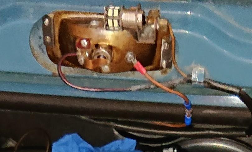

Hi Jim
No - I ended up making them from some flat metal bar drilled and tapped. They don't look brilliant and I keep meaning to make better looking ones, but they do the job so I haven't bothered.
I don't have a picture specifically of them to hand. This is cropped from another picture of the engine bay. You can get a better idea of what they're supposed to look like from that picture of the Bentley manual I posted on your Facebook question.

PostPosted: Wed Sep 21, 2022 12:10 pm    Post subject: Re: Source for centre brake light threaded plate? (211 945 327) Reply with quote
Thanks Andy,
I've got one to copy, so I'll do that I guess.
Geeking on your photo of your engine lid. Mine has holes for the bolts to pass through and the plate goes on the underside of those holes. I see yours hold the light unit by trapping the edge of the housing. So if you used OG plates I suspect that they wouldn't do the job.

PostPosted: Wed Sep 21, 2022 1:15 pm    Post subject: Re: Source for centre brake light threaded plate? (211 945 327) Reply with quote
That's just my bad, blurry photo. Very Happy The flash has cast shadows that make it look like the reflector is sitting in a hole the same size and shape as the reflector, but the hole in the outer skin is more oval and slightly smaller than the reflector.
The screws pass through the holes in the decklid, then through corresponding holes in the reflector and in to the threaded plates.
As the screws are tightened, they pull the threaded plates tight to the back of the reflector sandwiching it between the plates and the inside of the decklid.
My DIY plates are probably a bit wider than the originals too, so they oversail the edge of the reflector on the back.
Any chance you could measure your OG plate when you get a chance? I had to take a guess on the size when I ordered the metal strip.

Edit I've installed it wrong. Embarassed Looking at this thread, the reflector should go outside the decklid. https://www.thesamba.com/vw/forum/viewtopic.php?t=...p;start=60
When I got it, it was fitted on the inside with speednuts, so I assumed that was where it should go.
Next time i have it apart, I'll fix that.

PostPosted: Wed Sep 21, 2022 2:44 pm    Post subject: Re: Source for centre brake light threaded plate? (211 945 327) Reply with quote
ah, both the buses here had it in the wrong place as well. I was looking at it and thinking if VW designed it to go like that they would have put captive nuts directly on the housing and not bothered with the spreader plates.
Then someone found me a photo from and early manual and it shows it as I thought it should be.
I'll measure up the spreader plate later this week after the seals turn up.

PostPosted: Wed Sep 21, 2022 11:46 pm    Post subject: Re: Source for centre brake light threaded plate? (211 945 327) Reply with quote
Yeah, that was me. I didn't bother to look it up in the manual. Embarassed I just followed what a previous owner did. It seemed more leak-proof too, so made sense at the time.
