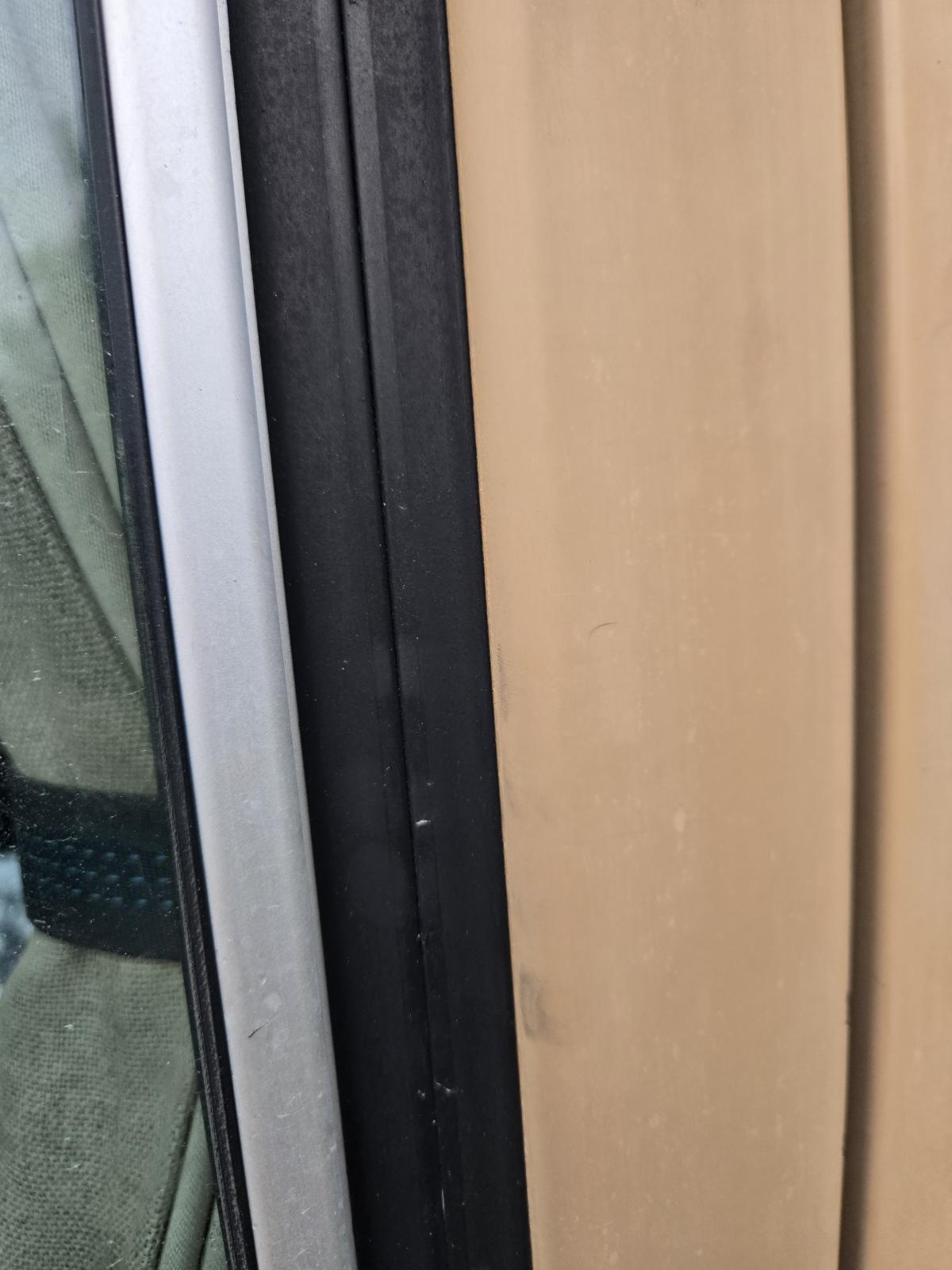

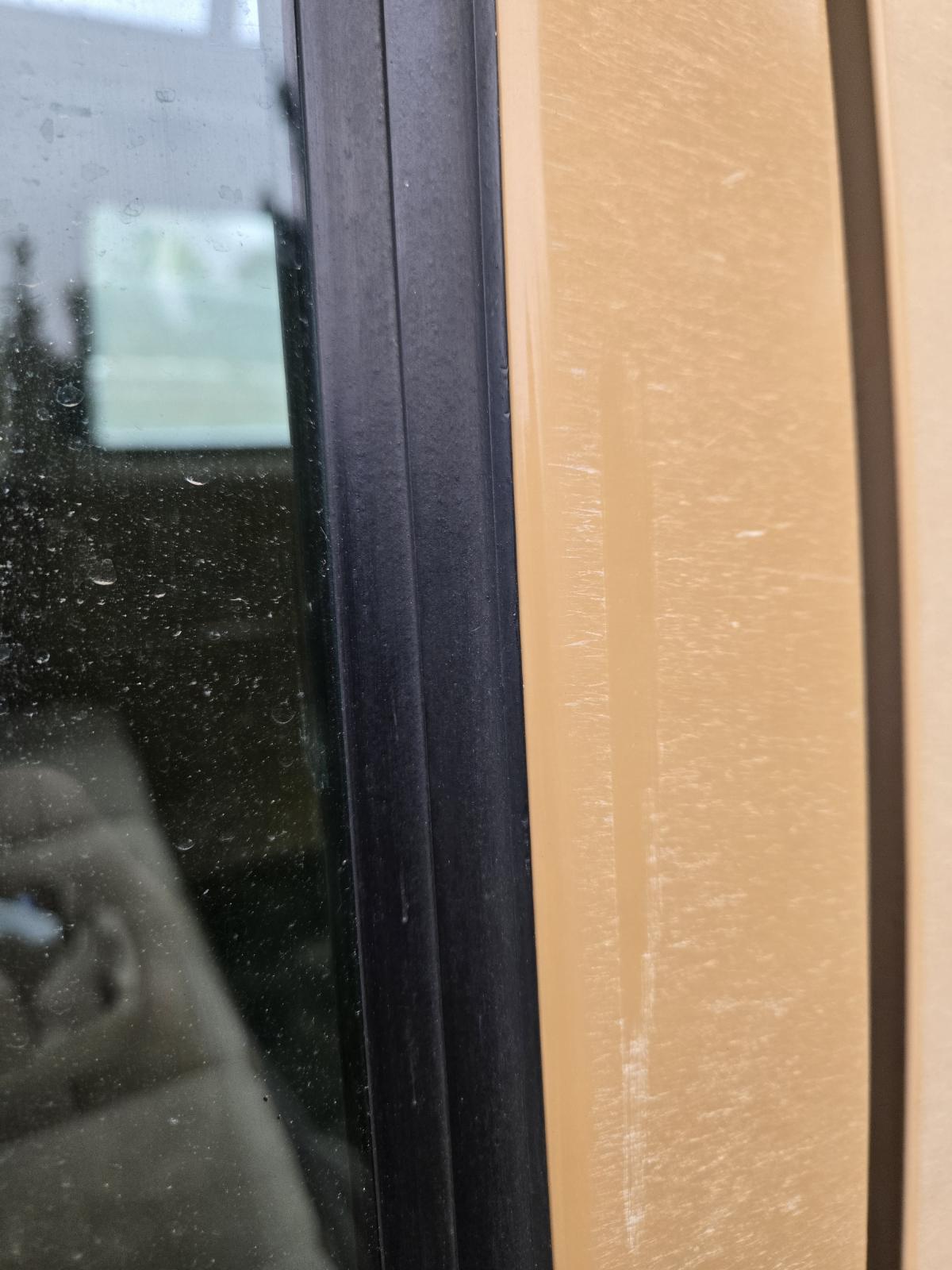

Any replacement window seal won't be exactly like the oem in fit or finish. Sure they work fine, but nothing is like the original. With the chrome strip removed, the seal basically 'closes up' and the gap disappears over time. You could always pull a side and see how you like it. No foul if you're going to be replacing them with inferior seals anyways.
Here's a BusDepot replacement
And a factory pulled trim. The 'gap' is smaller than the pic highlights.

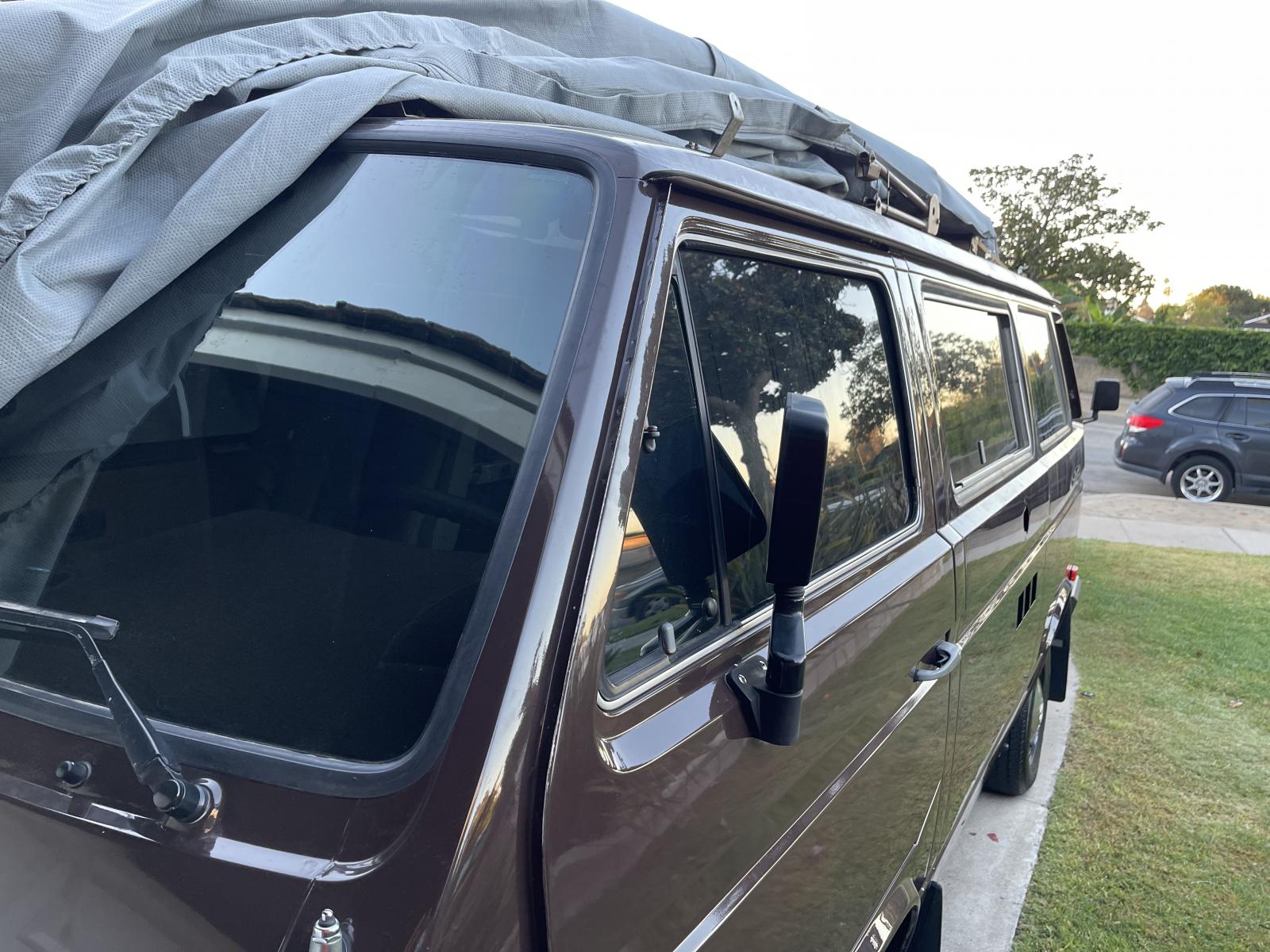

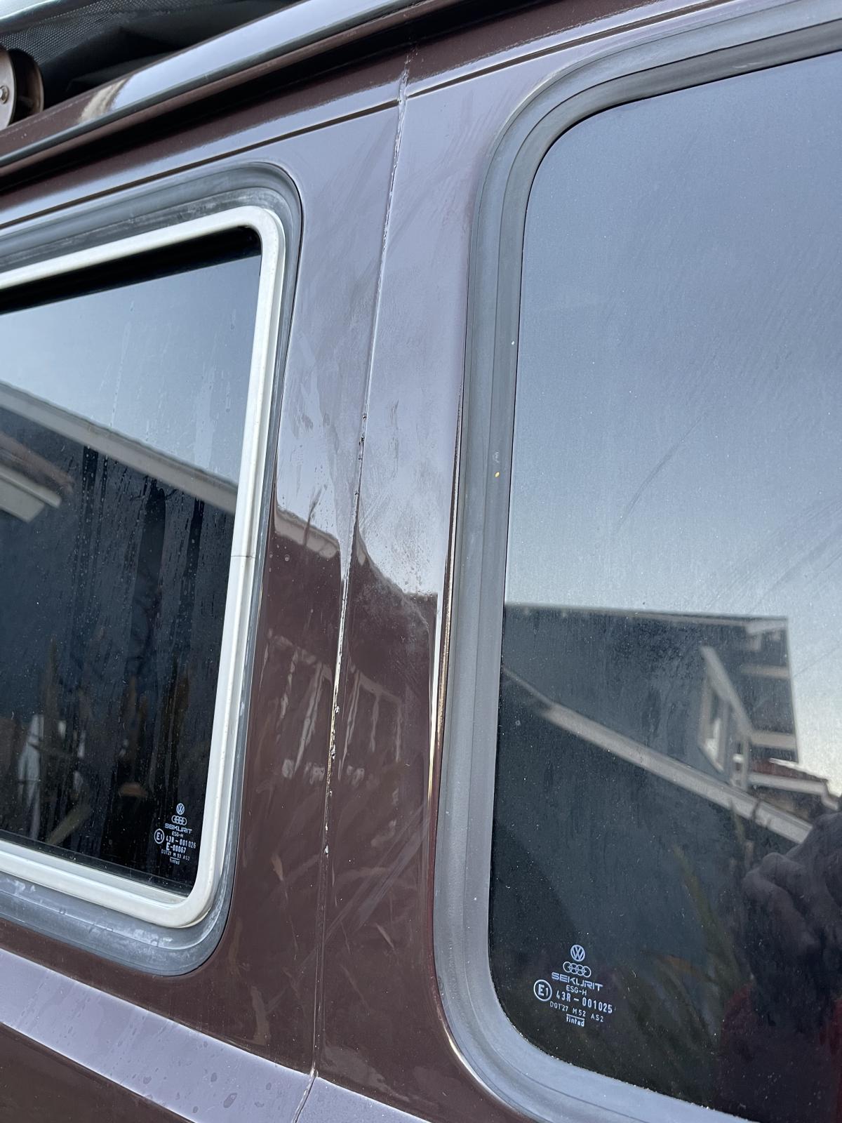

Hey Wellington, I feel the same way… I have a bit of the OCD in me too.
I just had my glass guy over on Monday to help me reinstall all windows with new German seals w/o groove from GoWesty. My glass guy is who used to service the Vanagon shop in Costa Mesa California that closed down last year.
He told me that these seals were very nice. Some of the other types of seals, he has to trim to make them fit correctly.
I did all windows except for the driver and passenger doors for now.
