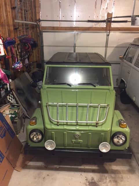

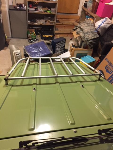

I knocked this rough draft together as a concept for a customer. I've fixed the bar alignment (after taking these pics), so everything is now symmetrical. What do you guys think?

It looks nice. My concern though is anything stored/carried on it would block your view...sort of like the people who mount a tire on the hood. Our hoods don't slope enough to emulate the Type 82. I did see one of the Domeck bros. had a hood with a tire that fit down in it. Along those lines, could you drop the front and rear support bars lower so the slats came nearer to the hood? Just a thought.

Love the look, wonder about the functionality.
Leery of cargo heading towards windshield as well as the vision issue mentioned earlier.
Bet it would be loud in the wind.

Looking to your design, I like the idea that it is an actual rack that holds luggage off the sheet metal. I would make the standoffs shorter though, so that the rack sat just a 1/4 to 3/8 inch above the sheet metal, to keep everything as low as possible. I would add a rail along the front and sides to keep things from wanting to slide off the front. I would also tighten up the radius of the front corners of the rack if possible. In the event that you might actually want to put a suitcase there, which will likely be rectangular, it will be a more efficient use of the space.

The uprights are 2' on the Beta. I may try to take it down to 1' but it would endanger the paint when installing bungee cords/tie-down implements. I had envisioned a 'spider-bungee net'' covering the load surface with small eyelets for hooks.
I used all steel for this mock-up, but the actual rack will have 2 1/2' oak slats that are recessed into the frame so that the wood surface will be ever so slightly higher than the frame. It will look really clean! I plan to make a run of matching rear racks with wood slats, too. Nothing beats a matching set!
Captain Spalding may be right. I'll reconsider the additional rail.
I had The Thing Shop's hood bar for years, but it was essentially a huge hood ornament. I'm not knocking it... I simply think we can do better.
