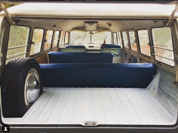

These photos are showing how the bus looked like when we bought it in Oktober 2017.
This is “Eve” our 1967 VW Bus– she received her name from a previous owner in honour of Eve Muir, the wife of famous John Muir. He wrote the popular book “How to Keep Your Volkswagen Alive: A Manual of Step-by-Step Procedures for the Compleat Idiot”.
About the bus:
It Is a Type 2, Model 251 Bus. That means the bus has 13 windows and all the deluxe trim. Additionally our bus is equipped with a short middle seat (2-seater) and it has the walk through option. Our Volkswagen Bus has been produced in Germany in May, 1967 and was delivered to San Francisco. It spent the following 50 years in California, had a short stop in the Netherlands and now Eve found a beloved home at our place in Vienna. Together with my father, I will work on the bus to make it roadworthy here in Austria.

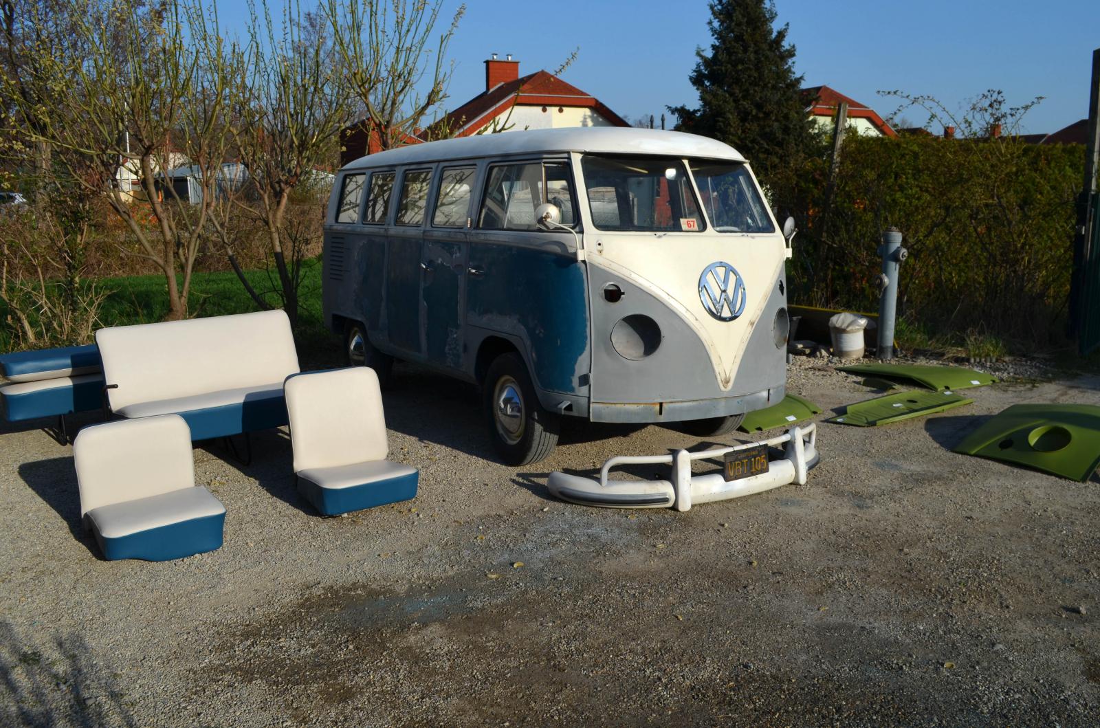

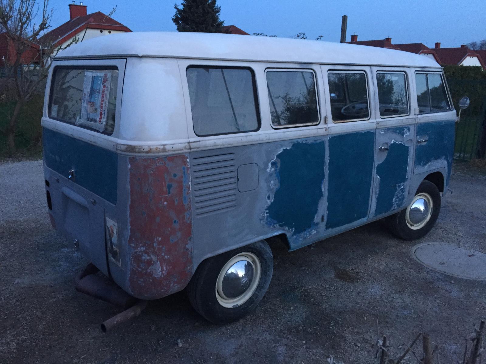

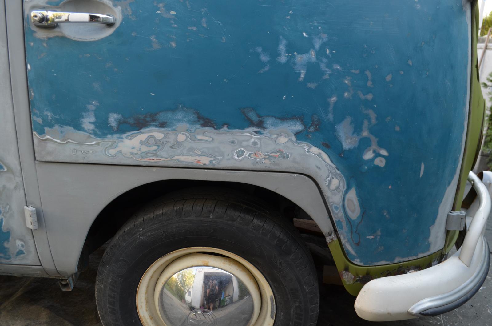

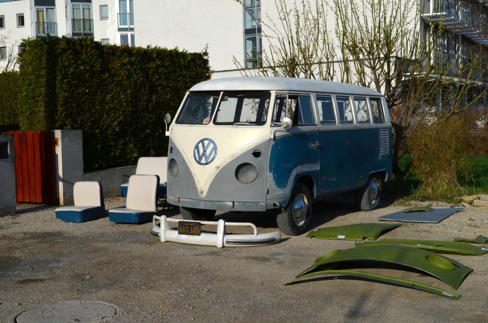

Condition before our partial restoration - 2017
So as we will be doing a partial restoration soon, i wanted to show you the areas that need body work and replacement metal sheets as well as other attention.
All of those pictures have also been taken in Oct. / Nov. / Dec. 2017:

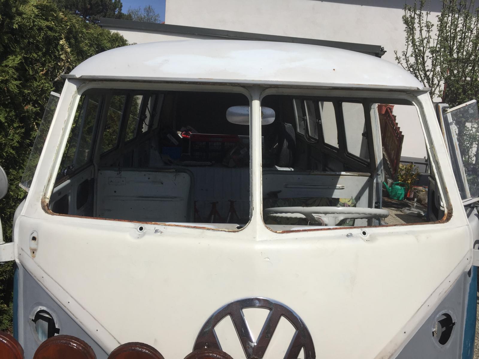

A big project will be the front as well as the a-pillar and the doors plus the driver cabin floor. As you can see in the following pictures, our bus had a damage on the front - mostly hit at the area below the headlight of the drivers side.
It has been fixed back in the days, but not perfect. The A-pillar is still not positioned correct and so the driver door is not closing as it should. We already took the measurements and it is approved that the distances are wrong.

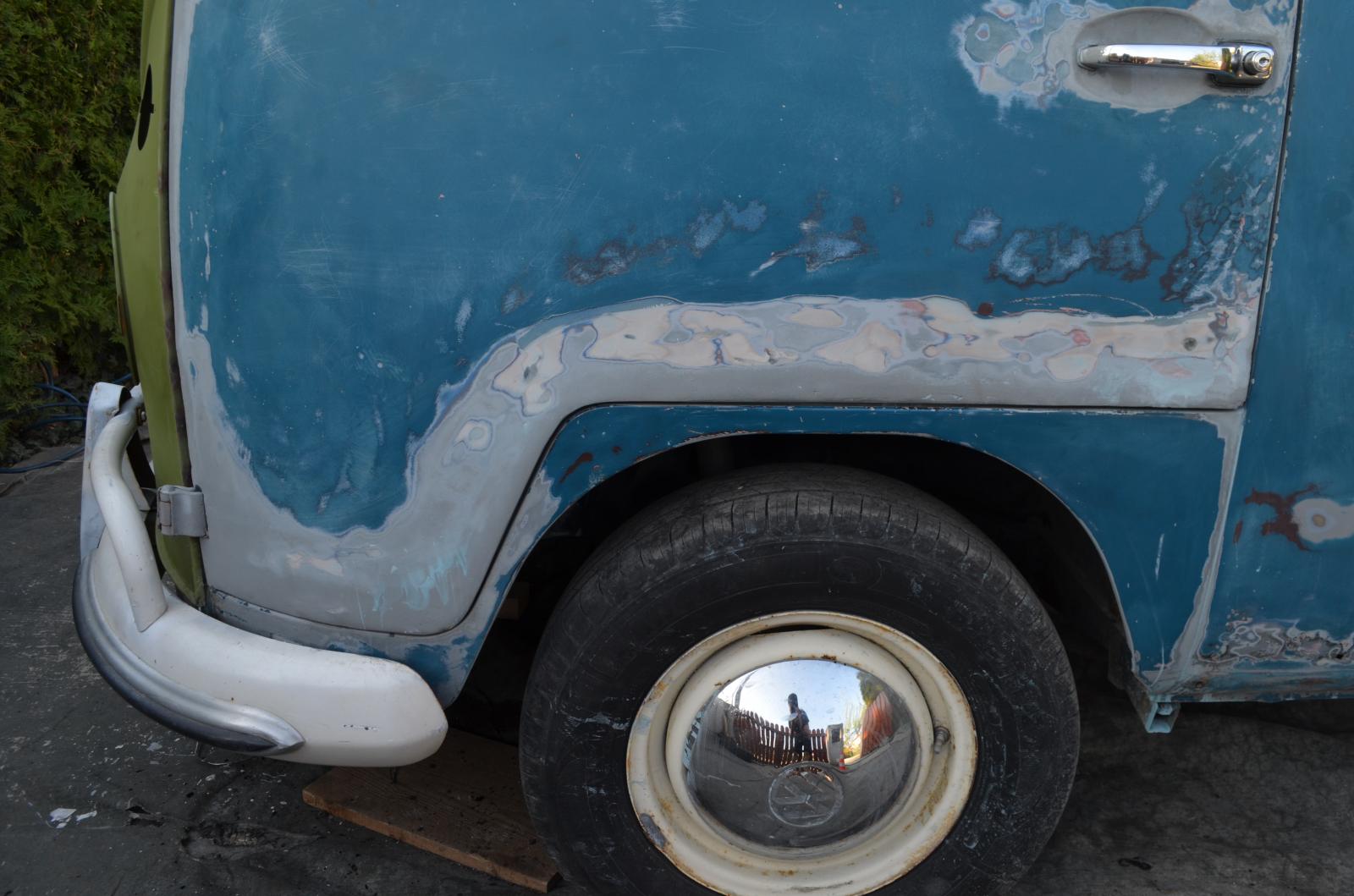

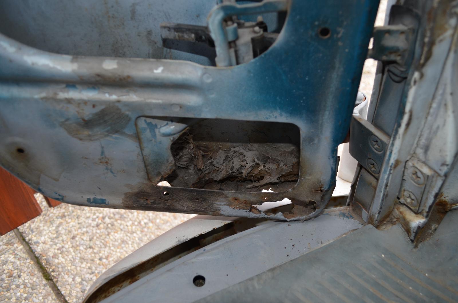

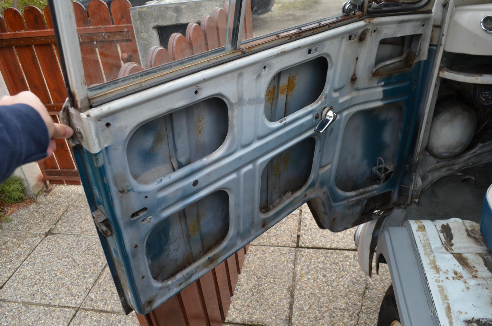

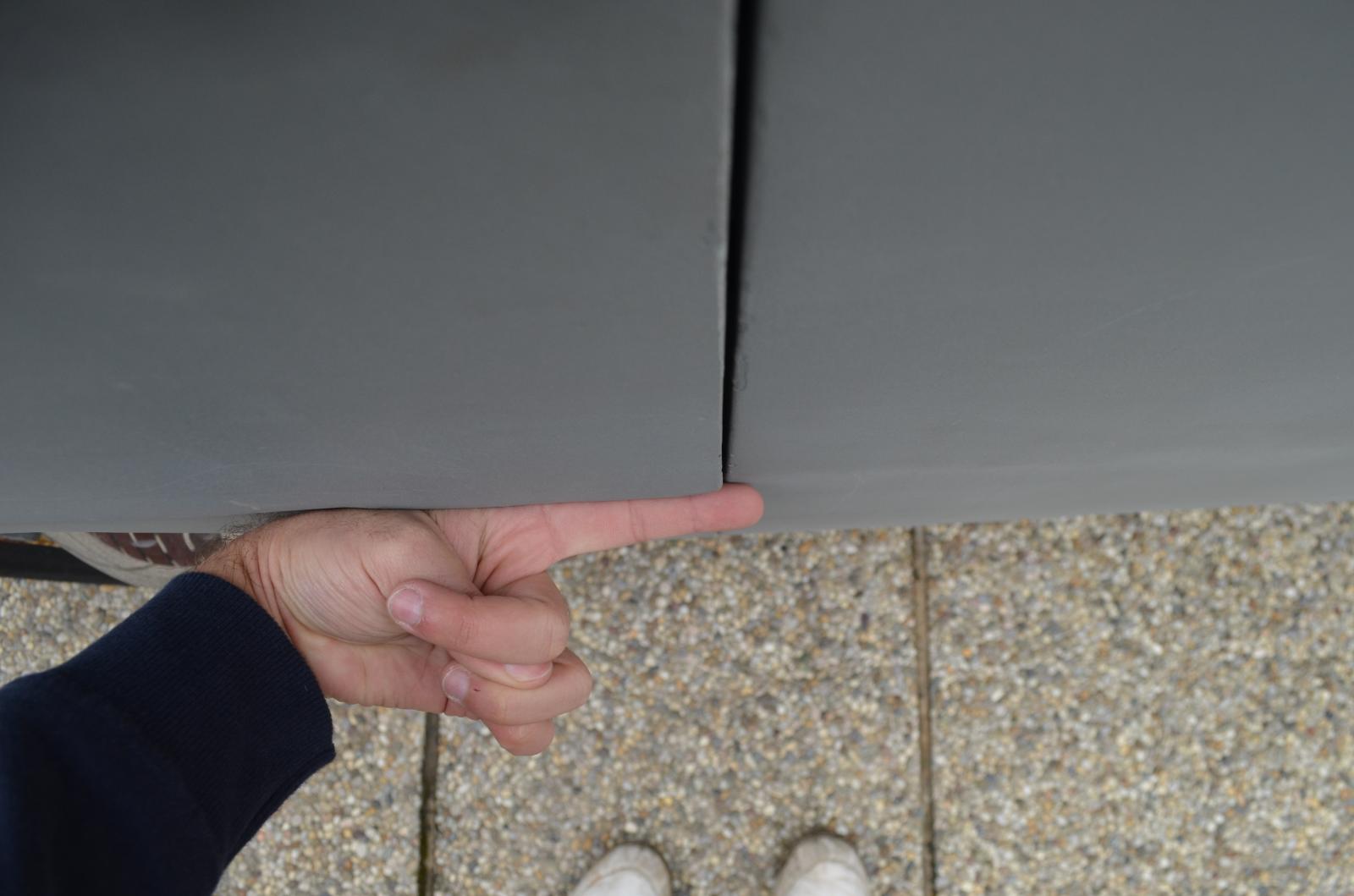

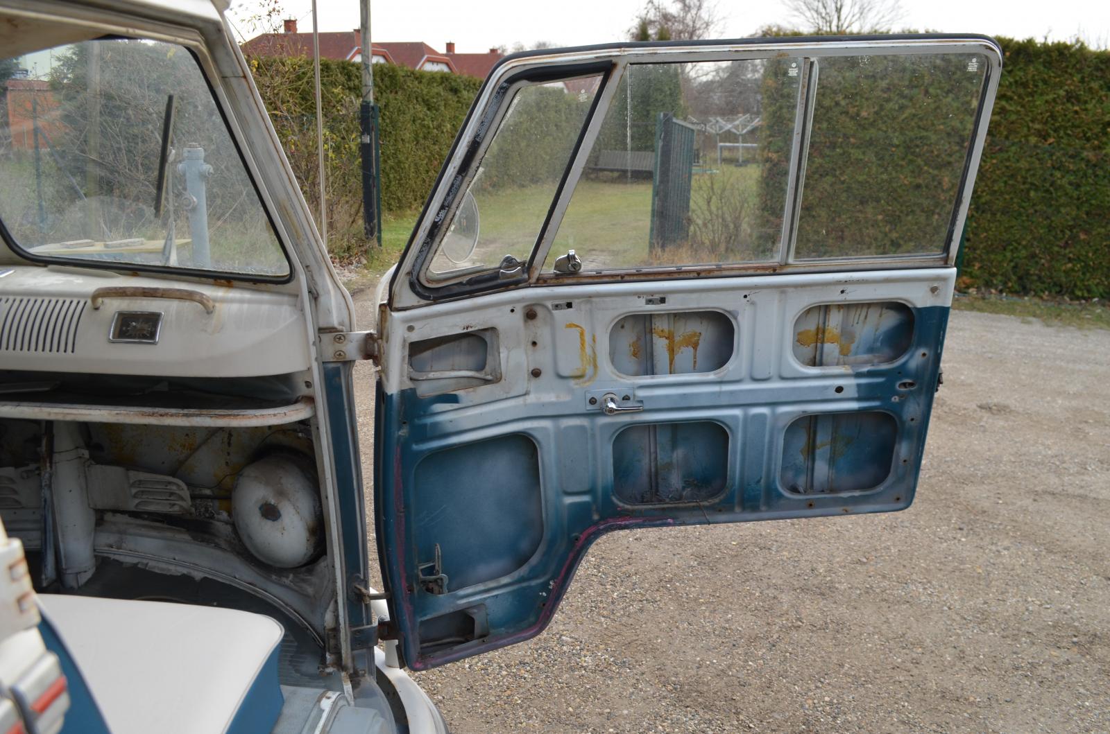

Driver door:
Lower 10 cm will be replaced. Lots of bondo and other kind of provisional and easy fixes.
Co-driver door on the right side:
Is in slightly better condition, but here the dogleg will be replaced and also the lower 10cm of the door need attention.

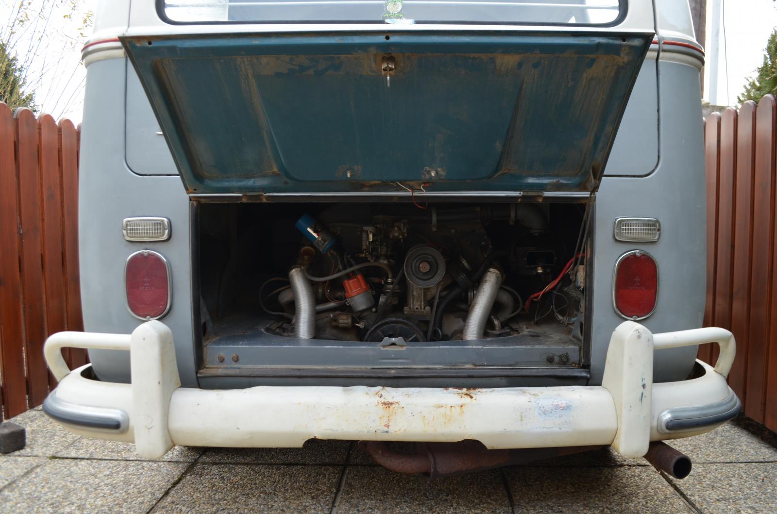

Engine is good, runs. Lid still showed the original sea blue paint on the inside.

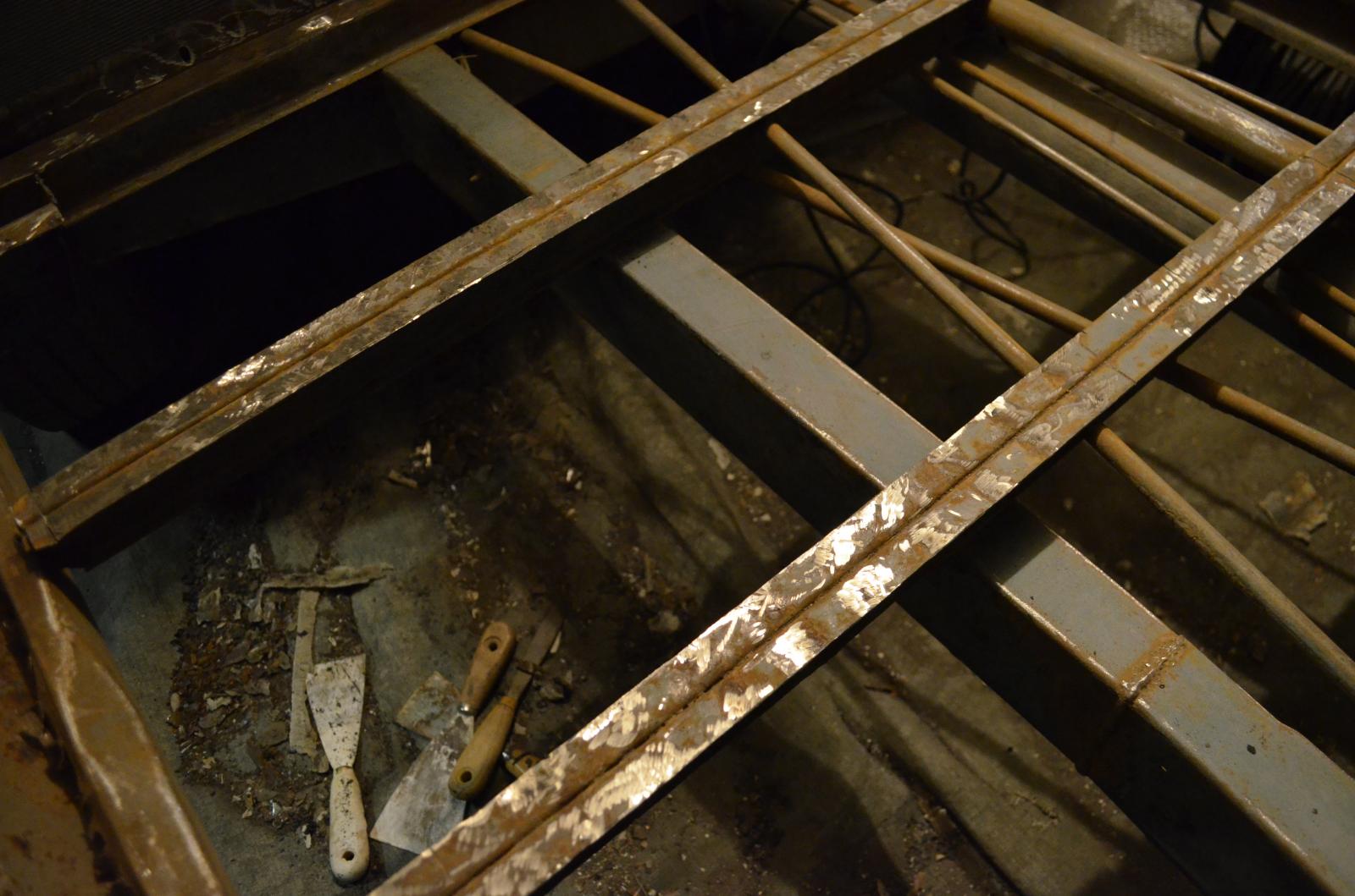

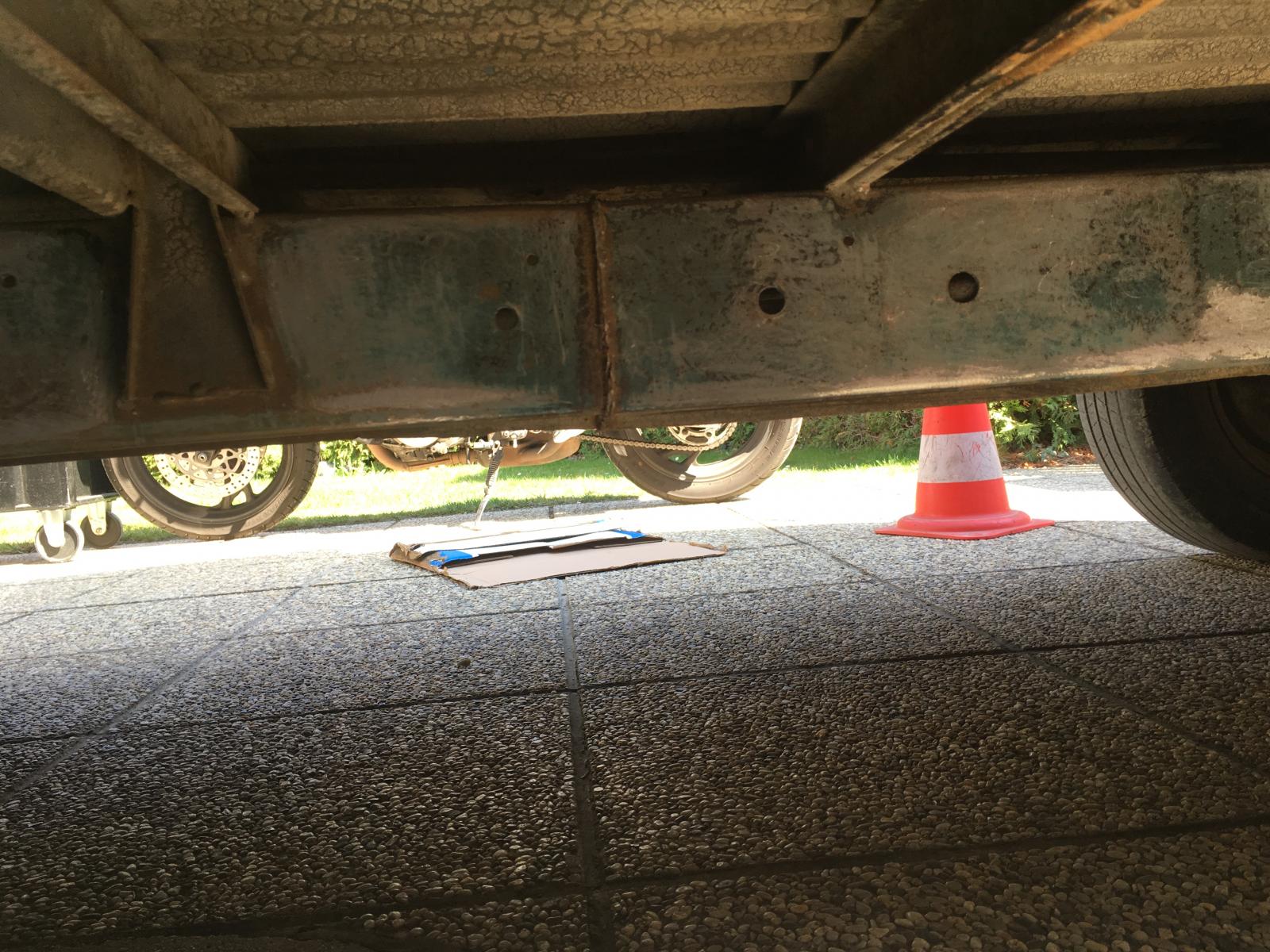

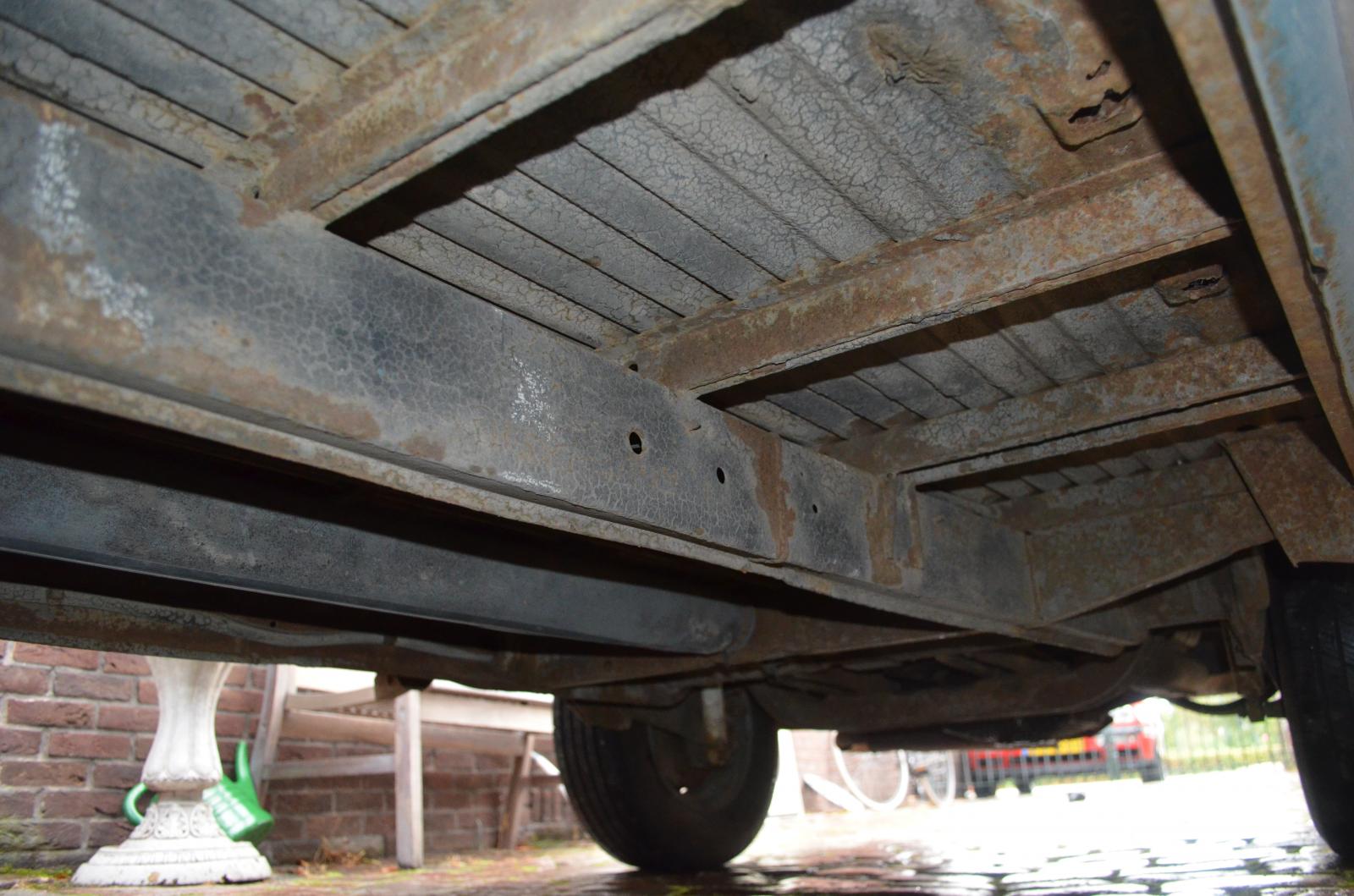

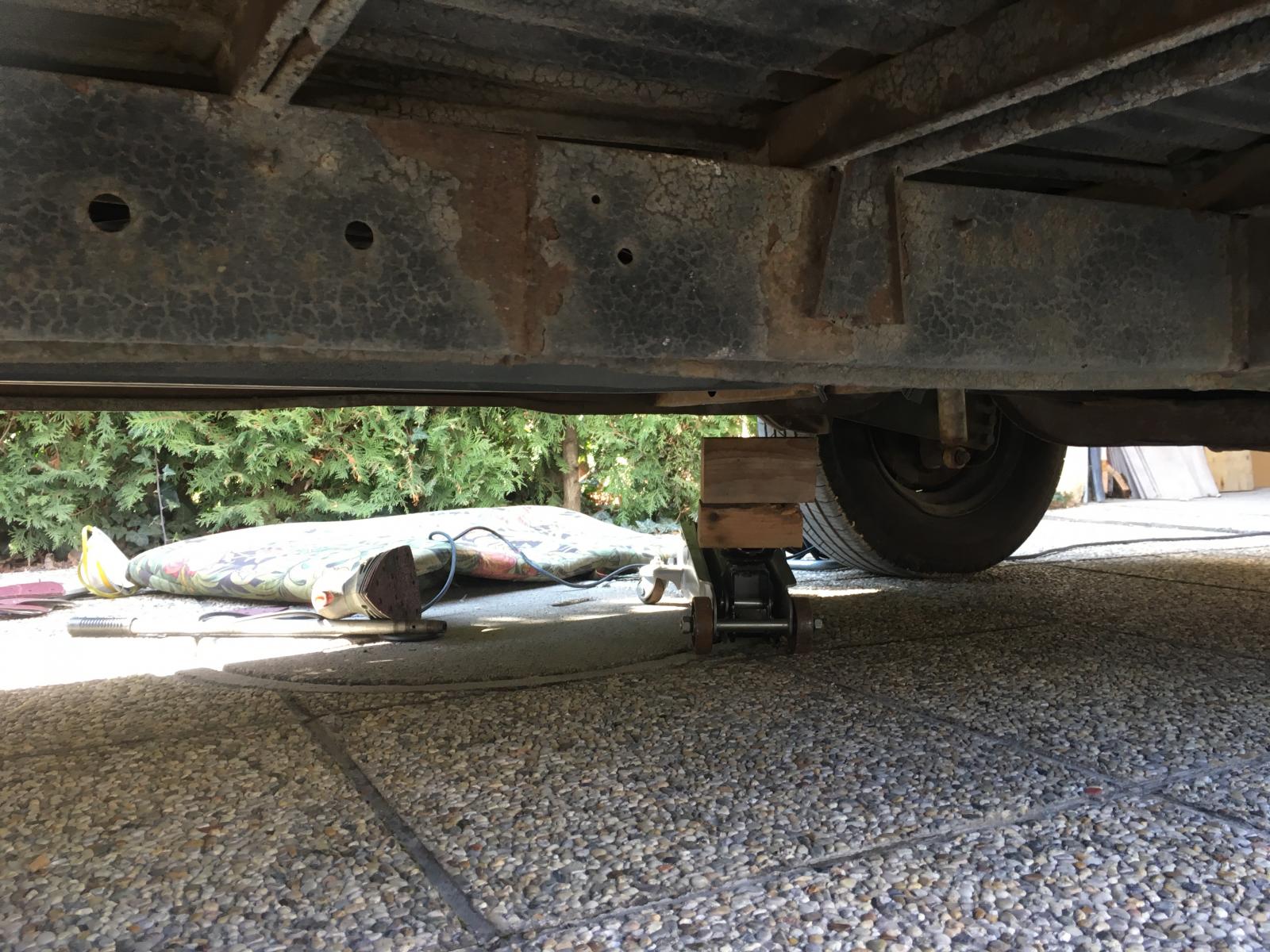

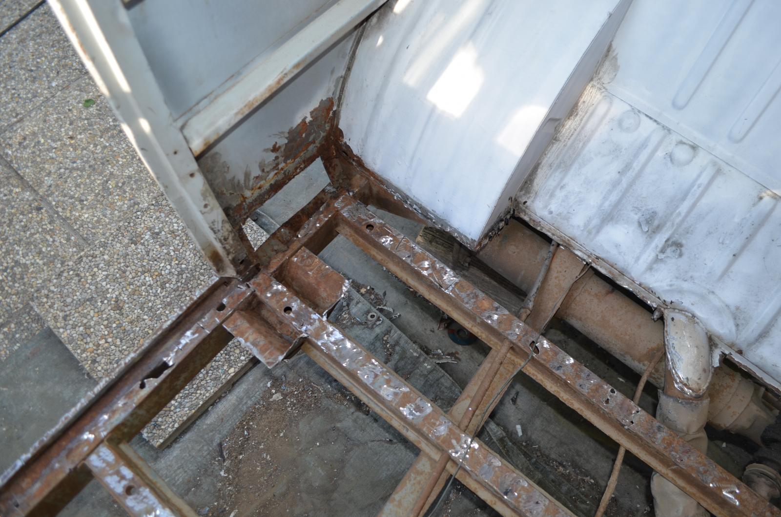

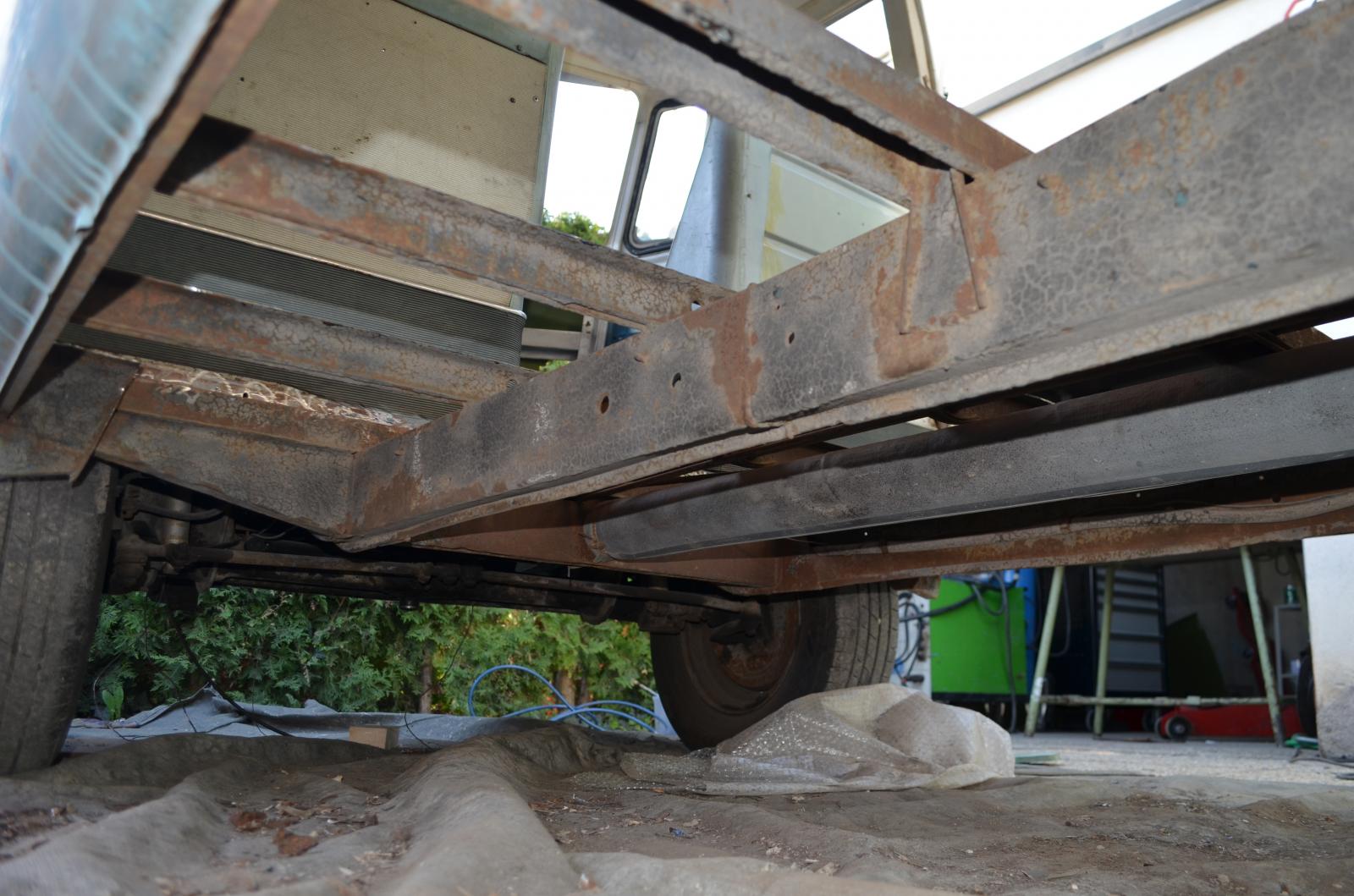

The bottom - view from underneath:

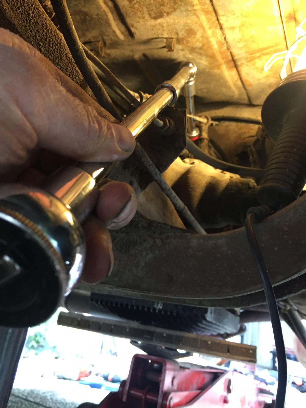

the crossbars still look solid, we will sand them and cover them with rust protection. But most likely we will replace the entire passenger floor with new metal parts. as some areas were badly fixed - for example the areas around the seat mounts:

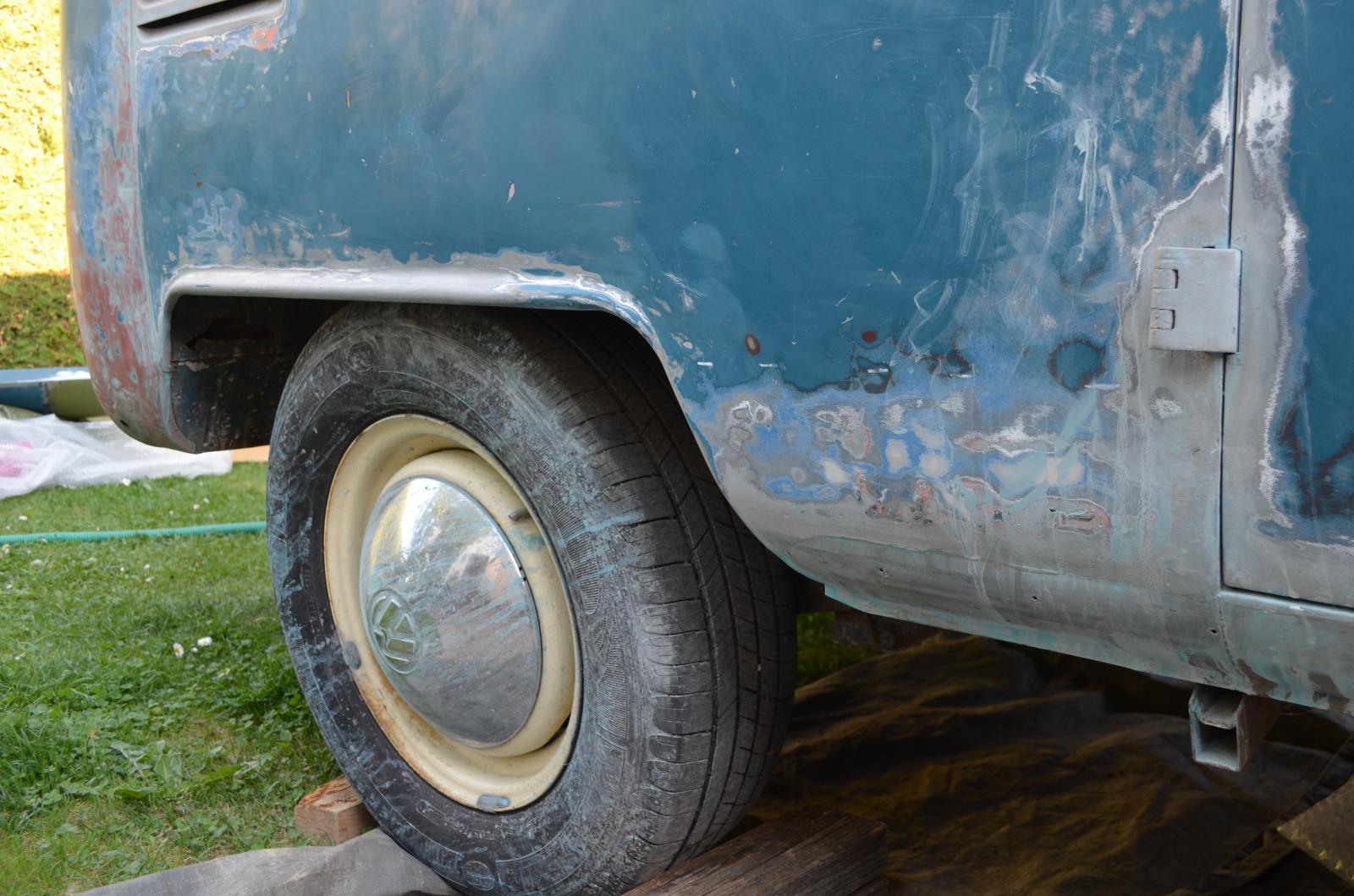

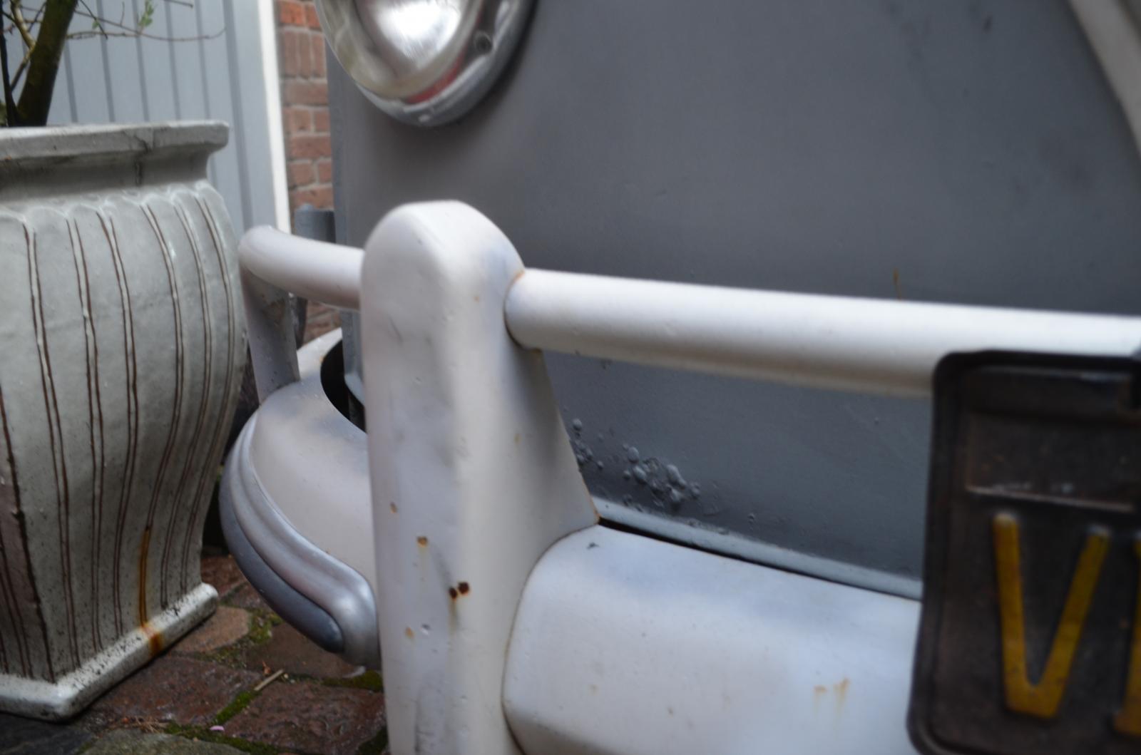

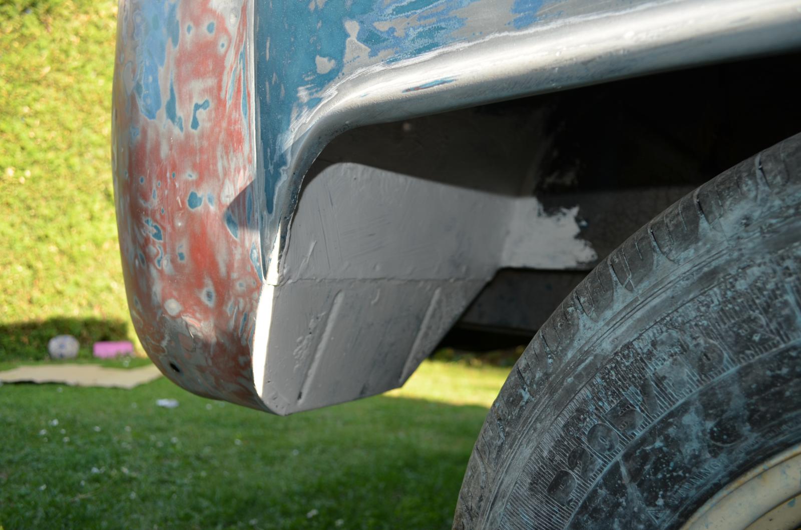

Rear fender on the right side will also need some little body work.

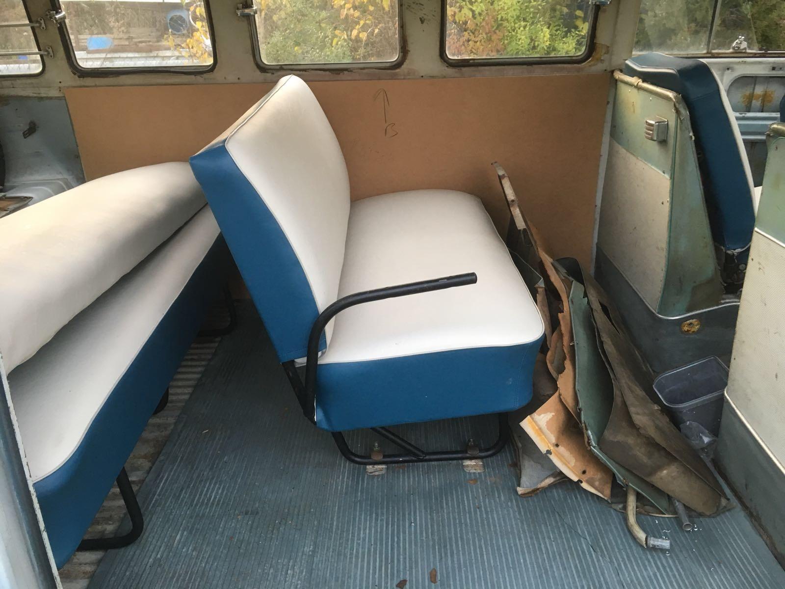

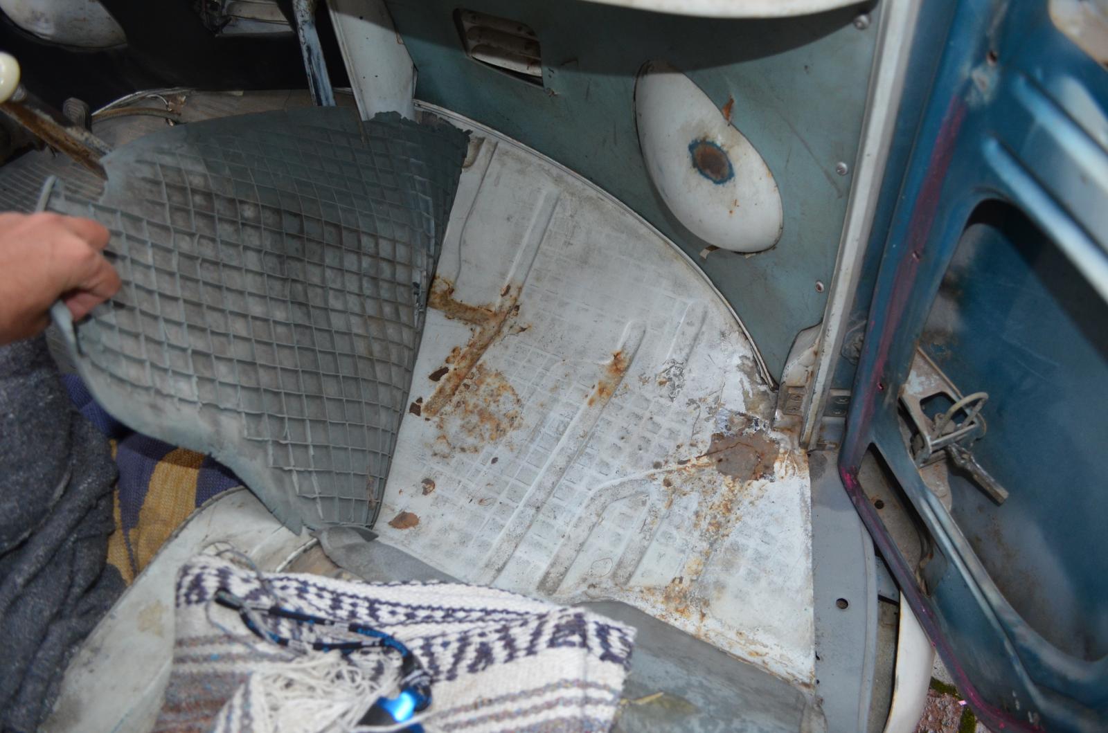

Interior.

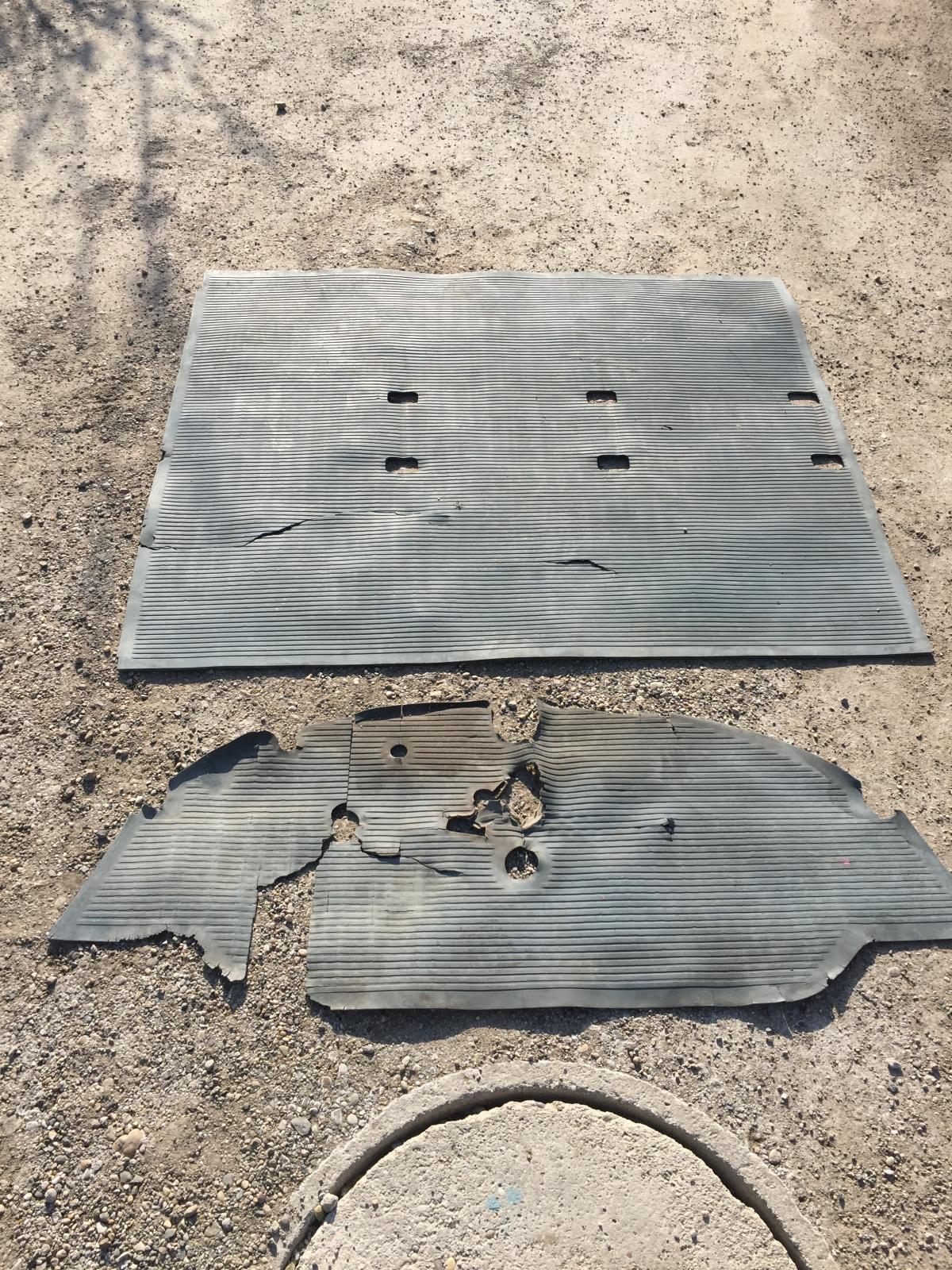

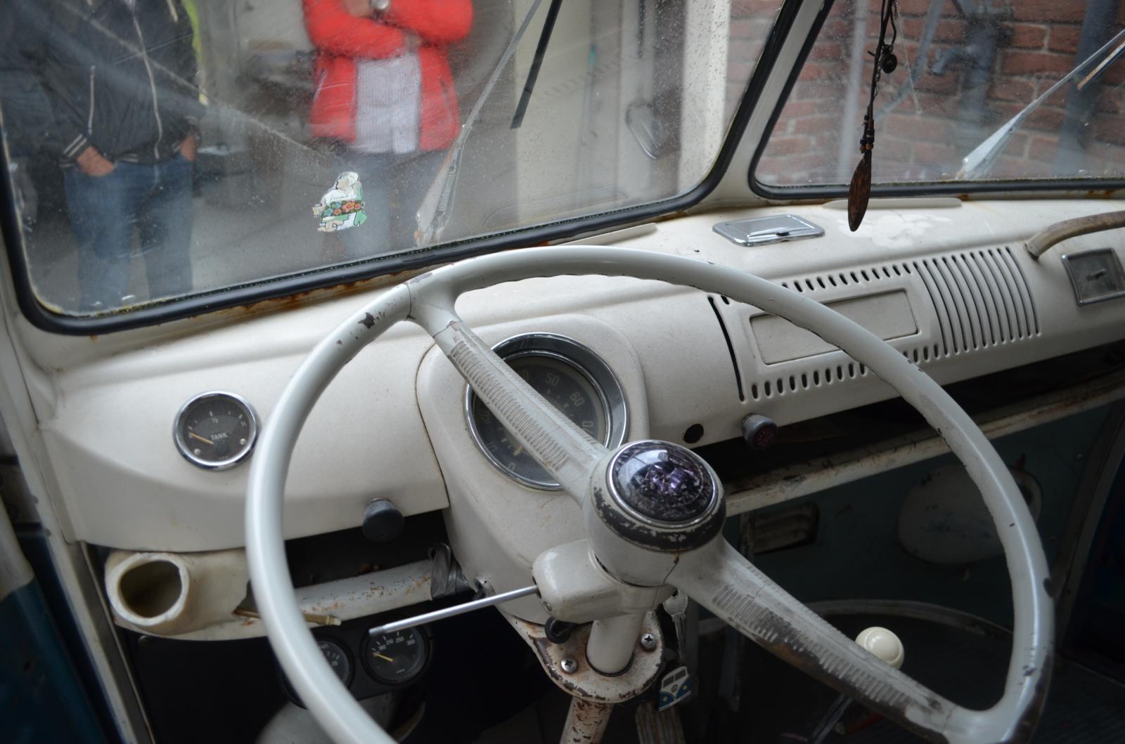

Our bus came with all the original accessories. Such as the light blue rubber mats on the floor and the rare short middle seat bench. The original aeropapyrus interior panels are still there, but they are faded out and will be done new. The previous dutch owner did a new upholstery to the seats. As aeropapyrus facbrics were not available anymore, he decided to choose a blue hue that comes close to the original sea blue paint.. well at least he tried. But we are happy that we have new done seats! And we already bought the same fabrics that the seats were made with, and we will do the interior panels in the same colors.

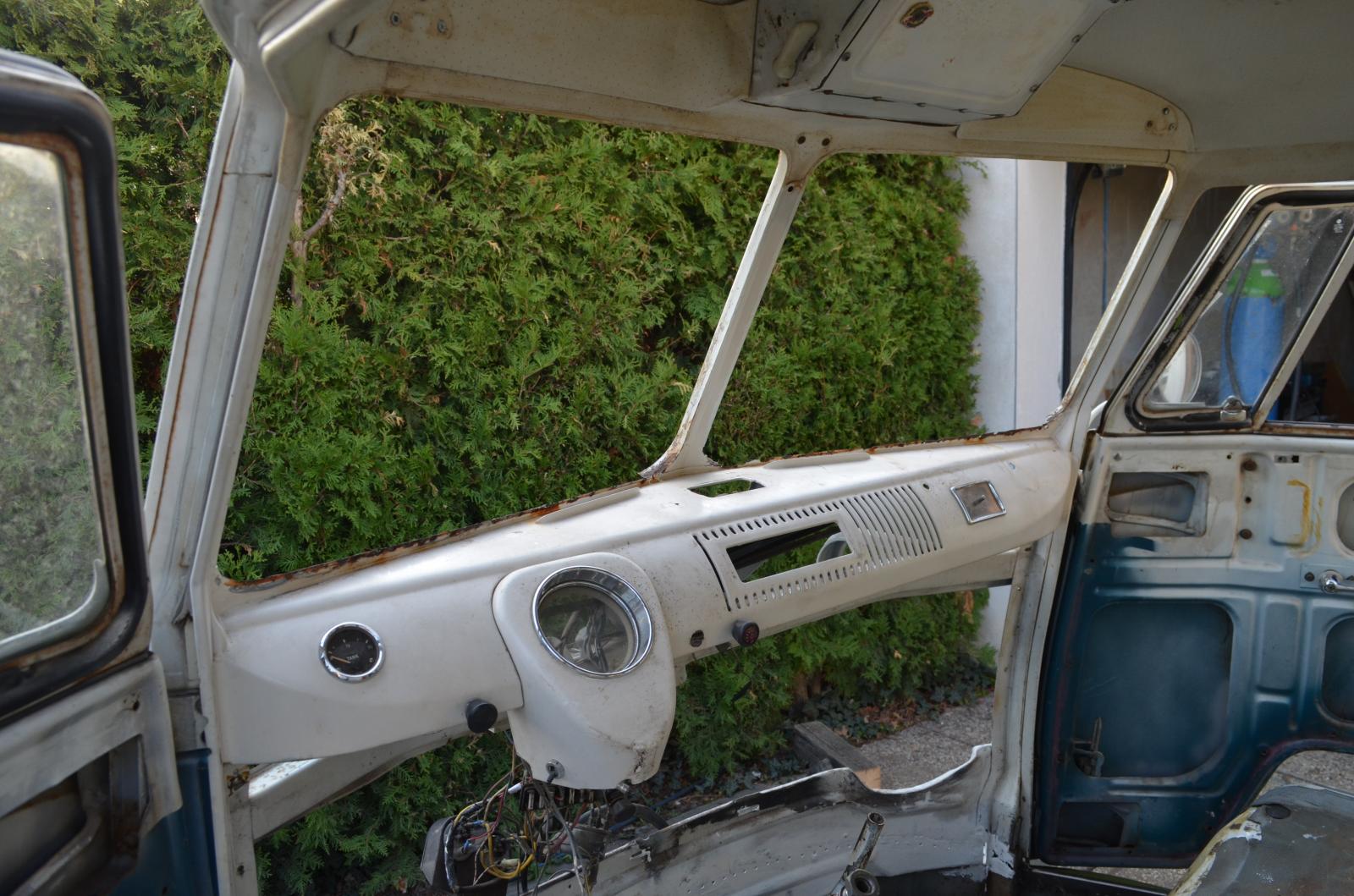

The dashboard looks good. The steering wheel is in very used condition. The horn bottom is very damaged as well as the water box for the wiper. In general lots of tiny work has to be done here.
The windscreen windows are not original anymore - no Sekurit glasses.

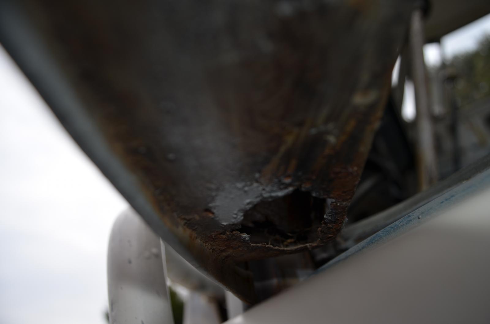

I guess the lower parts of the window frames will need an replacement too, looking quite rusty and have been glued, so i couldn't remove them that easy at first try.
But i am glad, that all the other windows are SEKURIT ones. They will also need new seals, but thats peanuts compared to the other work that is upcoming! Here is a picture of a pop-out window on the right side:

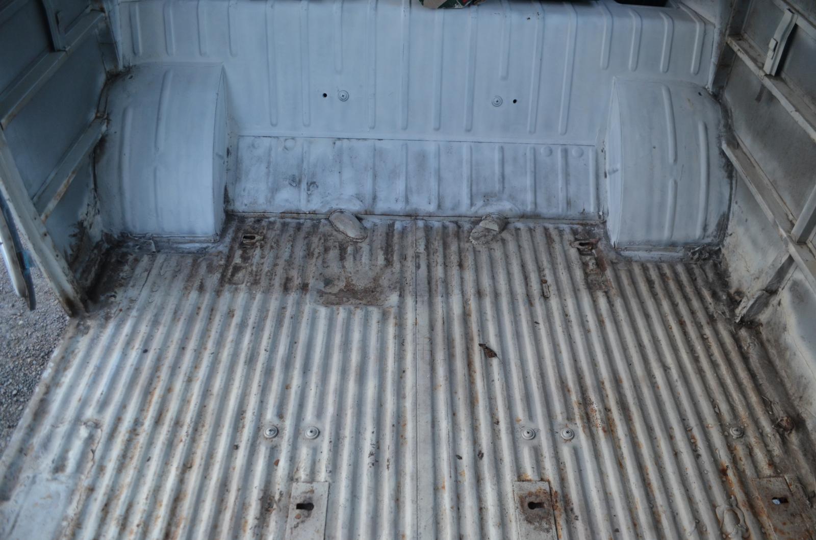

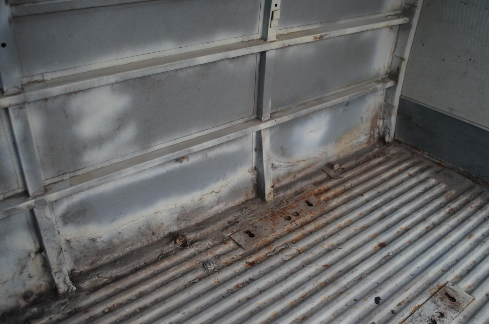

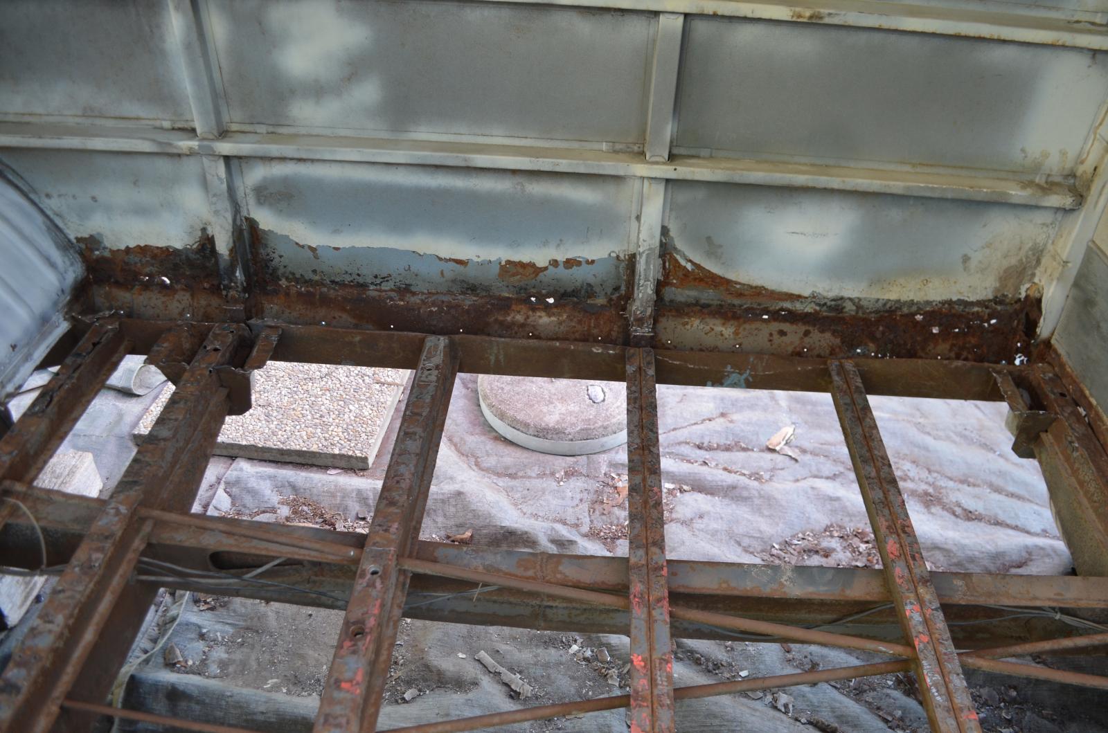

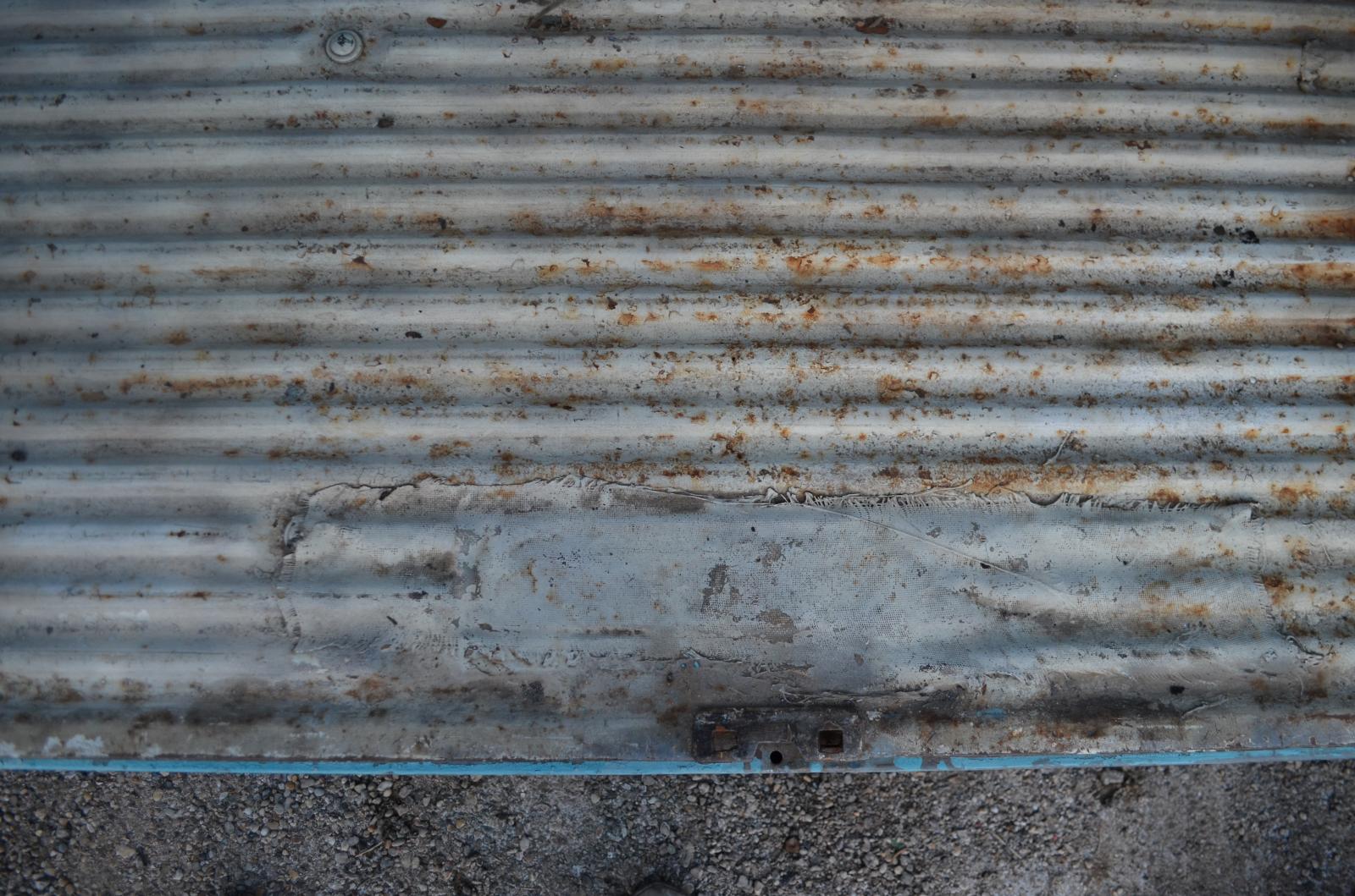

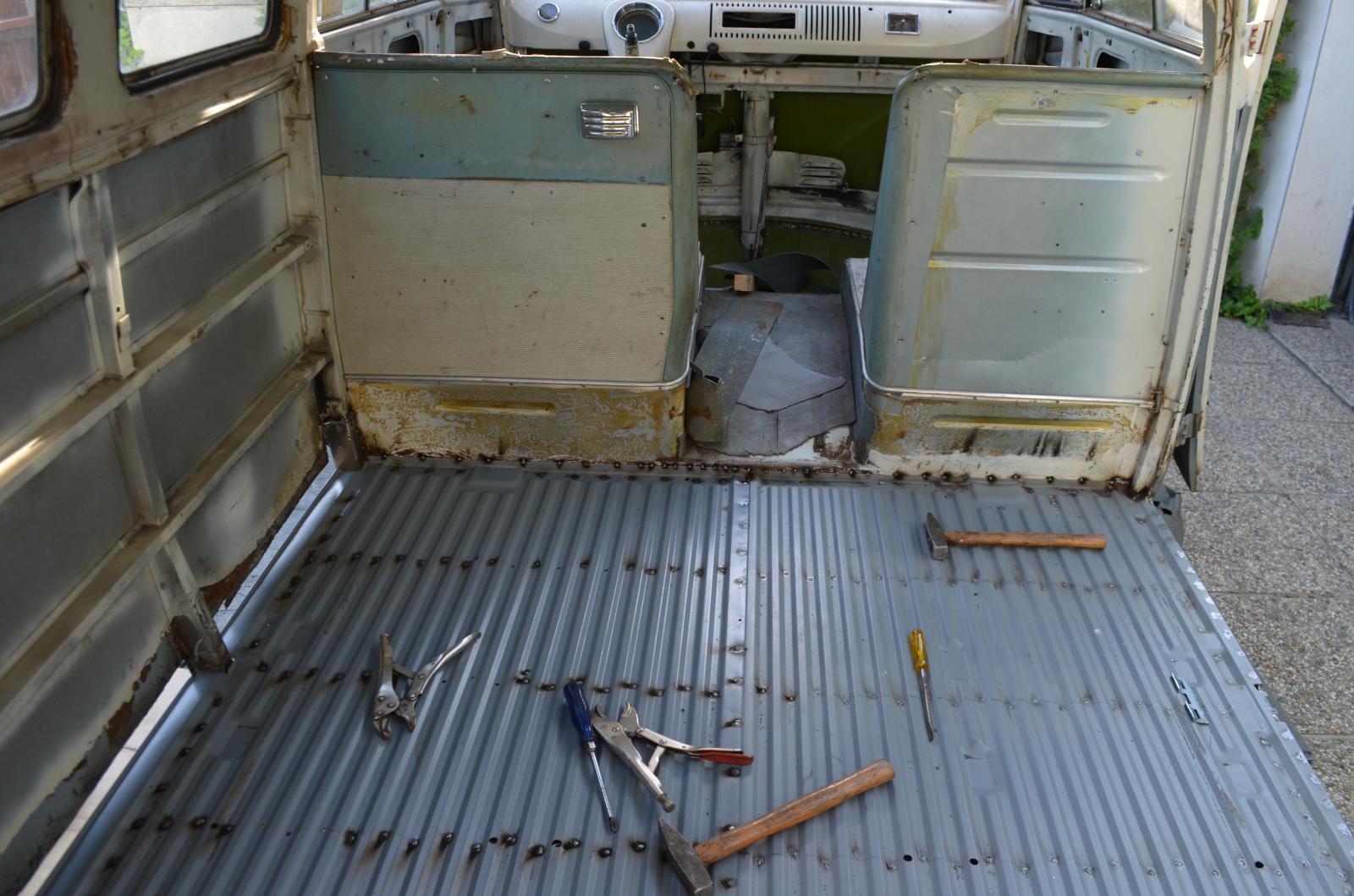

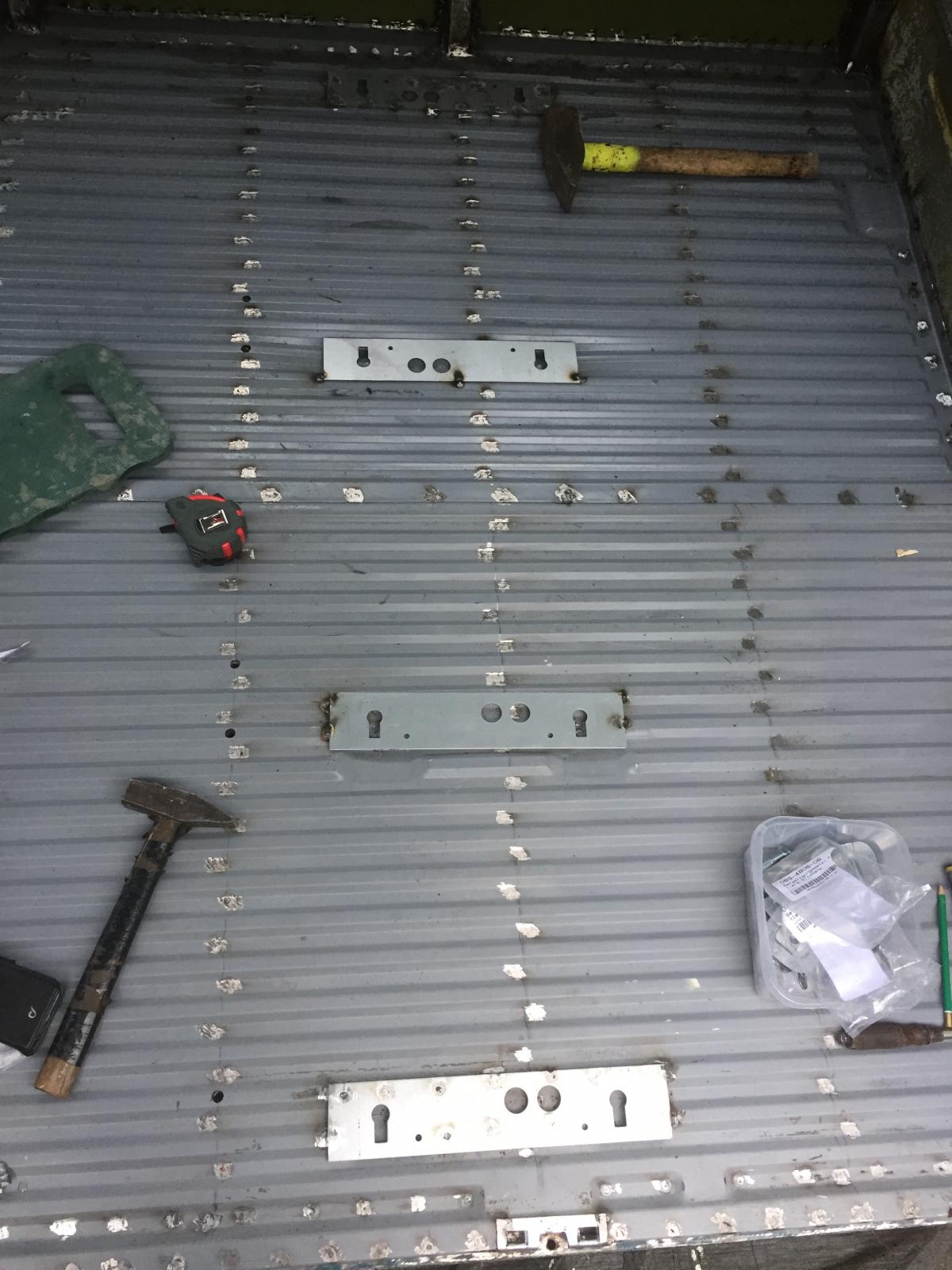

More pictures showing the condition of the passengers / loading area:
You can spot several bad fixes on the floor..

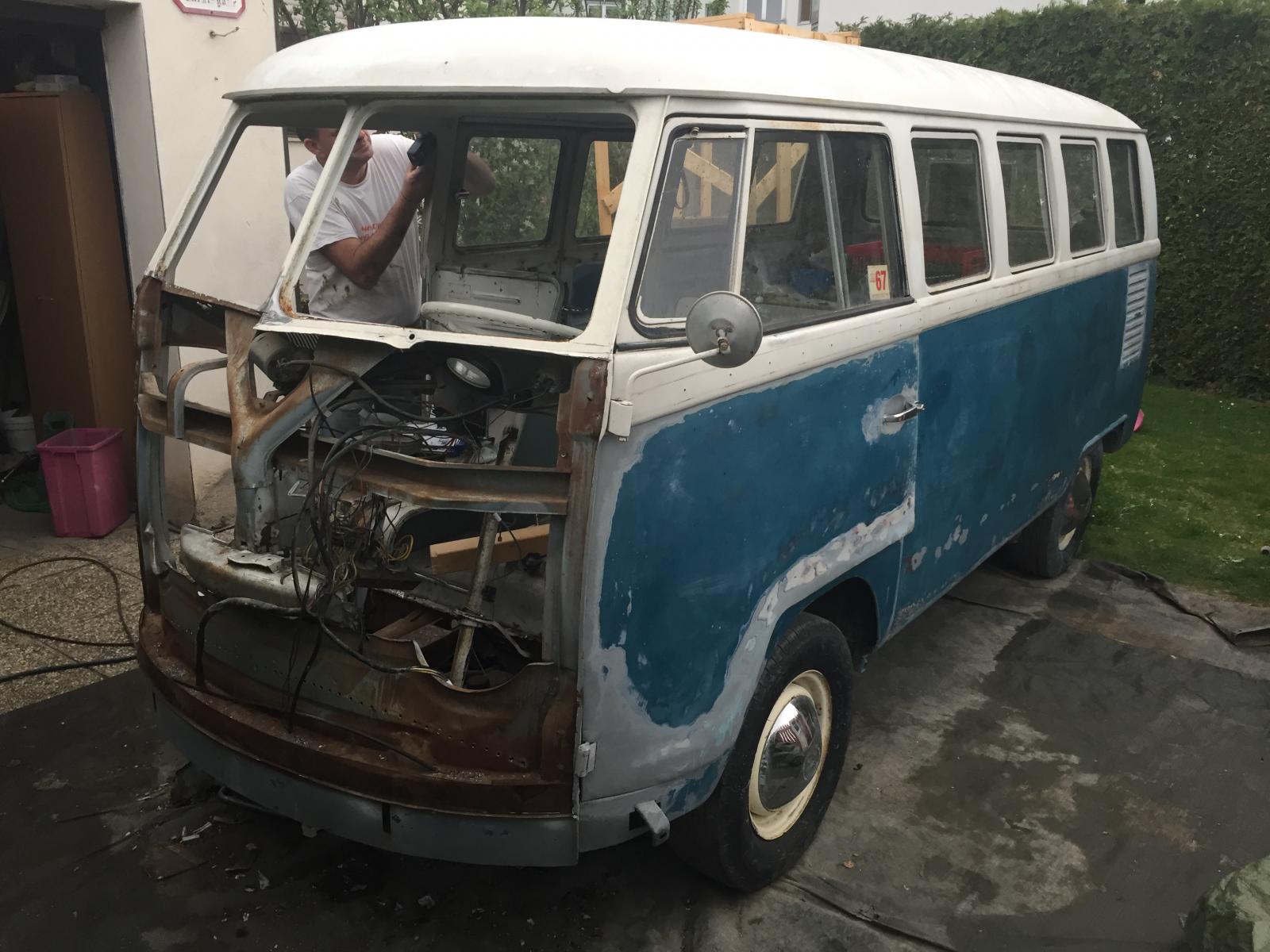

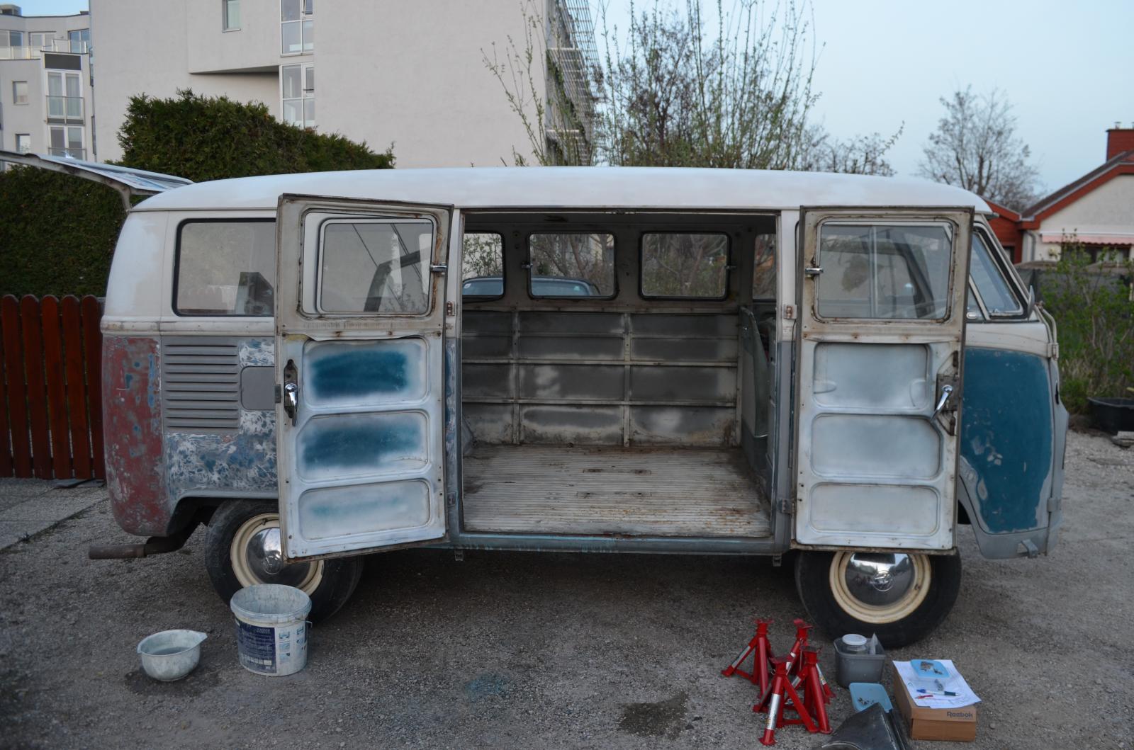

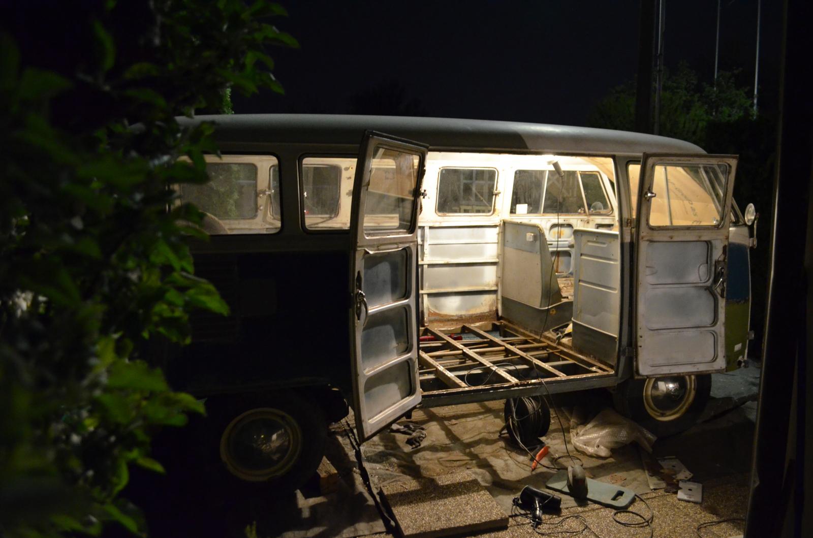

As this is a father-son-project - here is some of the work that we did last week:
removing rust and dirt from the bars underneath.
Bringing back the original paint to surface - current state:
Still lots of work to do!

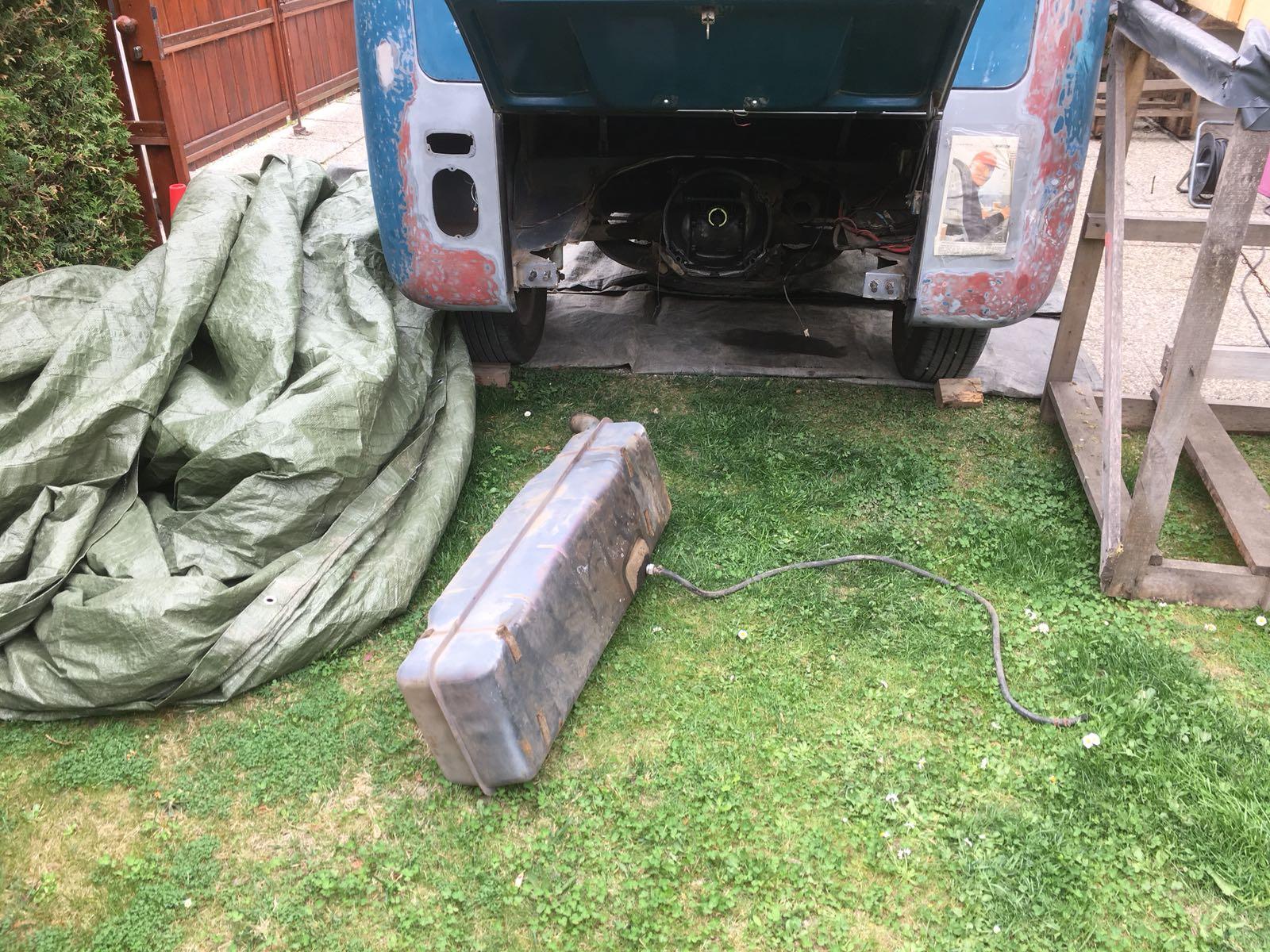

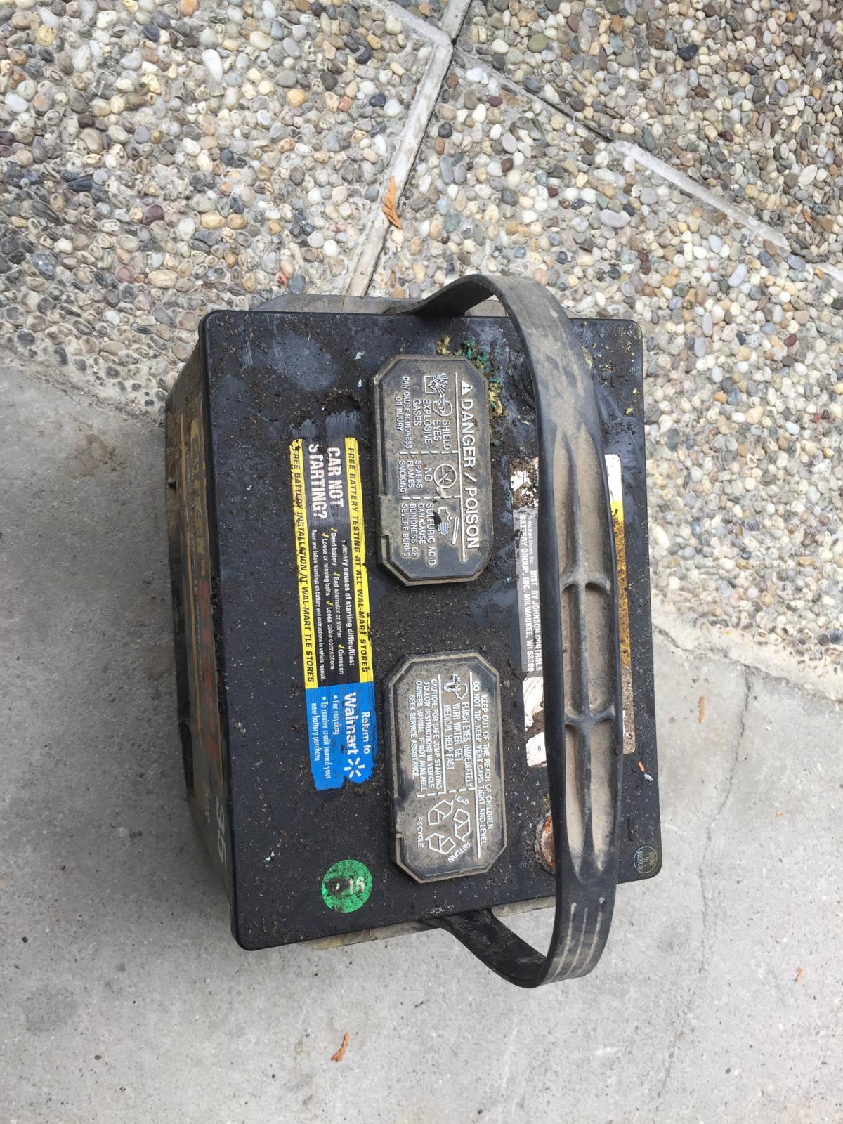

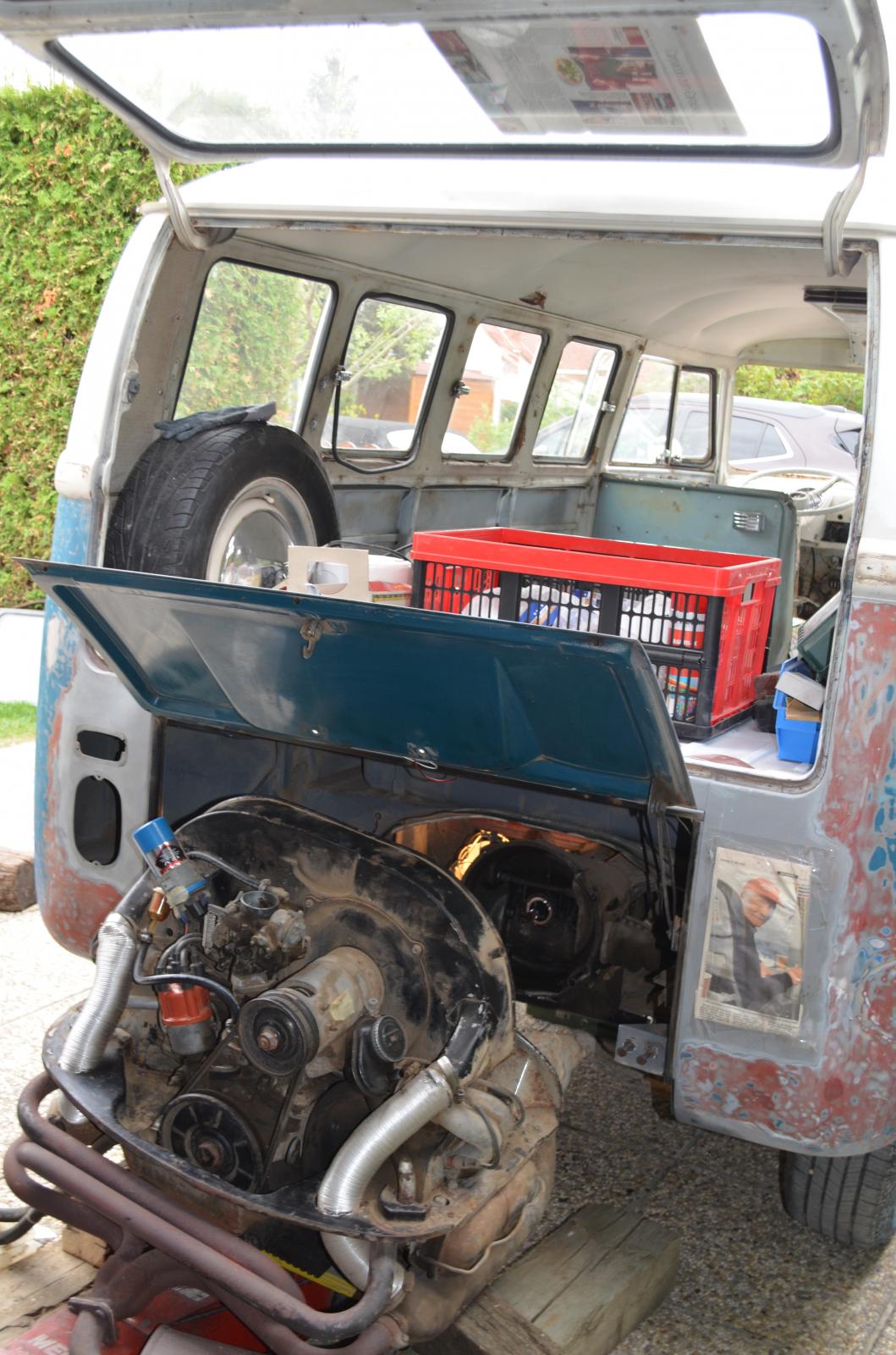

Removing head lights, indicators, interior.
Removing the engine, and gas tank.
Does anyone know where the closest Walmart to Austria is?
The blue sticker on the battery says we have to remove it to Walmart. Very Happy

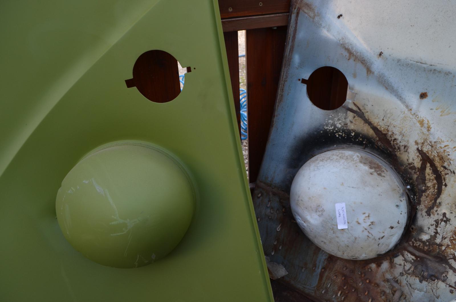

And last but not least two pics with some of the replacement metal parts:

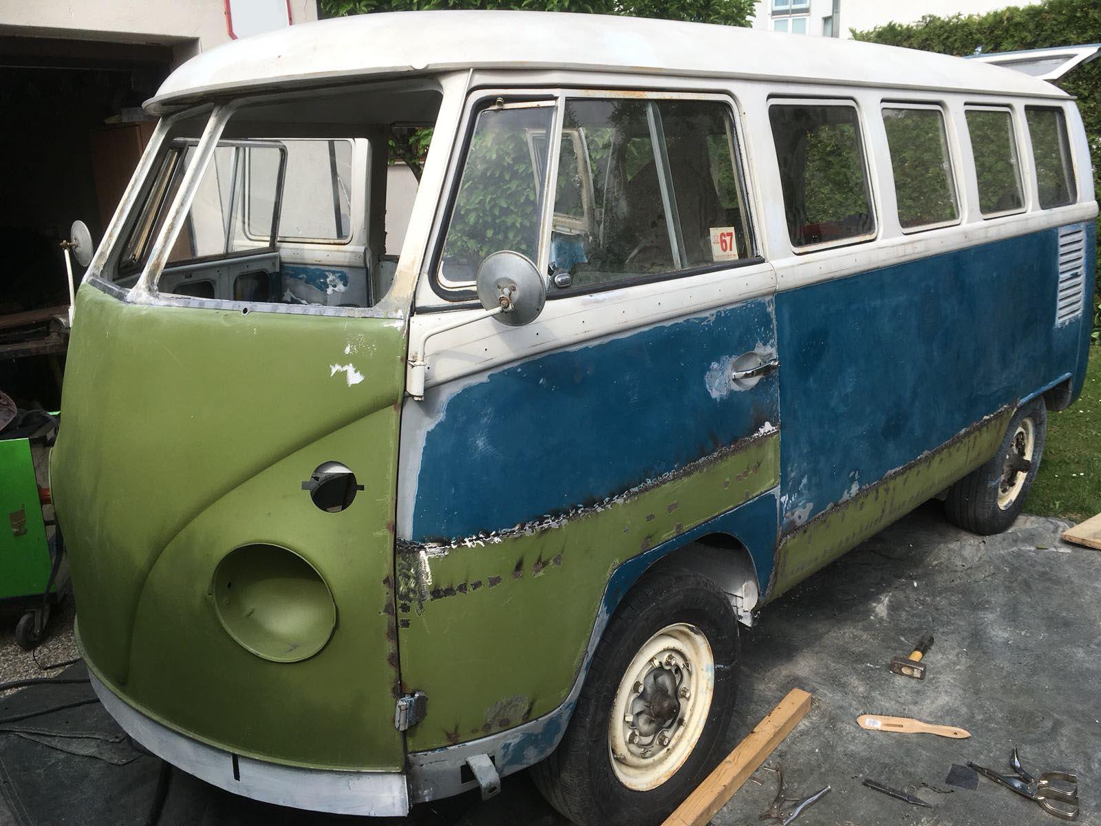

Body work
So here are some updates of what has happened during the last few days..

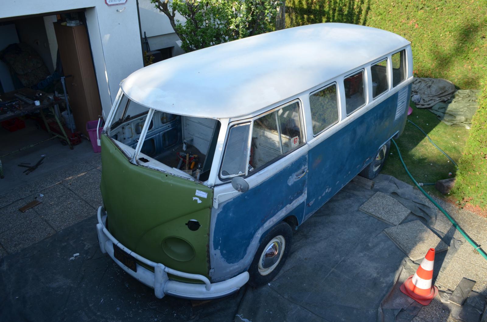

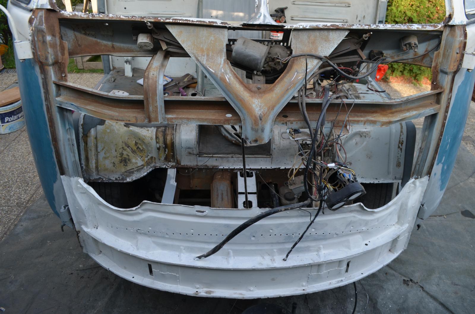

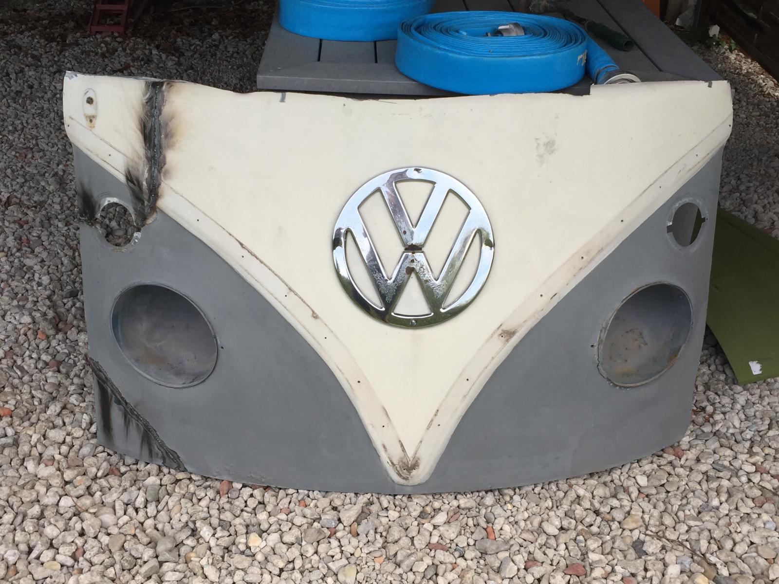

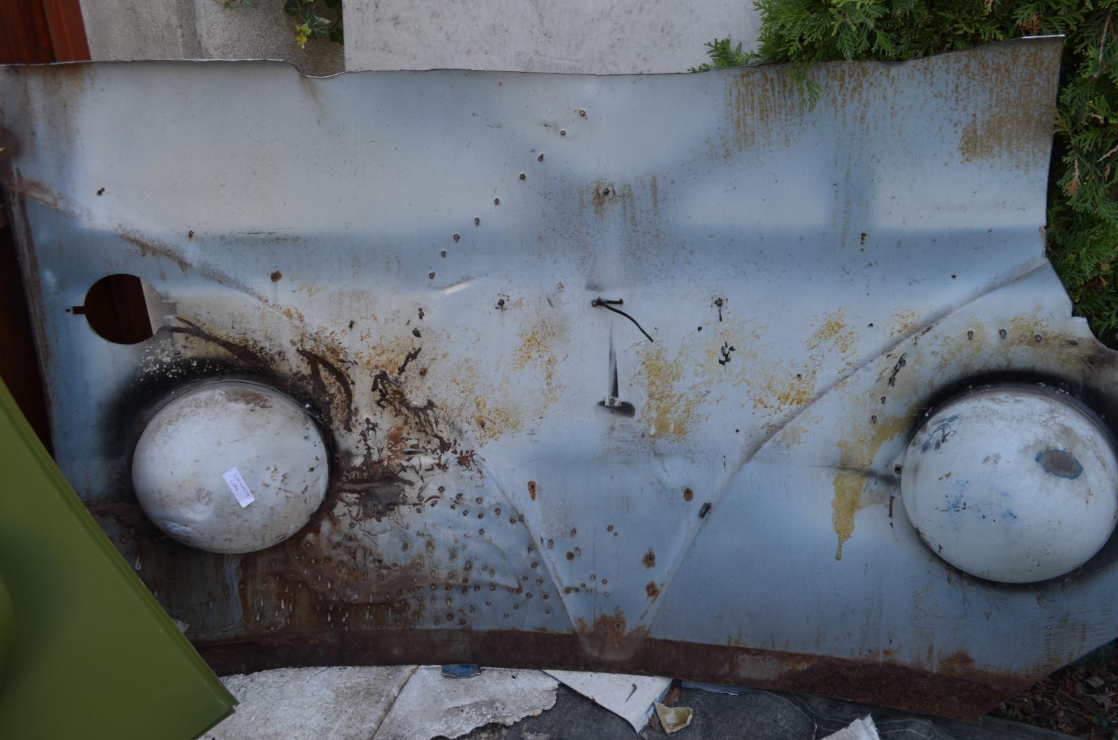

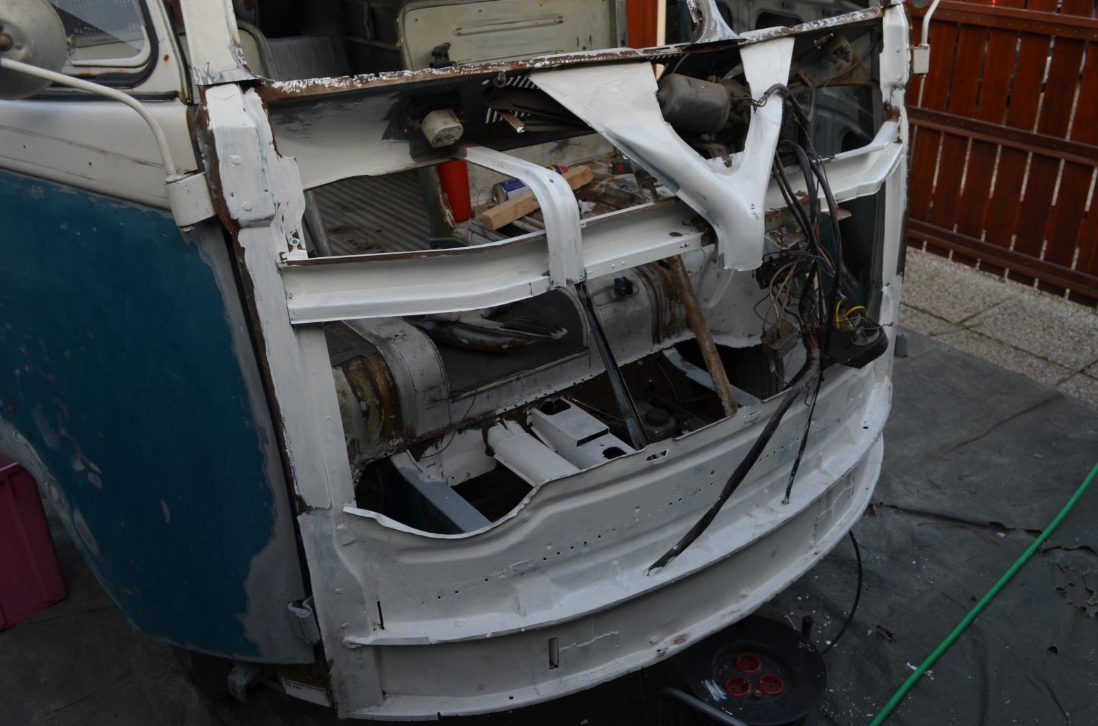

We decided to replace the entire nose - as the front section showed a front damage that has not been fixed good (happened before 1990).
So thats we we cut out the old front mask:

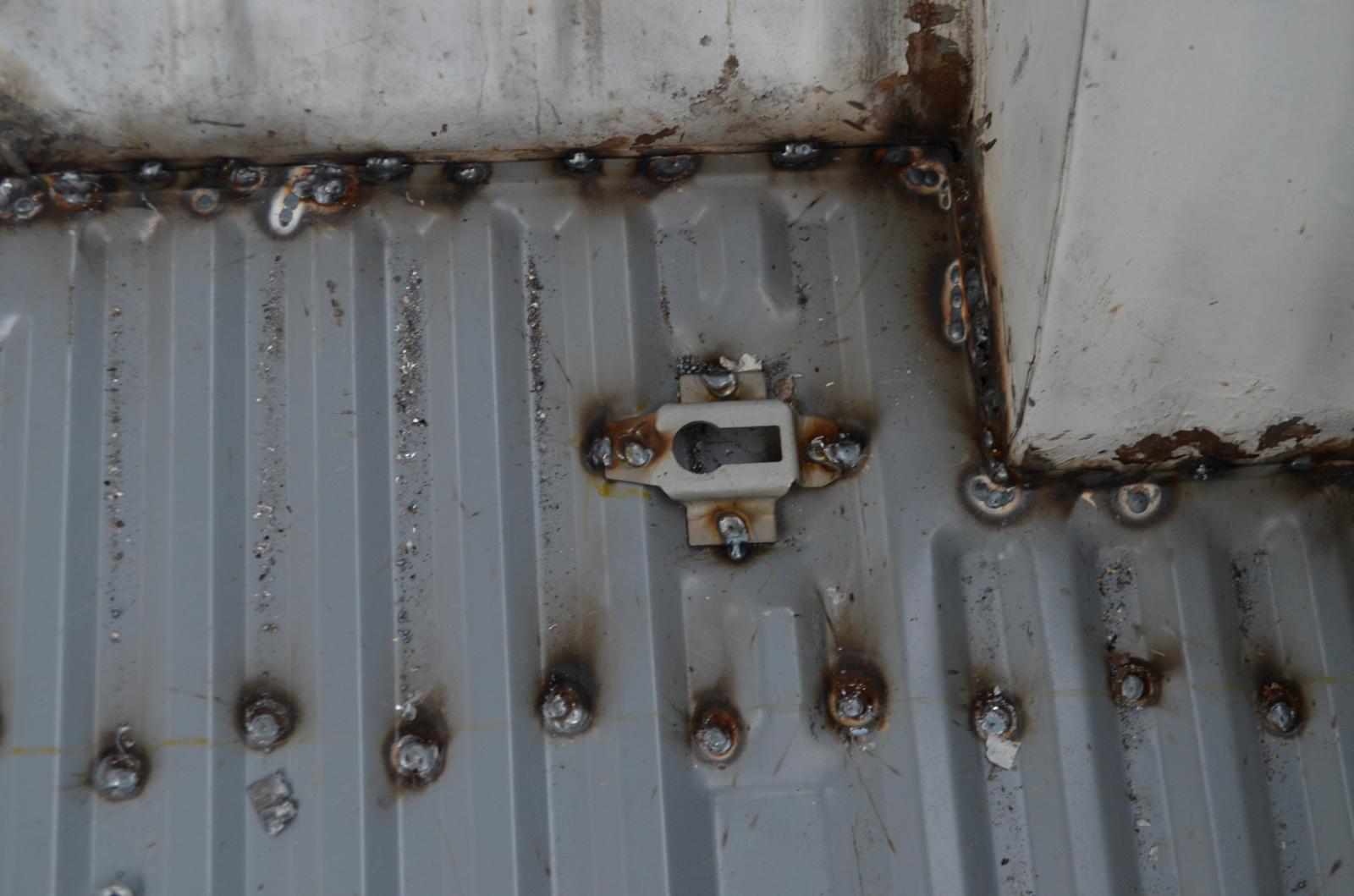

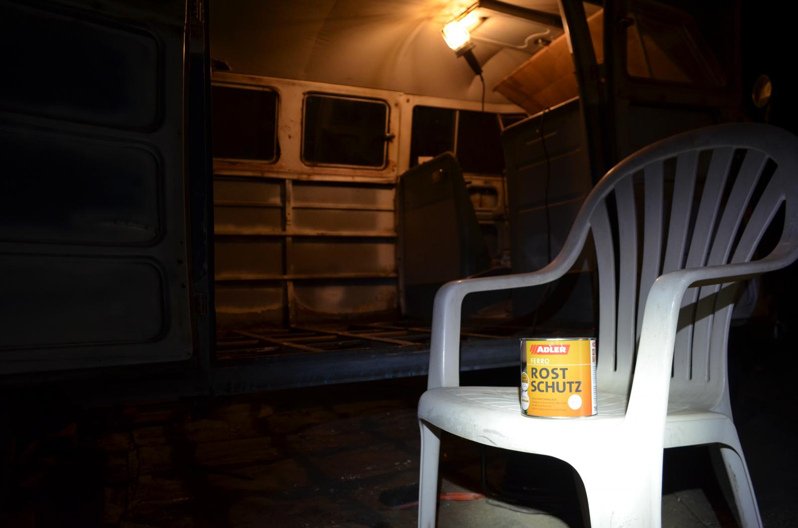

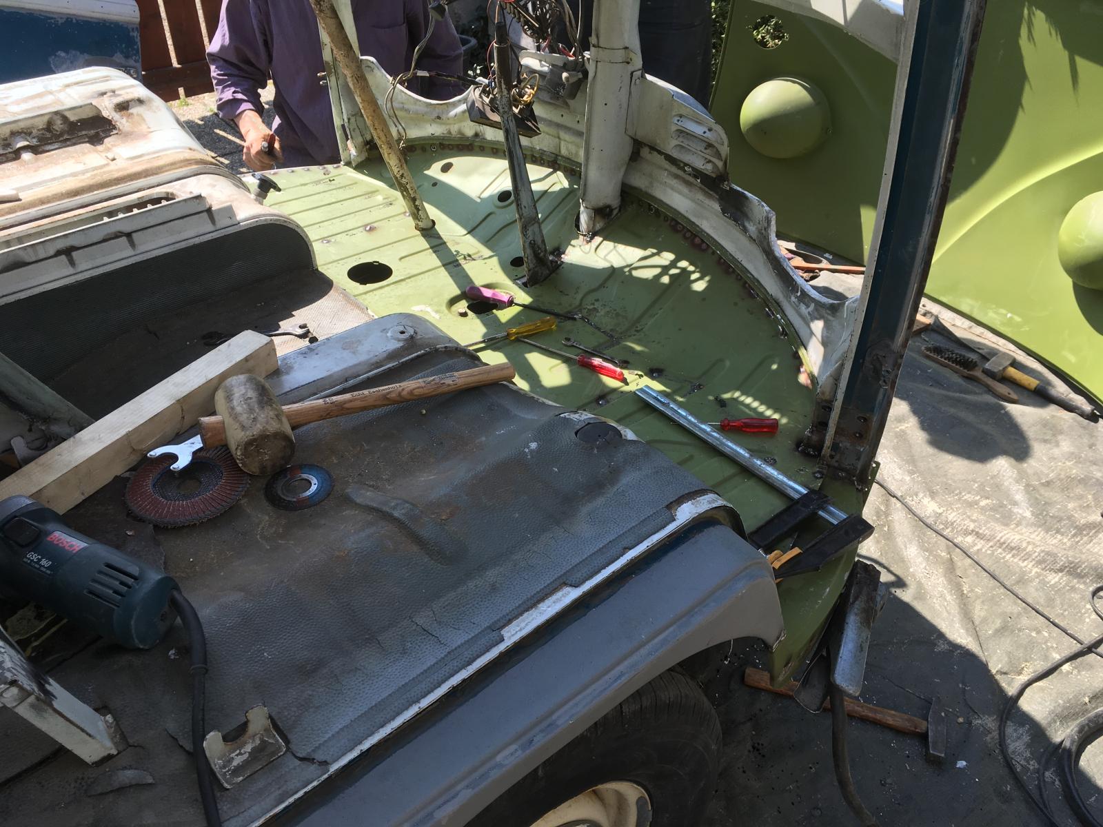

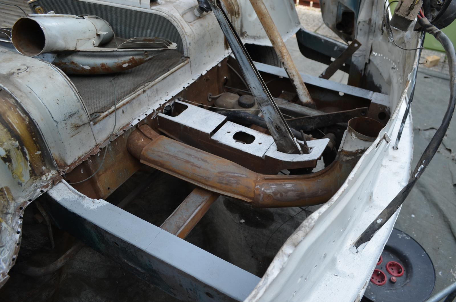

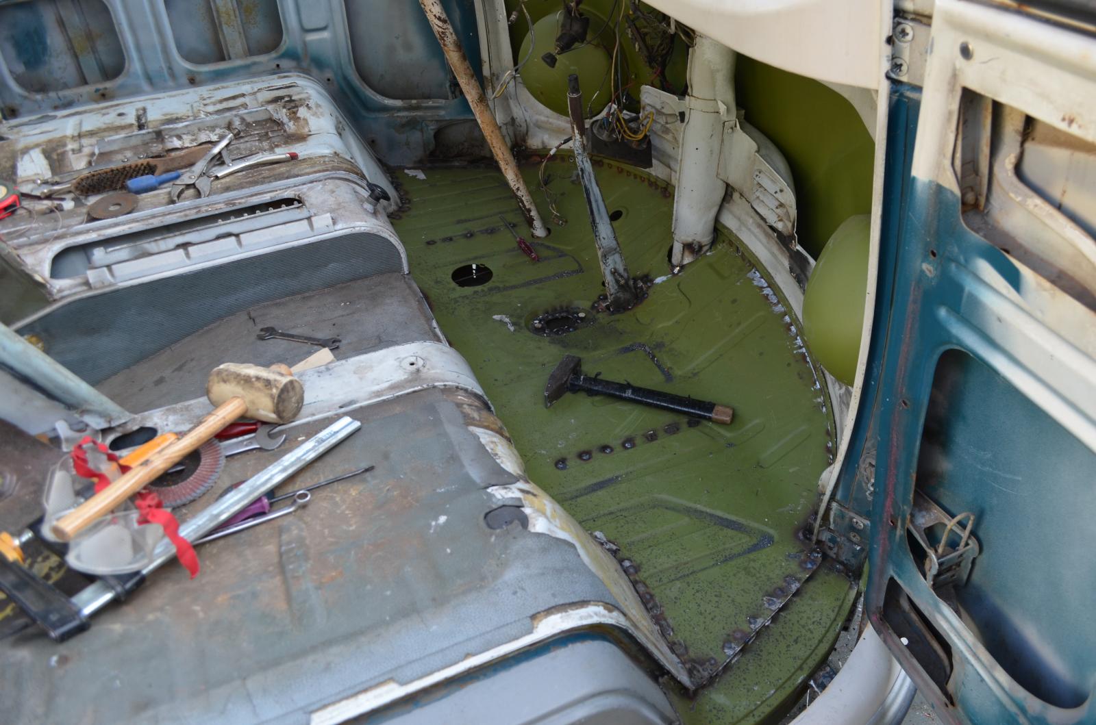

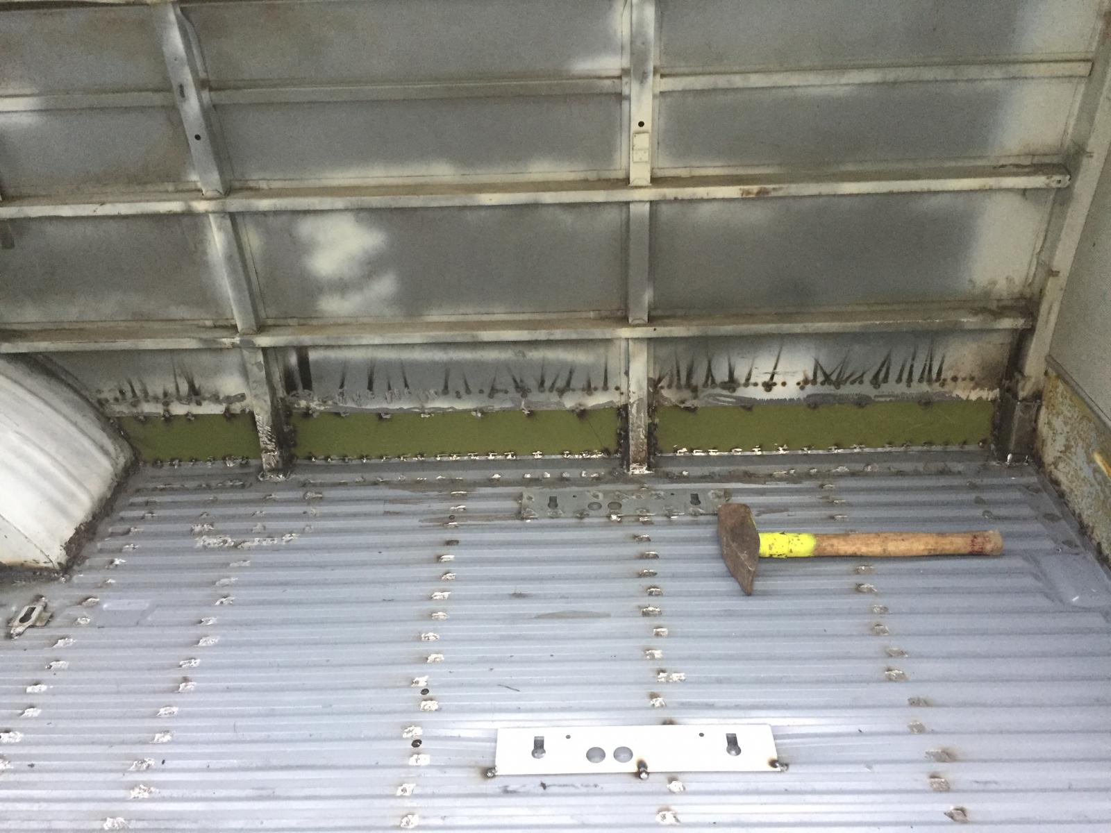

Afterwards we removed the old, crusty floor of the driver cabin. As everything was free now, we used the opportunity to sand everything down and cover it with primer / rust disolver.
Lettering on the can says: "Rust Protection" - shirt says "NOT NOW! And definetely not later as well". Very Happy

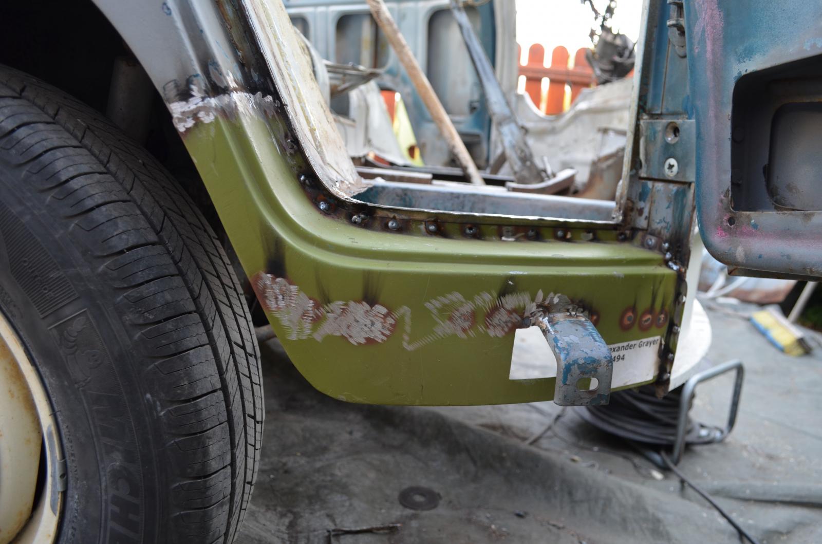

Then the first welding took place on the right side at the dogleg.
Followed by the new driver cabin floor and the part under the front section, right there, where the front bumper will be fitted.
Then it was time for the new front for our 1967 Volkswagen Bus:
The parts for the lower window frames will follow..

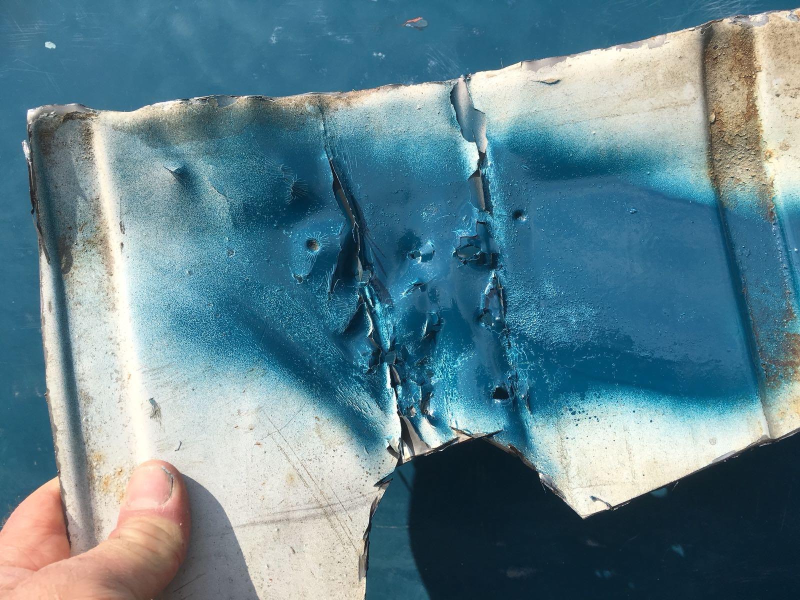

Working at the front doors:

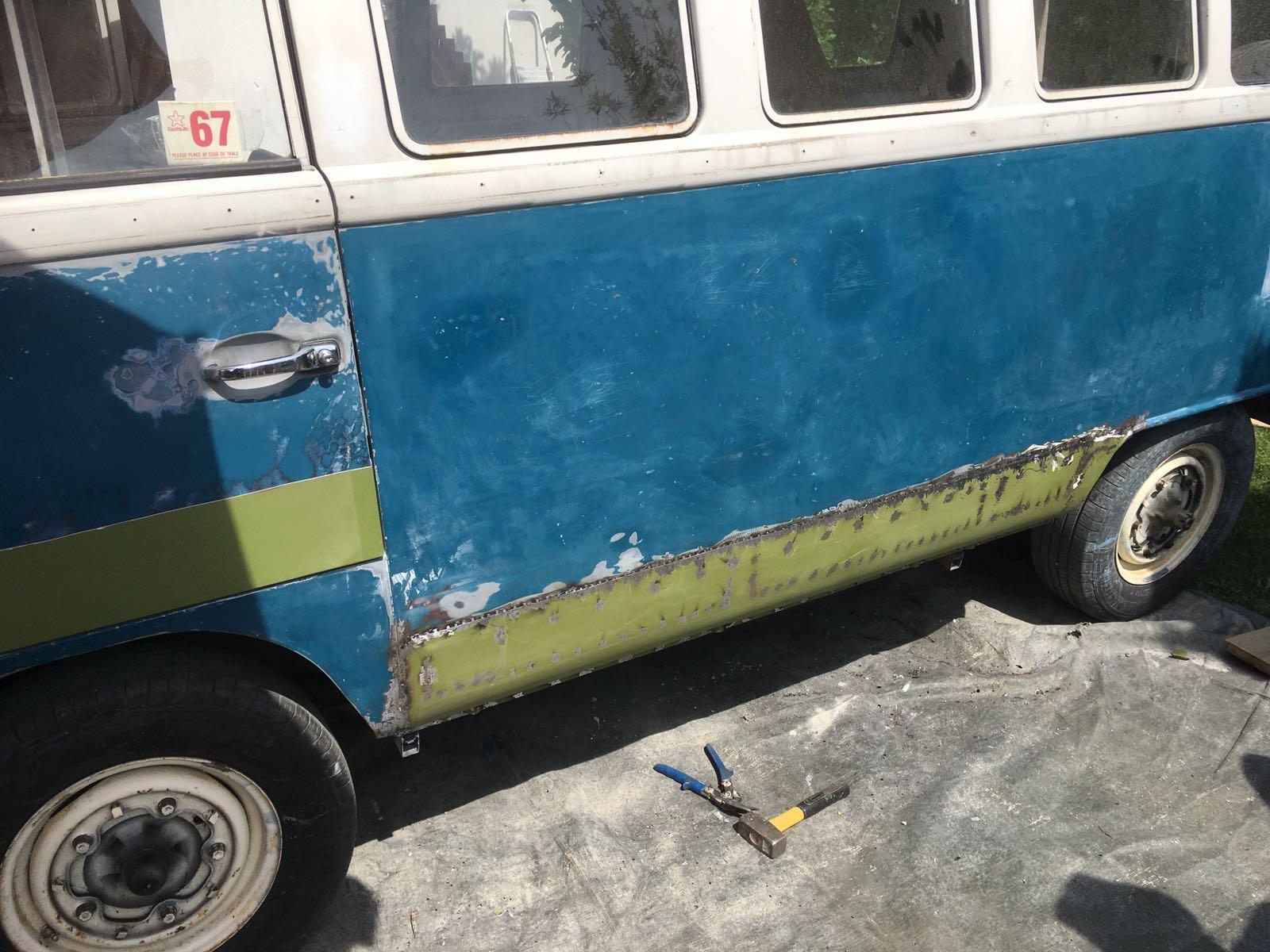

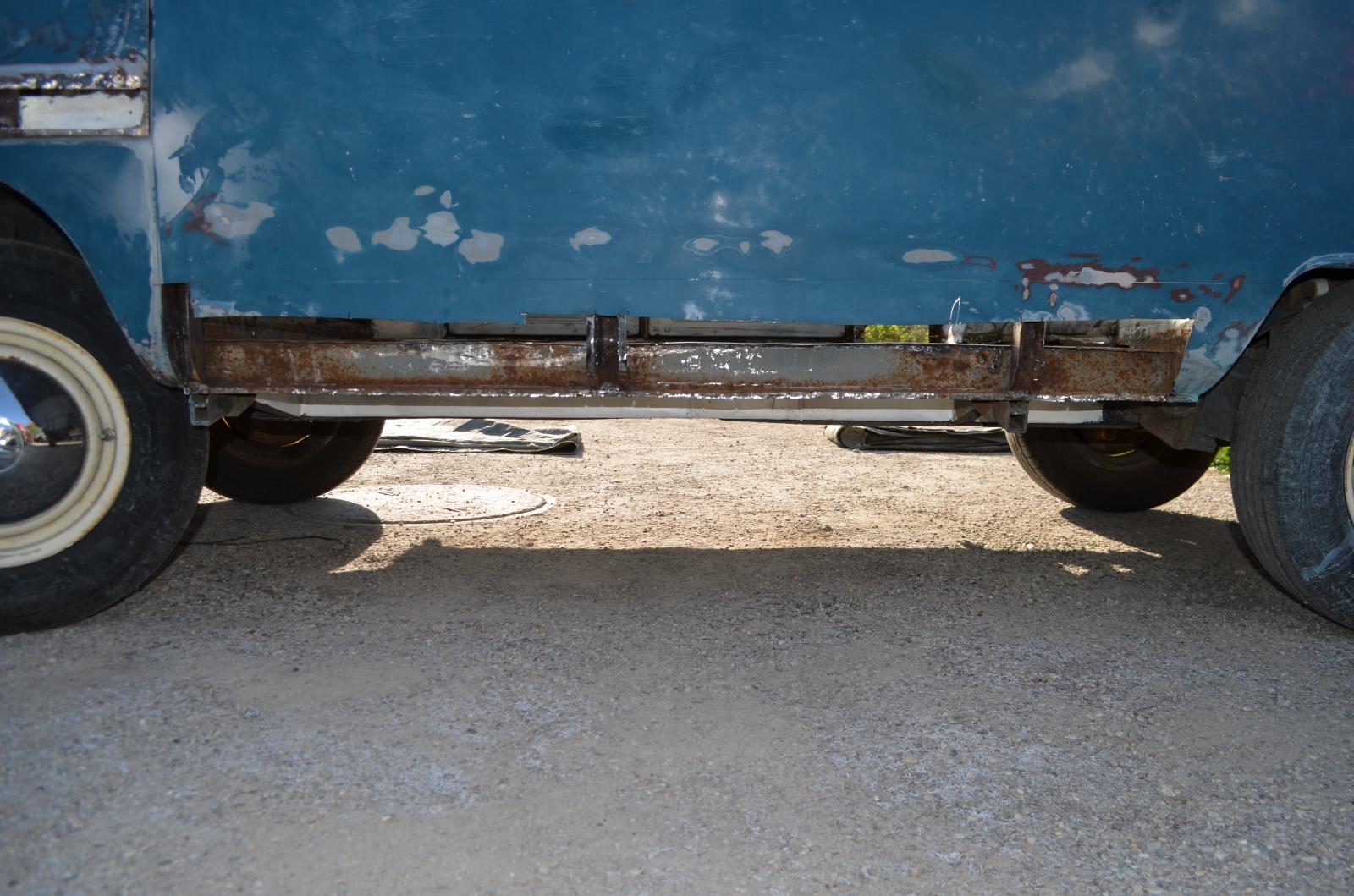

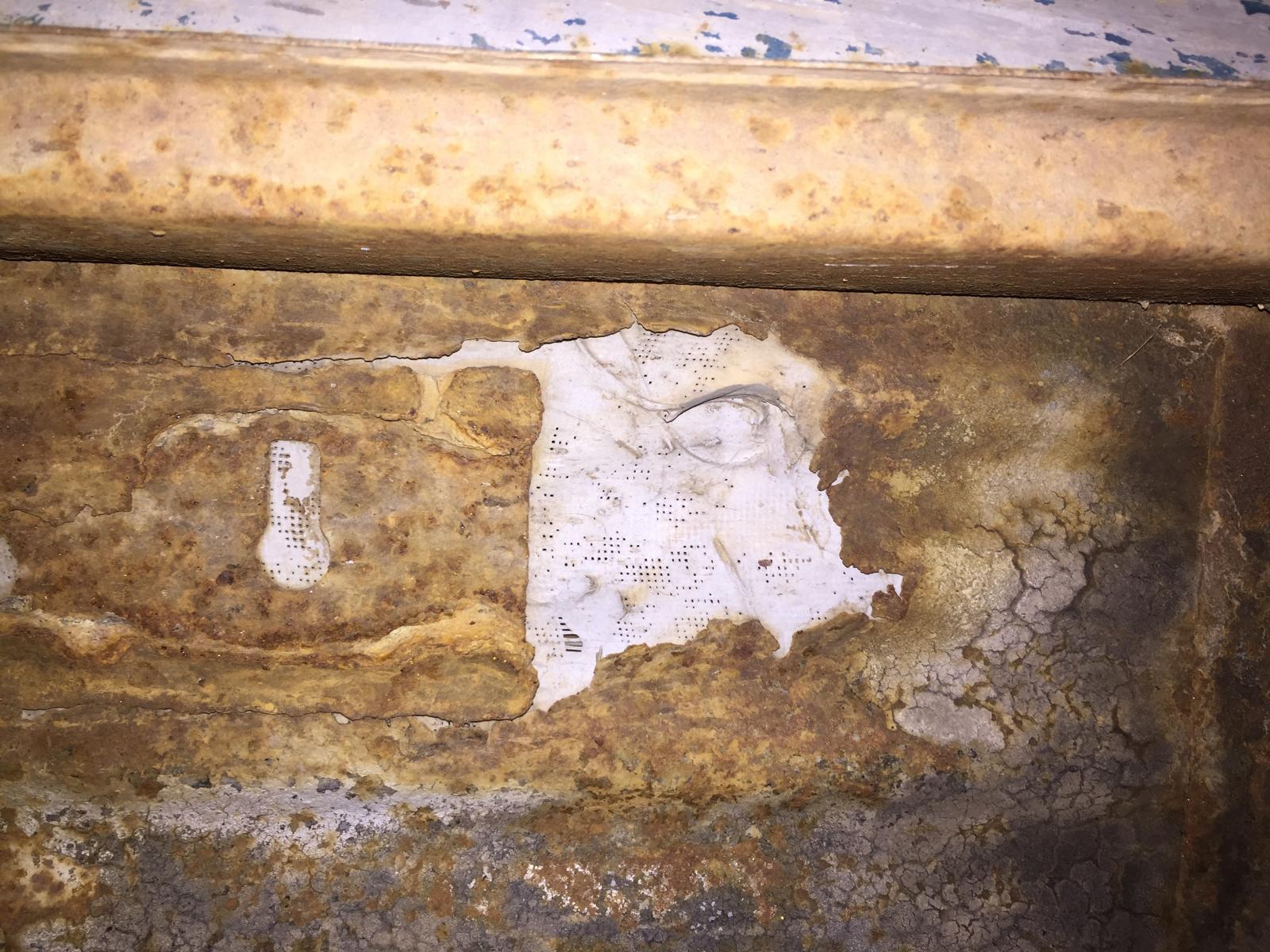

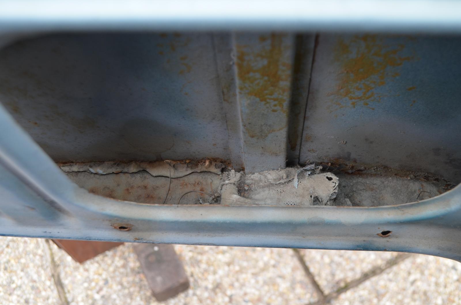

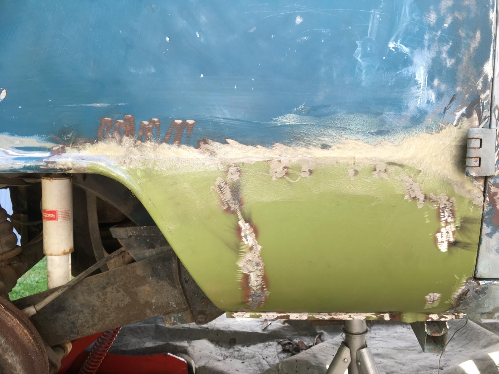

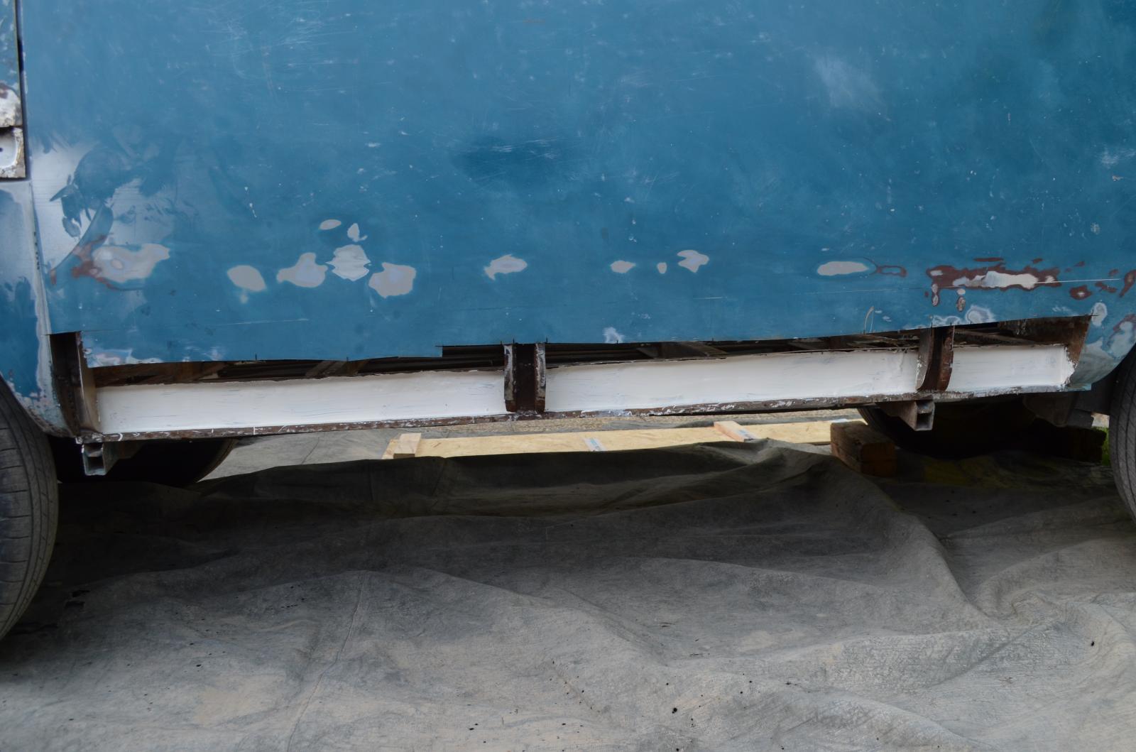

Here is what the sill on the left side looked like - we also decided to replace it as we have the chance now..
We also started to work on this area - it will also receive an replacement.

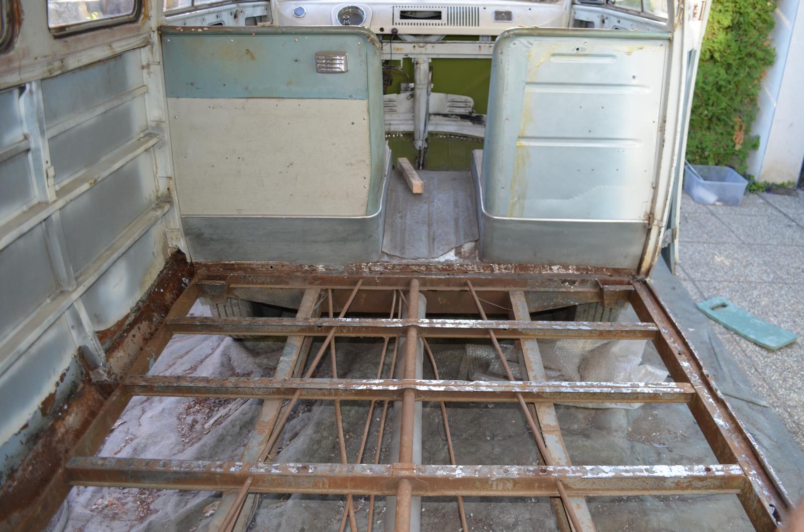

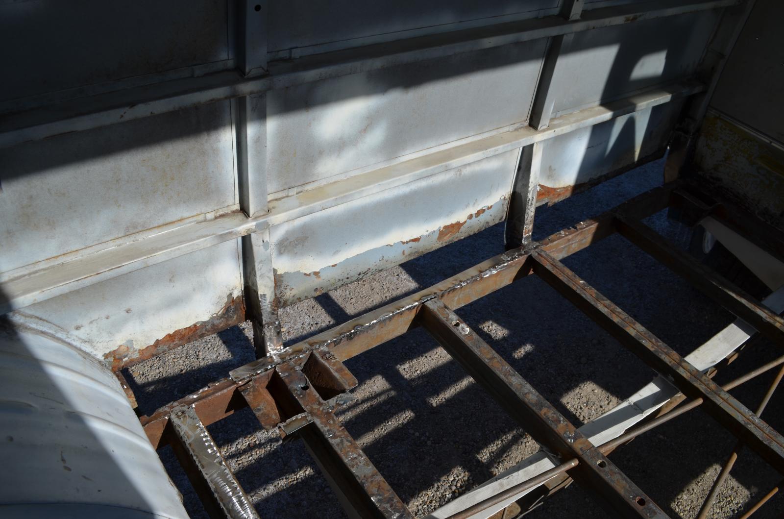

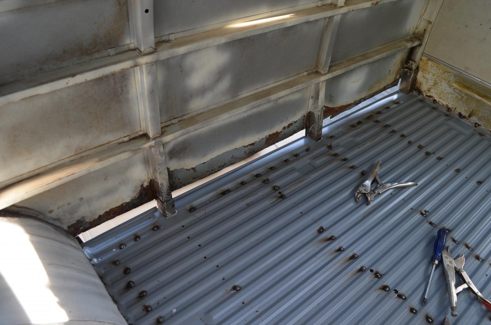

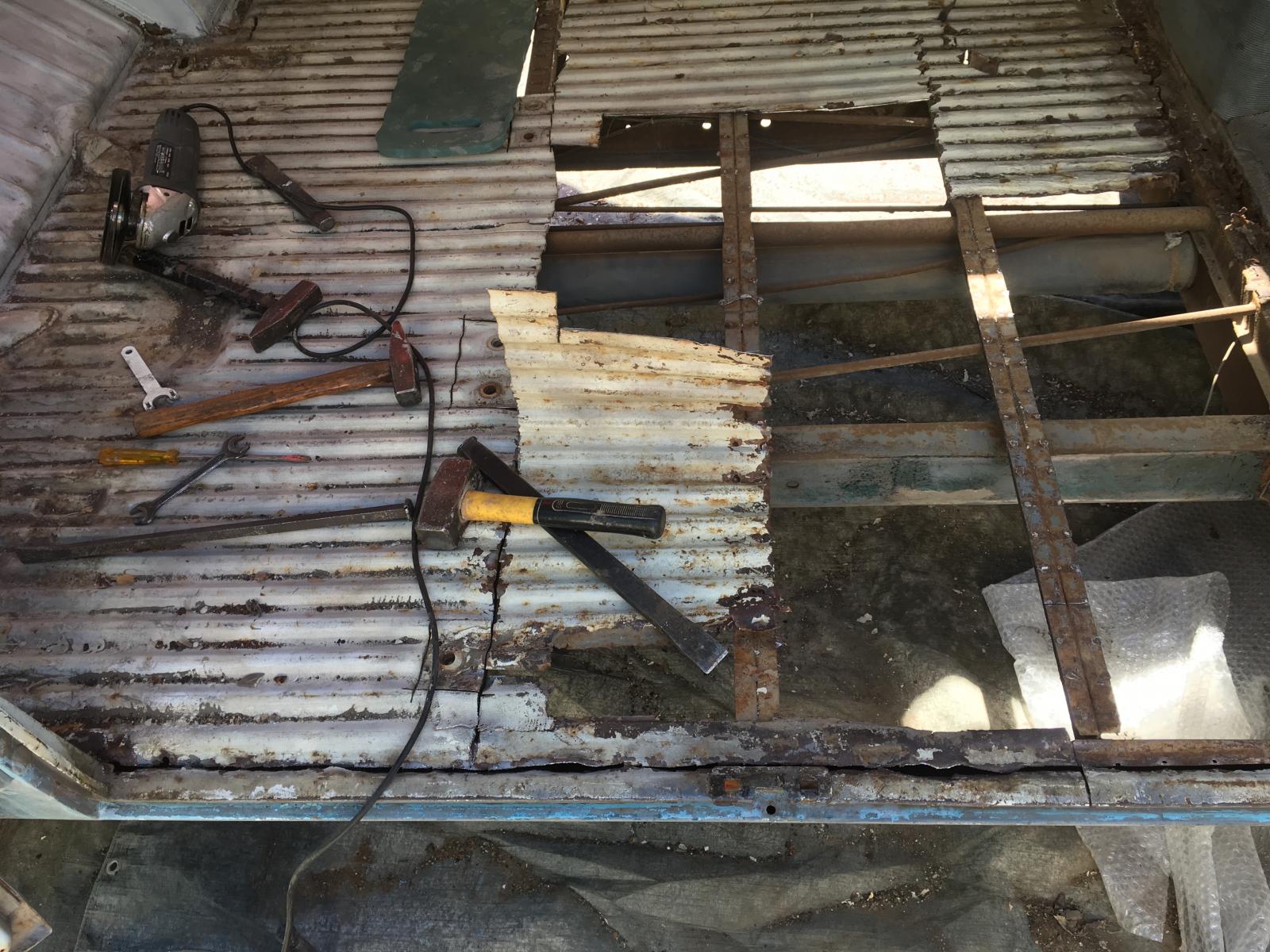

Removing the cargo floor:
Lots of rust at this sill - caused by old, crumbly window seals, as the previous owner told us.. so rain could get inside the bus and was collected down there.. Crying or Very sad

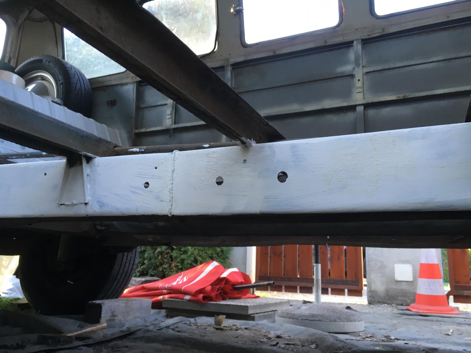

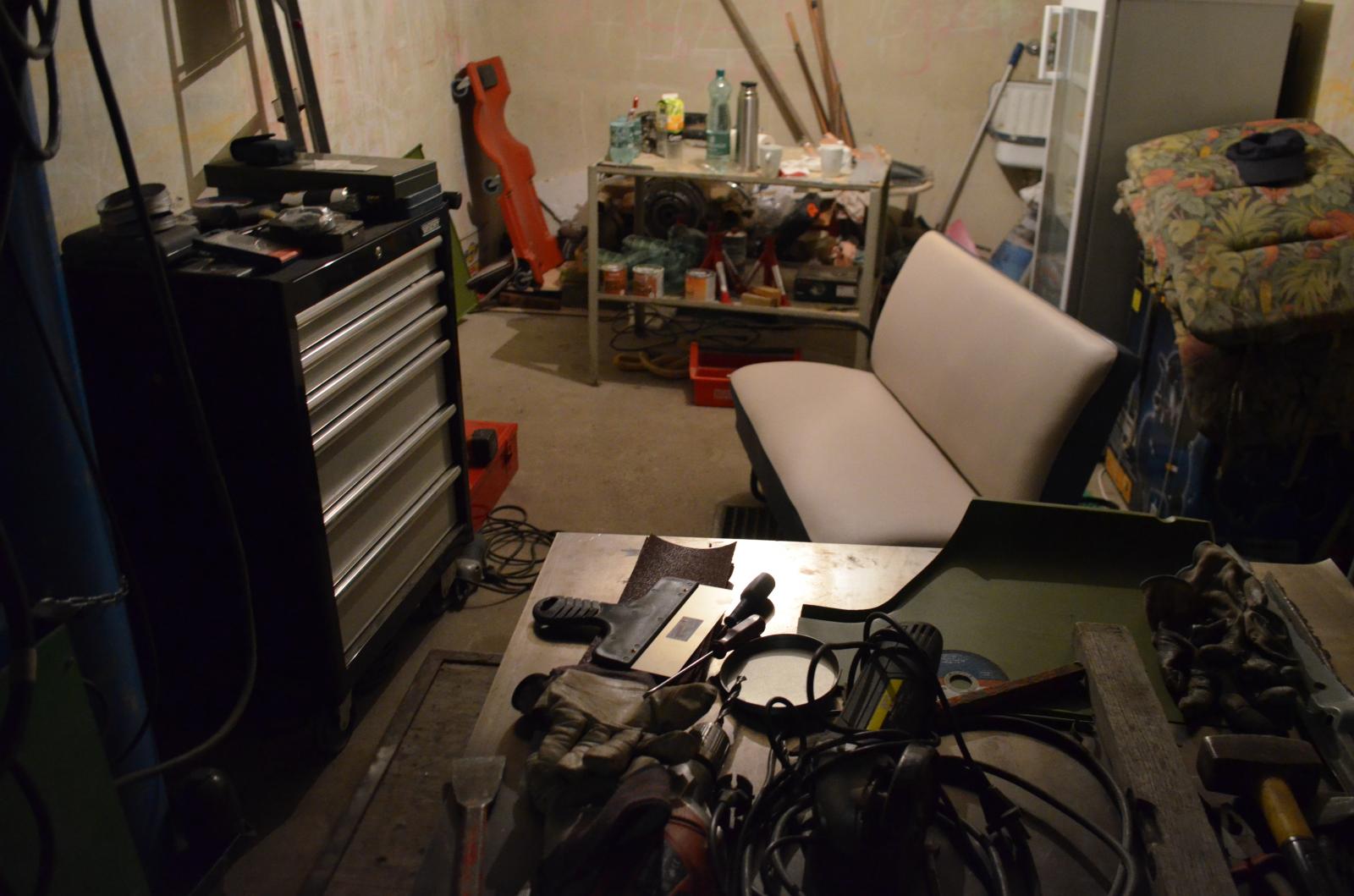

The bars all are very solid. So we spent lots of time with sanding them, using the sanding machine, wire brushes and scrapers. Then covering them with rust disolver / primer. We often work with nightshifts during the last weeks..
Chaos in the garage!
Nice and clean bar!
Of course i cleaned everytime before painting it - using air pressure.
Now this is the current look of our bus:

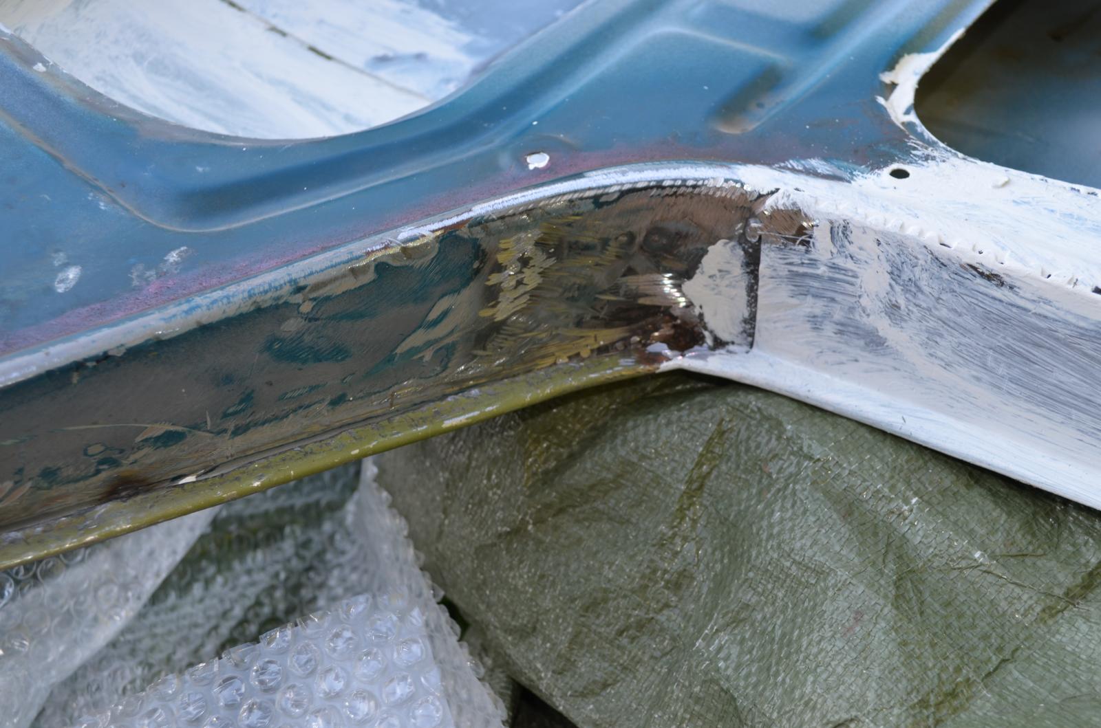

We also removed the rusty area on the sill of the left side. Two pictures showing it from the inside and outside:
Still lots of work to do - will try to post every kind of update in time. Wink

So today i am back with another update.. Smile
After sanding all bars with a wire brush, we covered them with rust disolver and primer - afterwards everything was ready for fitting the new floor.
The next step was to measure and fit the seat mounts for the middle seat.
Blog website:www.austrosplit.com
1967 Deluxe VW Bus - Resto Thread
Barndoor Coachbuilder Topics:
"Hans Kohlruss & Co"
AustroBus
Joined: June 01, 2014
Posts: 243
Location: Vienna, Austria
AustroBus is offline
PostPosted: Fri May 04, 2018 2:03 am    Post subject: Re: 1967 13 Window Deluxe VW Bus called Eve Reply with quote
Then the lower metal sheet at the left sill was mounted.
Of course we did some rust protection before again Wink
As you can see above, the driver door also is complete again!
The rear right wheel well and surrounding areas:

And the lower area of the windscreen frames is also complete again!
At first, when we were taking down all the layers of later resprays, we thought we could keep as much original paint as possible. But then we decided to better do a good metal work job that last for a few decades. So now we are thinking about doing a respray in the original colours again.
L360 Sea Blue
L860 Cumulus White
We already ordered some small cans for test sprays - below you can see the sea blue paint:
Sadly, when we cut out the old front mask of our bus, we damaged it as we cut away two corners on the left side. Now we welded them back in place and it will make a nice piece of decoration at home! Very Happy
Last but not least - the current look of our bus:
