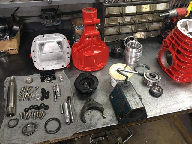

After going to 28" tires, this re-gearing was long overdue. I had planned to have Ken do this last summer, but had to postpone for various reasons. Going with the 5.43 R&P, 1.18 3rd, .82 4th and billet aluminum gear carrier; all provided by Paul Guard from Guard Transmission. Picking up today.....
