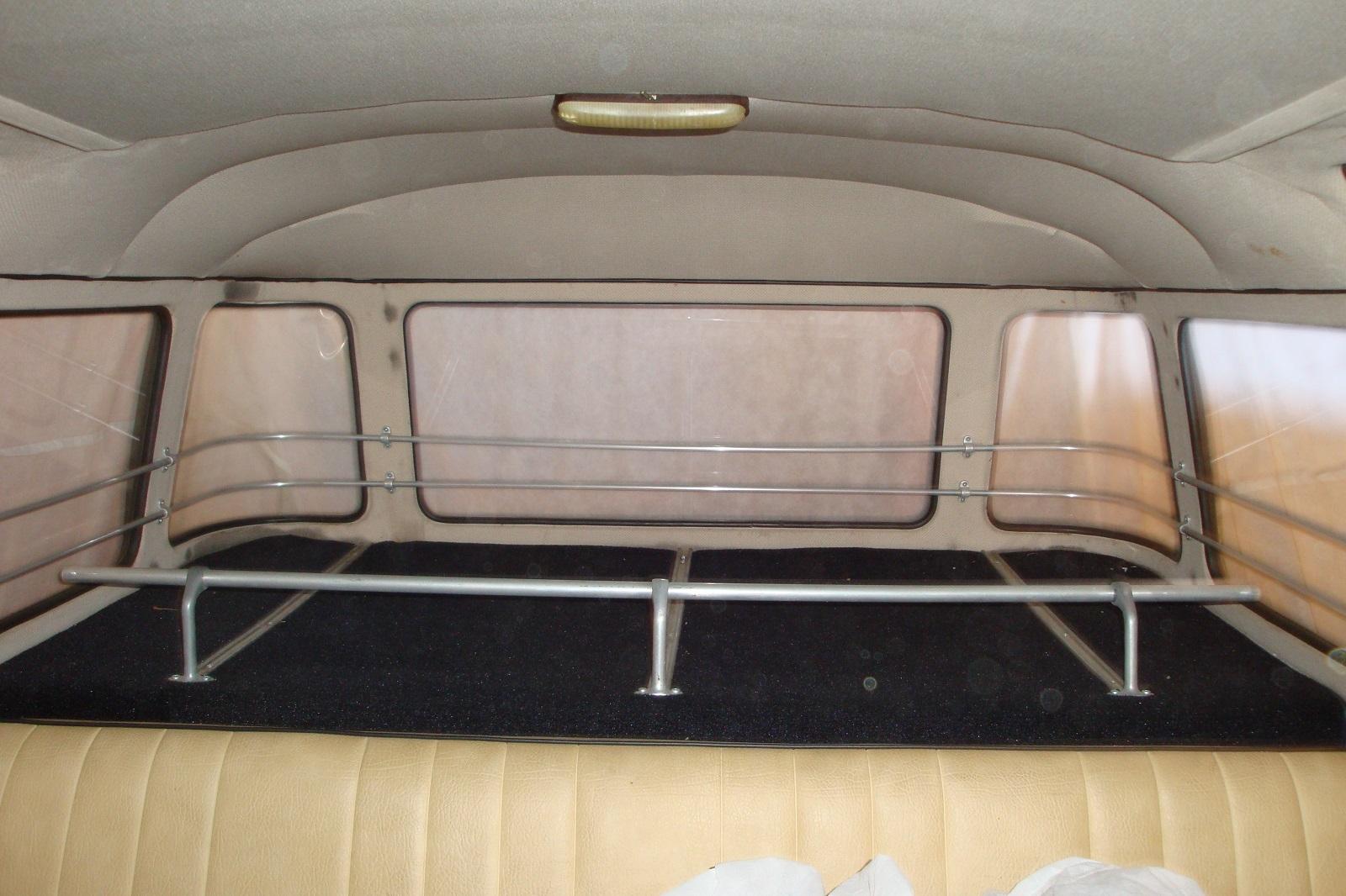

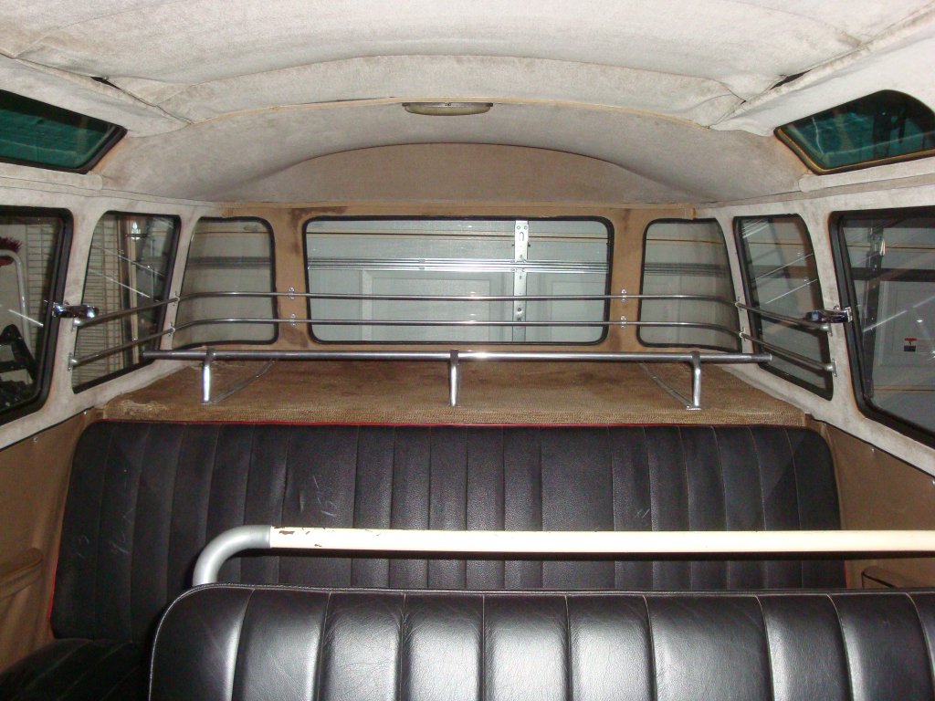

So we're getting close now but one more thing I'm stuck on is the placing of the three chrome luggage rails and the luggage bar itself on the deluxe rear shelf. Does anyone have any dimensions / photos without upholstery / etc?
Looks like all are held in place with bolts through the rear shelf rather than screws?
The location seems different in various buses. Top photo is Si Hitchmans old restored deluxe. Bottom photo more likely original. Positioning seems quite off between the two?!
Thanks so much to anyone who can help with this finishing touch!

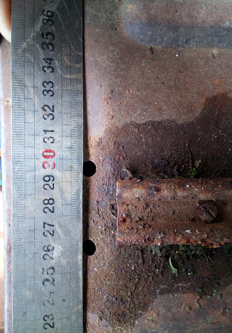

The center one is obviously centered on the bus and here is the measurement for the side ones... The rails are on top of the 4th ribs from each side (which make the middle one lower than side ones !), as shown on the pictures :

Okay, this is a good one.
It's exposed another little known detail - the positioning of the left/right luggage rails and the left/right luggage bar uprights.
Early (narrow)
Middle rail positioned in the centre dip of the luggage shelf panel.
Left/right rails positioned on top of the 6th rib out from centre of the rear shelf.
These rails butt right up to the corresponding upright in front.
The rails point towards the centre of the rear window pillars.
1951-1954
Late (wide)
Left/right rails positioned in the 6th dip out from centre dip of the rear shelf.
These rails (held with 4 scews/nuts) butt right up to the corresponding upright in front.
The rails point towards the outer edge of the rear window pillars.
1954-1955
So the wide upright spacing appears narrower on earlier deluxes.
The change looks to have happened mid-late 1954.
I have seen a 52, a 53, and a few 54s (ie the example shown above) with the early narrow positioning.
All 55s seem to have the wide positioning.
(Btw, on my 55, the lhs rail holes are not in the centre of the dip)
The rails propably wouldn't have been at different heights to each other in the earlier narrow version as the horsehair sound deadening strips, fitted in all the dips, would have padded out the centre rail area.
Cue everyone with replaced luggage shelf panels - or tribute deluxe owners - rushing out to their garage to check their rail positioning! Smile
