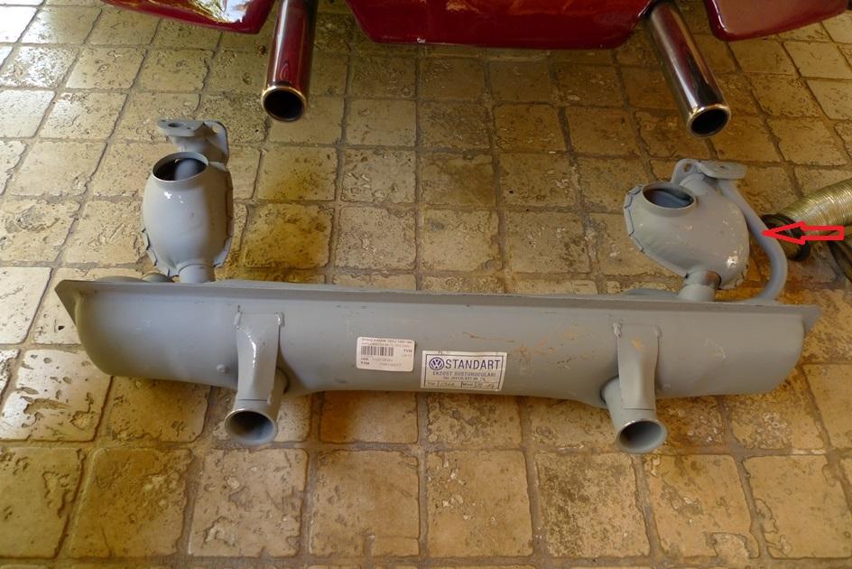

Just to be clear, are you saying the heat riser flange on the header has an open path into the exhaust pipe? Above it sounds like you are describing the heat riser flange/tube on the header being clear, but if there is no opening into the exhaust tubing there is no way for heat to reach the carb.
Not the best pic, but above you can see there is an opening in the center of the heat riser flange but out of the box it is NOT open into the exhaust pipe. You are expected to drill out the opening before attaching it to the heat riser pipe. These come closed in case you DON'T want to make use of the heat risers.
Is your exhaust a stock/factory style?
Or an aftermarket header style?

I second what Ashman is saying The flanges may be open but there may be no hole in the pipe below the flange- look closely to be sure if you haven't already. Also, the non stock mufflers don't have a low pressure pipe so there is no exhaust flow through the middle of the preheat, as the high pressure pulses keep pushing against each other.
