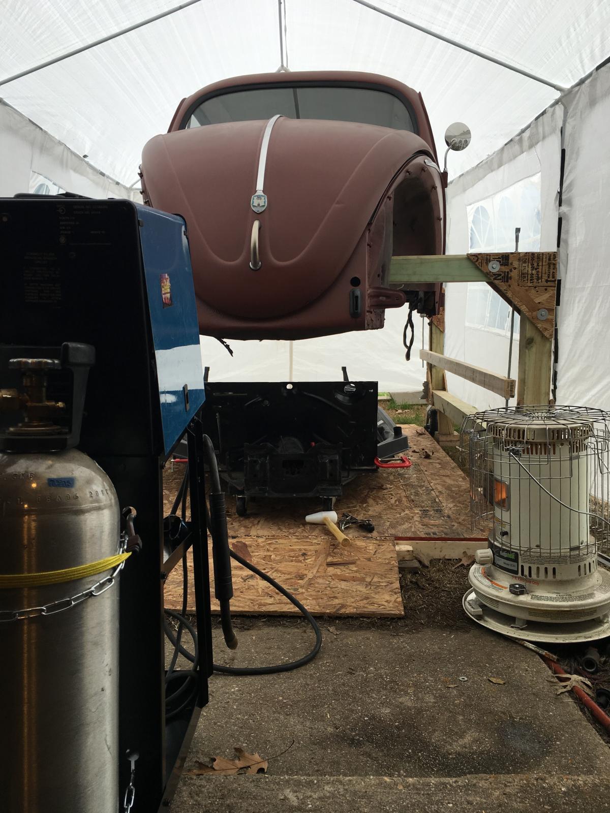

Well, here starts the nightmare roof repair.
The interior section of the roof where the headliner attaches was boogered up by the PO. So, we're going to try to replace the roof section as one piece (as best we can).
First, we cut out the shoddy repairs:
Then, probably spent two hours debating the best approach for the cut out.
We decided some bracing was probably a smart idea. (Turns out these would have to come off later as the passenger side appears to have been pushed in)
Let the cutting begin!
As we started to cut, we noticed the roof trying to separate:
So, we added some cross-bracing to prevent this. (Looking back, we think the car was just trying to “return” to it’s original shape)
After much cutting, the moment of truth:
Video evidence: http://i120.photobucket.com/albums/o198/cameraman123_photos/th_IMG_4569.mp4
Comparing the old with the “new”:
Surprisingly clean inside for 60 year old metal:
We then began the arduous process of slowly trimming the donor section to match the body. I emphasize arduous because after we made the first cut, and realized it was too short, we triple measured everything after that.
After a solid day of trimming & shaping, the patch fits the hole!
Of course, not without some issues. The original shape of the passenger side of the car has definitely been tweaked at some point. We ended up cutting our bracing free so that we could pull the B Pillar out about 1/2". Even with that help, the original pillar has lost its correct shape.
This will be fun to match up:
We then clamped the repair section in place to test the fit. It seems like each time we connected the two, we found another place that needed some minor trimming or shaping.
After another few hours, we were happy with the fitment:
Not perfect, but not bad either:
Now, for some welding! (Yep, Dad got a new "extra large viewfinder" helmet on sale at Northern)
After some very ugly spot welds…
I convinced Dad that we needed to turn up the heat on the welder… Much better:
We managed to spot in the majority of the top side of the seam. The C Pillar took some work as well as it looks as though the original roof had been “squeezed” – thus deforming the curvature on the roof style next just inside the gutter. Dad played around with this, and ended up getting a much improved fit. It will certainly take further work – but good enough for this stage.
After cleaning up the grinds with a flap disc, then sanding disc:
I threw a coat of primer on the previously warped roof section above the C Pillar to see how the distortion looked. Honestly, not too bad & very workable:
That’s where we’ve stopped for now as I’ve had to head back up to start classes for the semester. Next time I visit, we’re going to tackle the remaining roof section (including filler for our initial short cut – oops), A Pillar, and B Pillar.
We should have a replacement front passenger quarter section coming from a donor car – so after the roof is done, that will be next!

Long time, no post. We've been spending time helping my uncle realize his dream of building a Zenith 750 Cruzer home-built airplane:
Anyways, back to the project. We were able to just about finish welding in the "new" roof section. It's not 100% yet, but almost there. We had to cut open a few places and pull them out / re-weld to try to restore the curvature of the roof.
Some redneck ingenuity:
Up front, where we cut the panel too short & had to make a sliver of a patch:
Cool shot of Dad welding:
We also worked on fixing holes & tears in the fenders:
Before:
Filled because we are going to do single blade bumpers:
After:
More tears like this on each one:
We also started working on the front driver's quarter. The original panel has been mangled and was covered in bondo & lead filler. We opted for a year-correct replacement panel out of a salvage car. Unfortunately, the repair panel wasn't in much better shape - but nothing the planishing hammer couldn't tackle. This was our first time using one, pretty neat tool!
The "new patch panel":
All cut out:
Test fitting the panel:
Here's where we left it for now, with two corners tacked in:
Lastly, worked on coating the inside of the gas tank. Used KBS coatings large cycle tank kit:
Inside, before cleaning:
After cleaning:
After paint / sealer applied:
Next, we will need to finalize the roof repair, finish the front driver's quarter repair, and start on the rear driver's quarter:
More to come!
Zig, Aircooled Enthusiast
Current: Porsche 914 Resto | 1969 VW Beetle
Past: 74 Thing | Sand Rail | Baja Project | Oval Beetle
View user's profile Send private message Visit poster's website Instagram Classifieds Feedback
txoval
Joined: January 23, 2004
Posts: 3842
Location: The Woodlands, TX
txoval is offline
PostPosted: Mon Mar 28, 2016 8:15 pm    Post subject: Re: Our 1956 Texas Brew (one piece at a time) Reply with quote
It's good to see another Aggie working on VW's, keep up the good work!
JeffL
Joined: September 04, 2004
Posts: 1435
JeffL is offline
PostPosted: Tue Mar 29, 2016 6:57 am    Post subject: Re: Our 1956 Texas Brew (one piece at a time) Reply with quote
Awesome job on the rain gutter/roof repair!
http://karmannghias.org/
https://karmannghias.org/GAlken/index.html
AggieZig
Joined: March 10, 2013
Posts: 188
Location: Los Angeles, CA
AggieZig is offline
PostPosted: Sun Apr 17, 2016 11:10 pm    Post subject: Re: Our 1956 Texas Brew (one piece at a time) Reply with quote
Thanks for the kind words. Small update for what was a full day in the garage on Saturday. We were able to get the quarter panel fitted and tacked all the way around. We started to finish up the stitch welding but were running low on gas.
Gaps are a little too big to weld, but a piece of copper and some creative technique will work to fill this gap:
Finished up the rain gutter / inner door jamb:
Also got a new toy from Harbor Freight to pull out some sections. We started playing on a door and learned that sheet metal was way too thin to be playing with:
Then moved to the roof - there was some concave / sinkage along the weld line of the repair, so we started to pull that out:
Then we played with the rear pax quarter panel, this spot of the car is ROUGH. Will need a shrinking disc (next new toy) and some body filler:
Then Dad climbed inside to try to knock out a couple last repairs before the day was done (I think we were both ready to call it quits at this point).
So, one thing we clearly didn't know about... the donor roof was from a same year bug, but a ragtop. They must have the headliner "rail" at a slightly lower position when compared to the sedans:
(notice the drop between the original green & replacement panel)
This will obviously need to be corrected so that the headliner sits correctly... will take some creative thinking. With all of those repairs burnt in now, there's just a couple of things remaining. The car is missing bumper mounts (PO chopped them off) so those will have to be added back. The PO also chopped out the engine compartment and inside of the rear apron to fit the big engine, so we'll have to decide how we want to repair that.
The goal is to get the body work done before the end of May so that it can move out of Mom/Dad's garage into a temporary home at my uncle's place where we can blast & epoxy prime. More to come, so stay tuned.
