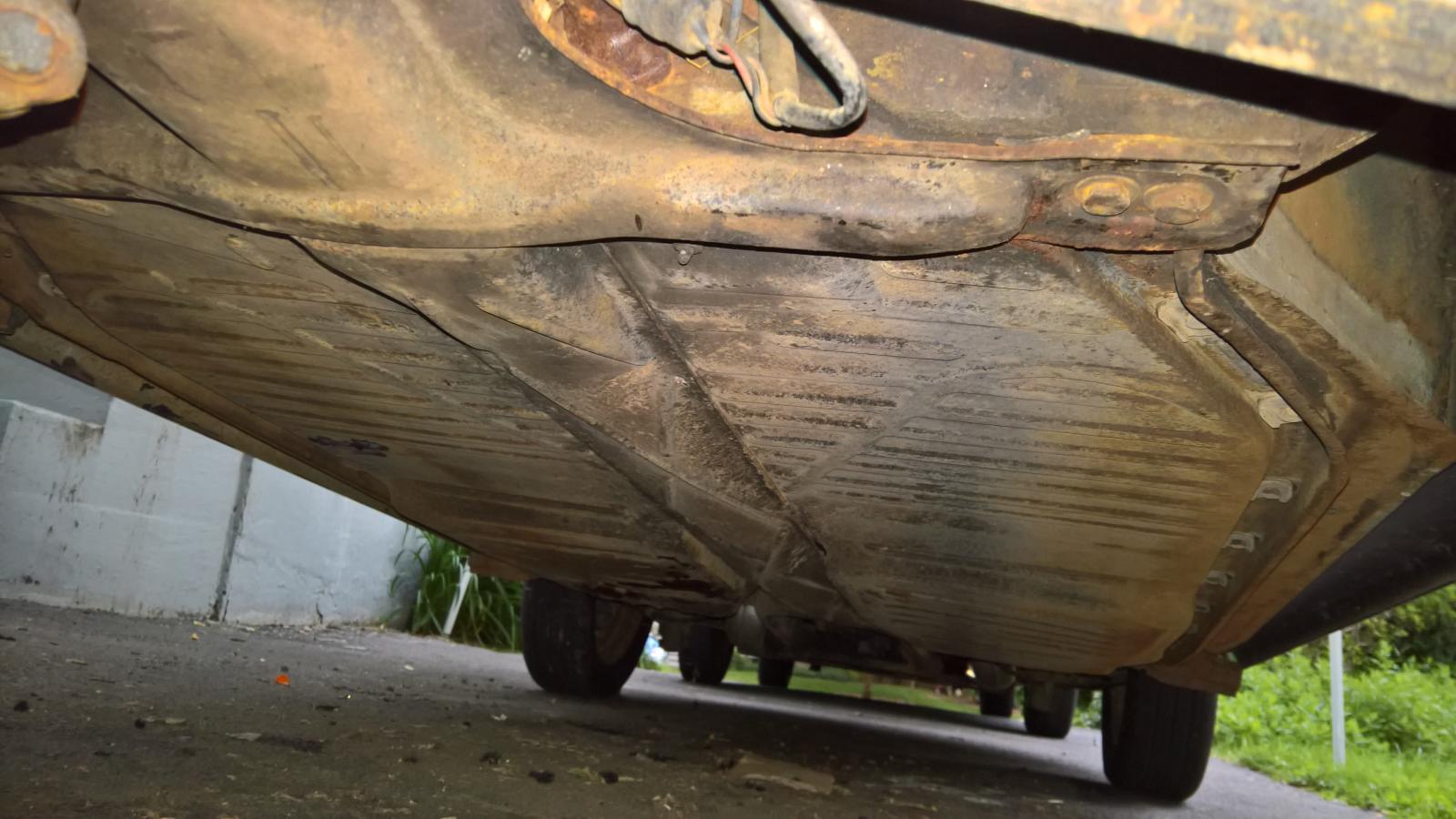

The driver side floor is good. The passenger side was fiberglass reinforced from the end of the seat rails back. It will need to be replaced front to back, including the battery tray. I'll probably get Buggy Man in Lorton to do that work since I can't weld, and don't have welders or space for that. Good thing is that both heater channels/rockers are solid, zero rust.

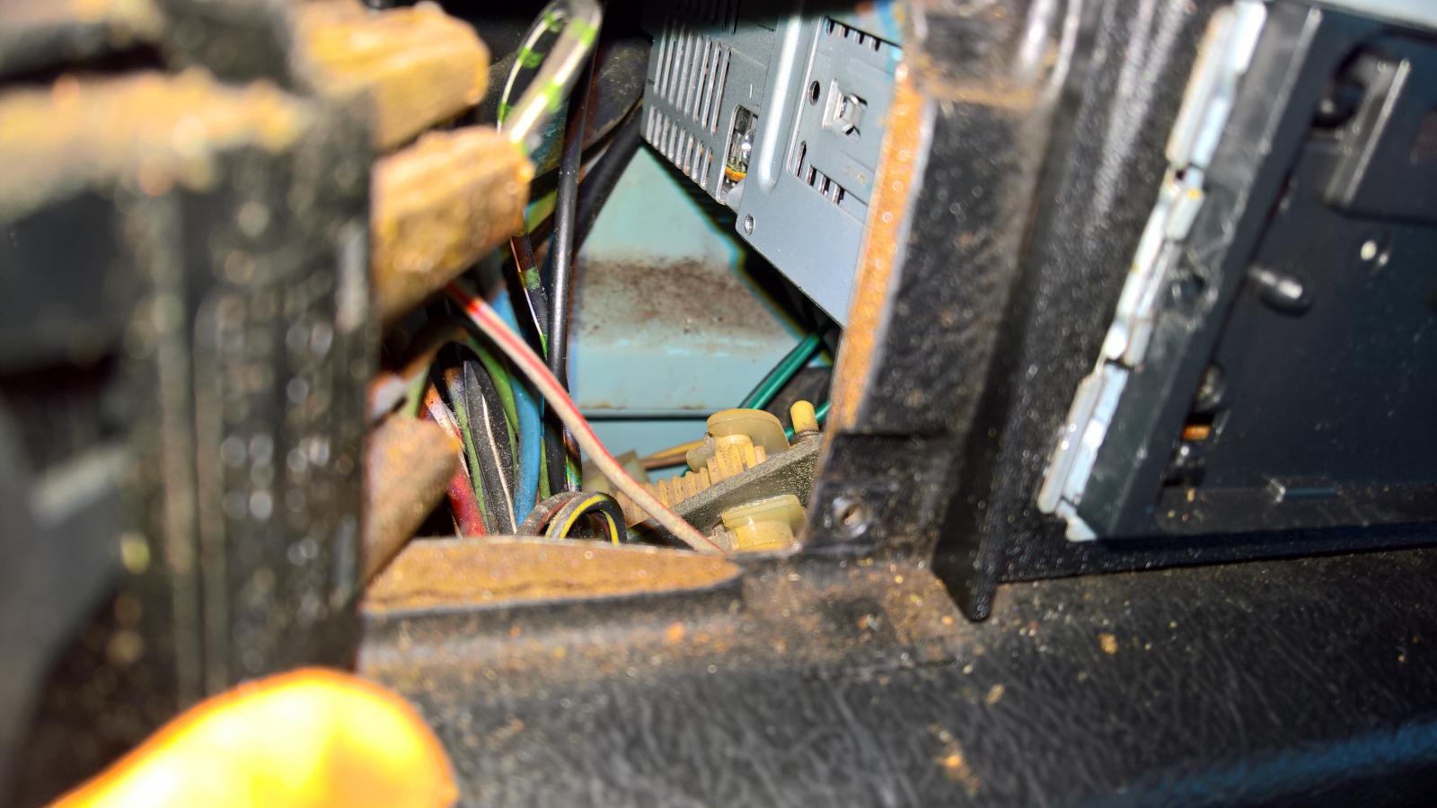

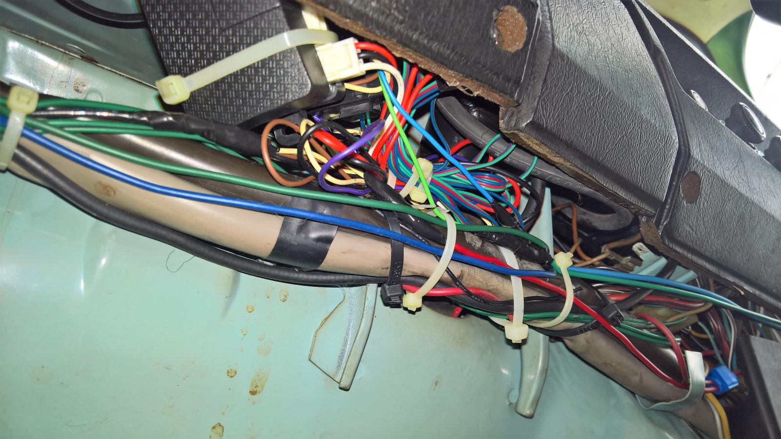

Electrical gremlins in this I'm sure. I'm hoping most of this is the radio that has 3 pairs of speakers.
Interesting choice of insulation where the wiring meets up under the driverside rear. The junction is run thru a piece of PVC pipe w/electrical tape holding it together. Confused I will assess that after the floor's replaced.

Let us know what’s in tha pvc pipe. Hopefully, it’s not as bad as the wiring you found under the rear seat in your 74’.

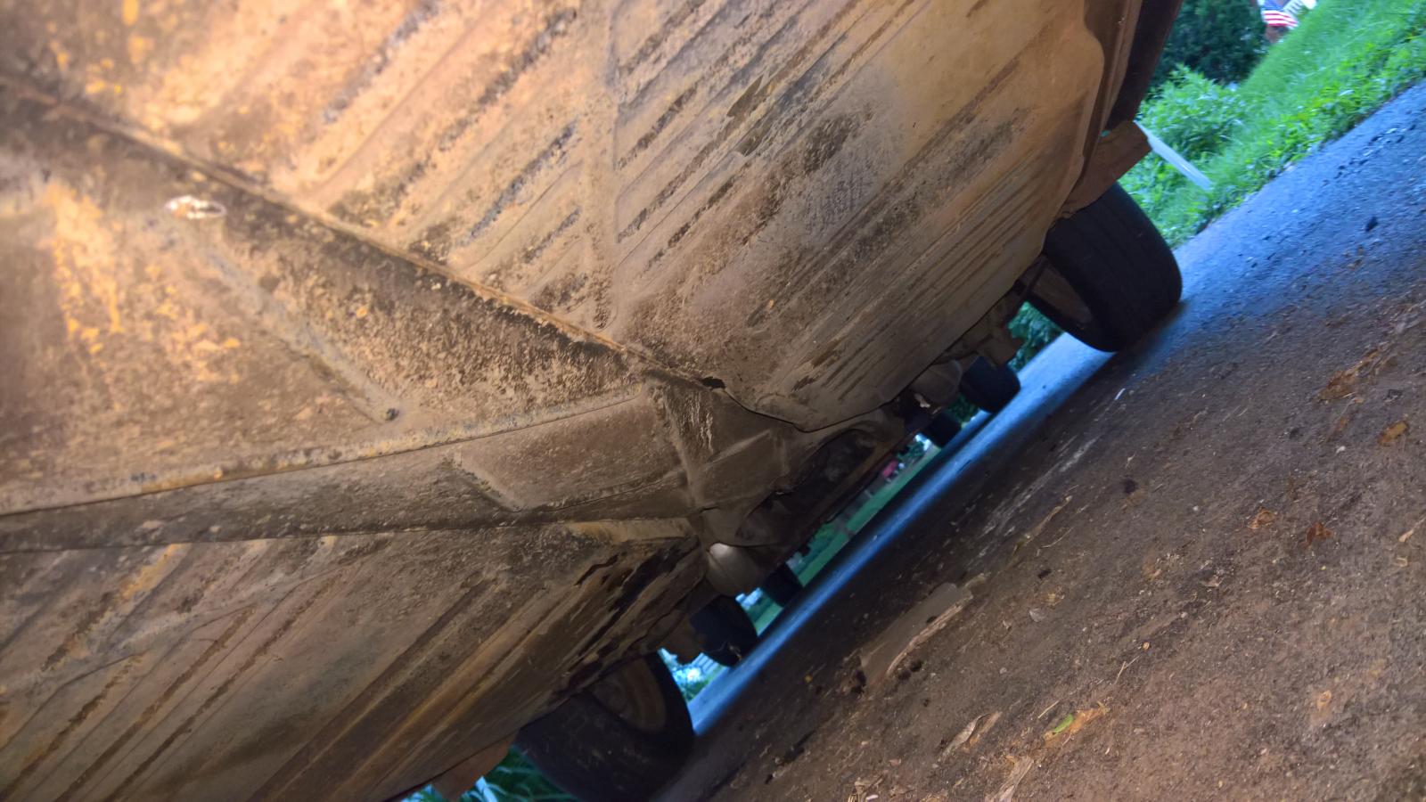

A bit more floor work tonite. Removed the rest of the factory floor insulation from the driver side.
I can see why this stuff may have done more harm than good. It looks like they didn't lay it fully in the dips in between the panel ribs. Those are the areas w/the rust. Fortunately it's only surface rust on this side. The passenger front may actually be salvageable. I'm waiting from my friend who welds to take a look at it before cutting any of it out. Btw - he's going to use this to teach me to weld w/his MIG welder, and I'm going to tackle the - gulp - death foam repairs on my own.
I also treated both sides w/prep and etch as a rust converter. Can anyone tell me if I have to rinse that stuff after it dries, or wipe it off w/a wet rag...? How may times should I treat it w/this...?
I don't have the little tool to remove the radio. Driving me nuts, I don't have anything thin enough to push the clip on the right side of the radio so that I can get it out of the dash to fully assess the wiring and ducting.

Victor, try two thin steak knives. If that doesn’t work, call a car radio installer and ask if they have some spare removers for your brand of stereo.

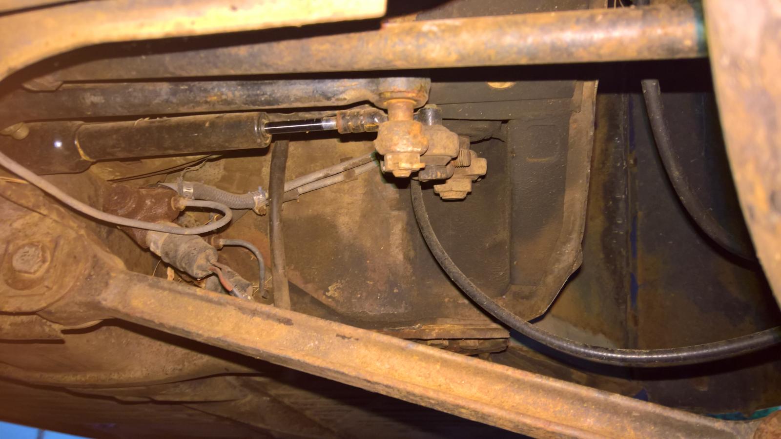

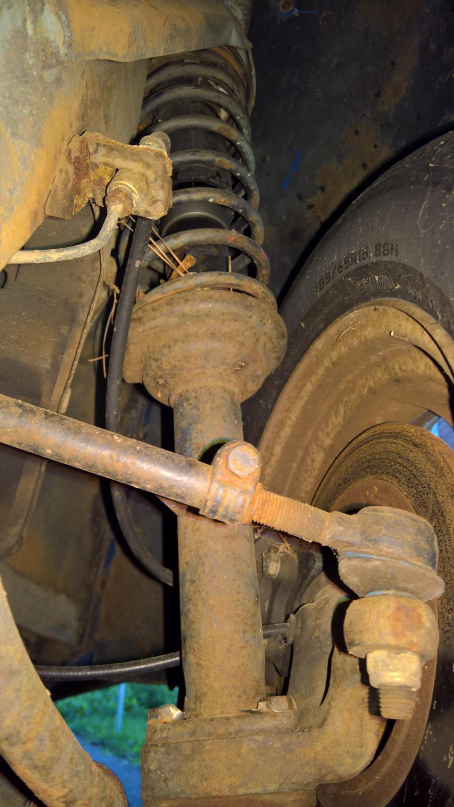

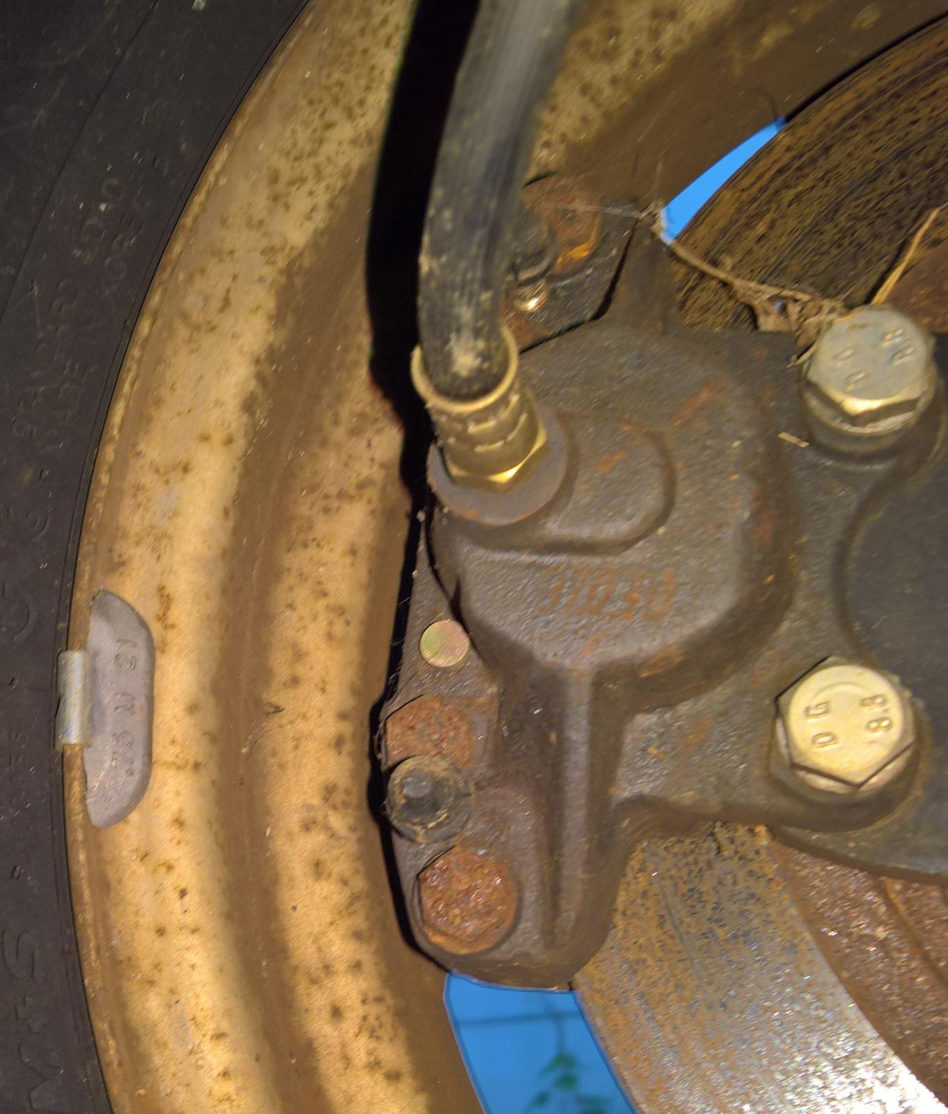

Tim - I was able to get the radio out. Used a big picture hanging hook, flattened it w/a 2lb sledge on the mini-anvil of the busted HF vise, and voila, came right out. Unfortunately, the radio gripper that these supers normally have is missing. Something else to search for in the classifieds.

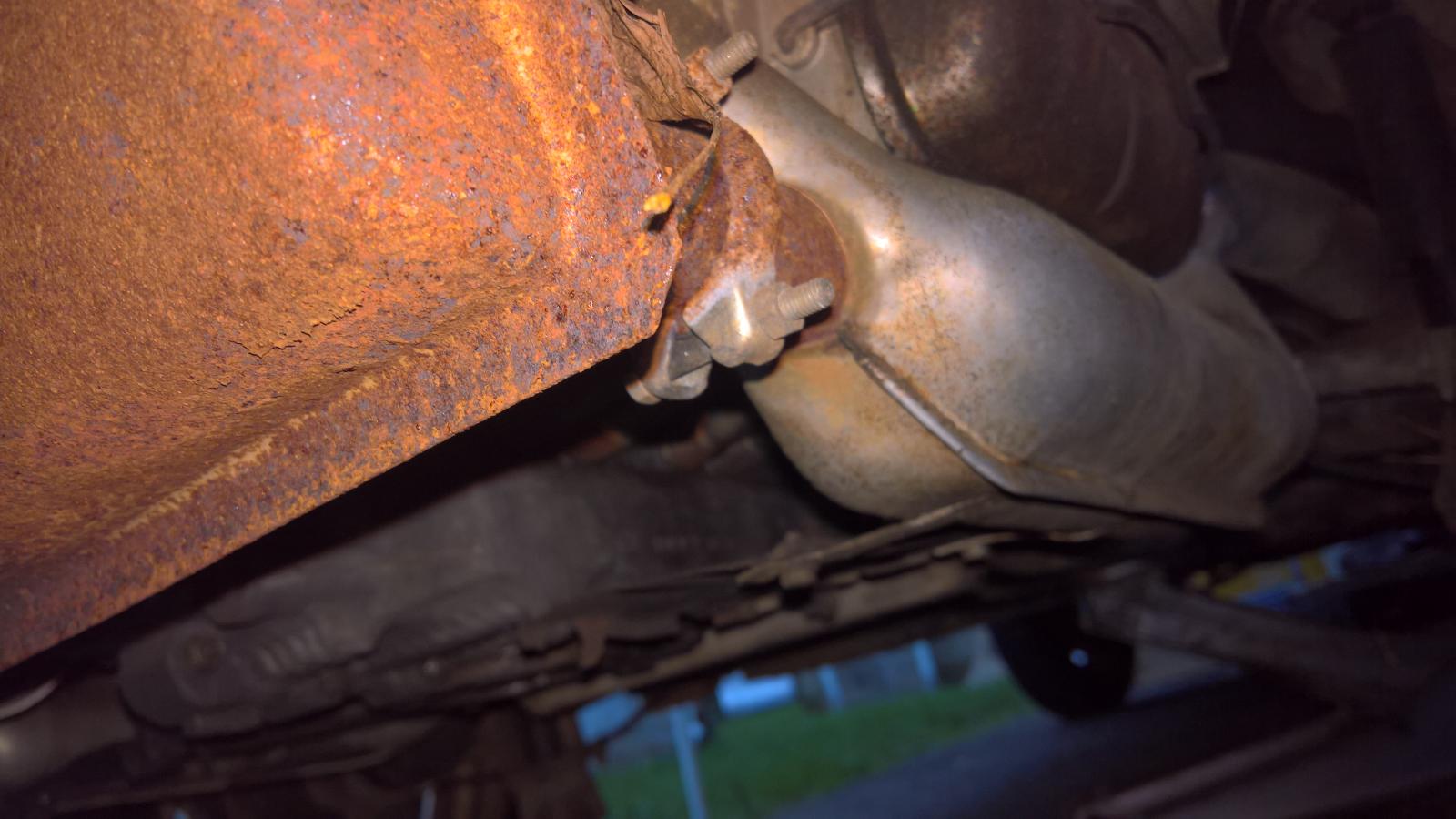

Now...get ready for a picture bonanza. I did an assessment of the underside and it's much better than I expected and makes me a more optimistic. Except for the battery-quarter of the floor (and that damn moon vent...always the moon vent), it's really really very clean. I need to remove and inspect or repack/adjust the front wheel bearings as there's quite a bit of vertical play in both front wheels, but the tie-rods, struts, springs, inserts all look good. Idler arm bushing looks new as well. I'm going to replace all of the rear trailing arm bushings - the spring plate/torsion tube ones w/rubber from Wolfsburg West, the pivot w/the black urethane ones from Topline. Needs transmission mounts, but I already have a pair of those from when I replaced the '74's but went w/pre-'73 mounts. Hmmm...That's an idea for this one... I have an extra pre-73 carrier...
Anyway - to the pics.
No thermostat and flaps. Another classifieds search as i will DEFINITELY be adding those.
2-sided tranny...no idea what gearing it has though.
No-name pump w/external filter. I like these, and will probably ride w/it since it's obviously a relatively new addition.
Clean around the push rod tubes.
Disc brakes - a first for me. I'll have to learn how to correctly bleed these.
Battery tray - will be replaced or repaired.
Looks like an Empi electric fuel pump.

Victor, I have one of those Super Beetle radio grippers—the U-shape bracket, right?
Also, I’m assuming you have two bleeders on each front caliper. The upper bleeder is the one you use. They put two on because it makes the calipers interchangeable (left for right right for left).
The car looks pretty good, really.
