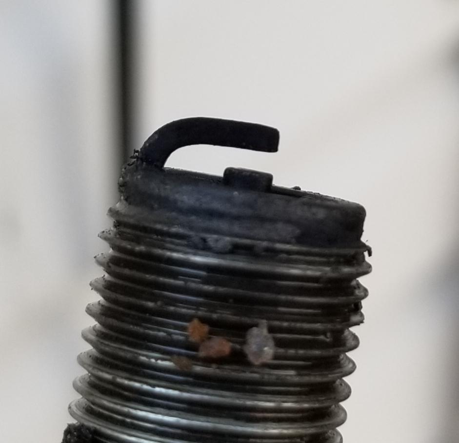

My first voyage into servicing my own engine. My 85 vanagen. usually starts without any gas and bops around town so nice. But a few times it hasn't wanted to start then I put some gas and perhaps flood it (once it started easy 20 min later once I had to wait overnight) the over night time it backfired on start up. I pulled the plugs. Here is a picture of one they all look the same. I am not sure if this matches an oil laden plug or if its just black. Also the gapping was off between the 4 plugs one as tight at .25 one as wide as .37. Would this cause starting problems?
yes there is some dirt on the threads I will wipe it off.
Holy crap I want to get this van on the road.

Definitely will cause start problems - get some new plugs and replace, then practice cleaning and gapping on the old.

and should I expect new plugs to oil up fast? Im not sure if you ment these are oily
WELCOME TO THE VANAMADNESS!!
happy to hear and good idea with the practice. What do you recommend for best plugs. I am not a perfectionist but am scared to death to drop another 1,500 on this van later.

.25 is a quarter of an inch and .37 is 3/8ths of an inch. im pretty sure you mean .024 and .037? i hope.

NGK Spark Plugs - BP6ET are what I used and are favored by many.
Here is one handy source:
https://www.ebay.com/itm/132562308638
Harbor freight makes a decent plug cleaner if you have compressed air available.

plug gap is .026"+/-.002" Smile
NGKs, hands down.
BP6ET--which you wont need to gap--is my best choice.
BP6ES--which you also won't need to gap--if you like the older style.
il like the P ones with the Projected electrode Smile
spark plugs and have the injectors cleaned/flow tested. change the injector seals while you're there and you've got a good starting point.

PostPosted: Mon Jul 08, 2019 9:40 pm    Post subject: Re: are these plugs oily? and what about gapping? Reply with quote
NGK BP6ET--which you wont need to gap--is my best choice.
Long used those, too, and just put a set of these in. All were above the recommended gap, one was sloppy enough I'd guess .036" or better.
Closing a gap is never as nice as opening one. Smile
And Yes, your plug looks quite rich. Are they all like that?

yeah I did everything carefully and this morning it started up . Then I drove it 20 feet and stopped it cause I forgot something in the house. When I tried to start it a minute later It coughed instead of starting. 20 minutes later it started.
I will follow through with your next steps after my epic bay window journey . Is there a map of recommended dub mechanics for fools like me? I will drive from shop to shop till I get to Cleveland.

The thickness of your finger nail, is close, most think plugs come prepared gapped, yes they do, but NOT for a vanagon, they are pretty gapped for the car the manufacturers think will use the most, modern ignition systems are more powerful, and can jump a big spark across a bigger gap, with a less powerful ignition system jumping a bigger gap, will weaken the spark.
Use NGK BP6ET plugs Wink
