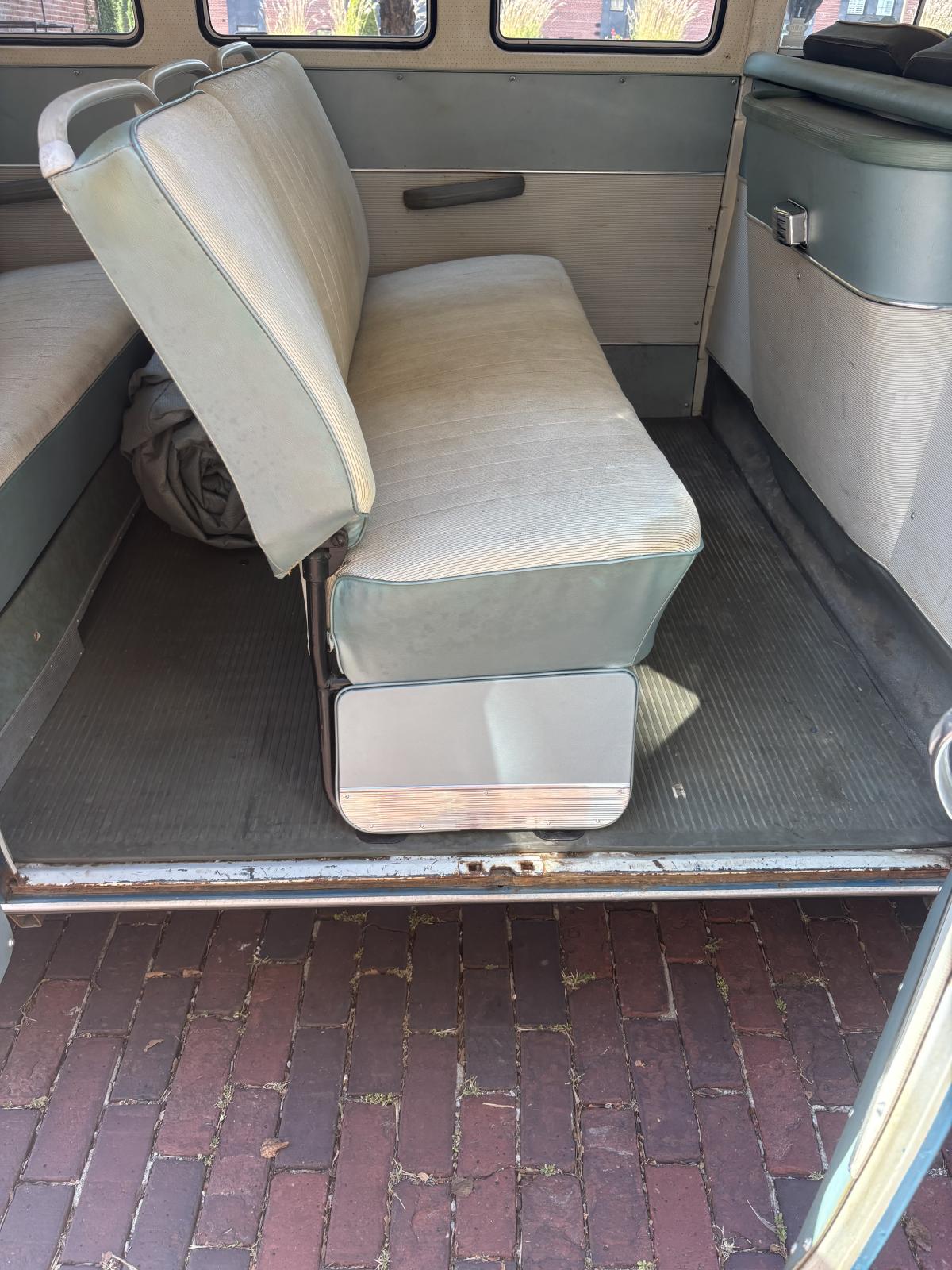

The following pics have been posted by @alex_vw_holmes on Instagram in June 2019.
He kindly gave me permission to post them here.
The photos show the heavy used interior of a pretty rough 1967 13 window deluxe bus:
And also he had some more interesting pics of another 1967 sea blue deluxe with walk-through that he posted in March 2020:

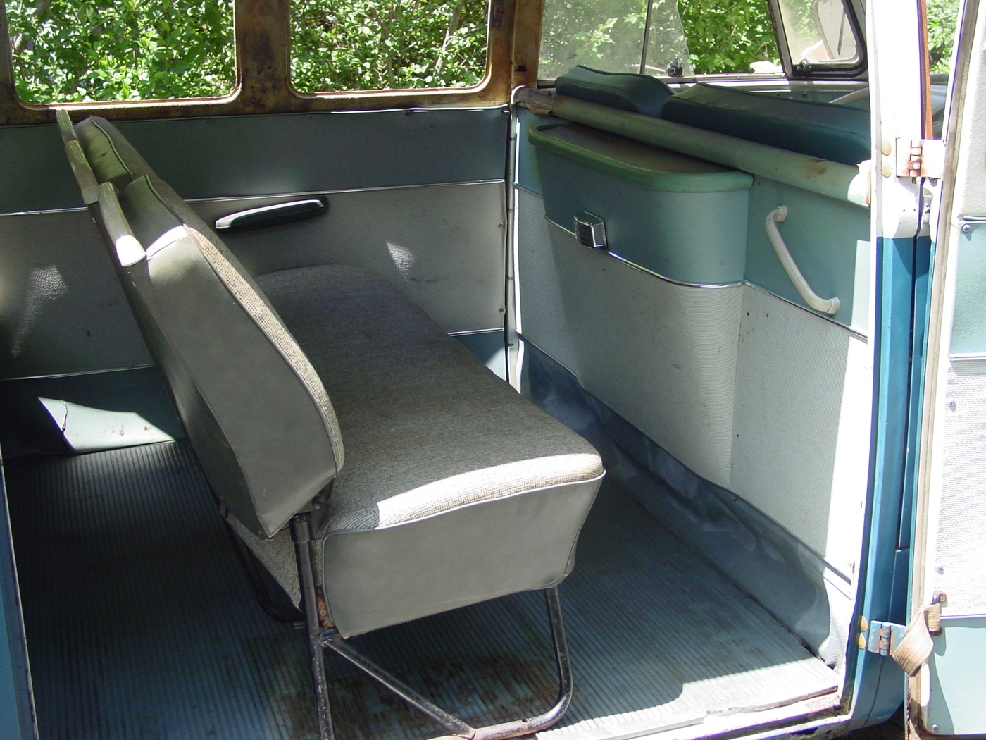

Thesamba User "Kombi65" posted some interesting photos of his original interior bus on instagram as well.
It is a 1966 13 window deluxe with walk-through.
You can find him via @genesvdubs and of course he gave me permission as well.
The exact sources to the photos can be found in the photo description of my gallery.
2017: front seats in original condition
2018: rear bench can be seen
2024: front seats received a re-upholstery
This bus was issued in "VW Camper & Bus Magazine February 2021" (Volksworld) - page 34.

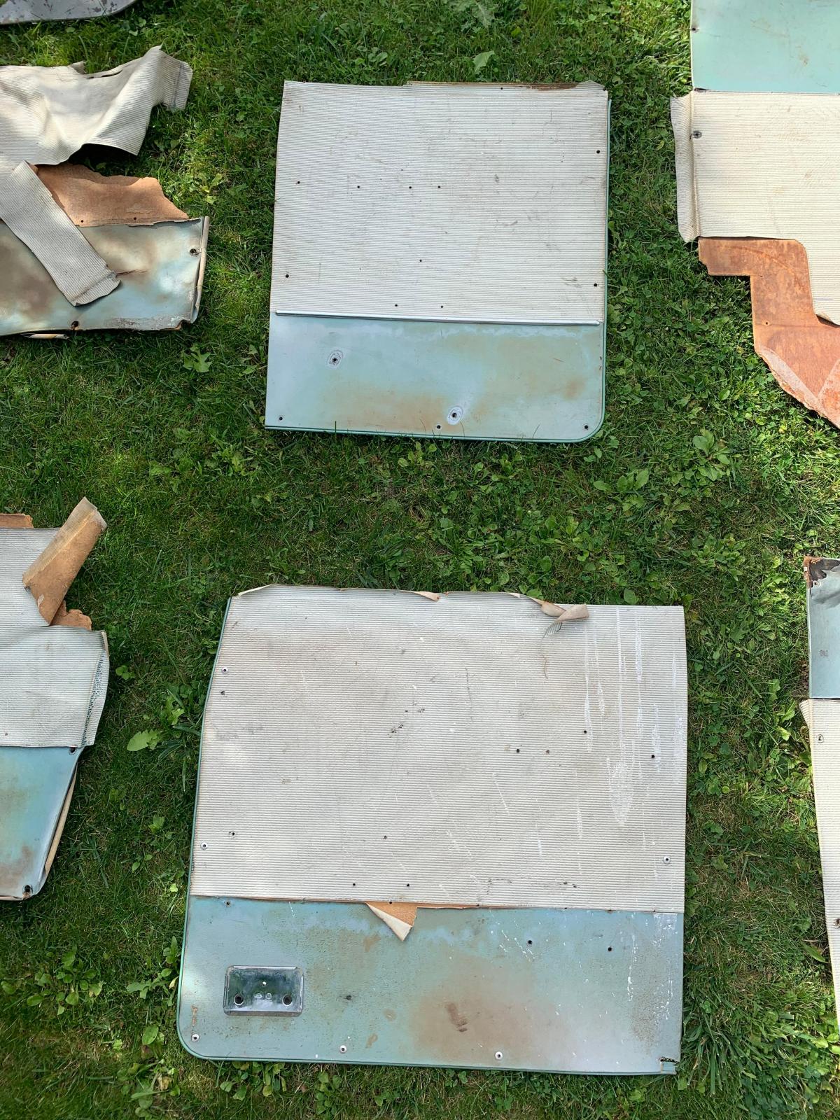

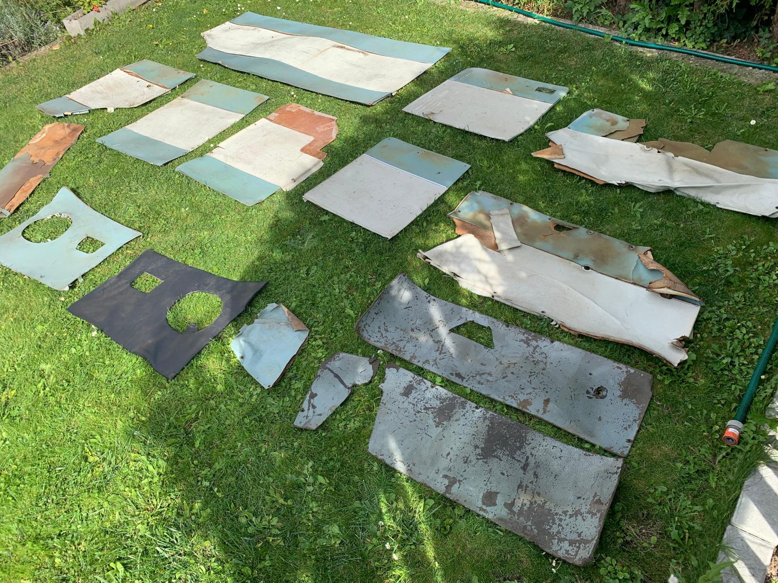

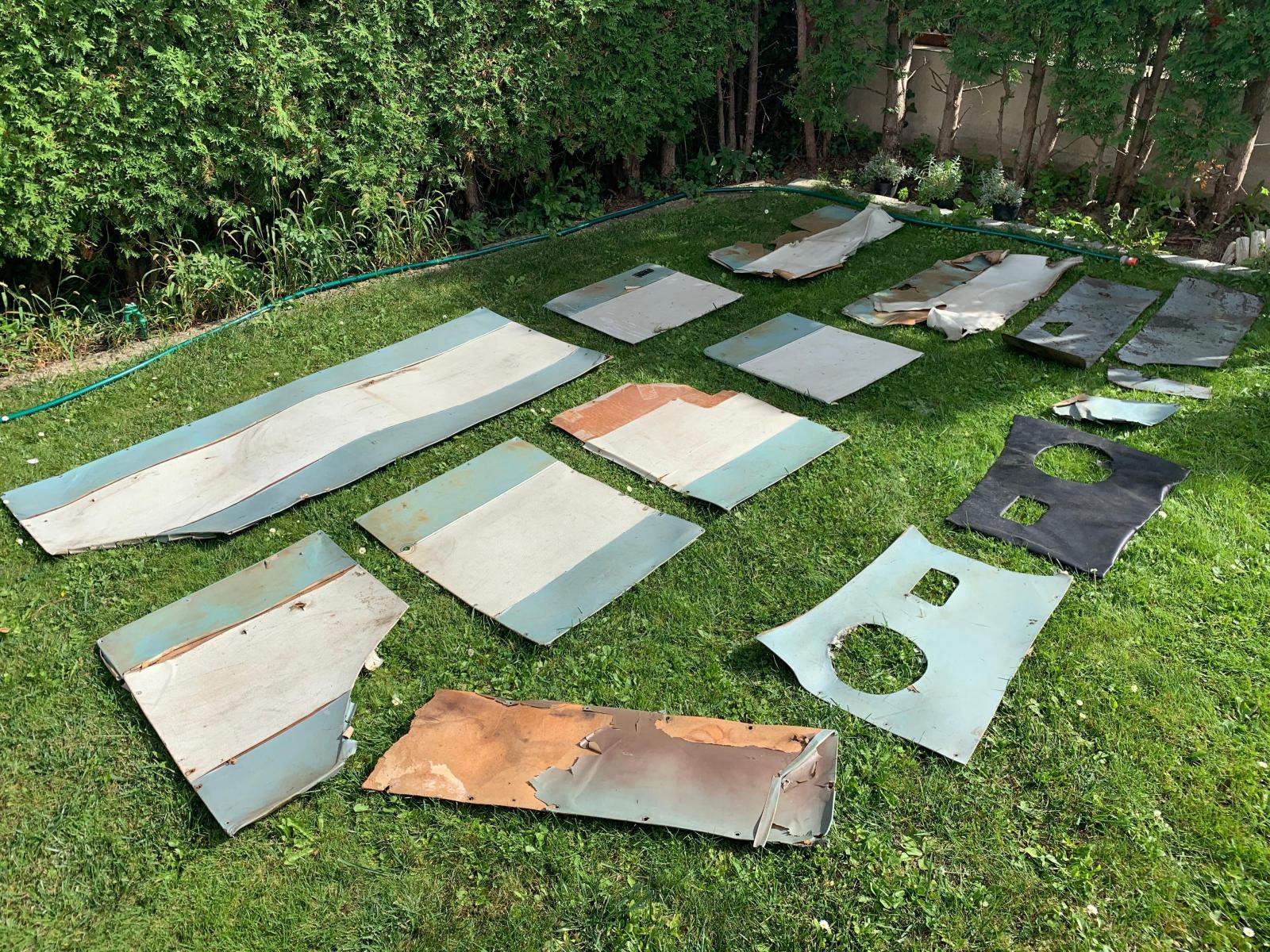

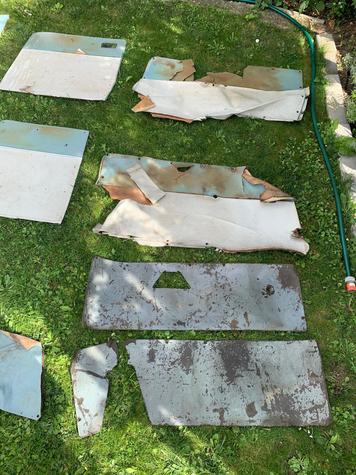

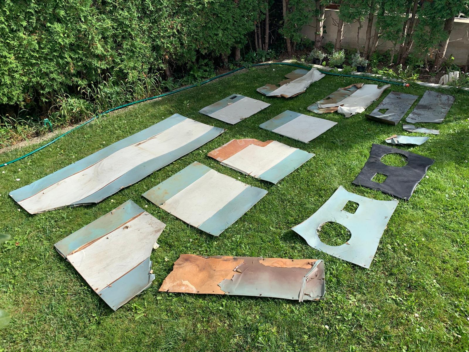

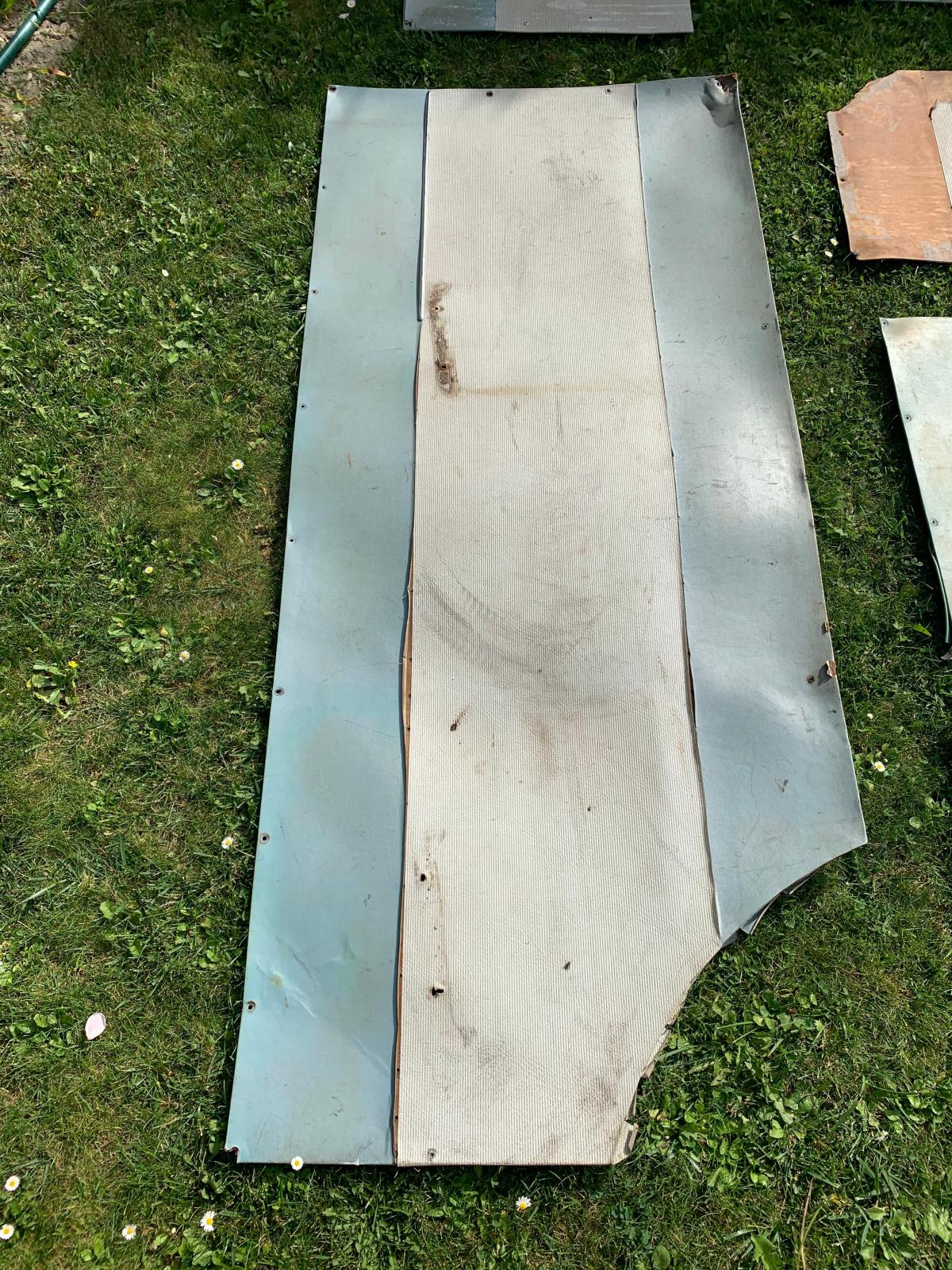

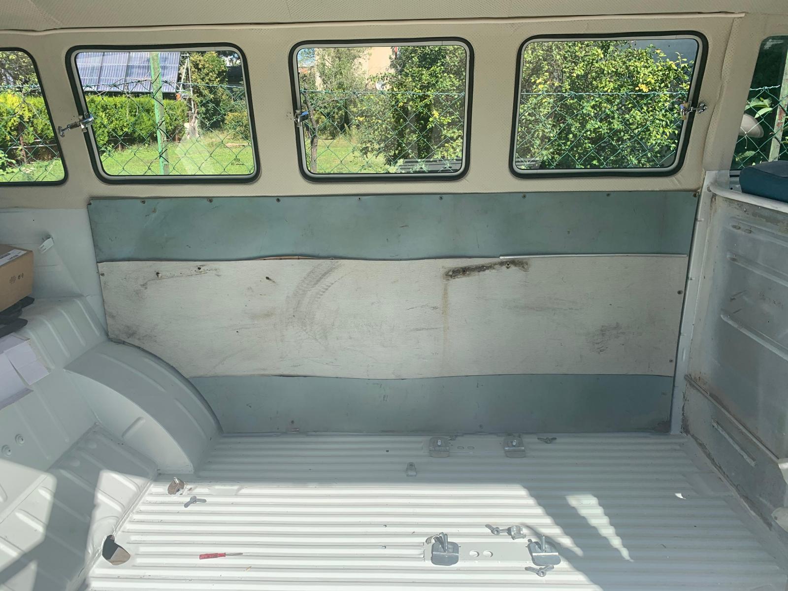

All the old interior panels that came with our own bus (previous owner had already disassembled them):
some pics as we test-mounted the old interior panels on our bus:
(during restoration, headliner material is already new)

Some more pictures that i found in our own resto sub...
front cab mat and kick panels:
walk-through rubber floor (diamond grid --> click and zoom into the photos!)
--> in this sub you can learn more about the grid differences of the walk-through mat, which has a diamond pattern.
and something that i learned today while posting:
the compartment under the dashboard also was glued with the aero papyrus fabric (blue)
(you can still see the yellow glue stain rests on the pic below)
Source: original thread

Love this thread. Just recently purchased this og '67 13 window. Above average og interior with almost flawless headliner except front seat needs attention. Just received sample card from Deutsch Polster
'57 sunroof Standard
'63 15 window
'65 Westy SO44
'67 13 window
KWZ
Joined: July 11, 2004
Posts: 1381
Location: St. Louis, Missouri
KWZ is offline
PostPosted: Sat Nov 01, 2025 8:09 am    Post subject: Re: Info: Original Aero Papyrus interior on Sea Blue Deluxe Buses Reply with quote
Weird all the grab handles in my bus (and a few others on here) are not blue. I am almost positive they were never swapped out.

PostPosted: Sat Nov 01, 2025 9:09 am    Post subject: Re: Info: Original Aero Papyrus interior on Sea Blue Deluxe Buses Reply with quote
From what I can tell, the middle seat grab handle and bulkhead grab handle are blue (Steel?) with black ends for 1966 blue/white deluxe buses, but white for the 1967s.
I am not sure exactly when the change was, and have not looked it up in the parts list to see if a change is listed there. Is yours a 67?
The blue (strato?) front floor, cargo floor, and seat stand mats, and bulkhead lower rubber are all not available new, but add to the ambiance.
