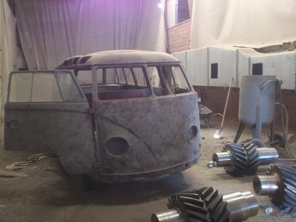

I found a person on facebook who has a 1950 Barndoor Deluxe which
is certificated from wolfsburg. I just want to share with you. I don't now the last condition of the bus. Updated photos will be share here Smile

NOT a 1950

it's possible to be 1951. I will inform after contacting with owner of bus.

Yes, find out the VIN #

screw the bus.... please tell us about those giant gears?!

Late 1961-early 1964 cab doors, 1963 and later front door window assemblies, reflector dimples on both rear corners, not likely any older than mid 1952.

Not a 1951 either it does not even have deep skylights

I knew about this bus for years. Said to be a 51.

Yes, there have been some pictures posted before of this bus.

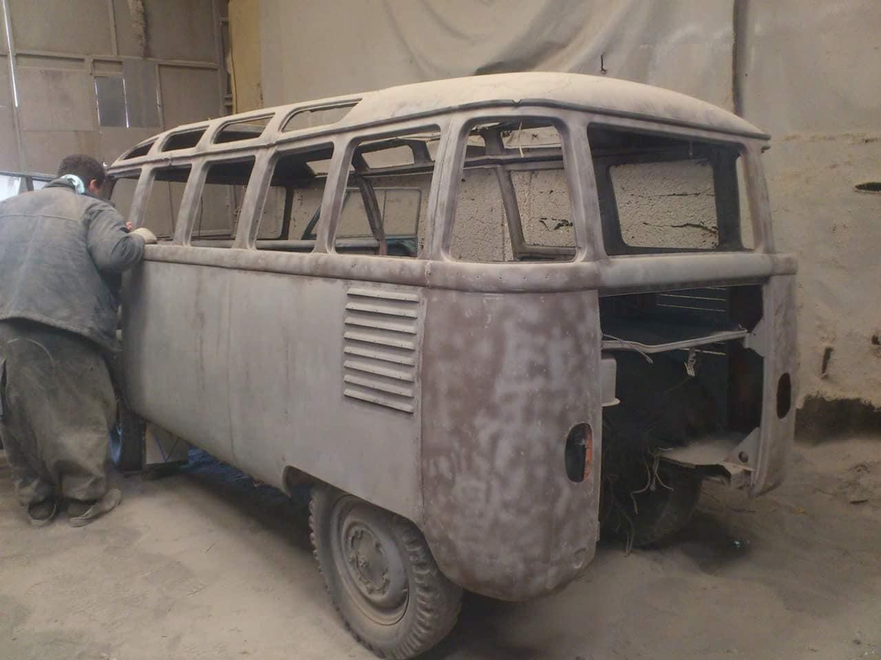

No sign of any early rear bumper trim holes either. 53/54/55?
Looks to have been picked up by a grabber crane at some point.
Please get us the VIN. A good shot of the engine bay would confirm early/late.

Yes, spare tire tray drain tube and trans cradle tube shape will help, too.

I've been in touch with the owner a few years back, who always said the bus is a 51 but from the pictures I have it is FOR SURE 53-55....
Late dashpod holder, long e-brake handle, no deep skylight etc etc
Lots of work required... Rolling Eyes

Why no semaphore holes?

Also is that weld marks through the centre of every skylight opening??

This bus would look really cool rolling on those gigantic gears. Just think of the terrain it could (not) cover!
Is there no VIN # on this thing that could put the question of YOM to rest?

Kombi dashpod on a deluxe?

I think that's how it looks without the long Deluxe pod in there?
The base structure is the same.
