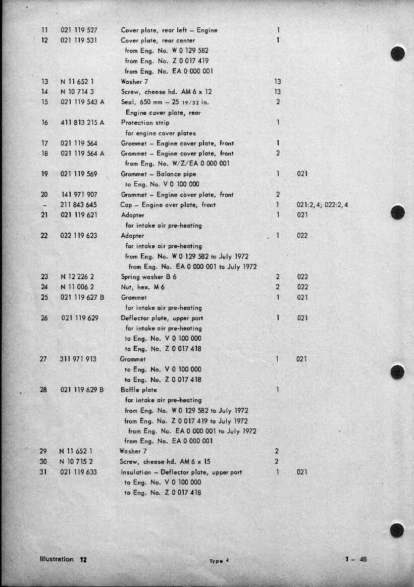

1972-73-74 Type IV (4) Engine Tins
75-78 Type 4 Engine Tin
Thanks for the links, they've been already very useful in the past. However, on this one there is no talk about the different versions of front tin, and the microfiche only shows one diagram.

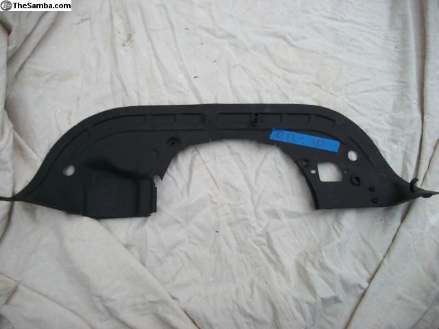

The pictures on that thread show yet another subvariant of my top picture:
Picture from Samba member pantone149, as far as I can tell
The squarish hole on the right side identifies it as a carburetor tin.

PostPosted: Fri Jun 29, 2018 6:11 pm    Post subject: Re: Type 4 front engine tin variants Reply with quote
#43 Baffle plate for Intake air pre-heating

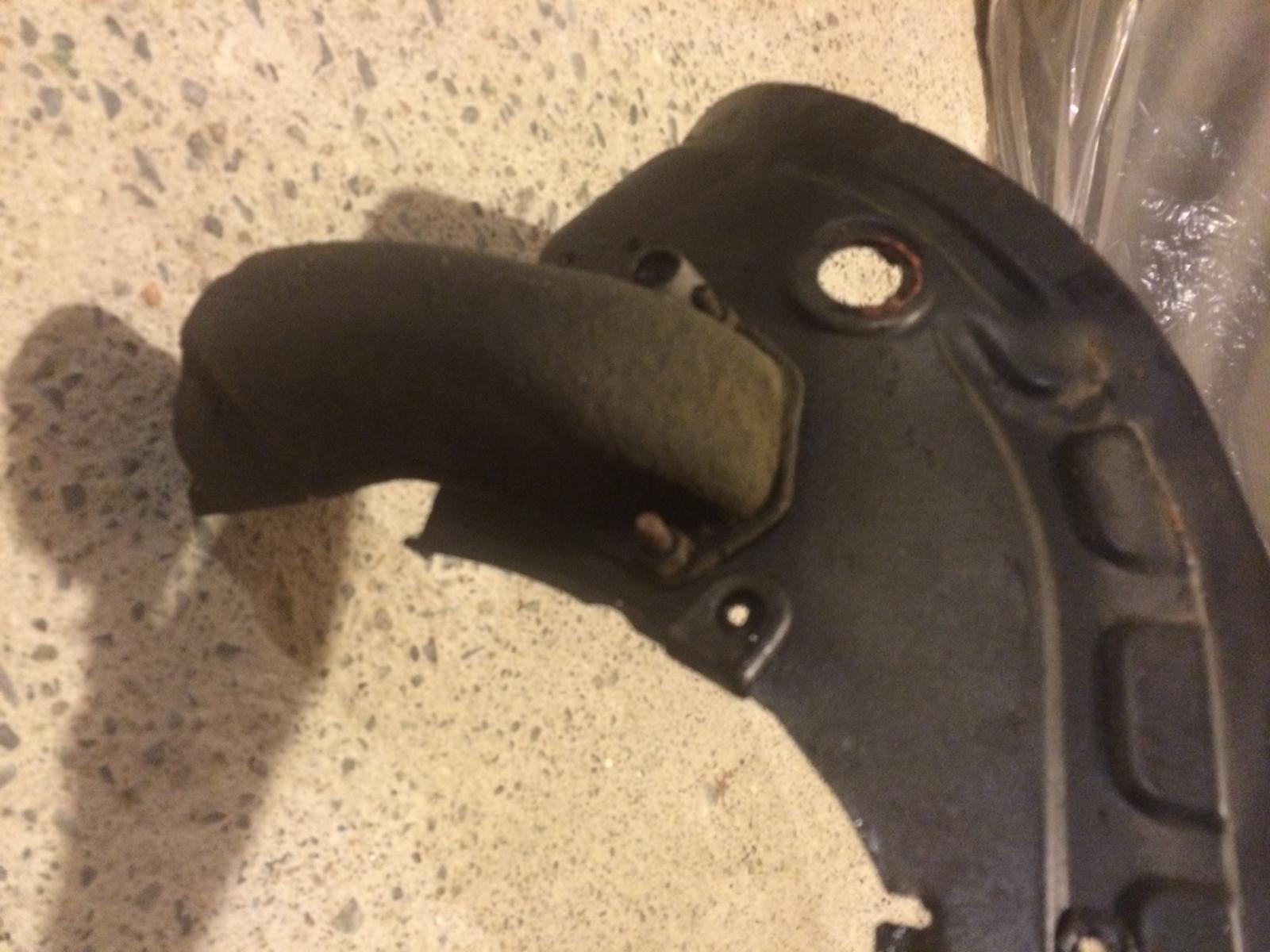

Tcash wrote:
#43 Baffle plate for Intake air pre-heating (021 119 629 B)
For those, like me, who didn't know what its function is:
OrangeZA wrote:
The twin carb system does suffer from inlet manifold icing if not set up properly [...]. The engineers developed a preheating system that can take warm air from the bottom of the engine and feed it into a control box where it meets cold air fed in from a hose stretching to the right hand air intake.
Here's a picture from macdonaldneal that shows it in place. It also shows what would seem to be a pipe that goes through hole #7:
