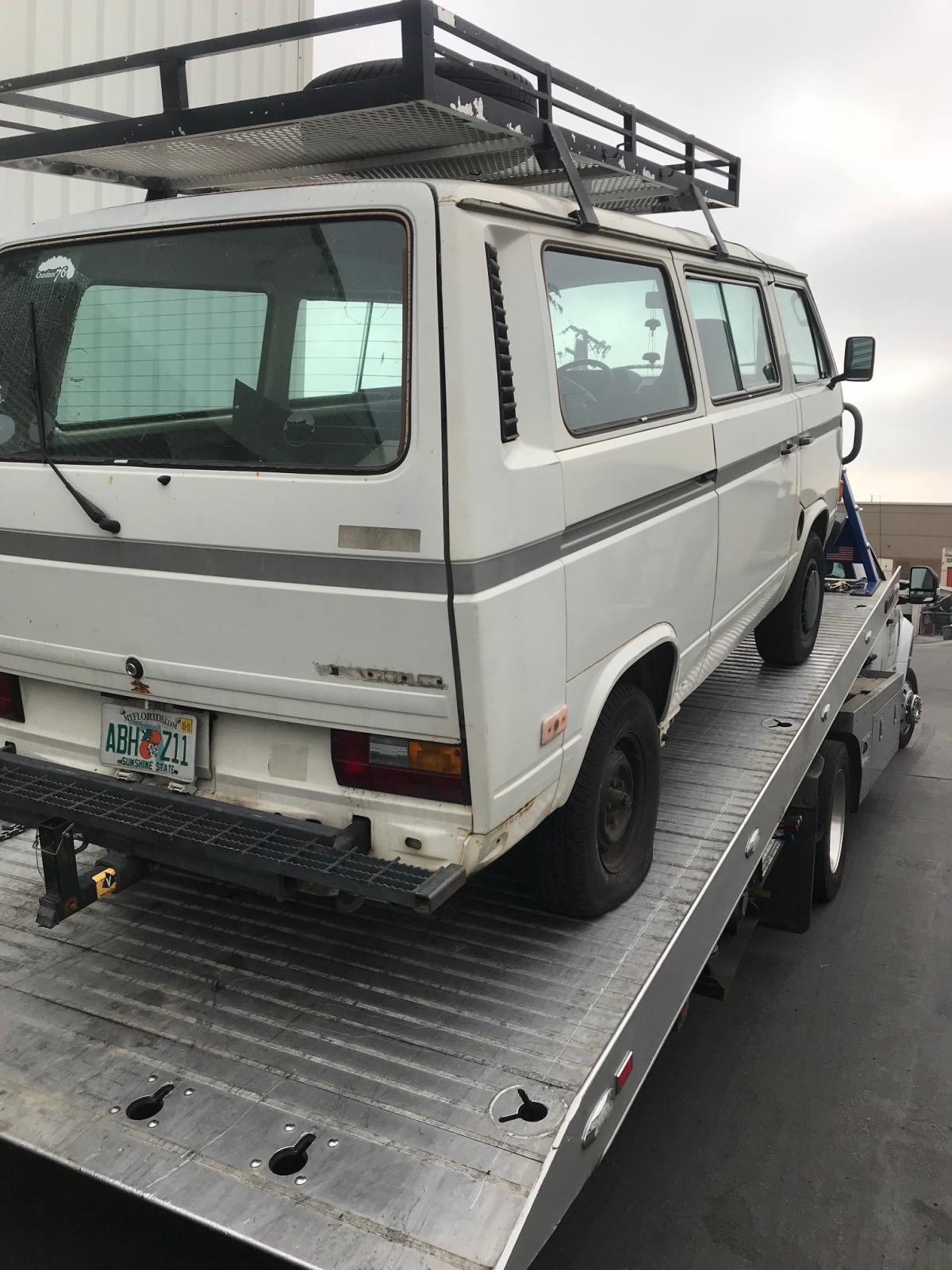

After searching far and wide… looking at The Samba, Craigslist, Facebook market place, offer up and LetGo, we are finally taking home a 1985 Vanagon boat anchor. The one I was able to find in my budget is a bit of a work in progress. It started up fine and runs perfect until it gets warm… then it’s like it goes into limp mode… not even sure if this thing has a limp mode but now the real journey begins.
Time to update the AAA card and make sure I have plenty of tows… because it’s getting towed home

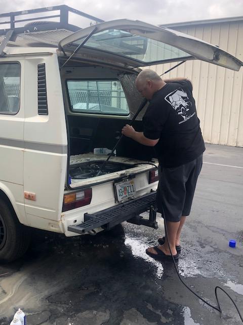

Well… I’ve started to work on my Vanagon and so I bought a Bosch Temp sensor off Amazon and put it in… base off a few conversations I’ve had with people. It seems to run way better… I was able to drive it around the block and find out the brakes… well let’s just say my foot was on the floor and the e-brake didn’t seem to work either. But it was running fine until the oil light came on… it started to flicker and then finally stay on only at idle. It also started to hesitate after warm.
To start I’ve pressure washed the motor compartment out so I can see where my leaks are coming from.
After:
It seems to be leaking from a valve cover gasket and the push rod tubes.

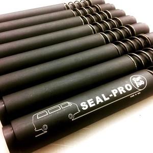

Has anyone ever used this push rod tubes? what do you think?
I found them online and at a few stores like Van Café or even Vanagain. I called and talk to Robert at Fast Fab.. He was super nice and was a lot of help..He explained how they work and about the seals they use. He told me to make sure I needed them before buying them. They happened to put me in contact with a few other good contacts for my vanagon. One of the gentlemen that he put me in contact with was Mike from Rancho Transmission… even though I didn’t need a transmission yet, Mike had all kinds of information for me and gave me the idea to have a local shop called Mike’s Foreign Auto Repair to give my vanagon a once over and give me a check list of things to fix. So off it went back on a tow truck.

For what it's worth, my valve covers leaked so much, that I thought it was a much bigger problem. I bought cork gaskets from aircooled.net and new bales (metal retainer bars) and 100% solved.
I used only grease on the cork seals, no sealer, etc. Aircooled also sells new valve covers (same as Type 1 Bug engine, BTW)
