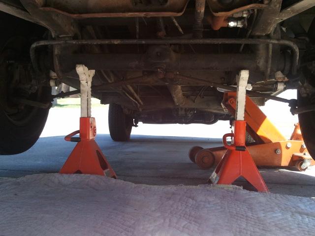

3. Jack up one side of the vehicle and place a jack stand under the front Beam on that side. Note: the jack stands are placed inward slightly to miss the grease fittings located on the back of the Beam. Lower the jack slightly, to put the weight of the vehicle on the jack stand. Now shake the vehicle, to be sure it is secure on the jack stand. Move to the other side and repeat the procedure.

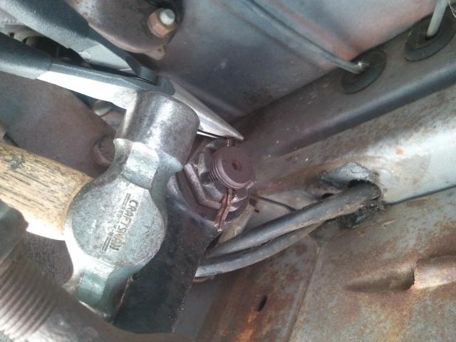

5. Use needle nose pliers straighten the ends of the Cotter pin.
6. Remove the Cotter pin with the Extractor tool or Needle nose pliers and a Hammer.

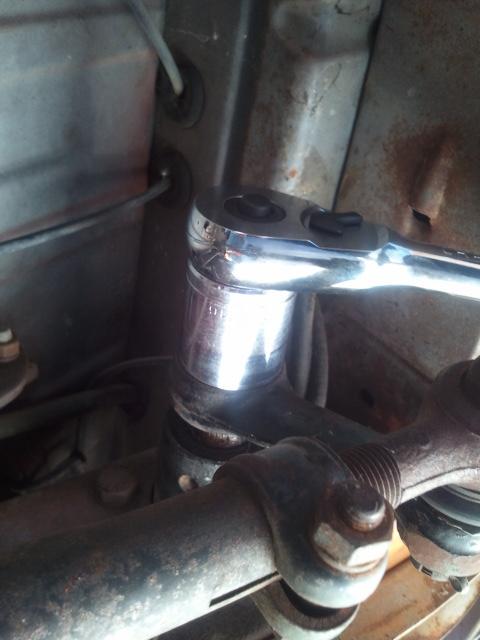

7. Use 30mm socket with 1/2" drive ratchet. Remove the Drop arm Nut.
7a. An Adjustable Spanner can be used. But keep in mind, this Nut can have as much as 80 Ft/lbs of torque on it and be rusted in place. I had been spraying the fasteners with rust penetrant for 2 weeks in advance. Don't round the nut off, go beg borrow or buy a 30mm (1 3/16") socket.

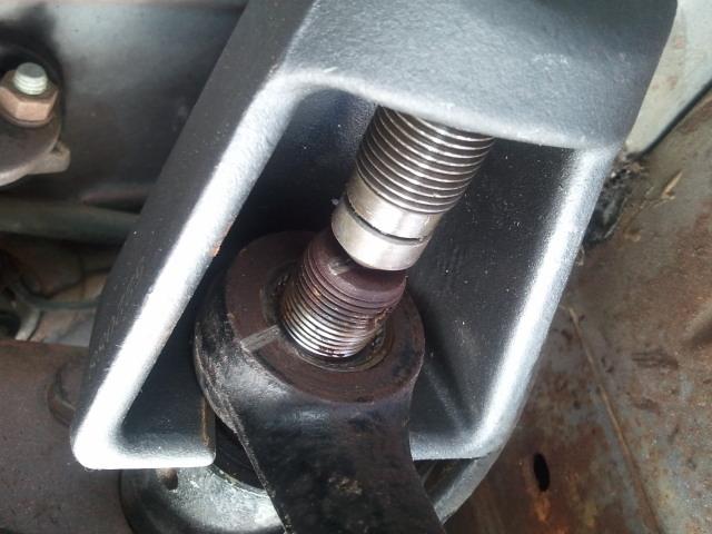

9. Position the OTC 8150 puller.
10. Pull the Drop arm with the otc 8150 puller, 22mm socket and 1/2" drive ratchet. Remember I presoaked for two weeks.

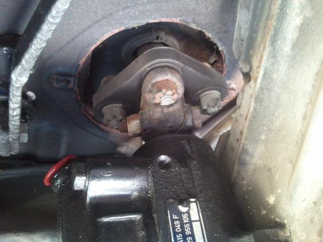

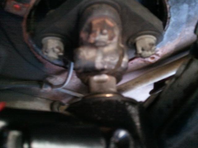

11. Remove the Steering box flange, Pinch bolt and Nut, using Two 13mm wrenches.
12. Steering box flange Pinch Bolt completely removed. Push the Steering coupler with flange straight up. It may take some prying?
Position it to the right of the Steering box shaft.

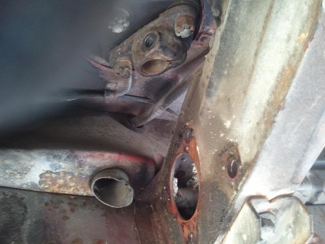

13. Using 17mm socket, 6" extension and 3/8" drive Ratchet. Remove the three steering box mounting bolts at 10,2, and 5 o'clock.
Loosen the mounting bolt located at 7 o'clock until it can easily be removed by hand.
The loose bolt at 7 o'clock will stop the steering box from falling out on your head. Stranger things have happened.

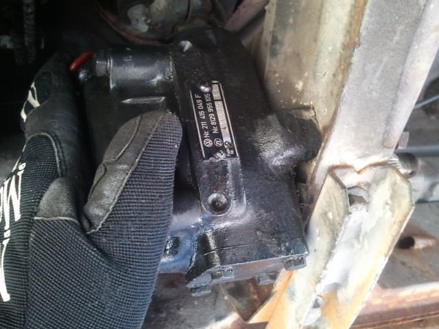

14. With one hand supporting the Steering box remove the last mounting bolt. Push the Coupler with flange up out of the way, rest it on the right half of the shaft if you have to. Now pull the Steering box straight out.
15. Steering box removed.
16. Clean the Steering box mating surface and area around it. This will make installation easier as well as leak detection in the future.

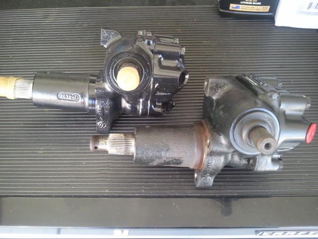

17. Compare the New steering box to the old one. Mounting bolt holes in the same locations, Worm and Peg shaft splines are the same.
18. Note the rubber Worm spindle cap with the nipple on it and the raised Centering mark cast into the Steering box. These where added June 1971. The New box is missing this and the Red fill plug.
19. Note the Nipple on the Worm spindle cap for center is at 9 o'clock and the relief for the pinch bolt in the Worm shaft is at 12 0'clock.

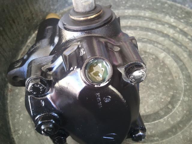

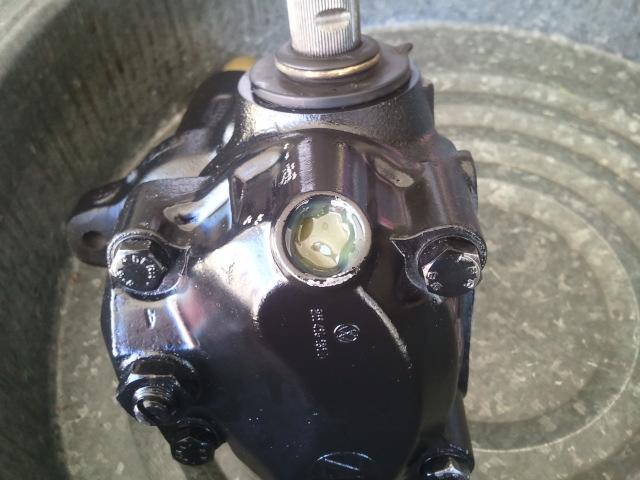

23. Time for some Steering box lube. What ever you choose you will need 9 2/3 oz (285.87 ml).
More Lube information located here.
Link = Steering Box Lube
24. Injected using this multi fit nozzle I got from my Friendly Local Auto Parts Store.
25. Piercing the air bubbles all the time.
26. 20 minutes later, full to the brim.
27. Ok time for lunch. Shrimp fried rice made by my lovely wife, with a salad of Iceberg lettuce, Union slices, Julienned carrots, lightly drizzled with The olive bar black currant balsamic, with a splash of Red wine vinegar, topped with Parmesan Romano & Asiago cheese. Paired with Lemon water. For desert a half a Watermelon. Eaten with a couple of AFM flap opening tools.
28. Back from lunch and my afternoon nap. 2 hrs have gone by and the Steering box lube is still at full brim.

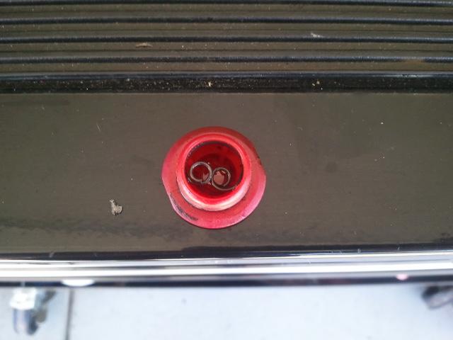

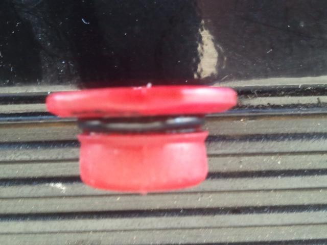

29. Note the tension Spring and O-ring on the fill plug.
30. The Grey line indicates the amount I used of the 500ml bottle. With some burping and spillage waste.

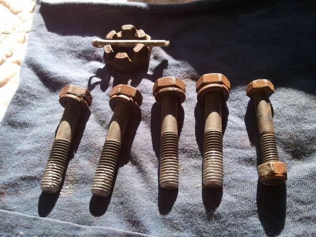

31. Fasteners laid out with Anti-Sieze applied.
