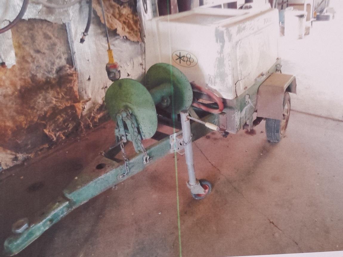

Got this new toy, it needs some work and a few parts. I have tried to search and keep coming up empty.

Any help greatly appreciated.

Interesting find. Your post didn't say what you are missing. Only thing I see is it appears to be missing linkage from the governor to the carb. Be careful with working with screw compressors. Make sure the regulation system is in good working order and the separator tank is in good condition with the proper oil. If the sep element is bad you could blow all the oil out the air discharge and damage the compressor. There are many other components in the regulation system that can go bad from sitting and could cause airend failure.

ZOZO, that would be great,THANKS! The exhaust on #3 is rotted, wrong dist cap, no gov arm, wrong gov belt, and misc. Are you any where near Marion, a great friend of mine lives near there? I am wondering year and specs. I would like to restore this compressor to an original appearance. The compressor makes great air and isn't blowing any oil.

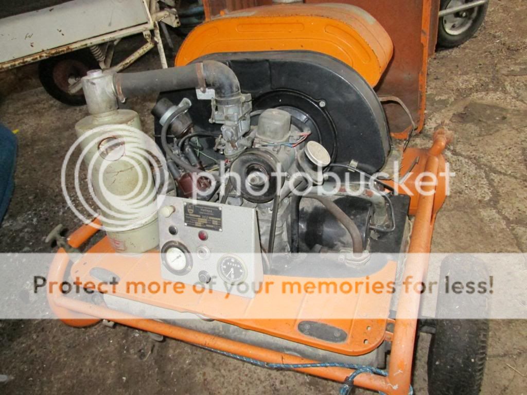

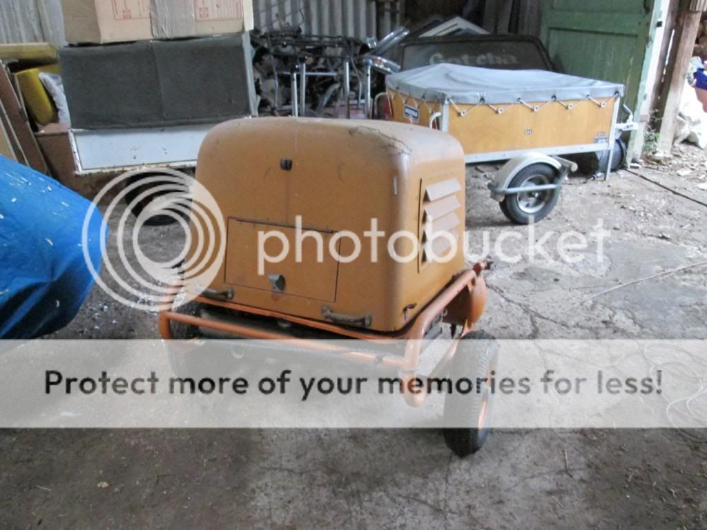

hi ive had a few industrial vw engines over the years this is one i still have and runs very well made in 1966

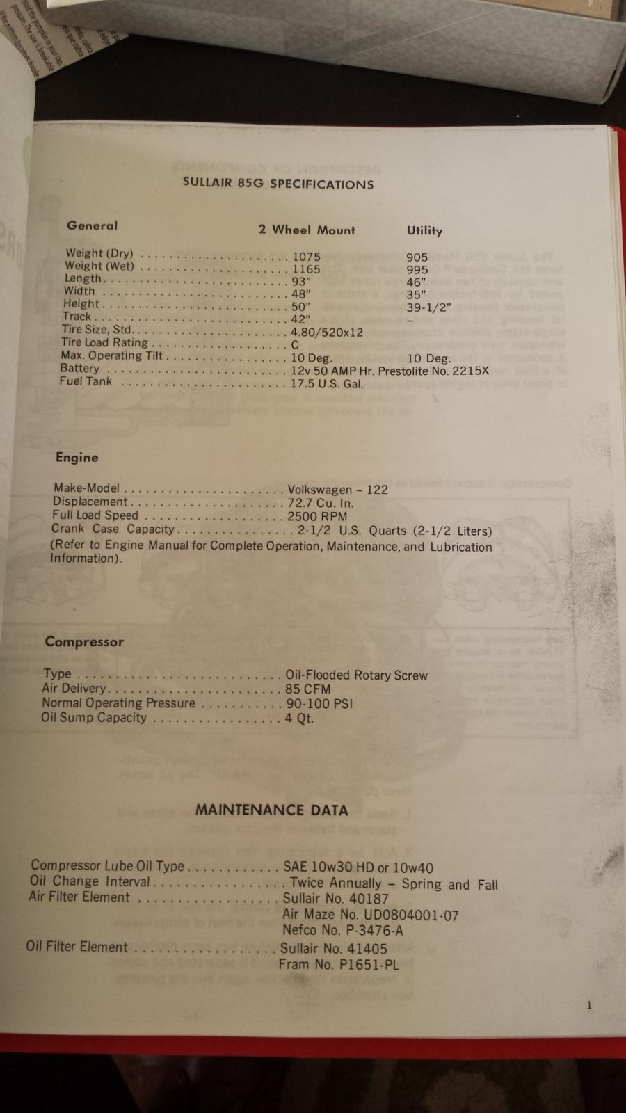

Two weeks into my marriage and I received an amazing birthday gift from my now Father-in-law. He purchased the unit from the local city maintenance tool sale in Eastern Montana. He surprised me by mailing me copies of the manuals and some photos for my birthday letting me know it was mine! Smile I hope in the next year or two to go pick it up. It's a cool piece of now functional Volkswagen art in my opinion and something I will treasure for a long time!
I will send the manual to Everett to see if he would like to upload them to the site. I can also make copies of everything for you VWRICK69. It looks like we have the same unit, so once I get me hands on this one we can use it for reference; it seems to be well, intact and unmolested.

Very old thread but how does someone get a copy of that manual?
PM me your email address and I'll email you a copy.
