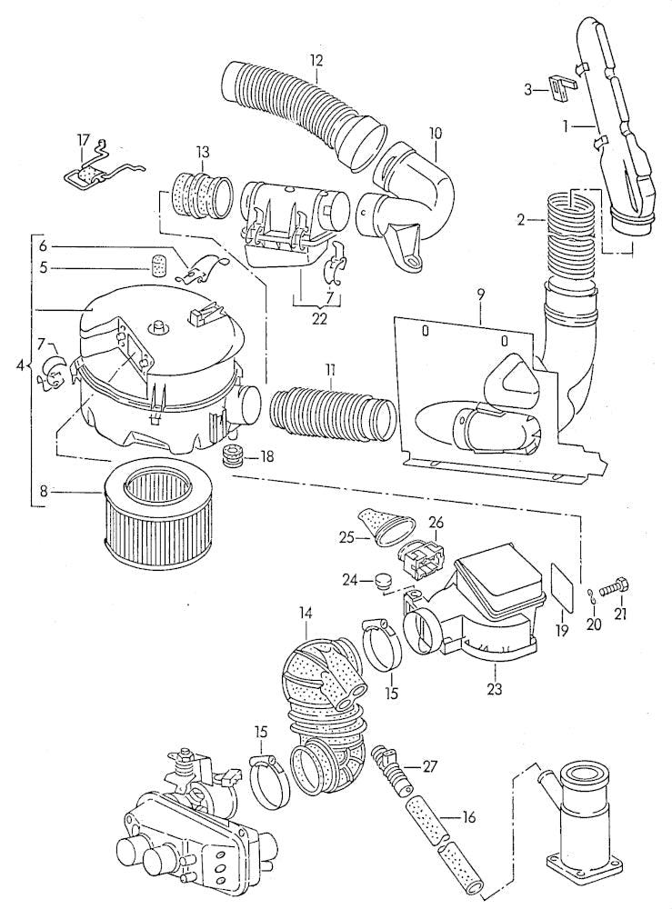

Hi all,
As part of me fighting some idle issues and taking apart things that connect to the throttle body I am wondering that part 27 is in the attached image. It appears to be a sensor but in trying to google the part, I couldn't find it. GoWesty also doesn't have it(according to the schematic parts list). I cleaned it with carb cleaner as it looked pretty basic. Does anyone know what it is and if it's available or is it needed or not? Finally...if it's needed and just ok to carb clean(if not available)....do you know which way it attaches to the boot? Is it long barb-side into the boot or long barb side into the hose from the breather tower? Thanks in advance...

PostPosted: Tue Nov 11, 2025 6:27 pm    Post subject: Re: What is this part and is it needed and which way does it go? Reply with quote
It's a heating element and also a restrictor for the crankcase vent to the intake. If you are in a warm climate, you could probably due without it. But, you may still need some sort of restrictor.

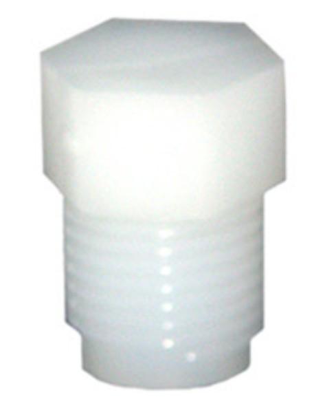

I did have a idle issue at one time -- it would tend to 'hunt' or 'surge' at idle. I did many things, diagnostic, adjusting and parts swapping in search of a smooth idle and better mileage so I cannot say for 100% sure which changes smoothed the idle but I think I know what had the biggest effect.
On the 84 the hose from the breather tower to the S-Boot is just a plain hose. At some point VW added a device midway in that hose that (I think) had a heating element to prevent icing and also a restriction to reduce flow.
I duplicated the restriction by inserting a plug into the hose with a 5mm diameter opening drilled thru it.
The plug (hole not yet drilled):
The UPC label from Ace Hardware:
The threaded end of the plug I inserted into the exit fitting on the breather tower, then slipped the hose over it.
Of course, if 85s came with a restriction already in place (I have no idea) then this is not going to help you.
