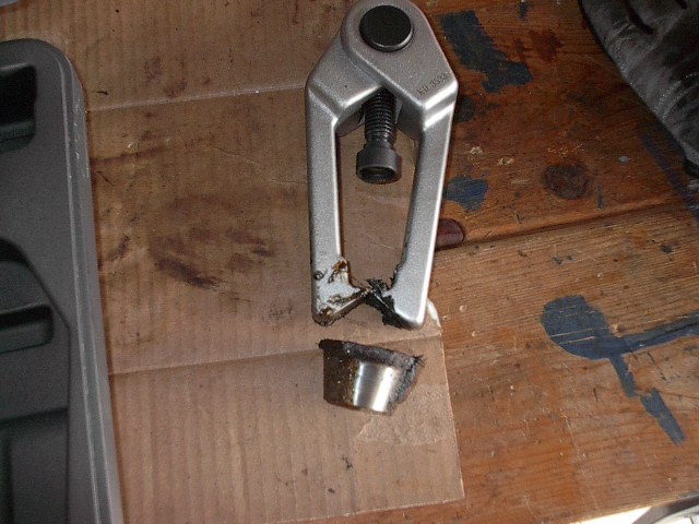

This is an old post, but I'm having a hell of a time getting number 19 separated from the upper ball joint on both sides. I purchased a refurb set of torsion arms with ball joints pressed in from WI. I just can't get these seemingly non threaded spacers off the old ones.
What's the trick?

Shouldn't be that hard...I used this type of puller and it did not take too much to pop it off.
