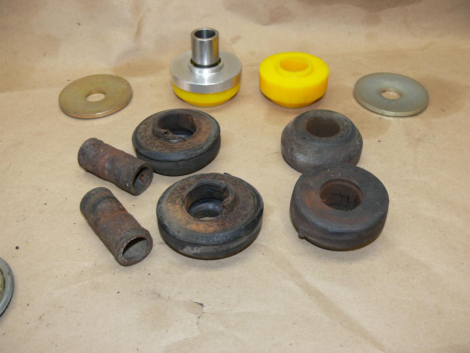

This is the wear levi is describing, on this one it's just starting to wear through the inner sleeve but if left too long the rod will start eating the frame.
(the portion that's missing is steel not rubber)
And the worn out bushings/sleeves with Powerflex replacements in the rear.

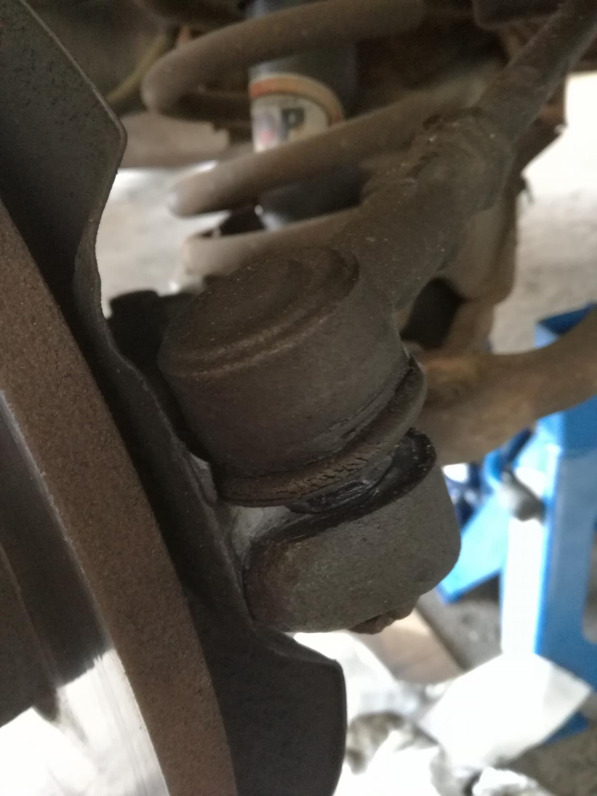

are you talking about this auction? thank you for your precious time
Photo 1 or photo 2 ?
1 :
2:
Thank!

It is the right had end of the radius rod in photo 1, the hole in the left hand end is where the drop link for the sway bar is meant to go. Photo 2 is the tie rod end.
