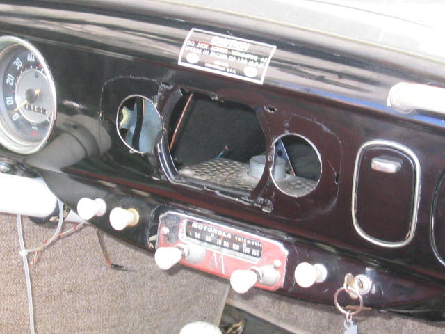

Here's what you need to do to your dash. Not a pretty sight:

Coad's picture is about right------What it doesn't show is the sprained wrist when that drill bites. Never again!!!!!!! Confused

I've just picked up a whole bunch of original 1950's VW tech bulletins & VW themselves reccomend cutting a f*ckin great hole in your oval dash. It even shows pics & tells you how to do it. EEK! Shocked
