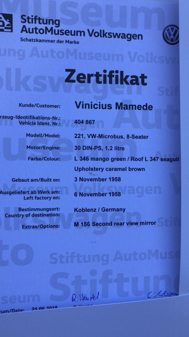

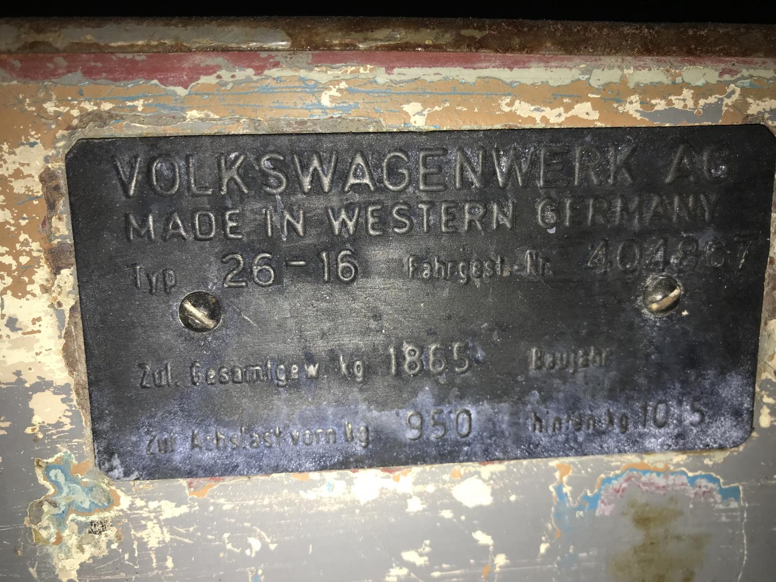

Please, give me a help.
I have a bus with Vin Plate
But my certificate is :
What model my car is? The certificate is wrong or my Vin plate was changed?

what do you actually have? a single cab?
the vin number is also on the body, make sure it matches

Posts: 71826
PostPosted: Sat Aug 04, 2018 10:14 pm    Post subject: Re: Typ26-16 Reply with quote
It looks like the factory made a mistake on the letter, I would contact them to correct it. Tell them you have a Double Cab.

PostPosted: Sun Aug 05, 2018 4:51 am    Post subject: Re: Typ26-16 Reply with quote
I supposed, but was need more information.
Here, in archives, the type 26 is for single cab or double cab. Is right EverettB?

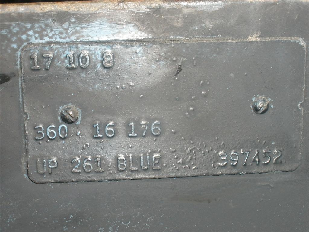

The earliest double cabs were coded 261 like a single cab instead of 265 like a double cab. The photo above is a m code plate frame a October 1958 double cab. Does your bus still have the m code plate? Does your bus have belly pans or the remnants of belly pans. The really early double cabs came with belly pans. Please share some pictures with us, we would love to see them.

Yes, that is correct and early ones have the 26-16 on the VIN plate.
Also everything that ronjohn above said, you have a very early Double Cab, it would great to see some photos.
