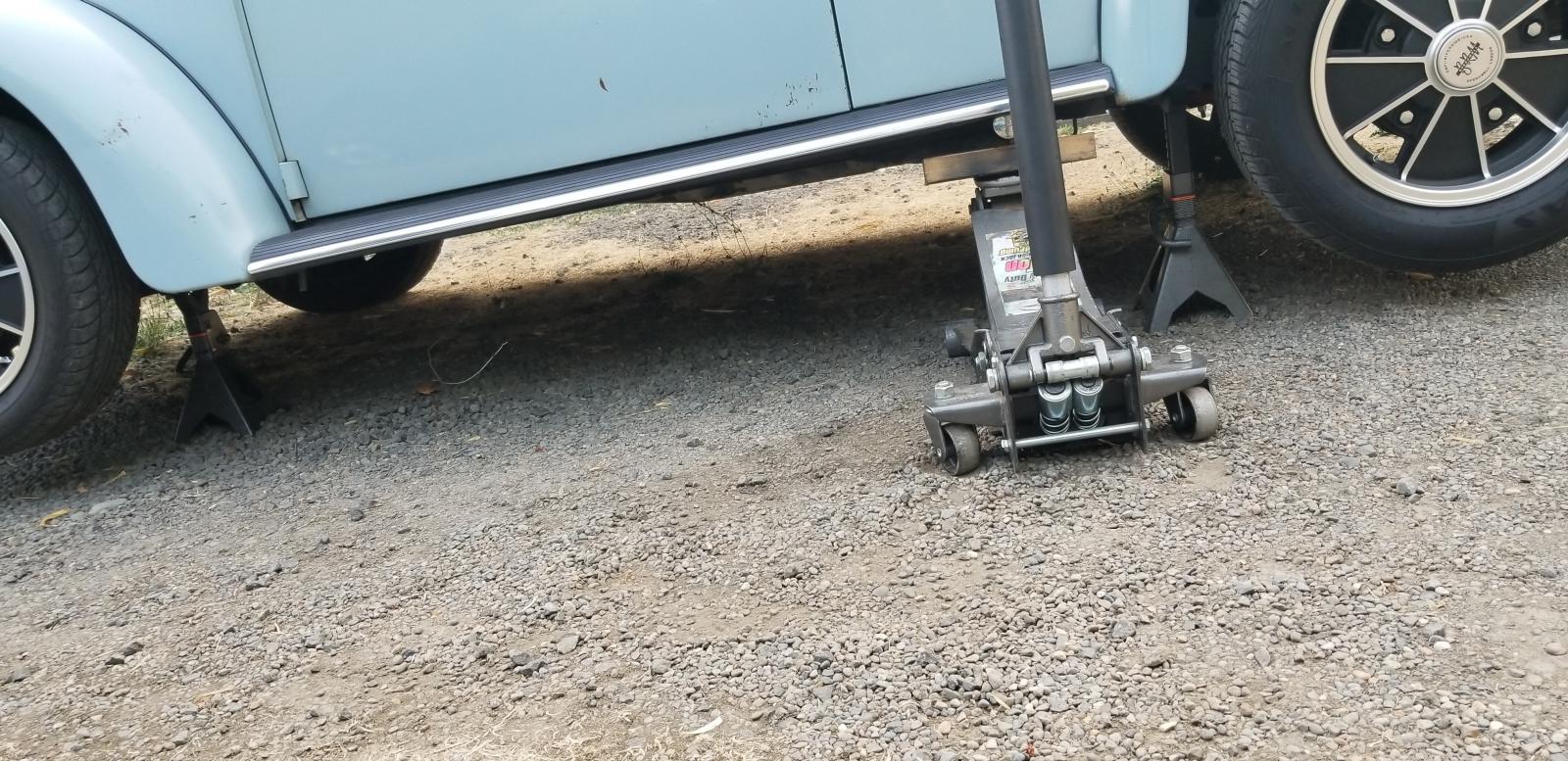

Jacked the car up on the drivers side. Placed jack stands fore and aft. I also left the floor jack in place under the jack point on the car since I was working on gravel. Safety first!

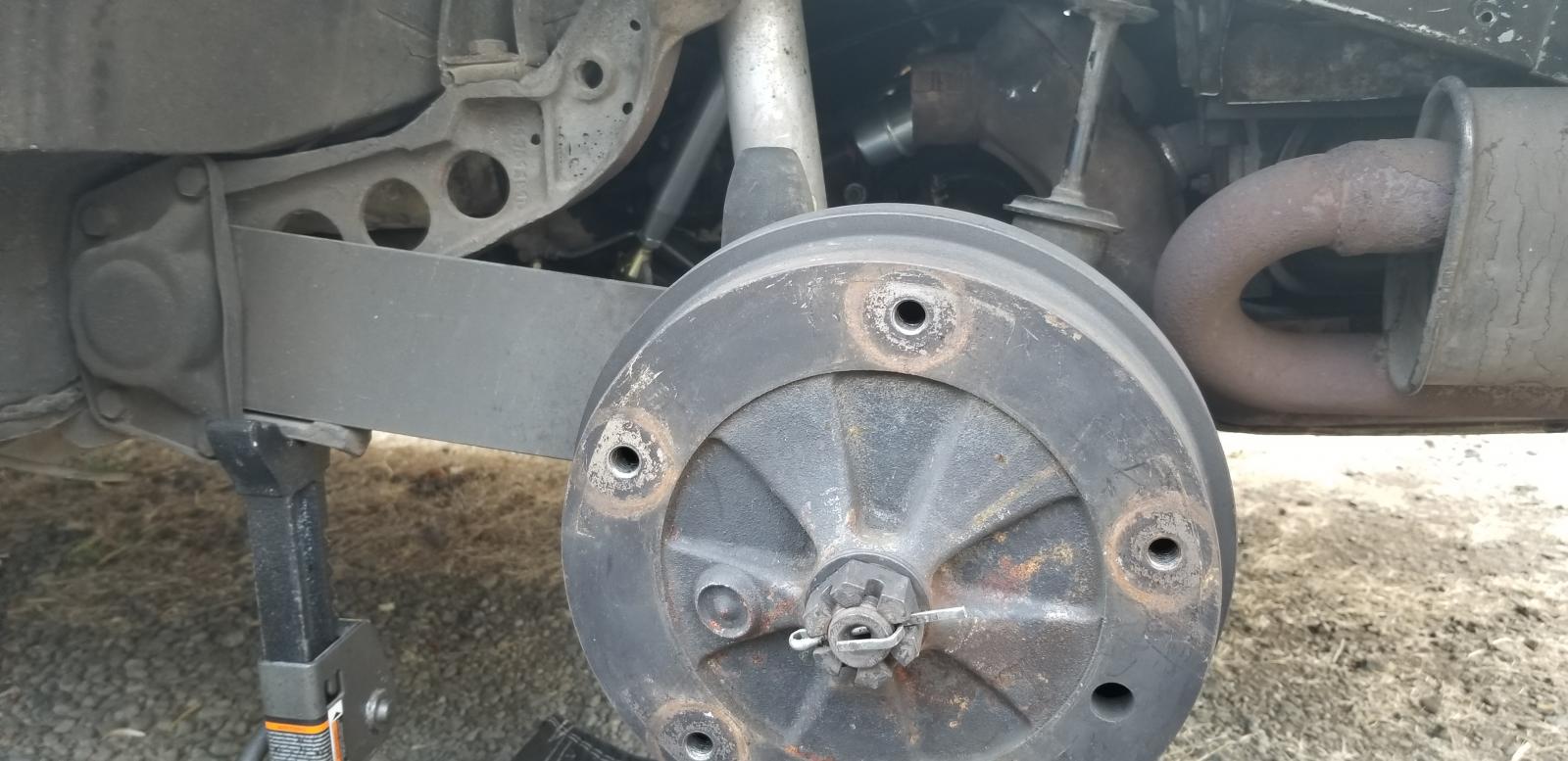

Removed the rear wheel to gain access to my target.

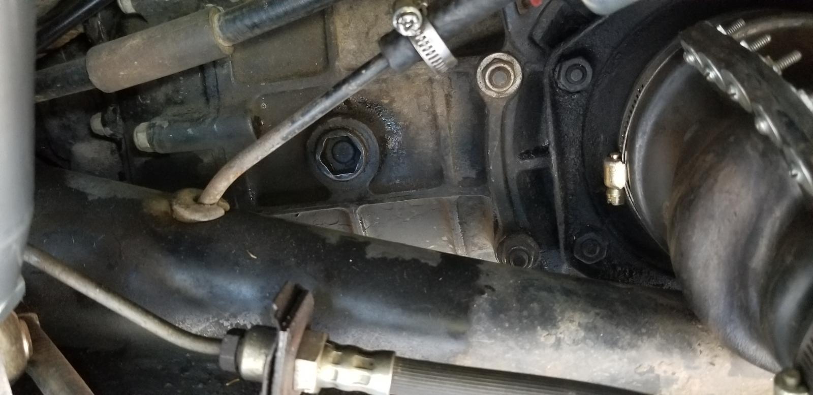

Target acquired!

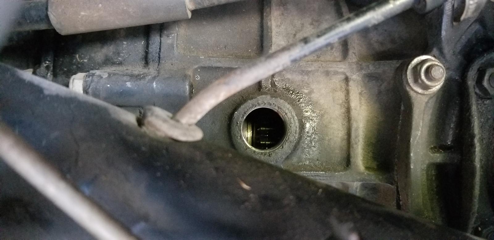

Removed the trans fill plug and acquired my secondary target.
I inserted a screwdriver into the fill port and moved the gear visible through the fill plug opening rearward.
