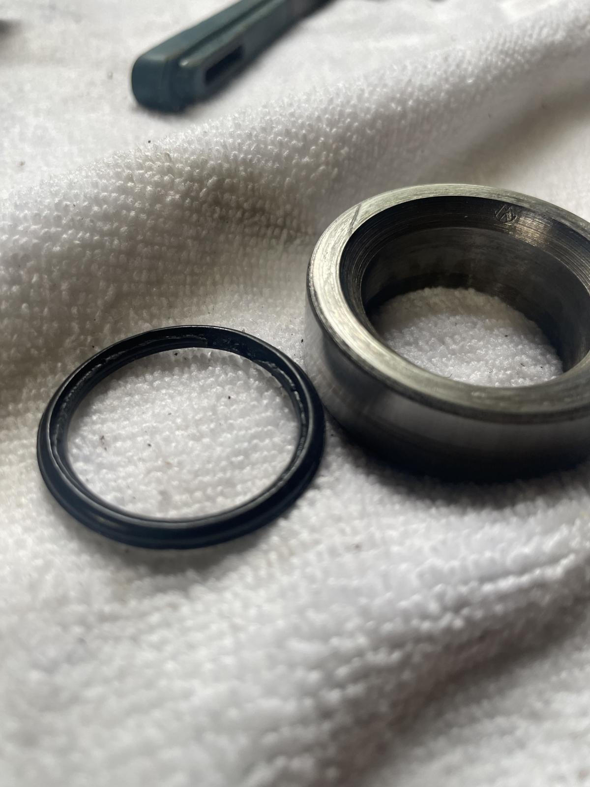

strange timing, that one of the new axle seals on my rebuilt split case trans is dripping.. and I was very careful during the installation. Check it out:
The o-ring behind the spacer got pinched into the little gap between the shim #7 and the axle. I don't know if it's a problem with the shim or O-ring, the spacer is stamped VW so I assume it's got the correct bevel to fit against the o-ring. This is a Wolfsburg West seal kit, and to be honest I do not like them.
Here's the spacer and o-ring after picking it out.
My current plan is to leave the rubber thats stuck in the shim, and fit a new o-ring to see if it still leaks. If it does I'll R&R the whole thing with new shims and seals.

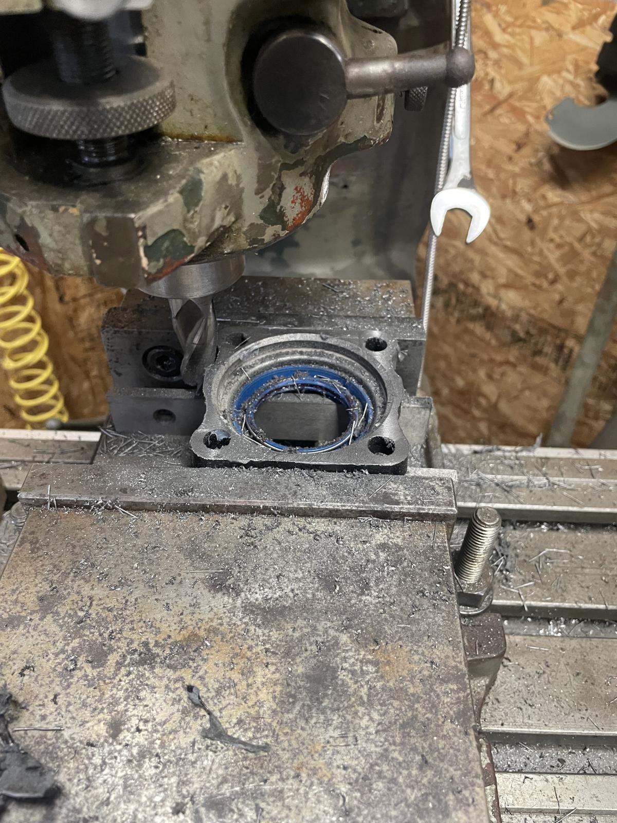

I was curious about how you tried this. Did you grind the sides of the '56 axle bearing caps and then use them with the later backing plates, or use the later bearing caps that clear the center reinforcement on the later brake backing plate?
The reason I ask is that I was told if the original oval window era bearing caps where modified to clear the reinforcement in the later backing plates it would work. If the later bearing cap was used I was told it would leak. I haven't personally done an oval brake swap, but did consider it at one point.
Yes, you have to grind the sides of the early cap to fit the hourglass shape of the backing plate stiffener.
Here: halfway down page 3 I have measurements and pics of different early swing axle tubes, backing plate thickness and bearing cap details. Mundane details to attempt fixing a leak..
