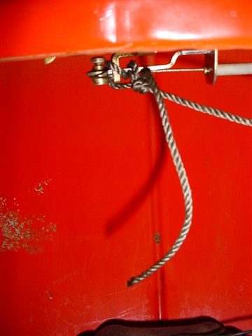

When you run your new cable put an old piece of bike cable around the latch arm. This way when you break the next cable you can reach into the horn boot and tug the bike cable to pop the hood. I havn't done this on the front yet, but I did it on the engine compartment. I guess since you have a 71 you can go a few days without getting under the hood. For guys like Coad, who's fuel filler is under there it could tunr into a real pita.

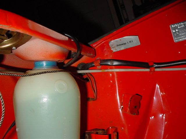

My front hood rip-cord follows the plan suggested by a posting at aircooledaddiction.com: loop a piece of mechanic's wire (available at NAPA or just about any auto parts store) around the latch arm and run it out through the right hood drain tube exit hole below the right front corner of the hood. It was easy to do before I installed the drain tubes, but I managed to work the wire around the rubber tube with some effort after putting the tubes in. The end of the wire is now inside the right front wheel well, resting on the "shelf" formed by the air intake duct. I bought a 1 1/4" welded steel ring at a hardware store and twisted the wire around it. In actual fact, you would twist the wire on the ring first, then poke it through the drain tube hole, and, lastly, secure it to the latch arm. To get into the trunk, I just reach up into the wheel well, feel around for the ring, and give it a tug.

Even though my gas filler is outside the trunk, there still could be some cold beer in the trunk so I added a ripcord that exits near the pax side headlight bucket. It works so well, sometimes I use it instead of the glovebox lever to open the trunk out of simple laziness. Hopefully I won't wear it out for when I need it. Laughing
Works great!
