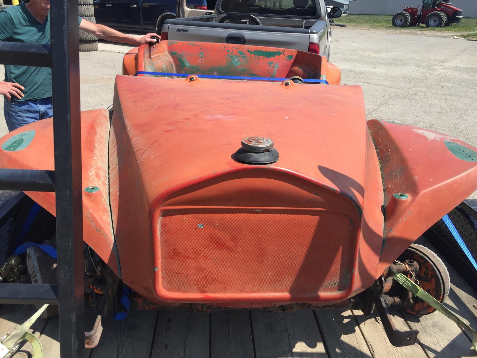

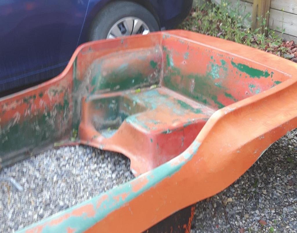

I have posted some pictured of this buggy already, but was more looking for some info in it.
if anyone has any info on manufacture or IDing it please let me know
DBA says its brand X0049 i think
well the story goes as this
My uncle got this line on a buggy disassembled, they wanted $400
he originally talk to me about it and we were gonna buy it get it back together then flip it. as we both have a buggy already.
well he goes and picks it up for $400, but then starts thinking he is gonna keep it for himself, but i feel in love with the lines and the top.
told him i would take it for $400.
he said for that price which he paid for it we would keep the 1600dp that came with it.
i said sure as i have a 1300 that runs already.
but now i have decided to rebuild it to my liking taking experience from my first.
onto the pictures

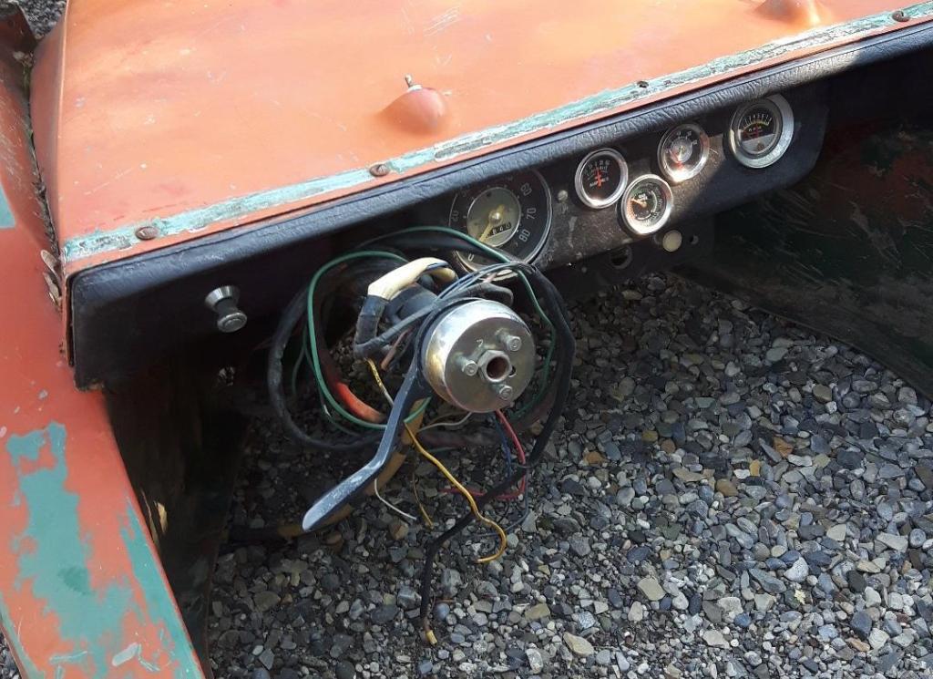

more photos

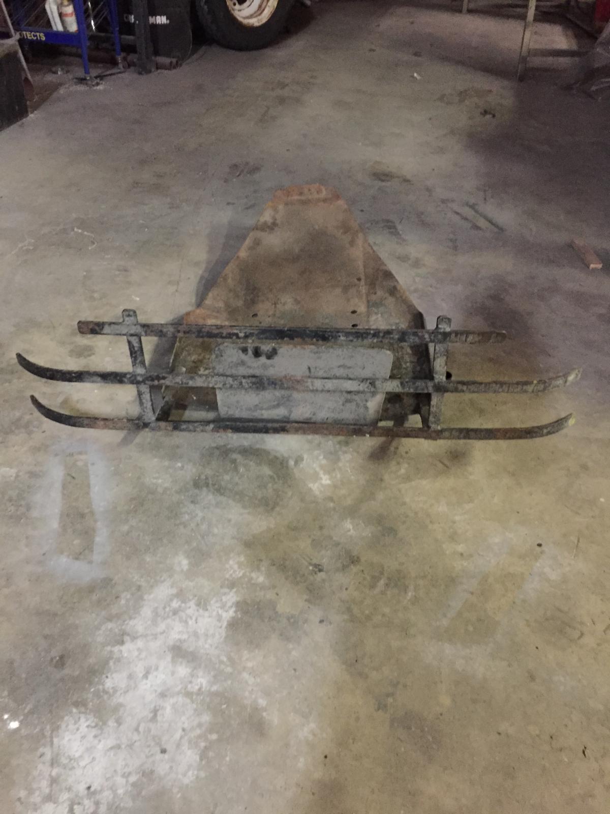

rear bumper
the windshield is in perfect shape
and its on a modified 59 pan

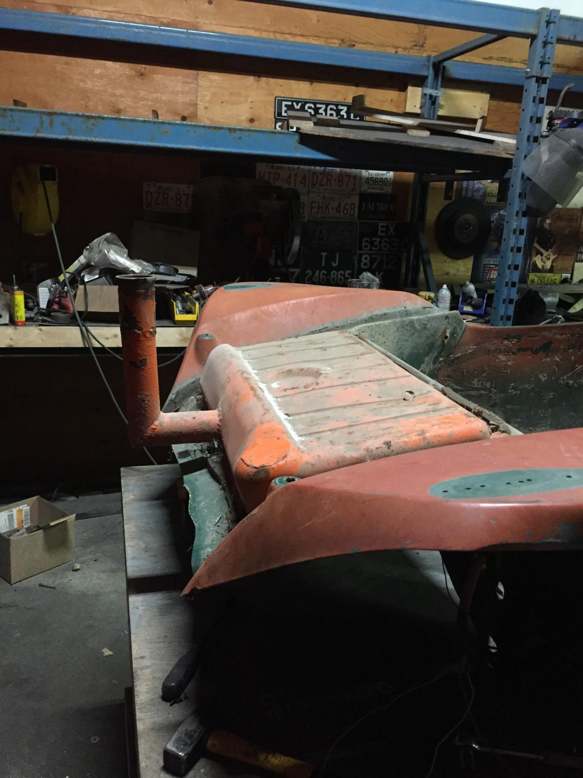

has some old school lights that i am not sure if i am going to reuse or not. originaly i was thinking turning them 90* from the original mounting and putting them more on the outside
the gas tank has some interesting work done to it the way the filler is mounted it would only fill about 3/4 full and given the angle on conture on the under side, i t would not get much usable fuel. there is no fuel level sendor either

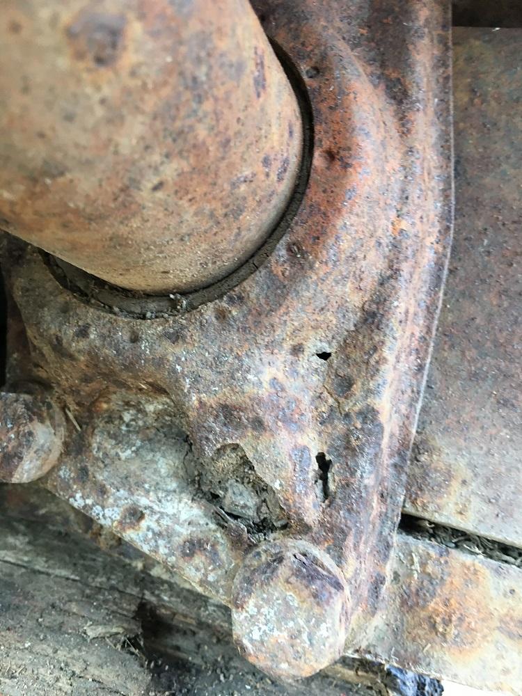

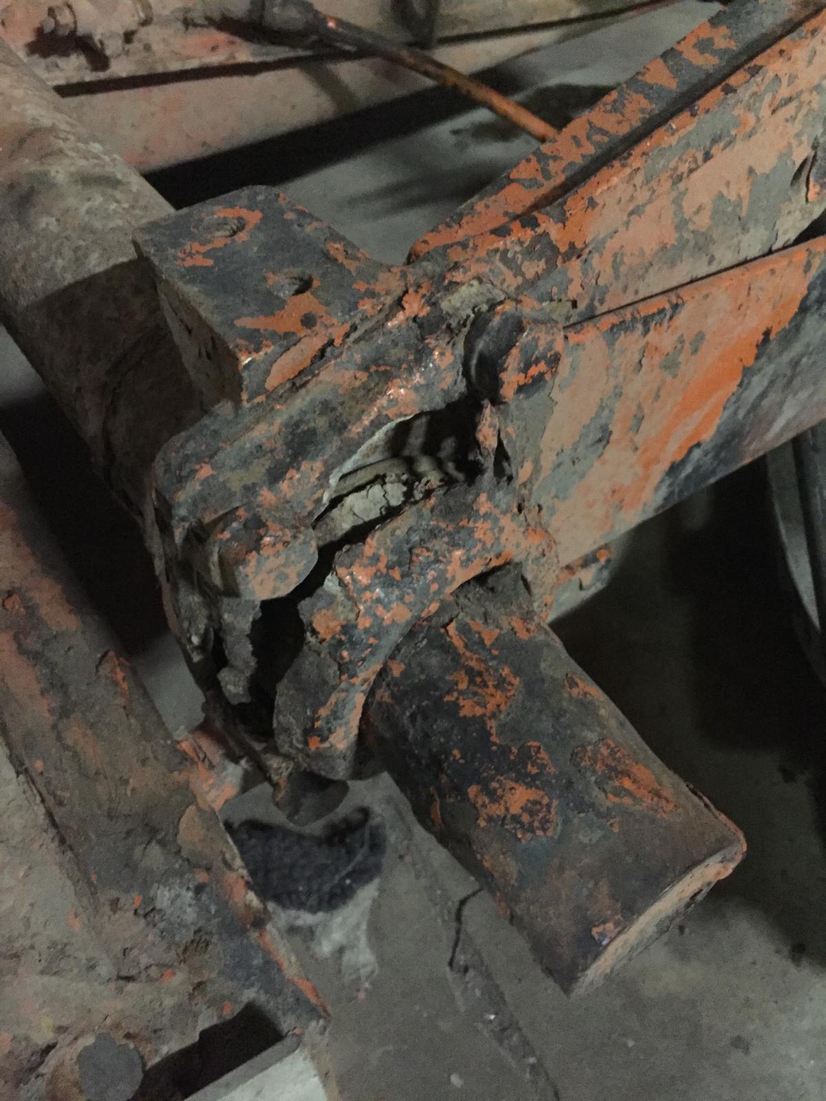

well this is somewhat concerning to me, this side is the worse the other is nowhere near this bad

You got quite a bit for that $400! Lots of work ahead though. Was the engine in it or a "Oh by the way here is an engine that should work."?
Is the engine complete?
Turn over?
Run?
You could put a monster fuel tank under that hood!
I am sitting here picturing that Buggy in a nice metallic chocolate brown, gold pinstriping and a black roof. Smile
Or - a white roof...

No my uncle took the 1600dp that was in it. I had another guy give me a running 1300 a few months ago. That he took out of his buggy it was running. And complete.
And yeah I might build my own tank this time around.
As for the buggy it needs a ton of glass work. Lots of stress cracks and in needed holes. The chassis has the normal rust areas. The floor will get replaced like the other. But this time the 2X3 tubing will be stood up so I will get a 2” lift.
Theretubes for the clutch and throttle I think are rotted away. I may look for another donor chassis, it may be cheaper as I need all the steel and rubber brake lines, pedal assembly, the bolts for the front shocks are broke flush with the mount.
We will see. It will be a good project

. . . well this is somewhat concerning to me, this side is the worse the other is nowhere near this bad

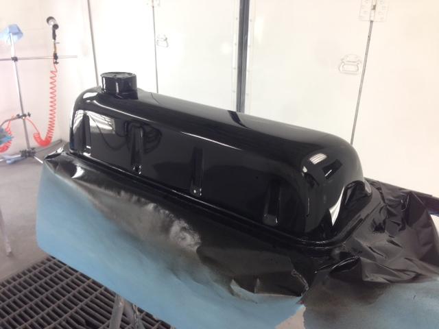

Ya might want to jump on these . . . quick like a bunny . . . https://www.thesamba.com/vw/classifieds/detail.php?id=2194661
No gauge sender on the fuel tank . . . must be a 1961!
You will be able to completely fill the tank only if you add a small (5/16") vent line from the highest point on the tank and run the line up as far on the filler neck as possible . . . probably just below the level (inside & underneath) of the hood.
Add a "tee" fitting in that line for a vent . . . again up high towards the filler neck.
It's neat how the gas cap simulates a radiator cap . . . just be sure somebody doesn't inadvertently put water in there! Razz

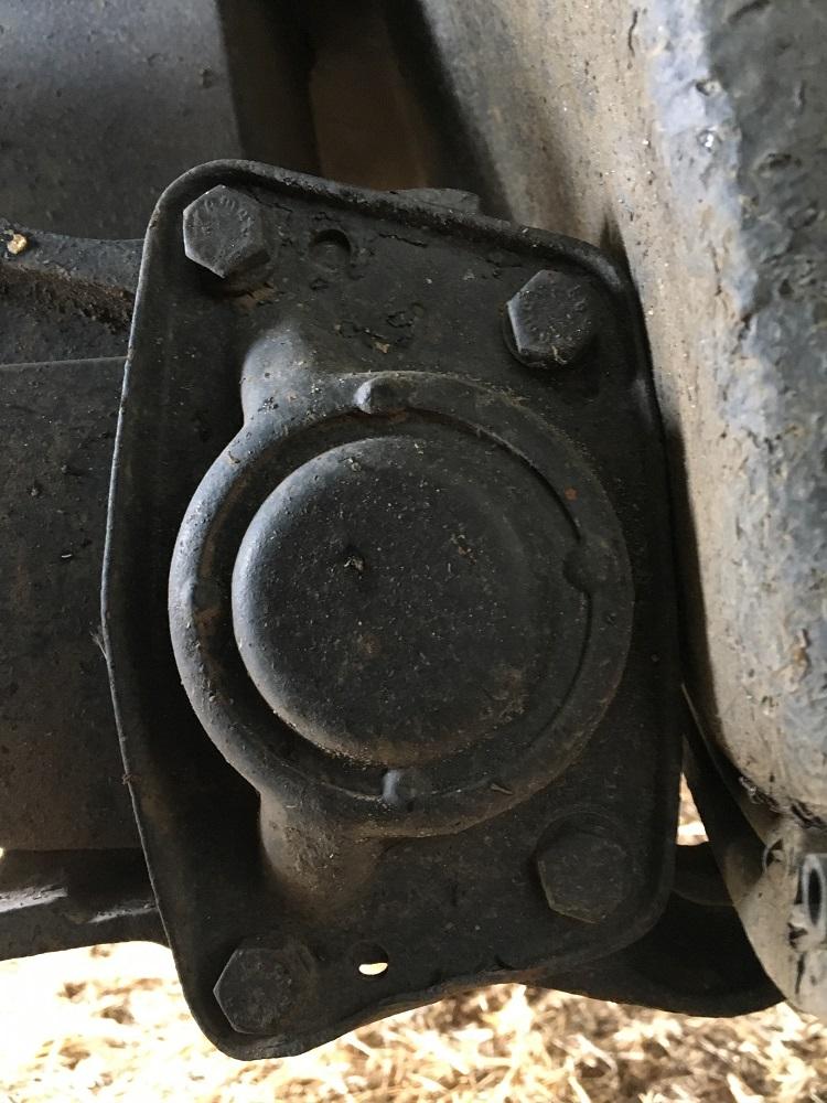

1960/earlier tanks are a completely different (taller) shape . . .
I guessed that your tank is a 1961 because that was the last year for the "reserve tap" . . . hence, no gauge sender.
1961 fuel tank (photo from TheSamba Gallery) . . .
1959 tank looks more like this (photo from TheSamba Gallery) . . .
Good tip on the early torsion bushing covers . . . I did not know that CIP-1 sold them!
Are these what you found? . . . https://www.cip1.ca/ProductDetails.asp?ProductCode=VWC%2D111%2D511%2D225%2DCPR
Jesucristo es mi Señor y Salvador!

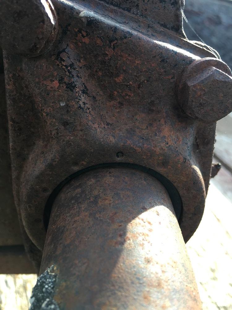

I took a look at the ones off the sand rail and at first glance they looked good.
But then I looked at the bottom side...
The ones that will be coming off the Manx copy look like this. They are a little different and may not work.
I am thinking you could just pop the caps off that are tack welded on to the cover where the older torsion bars used to come through and use them. I'm not sure though, others on this site may know.
