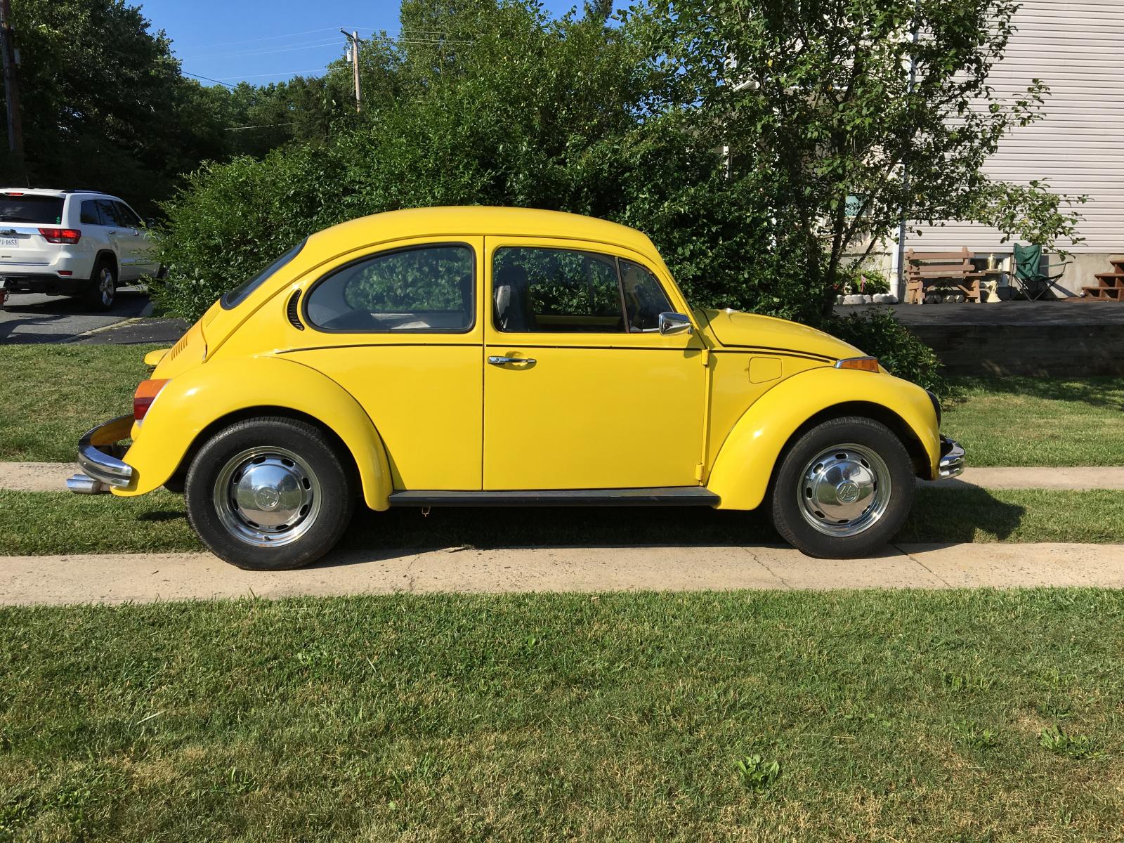

This is how I got it. 5.5 rear rims with 215/65-15 and 4.5 fronts with tall 195/70-15 tires. Car is otherwise stock.
This is with a 3" narrow beam with adjusters, dropped disc brake spindles and 145/15 front tires.
This is the rear lowered one outer spline. Same 215/65-15 tires.

Did you use special lowering ball joints?

Nah, it's not down that much on the adjusters. It's a in combo with the spindles. It rides and handles pretty good. I narrow the stock sway bar, but haven't put it on yet. And I used some no name blue low pressure gas shocks. Can't wait to try the sway bar, though.

I may switch to 205/65-15 on the rear. These tires came on the car and are kinda big.

You should try some spacers and getting a flushed look in the front like you did in the back. Mind if I ask if you have any rubbing in the back? I was thinking of 215/60s in the back on mine, but if you dont rub, then the more meaty setup looks way better IMO
Many here would doubt that the car is actually otherwise stock !!!
I like the narrowed front end drag car look.

You don't need "lowered ball joints" with drop spindles. The front end geometry is the same as stock.
145-15 fronts really kill the braking and handling.
When selecting rear tires don't forget the will alter your engine speed when cruising.
I'm using 205/60-15 rear and 195/55-15 front with a 3" drop.

I have a few sets of rims. One has 185/60-15 fronts.
