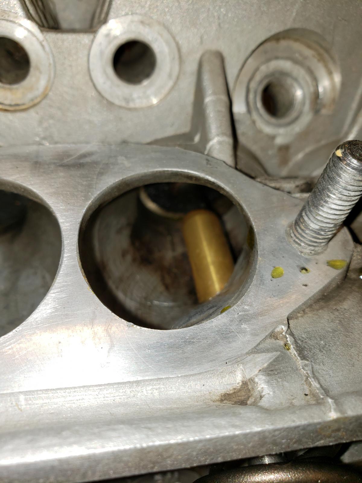

Well, my used used heads were different than I thought I was getting. I don't think th PO knew what he had. He sold them as a standard L5.
Specs that I have verified:
94mm bore
40x35 valves = L5
76 or 77cc intake runners = L7
64cc chambers
Aircooled.net CNC'd in large print on the bottom fin.
049 castings
Ports have not been touched since CNC'd from the looks of it.
Was this a mistake somehow that got out the door? Did someone install smaller valves after new?
Is this some secret racers trick: venturi effect with the medium size ports tapering down towards the smallish 40mm valve.
I'm told by the PO that these are circa 2014.
Should I go bigger valves to match the runners?
If so what size? Having a local a vw machinist do the work, so is it worth the cost over buying new Panchitos for $600-700? BTW, paid $400.

Mine Vs CB Super Mag Plus

Those are CNC L5s from DRD and they did have a lot larger intake port volume than his previously hand ported heads.
Alstrup would be the best to comment on performance, but for running an 86C I would think you would be better off with different heads.

There is no way those intake ports are 77cc's.
Before you make changes, I would cc those intakes for real this time.

Right, I was thinking maybe my method was off until the chambers came out spot on.
I measured 76cc. And they do seem to compare in looks to other 75-78cc heads.

The bowl is on the large side. That´s why they don´t look like the have that much intake port volume.
The exhaust side is ok for high rpm. The intake ports will make the engine rev high, but it woh´nt make the power you are aiming at.
If you want to use those heads you could replace the intakes to 42 mm and leave the exhaust as is. Reshape the lower intake bowl to the new seat and basicly leave the upper port alone apart from maybe a slight straightening up of the long radius. but only 1 to 1,5 mm. This will restore the port velocity and bring the I/E ratio somewhat down. That means that with say an 86C you will get an I/E ratio that is a tad on the low side. That´s not especially good if you want to make power to 8000. On the other hand it will be very good for bringing in the usable power in the lower part of the rpm band and the midrange torque will be phenomenal. If John @ ACN still carries the A1 step headers this is where you would want one. 1 5/8 going into 1 3/4" Then you can reach the 180 hp at approx 67-6800 rpm. Shift point at about 7200. At 11-1 on premium fuel I would´nt be surprised if it pulled 250 Nm torque.

Your heads:
Now DRD L5 heads:
Now DRD L7 heads:
The L7 is a totally different shape also. CC those for real, and I bet you don't get 77 cc's.

Yeah. On a second glance, are those L5´s CNC ported?? I just checked my templates. The port shape is different from the ones I have modified. - maybe an early version (?)

Ok, you all sound right. So I'll have my guy look them over and CC them. They are CNC ported.
The runners taper down from large cross sectional area to small at the bowl. I've noticed that about them before I CC'd them. It does make sense to me that they could really use a larger intake valve and then open up the bowl to match.

His angle is different than what Jeff posted. They look like they might be the same.

And I was planning on using the L5s and wanted to get some RPMs out of them and a longer stroke would shift the RPM range down. At least that was my thinking.
So basically so far all I have is a block that is ready to go, and I'll pick up the bugpack crank and Pauter rods this week.
