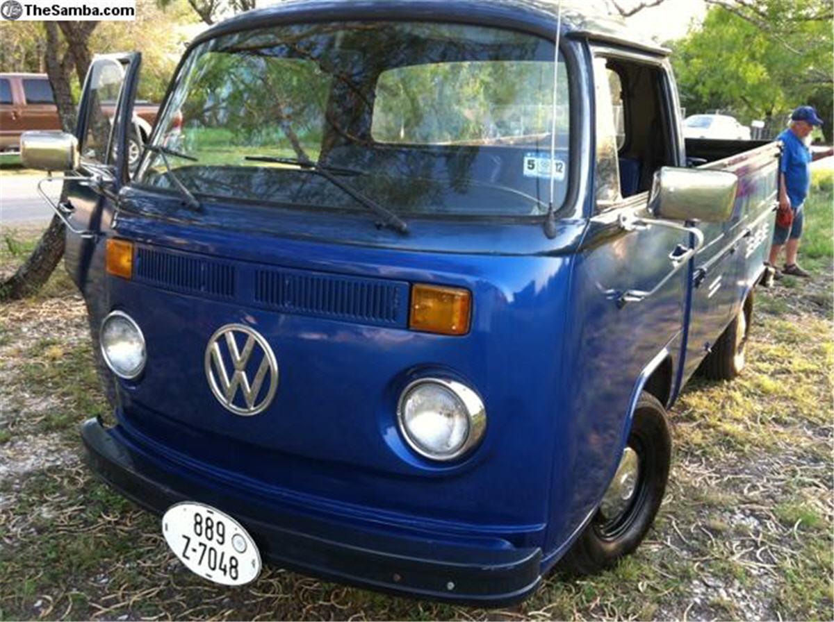

In Late 2012 I had been watching an ad on The Samba for a 1975 Single Cab Type 2 VW pickup in Texas. It had been there for several months. These are photos from the ad:
I traveled to San Antonio, Texas to see the truck in April 2013, and it looked like the ad photos -- OK from 20 ft. Turns out that the previous owner, Gilbert, had used the vehicle for a project in a Paint and Body class at the local College. Here are the "before" pix:
The original color is L345 Licht Grau - a utilitarian light gray.
The new paint was a pretty metallic two-tone blue that I would later discover was hiding a thousand sins and insults to this hard-run truck. It also became apparent later that Gilbert cut a lot of corners on the prep work. (By 2018, the clear coat had peeled off, along with much of the paint on the roof - down to bare metal, and the truck bed liner on the bed is chipping off revealing rust underneath. Mad )
But the engine started, and the truck pushed itself around with a lot of coughing and sputtering, and the undercarriage was surprisingly clean. The gates worked, the doors worked (with a lot of window scraping noises inside). Some rust holes in the floor of the storage chest under the bed (aka the "treasure chest"), but it had been "treated" with *ahem* fiberglass. Yuck.

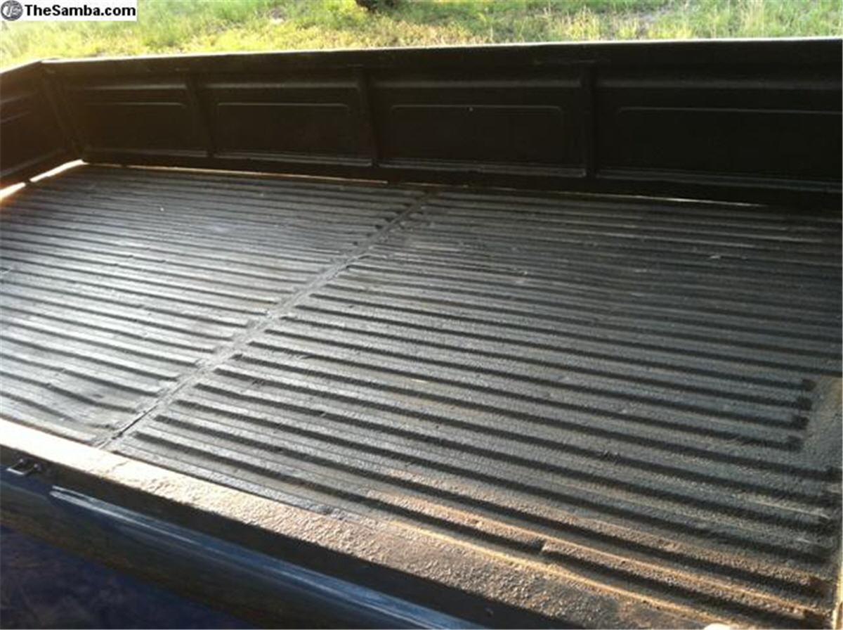

- refinish storage compartment floor
- refinish bed, removing bed liner crap

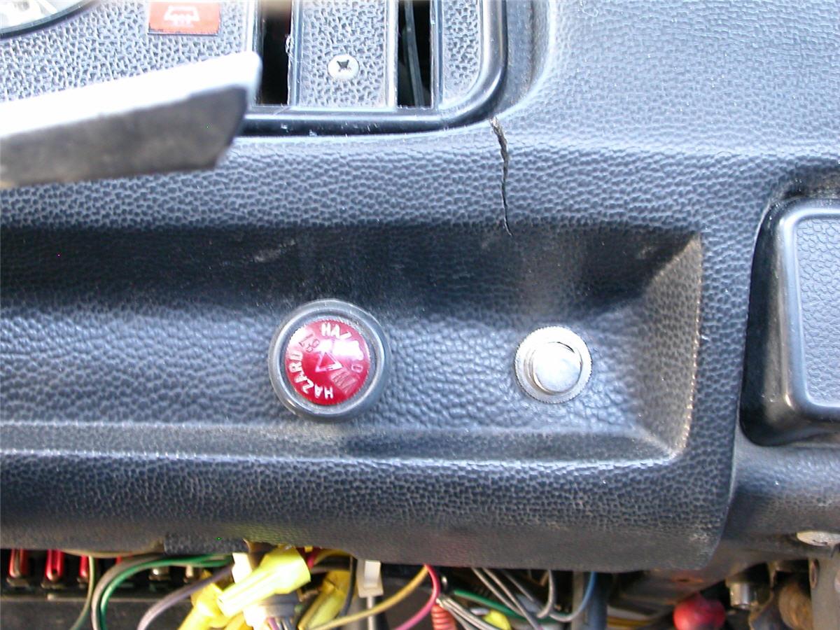

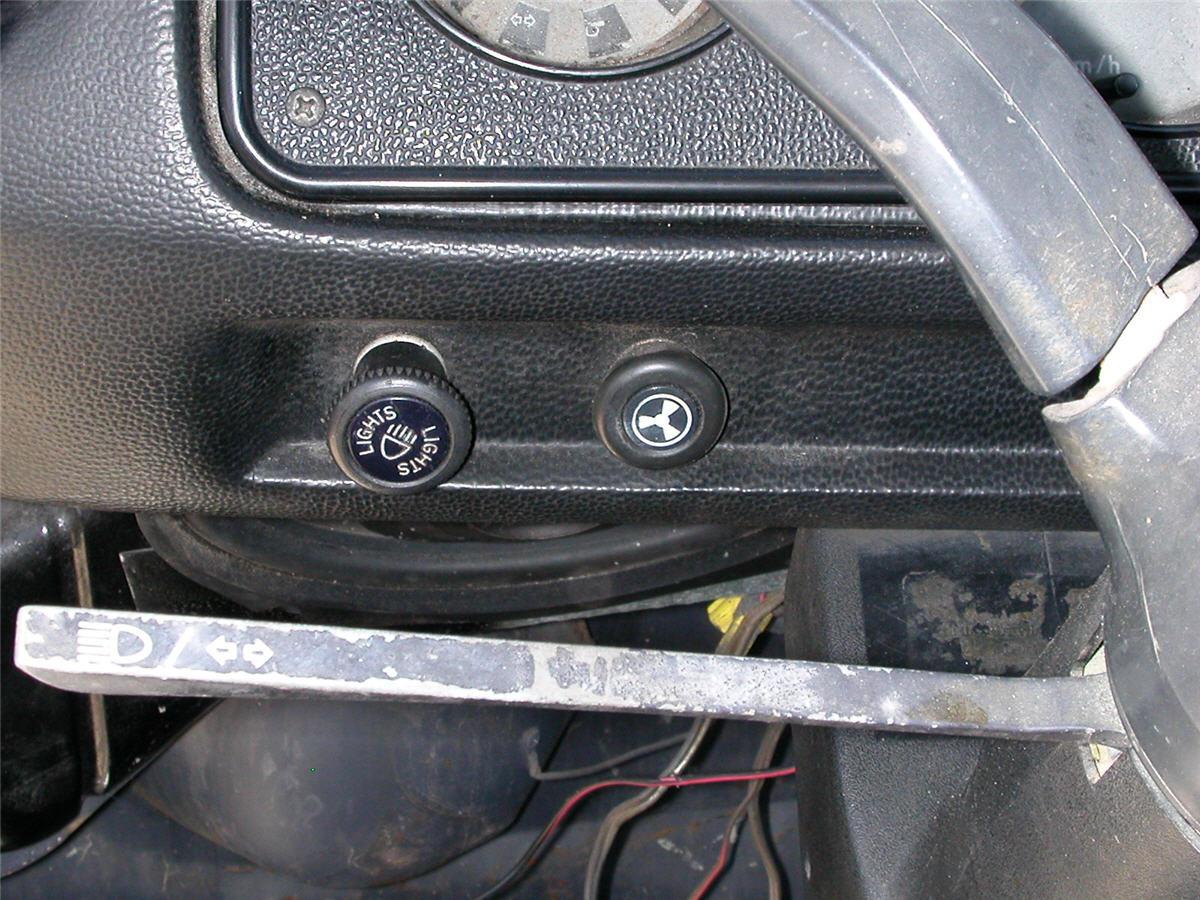

It was time to dig into the dashboard. I disassembled and serviced all the instruments and switches, and even labeled the wiring to aid a future self. First off: Get the idiot lights to work consistently.
Some PO had worked around a failed ignition switch with the Silver Button mounted into a hole on the dash. Maybe you have seen these -- it's the old school version of the keyless ignition. Ol' Gilbert said he had thought that was stock. This is the third one I have seen and replaced. I mean, I guess it works.
There are other interesting swtiches here. I finally figured out that this orange one with a hole in it was the original dual-position fog light switch. Well, son-of-a-bitch, that's great. But what's with the hole? Some dim bulb must have put in an over-aggressive light bulb and melted it. I later sourced an original used bezel, and a nice repro one as a backup.
And the ambulance fan switch! I am digging this. Clearly the headlight switch is from some other vehicle, though. I later replaced that with a good used one.
One of the fans spun, but one was jammed. I futzed with the duct housing and got it freed up. It's binding must have been the result of the wreck. Oh yeah, the punched-in-the-nose wreck thanks to PO Luigi, the welder. More on the nose later.
The turn signal switch got replaced with good used, but the wiper switch is the many-wired intermittent switch -- part of the Z21 package. I hear tell these ended up on Champagne Edition bays later. I'd like to find a spare one, as this one is on its last legs. Or arms, or whatever.
The brake indicator light had a broken board in it. I had a few of these of various designs in my stash so I replaced it with a good used one. This is why I collect parts.
Then I went after the non-functioning odometer. It had been stuck at 153250 km for an unknown time. I lubed it all up and brought it back to 0 again with a drill. I found I could calibrate the speeedometer by running it with an electric drill so that the odometer would turn over 1.0 km in 60 s. At that uniform speed, the speedometer should read 60 km/hr. Adjust needle accordingly.
That odometer worked for 19 miles and pooped out again. I ended up replacing the odometer with a good used one. These European metric speedometers have the trip odometer, too, so that's cool.

If you look at the very first photos in this thread -- the ones from the original ad, you will see that the photo of the interior is missing something below the dash. Instead of a heater tee it has a single black vinyl kick panel across the entire front.
I thought that was odd, so I yanked it out (OK unscrewed it, since it had been wanged in with self-tapping screws) to find -- no heater tee. There was evidence of one in the past in the completely mashed down pipe throught he floor that the heater tee is supposed to sit on. Mashed flat and smeared with body putty. Nice.
OK, so in San Antonio you don't always need heat. But didja have to mangle the duct work?
I happen to have a spare heater tee from a 77 bus I chopped up for panels, so I unmangle the pipe as best I can and fit the heater tee on, but -- no... it simply will not fit into the proper location under the dash. Best it can do is sit about 1 cm aft of the proper location. This is an indication of how damaged the nose was when it got punched. It pushed the heater tee out of position. That also explains why the fresh air vents on the nose are so hard to operate. The geometry is off, and they do not open smoothly from opened to closed -- rather they snap into one or the other positions. You've really got to watch your fingers as you open and close the vents with force pressing on the arms directly. There is no way the blue plastic handle could move these.
So, someday a new nose, and a properly connected heater tee. It's not the heat distribution so much as the defrosting functionality that I need. But, meanwhile, I find that a black PVC plumbing elbow fits perfectly on there, and directs the heat right onto my feet. Lovely in the winter.
