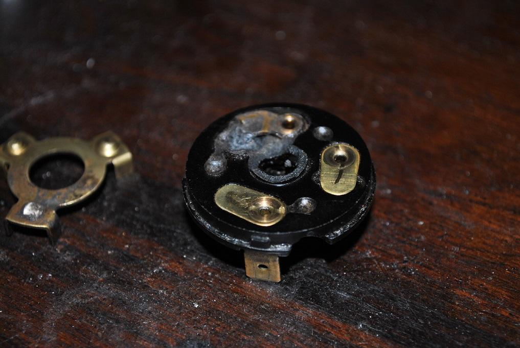

In my case I found that the contact switch tends to develop an eroded pit at the contact point as can be seen here (this is a ghia switch)
It can be easily repaired with epoxy glue.
however I don't see a clear relation between this and a hesitating engine.
