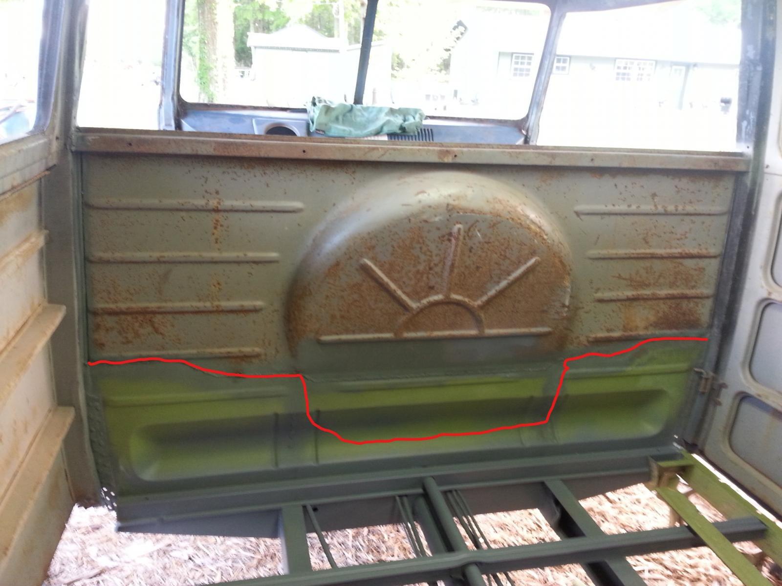

So, I have a 66 standard 11 window bus. I bought it with the bulkhead (full rising sun) removed and some awesome volvo seats. I want to replace the bulkhead (the right way).
- I have a donor bulkhead, but as you see in the pics, The metal is a bit thin and rusty at the bottom, and flanges, so a bit of repair work is needed.
- Also, the remaining portion of my bus (where the og bulkhead was cut out), has a little metal left (anywhere from about 1" to 1/4"). Meaning I will need to weld new metal between there and the donor bulkhead.
My question is, what is the easiest BUT CORRECT way to do this?
OPTION #1
- Make repairs to the bulkhead itself (blue areas)
- Cut off at the red line
- Trim the surfaces even and flat
- Then temporarily put it in place with sheet metal screws,
- Make a template and weld metal in between?
[/b]
OPTION #2
- Make repairs to donor bulkhead (same full rising sun)
- Completely remove the remaining lower portion of the bulkhead from the bus.
- Get a new lower portion from Kfab (meant for 55/61 bus)
- Cut new portion to fit donor bulkhead (red line)
- Weld new lower to donor bulkhead and install as 1 whole bulkhead
- (So finished product will be 66 full rising sun top + 55/61 new kfab lower)
*Getting super f-ing tired of saying bulkhead Mad
**I REALIZE THAT THE PIC IS A 1/2 RISING SUN, AND THE NEW LOWER PIECE IS MEANT FOR 55/61. BUT BESIDE SOME MINOR COSMETIC DIFFERENCES (VERTICAL LINES) SHOULD WORK RIGHT? I WILL PUT A PANEL OVER IT.....EVENTUALLY
Any thoughts or other options to consider would be greatly appreciated.
Thank you[/i]

Looks like the metal on your bus is in good shape. Probably best to carefully straighten it out as best as possible. Then cut out the rusty parts of the donor, and make many small cuts till donor fits the metal on the bus as perfectly as can be.

If the remainder of your bulkhead is good I would trim it back to the center of the lip around the fender wells. That will eliminate weld on the cab side and give a solid base to weld on. Also i would trim and repair the donor part first.

Thanks for the tips guys. So the guy I'm taking it to, to have some body work done, doesn't want to do a butt weld on the bottom. I think he wants to just lap weld it onto the back of the wheel well. That's kinda why I asked the question.
I want it butt welded so it looks as original as possible. I know its hard to tell from pictures, but that should be able to work right?

Lap welds tend to collect water due to capillary action and rust follows all too soon afterward.

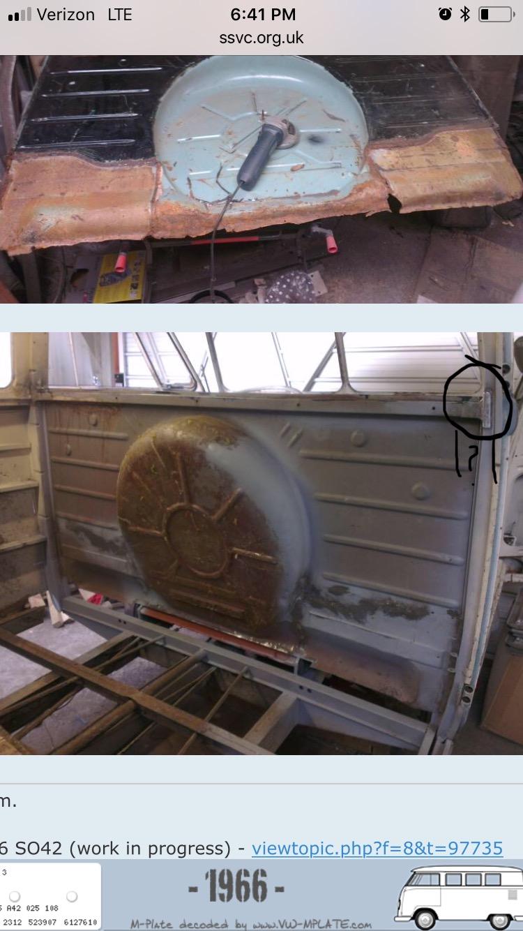

I’m replacing the bulkhead in my bus right now and I am working through issues if you have any questions I may be able to help or vice versa, I’m actually looking for a dimension of the piece maybe you guys can help with? It’s a small sideways T shaped piece at each corner at the top of the bulkhead. Their tack welded on. I need the dimension from the left To write up that small T shaped piece.

Think this will help.
https://www.thesamba.com/vw/forum/viewtopic.php?p=8969323&highlight=#8969323
