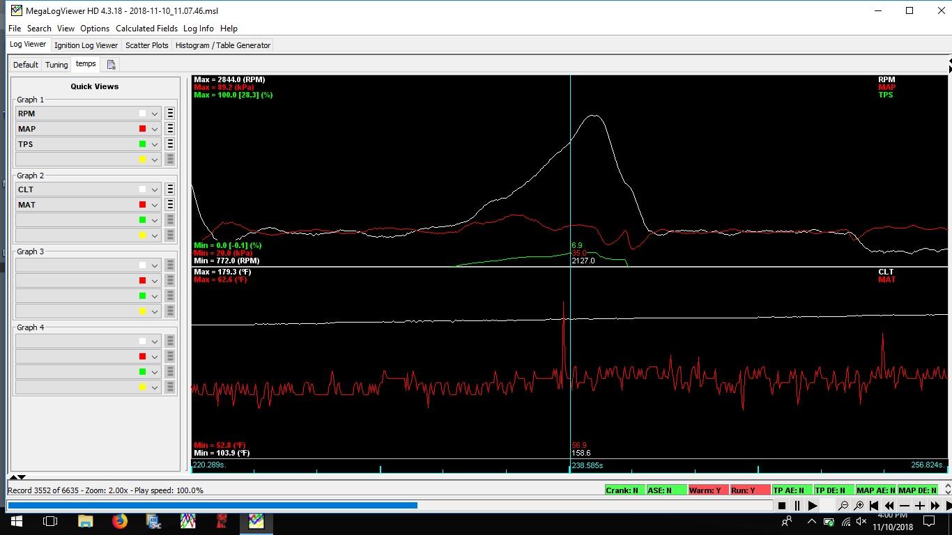

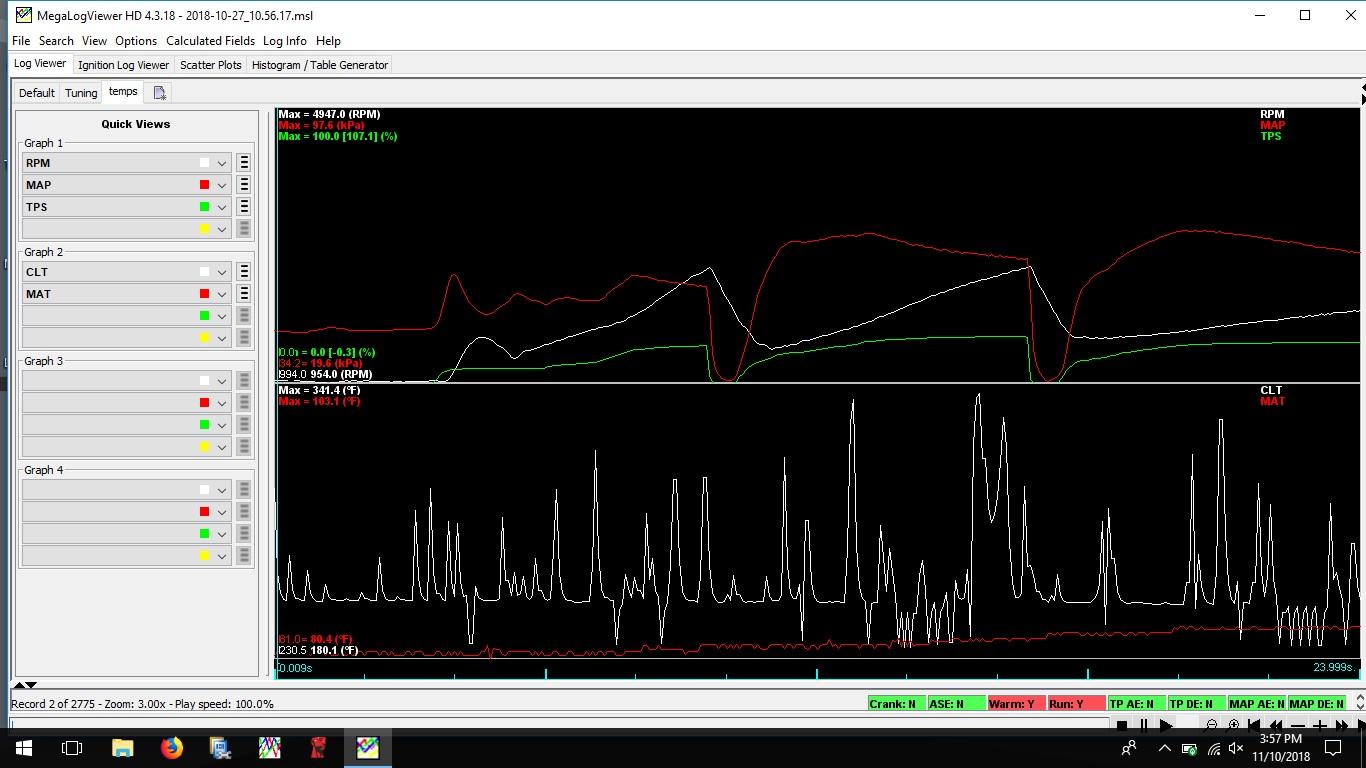

Even though I've had a lot of experience with EFI it has always been diagnosing or repairing a factory setup. Replacing the factory carb with a home-brewed fuel injection setup has certainly been a learning experience. Megasquirt specifically instructs to use the PCM ground for all sensors. When I wired up the ECT (engine coolant temp) or in this case Cylinder Head Temp it was after everything else was already in place. Not thinking, I wired the CHT / ECT sensor to the engine ground. For the life of me I couldn't figure out why my engine temp data was so jumpy ( see datalog below)
After connecting the engine temp sensor ground directly to the PCM sensor gorund pin (same as the IAT sensor) there was a world of difference (again, see below)
Nice and smooth!
So take this as freindly advice or something to double check is you are getting erratic sensor signals.
