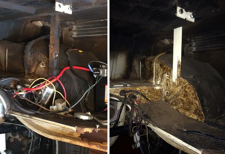

About 3 hrs work (thick in places!). Support pillar is how clean it eventually comes and now serves as motivation to keep going. I'm committed to the long haul...
Bought/using a heat gun and plastic scrapers, which tend to heat up but need to stay cool for efficient scraping (no flexing).
2 sq ft done, 20 to go... I'll be the tortoise on this one, not the hare...

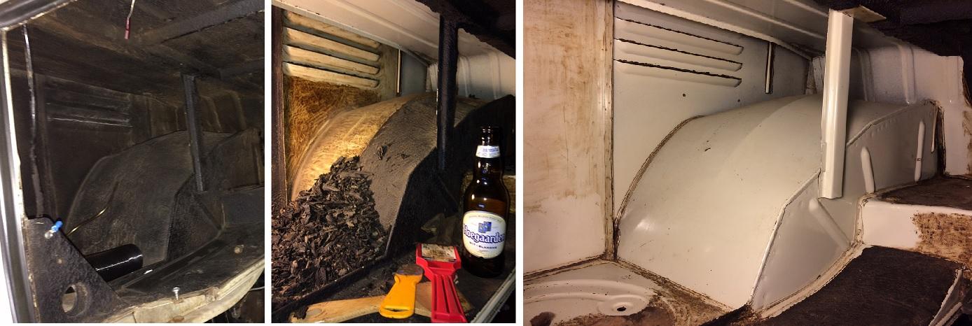

Progress pics after about 19 hrs.
Using heat gun with firm plastic scrapers to get the bulk off, then reheating and wiping off excess residue with rags, then using clean rags with off-the-shelf acetone for the final clean up (decided not to by Eastwood PRE after I rang them and they said the California version has a very high acetone content... and I've learned straight acetone is working just fine). No luck with paint remover, and didn't want to risk using oven cleaner with OG paint preservation in mind.
Anything other than plastic or teflon scrapers (ie: bamboo/wood) scratches the nice OG paint hiding underneath. Some areas, like by the battery, have very hardened black deadener that heat doesn't affect. Using a metal 'wood chisel' there at a very careful/light pressure/consistent angle to slowly scrape it off without scratching the OG paint.
Cleaning the calked seams is tricky as the paint wants to come off more easily than paint on metal, but fine and focused light scraping and light rag wipes is working out okay. Sometimes I feel like I'm going at an archaeologist's pace!
I've come across no rusty areas, and still have fingers crossed on that front. My chosen method is slow going but it's coming along, and the hours of later enjoyment will far exceed the hours of work to remove this dreadful stuff.
I've almost got the other side done, too, and this weekend hope to move to the 'roof'...

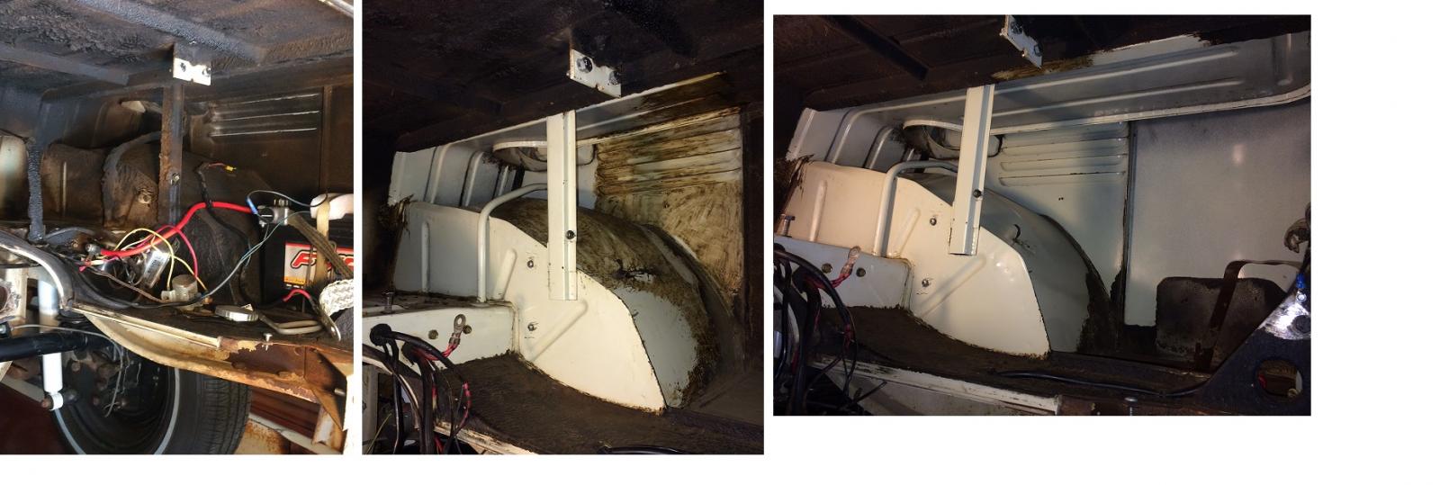

Left side progress pic below, after about 23 hrs on that side.
Am having to scrape gently yet firmly with the chisel on the flat tray area... while using light heat so as not to soften the paint too much. The tar there has hardened to a crust and nothing penetrates the bulk well enough to scrape it off. Left side is taking more hours than the right.
Pic also shows the aft side wall and how clean it gets when reheating it after the bulk is removed and just using a rag without acetone. Lower on the sidewall, and tray, you can see where the acetone rag was used for final clean up... matching the forward sections. I'll detail out the seam calk and vents more later.
