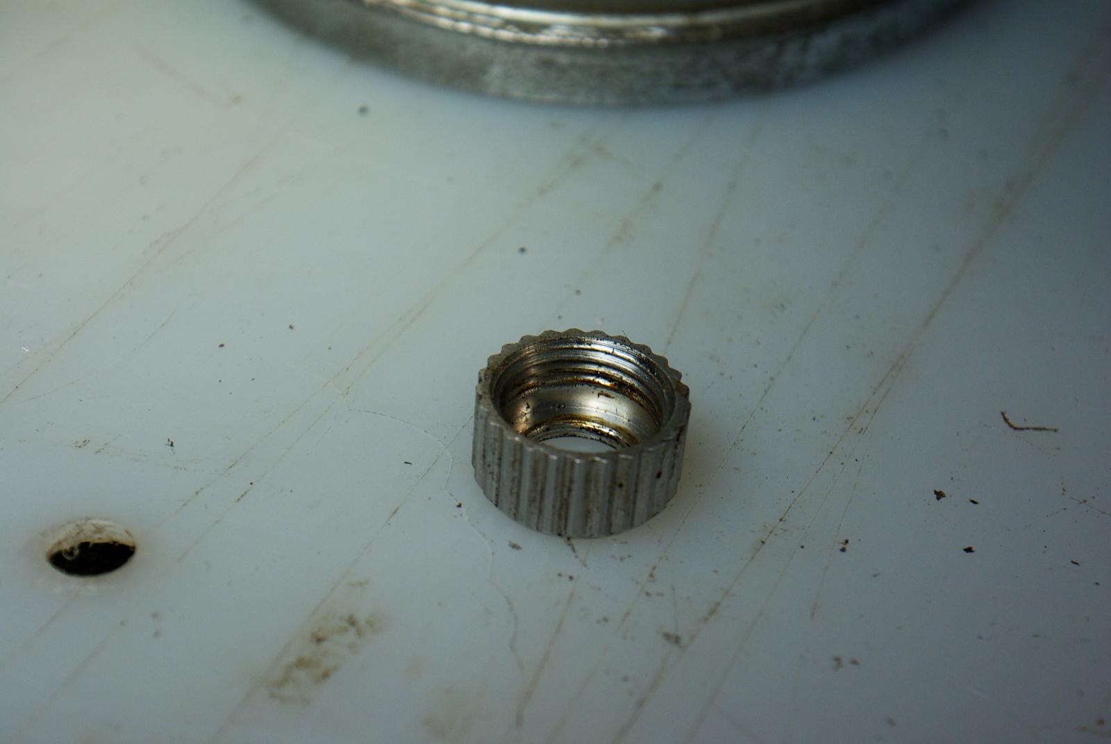

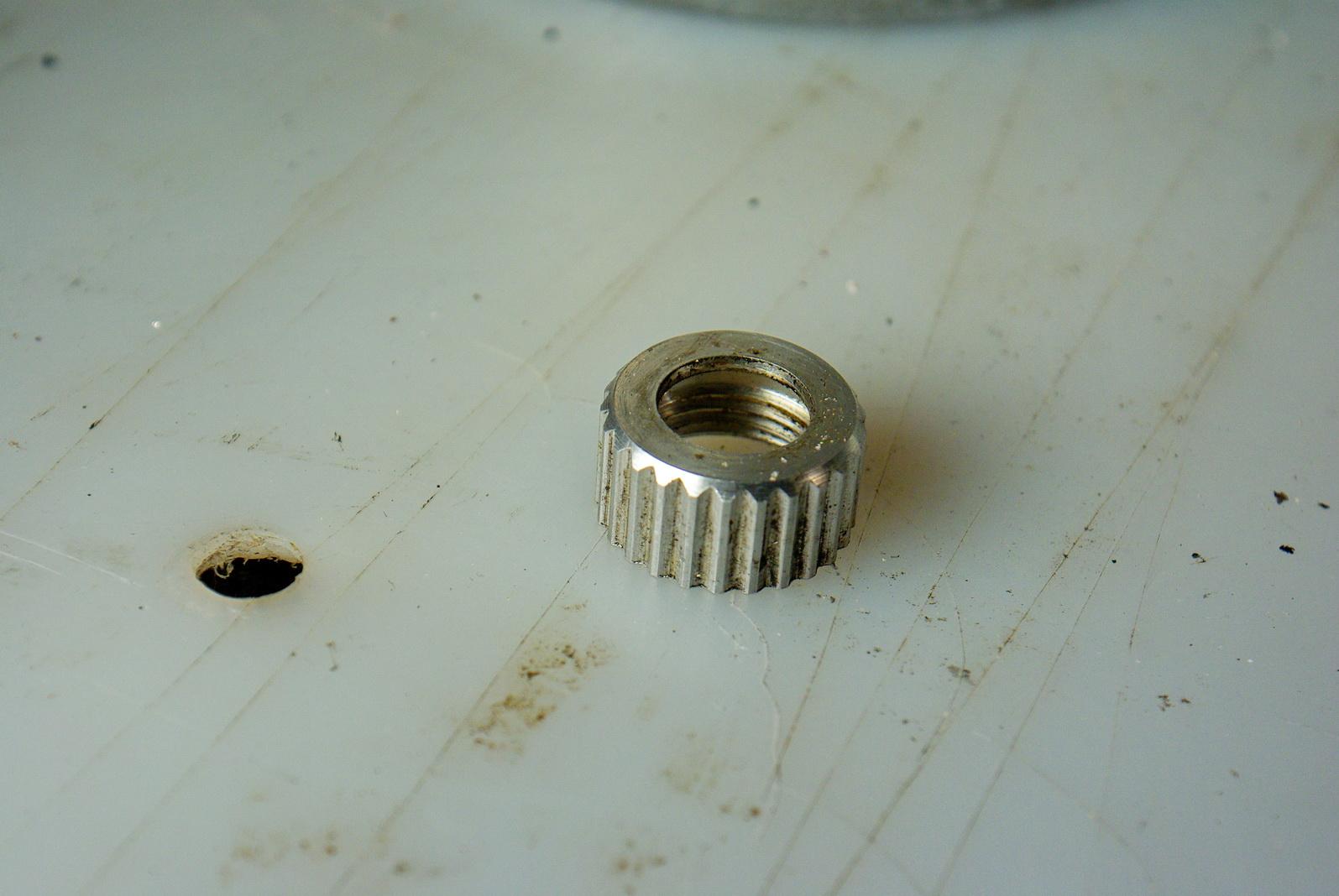

So I found this aluminum nut:
I do not remember exactly what this came from….but it was either from a cold water hose for a washing machine, a kitchen sink sprayer coupling, a water connection hose under a bathroom vanity or a toilet water connection. It may have even been a hose coupling nut from an industrial sprayer system.
You can even use a 3/8” NPT brass compression coupling nut….as long as its 3/8” NPT.

This was a grade 8 washer that I sanded the ID and OD with a Dremel tool and small sanding drum to use as a spacer. Depending on what type of nut you find..... you may or may not need this spacer or may need one of a different thickness.

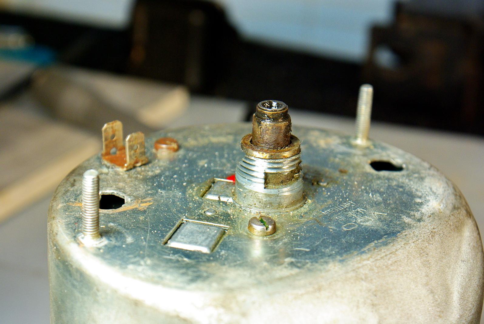

You may need to sand the very top edge of the boss on the speedometer to make sure you get a clean flat start for the die.
Work it down by hand…only cutting a little and backing it off. Use WD-40 for a lubricant. DO NOT FORCE IT. Cut a little …maybe 1/5th to 1/8th turn at a time.
Stop frequently to fit the cable and the nut. Bear in mind…that as long as the nut goes on about 3-4 complete threads and tightens up…the nut part is done.
Then you can make your shim to fit to take up the slack.
Do this instead of over working the threading and risking breaking the boss.

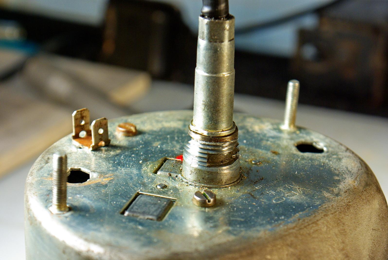

Here is some before and after of the threading. The spacer is on top in this picture
Here is how the spacer fits:
And now the nut
The cable assembly and spacer without nut
And the whole assembly put together and ready to install

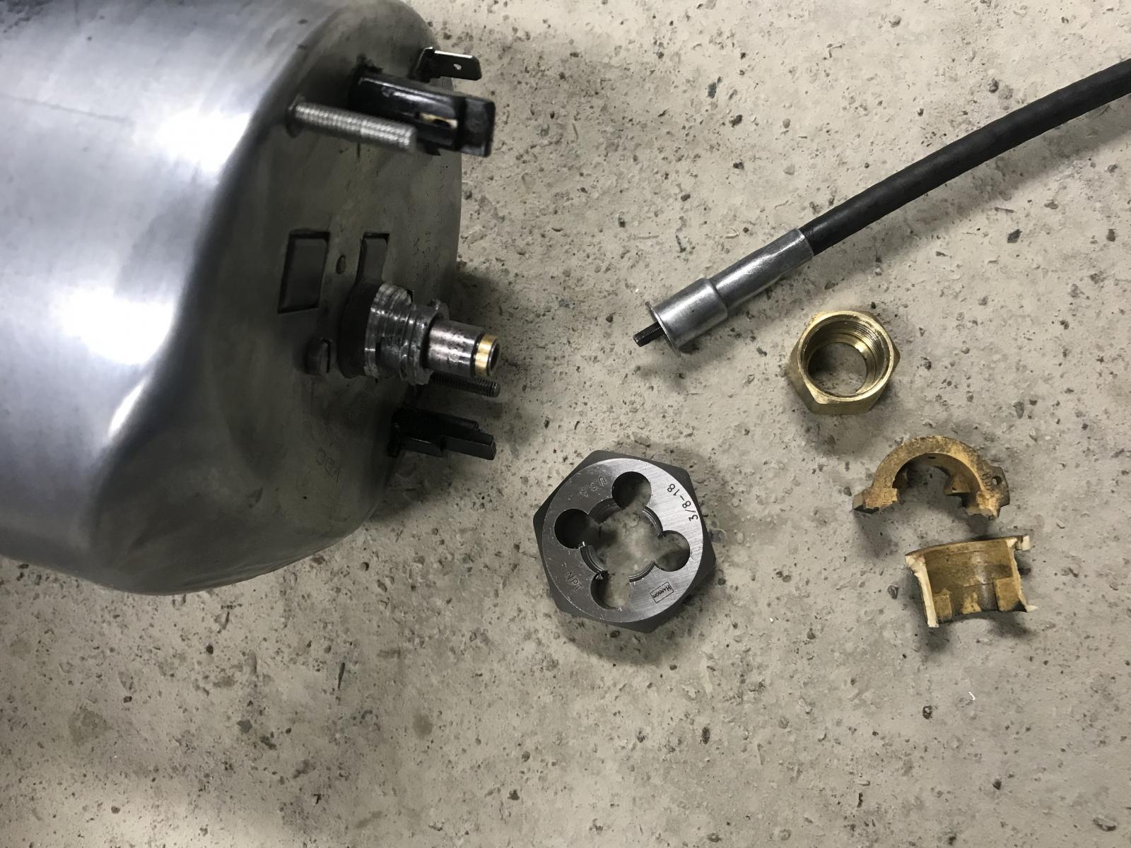

Here are the pictures of the broken nut.

Ok, I did it!! This modification works beautifully... see pics.
Broken plastic nut along with the 3/8" NPT hex die and the 1/2" NPT Brass compression fitting.
Treads cut. Took me about 1 hour of back and forth, going slowly. Die was clamped in a vice and i worked the speedo in my hands.
Assembled the parts, and voila!
