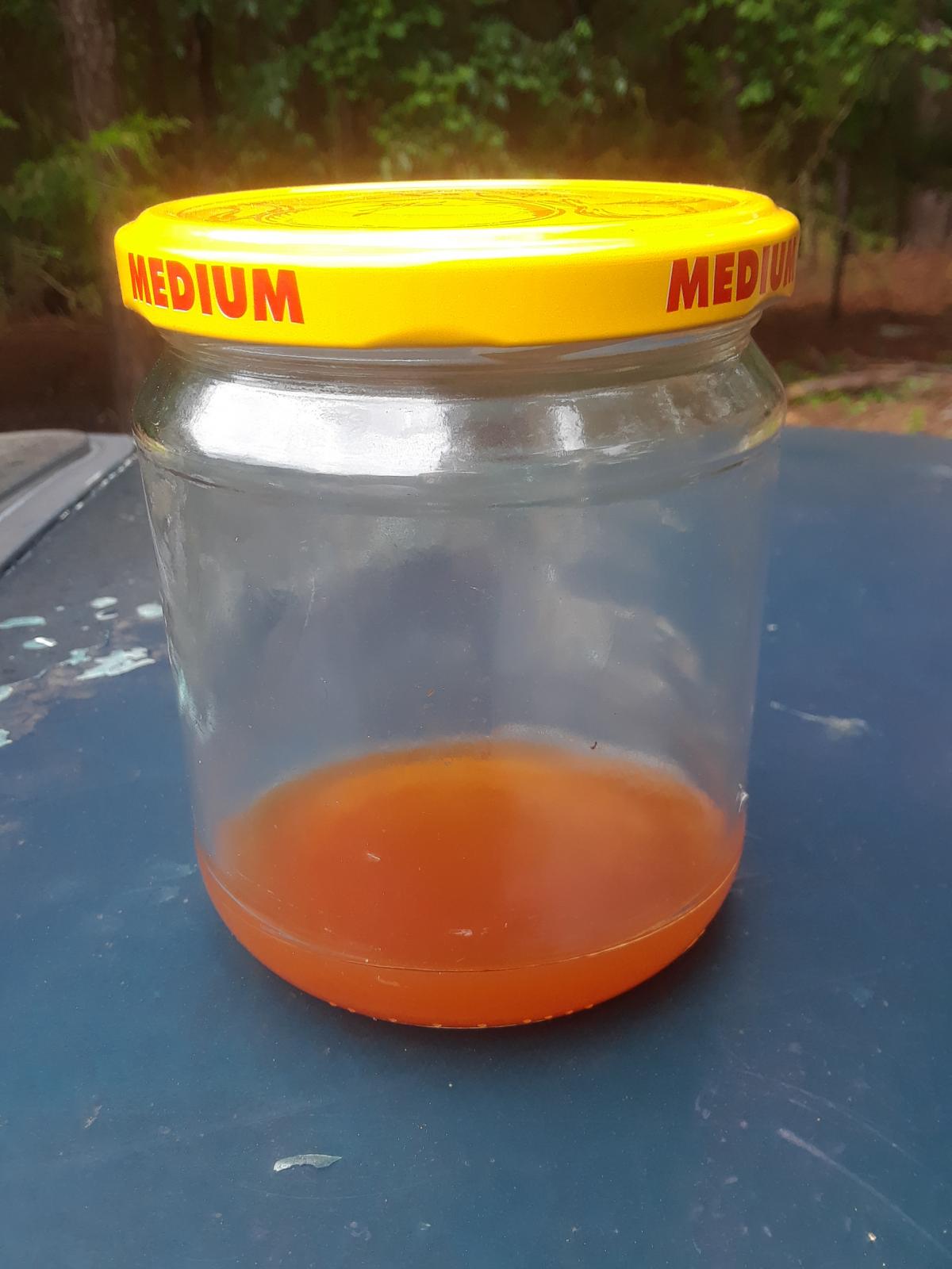

Well I pulled out the carb, dismantled it and now it is sitting in carb cleaner waiting for UPS to drop off my carb rebuild kit. This was some of the gas that was in the carb.
In the bottom of the sediment bowl was a thicker sludge than this. Also, the "volume control screw" O ring was kind of shredded.
Because of all that rust in the fuel, I pulled the gas tank out far enough that I could see down into it through the fuel level sending unit hole. I was thinking it was going to be really bad but honestly, all there was was a little bit of surface rust and some very small accumulations of rust sludge here and there. I'm thinking just leave it alone for now.
