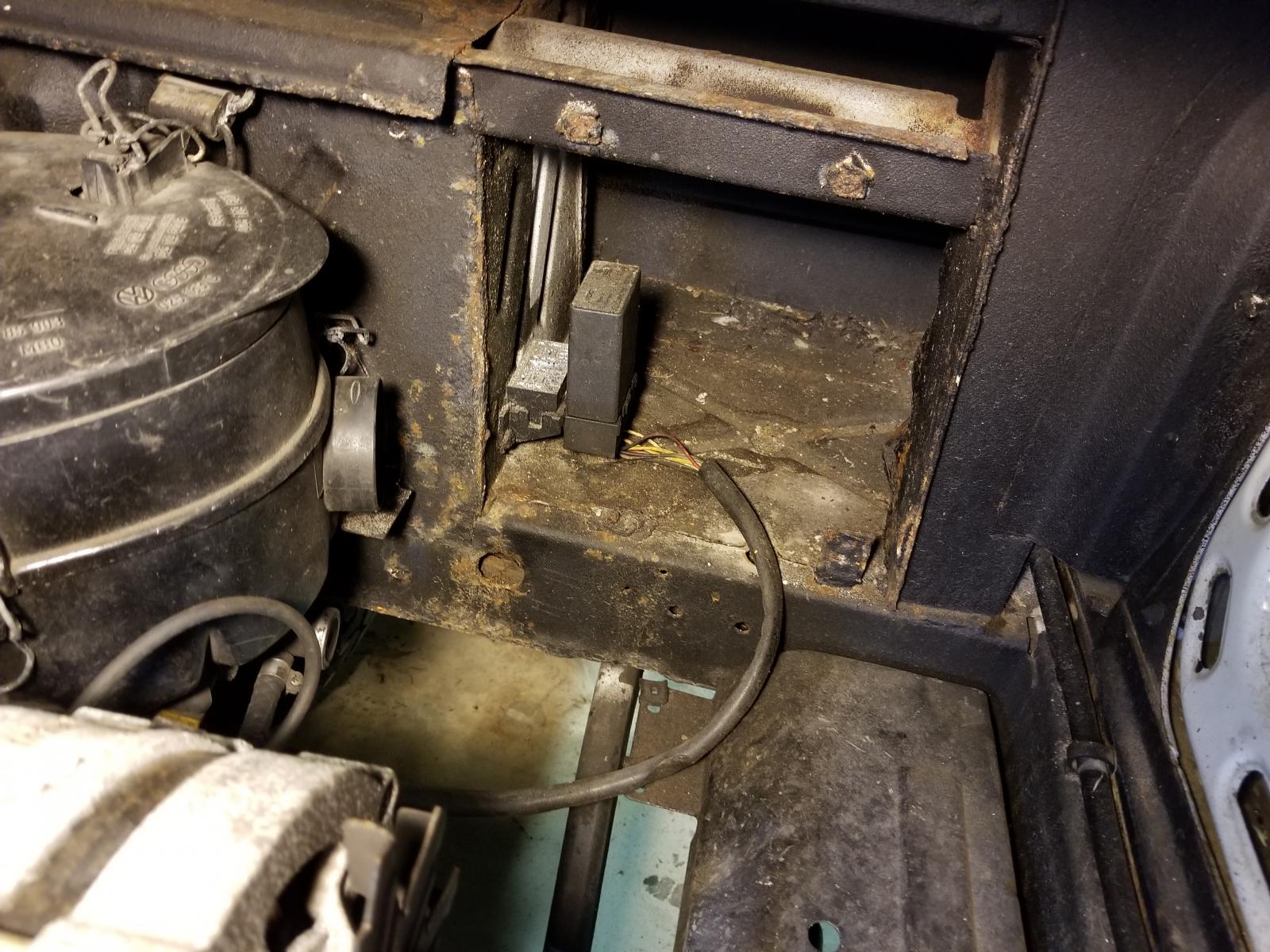

Do you have an idle control relay behind the right tailllight? My guess would be no, just because you have a cat and a O2 sensor. If you do have a ICR behind the tail light it should be either an A or C.
Only the DJ has a Digijet with out a cat and with an ICR. In the early days when these were being brought in as Imports, It was common that the importers would put a cat on them with a 02 sensor and just try and bury the wire to make it look like it was hooked up.

do you have an idle control relay behind the right tailllight? |
I do indeed, see pica pics below
16CVs wrote: |
where did this T star come from |
I bought it locally here in Seattle, happy to show it off any time. Original delivery code is northern sweden.
Detail of Relay behind the right tailight

16CVs  Samba Member
Joined: February 22, 2004 Posts: 4215 Location: Redwood City, California
Posted: Thu Jan 03, 2019 1:11 am Post subject: Re: Mysteries of the Tristar Doka, part 1: What is this engine? |
What a mess, did you notice the vacuum hose off of the Distibutor? Hard to tell where the wires from the O2 are going. I think you'll find that you only need a single wire O2 and someone added power and ground to it for some reason. As noted earlier it shouldn't even have a O2 sensor.
Someone did some witchcraft on this and you're going to have to figure it out.
Some of those grounds do not look so great, I'd dump all of those Insulated connectors and get some OE style open barrel connectors and get a proper crimp. I'd cut those things back and make sure the wire is not corroded.
