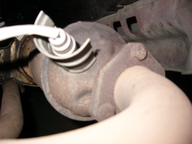

Since you said that it was happening in the rain... by any chance are you missing your Oxygen Sensor shield?
A couple of years ago, while driving on the freeway in the pouring rain on New Year's eve, I would begin to lose power until the engine would completely stall out. I would wait a minute or so and then the engine would start right back up. I could drive a short distance when the symptoms would appear all over again. It took us over 2 hours to drive 30 miles.
I finally had it towed home.
The next day with no rain, I had no problems...
I tried checking all kinds of things, but nothing proved definitive... until, I discovered that other Vangonites have had the same symptoms... the common denominator is a missing Oxygen Sensor shield in the rain.
Apparently in the heavy rain the Oxygen Sensor gets wet and the sensor sends the wrong message to the computer and then it starves the engine. It shuts down (i.e. stalls). When you turn it off, the computer resets and then you can startup the engine and make it a little while until it happens all over again (like "Vanagon Syndrome"). The VW engineers developed that shield for a good reason.
So, check for the Oxygen Sensor shield - the shield clips onto the Oxygen Sensor which is screwed into the Catalytic Converter (next to the muffler).
Here is a blurry picture of one of mine:
Hope this helps!

PostPosted: Sun Jun 26, 2011 8:08 pm    Post subject: Reply with quote
On my 84 the O2 sensor is in the exhaust pipe ahead of the cat. It does not have a shield (don't know if it ever did) but that area is so stinkin' hot it's hard to imagine it could get (& stay) wet. Still, pays to check everything.
