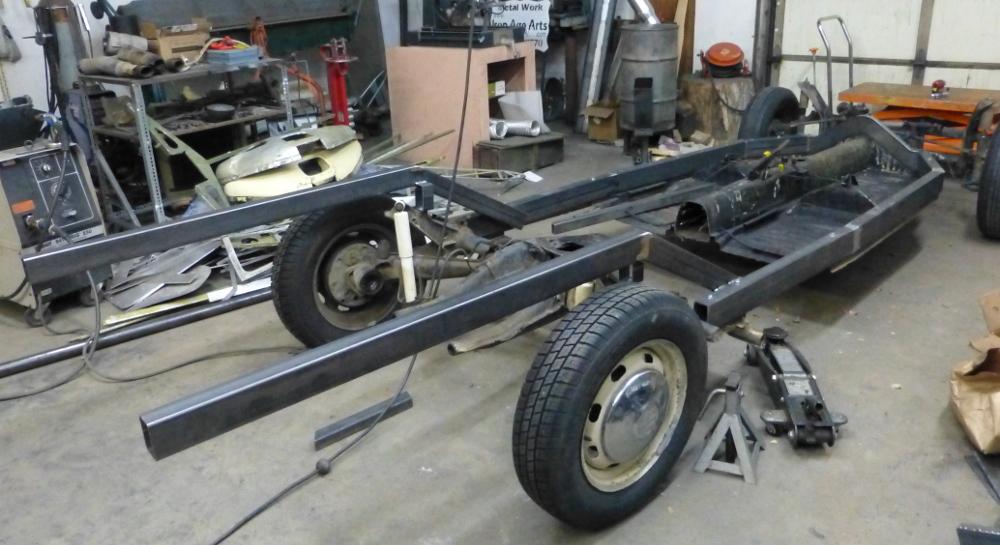

Very nice work. Looks like you constructed pretty much a full frame. How much did you extend it? Looks like at least 2 feet.

Wow, sharp eyes. In actual fact the wheelbase is 22 inches longer. Here are a few pictures, but for a more detailed account you can check out my website at https://idlehandsshop.com/
This gave the cab section a 4 inch lift. I will continue to post here to the Samba on what I did, because I see so many other great ideas and pieces of work here and would encourage anyone else to follow their whim. Or their folly as in my case. Thanks to Everett for this site.

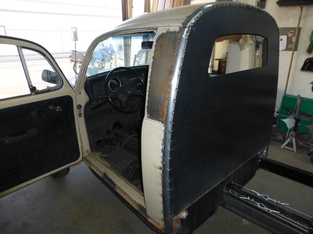

What really got me moving on this project was watching what others did to create a truck cab. Most seemed to go the route of grafting old truck cab backs and corners onto beetle front body halves. Often this included chopping the cab. I wanted plenty of room in my cab so a chop was not in the picture. I also like the nice tight fit of a VW beetle. I wanted the doors to close with that pneumatic thump, that new beetles had.
Some old time pickups had sort of a squared off back and I also liked that. I had plans to make this puppy look like it could have come from the 30s or 40s. The method I used was to make a rounded tube back corner for the cab. This made the cab back very rigid and gave me a rounded steel corner, that would be easy to finish for body work and paint. It became even more solid, when I welded a single plate of 16ga. sheet steel to the tube frame.

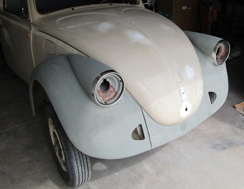

Do you have pictures showing the truck from the front and what you did with the headlights?

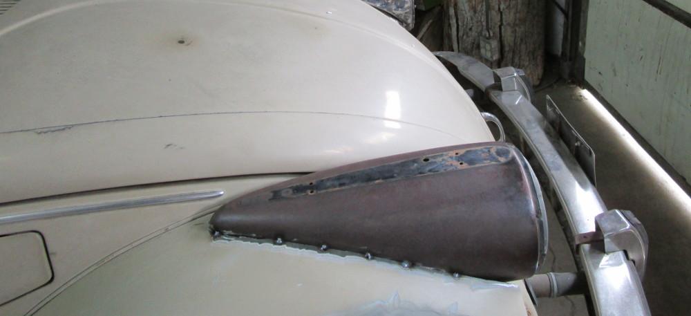

Oh yeah, we got pix. Documentation so I can remember what I did. As mentioned I wanted the look of 30s or 40s trucks. Along with the squared off cab and spoked steel wheels I figured the headlights needed to be mounted in separate buckets or in nacelles on the fenders. I grafted a pair of nacelles from a 1946 Chevy pick up onto the fenders and covered up the VW buckets. The turn signals are from VW either late 50s or early 60s with yellow LED flashy things, so they can be seen. Yellow fog lights seemed old fashioned, too. The flat faced Hella headlights seem proportioned right for the smaller front end, but I,m wondering, if I can make them LED instead of halogen.

You are getting that 2CV kind of vibe with those. And I love those cars. Very unique. Not sure I would do it myself, but its a cool look. Very very nice work. The more I look at it, the more I am digging it. Almost seems like the cab needs a folding ragtop. That would REALLY mess with peoples heads.... Laughing
