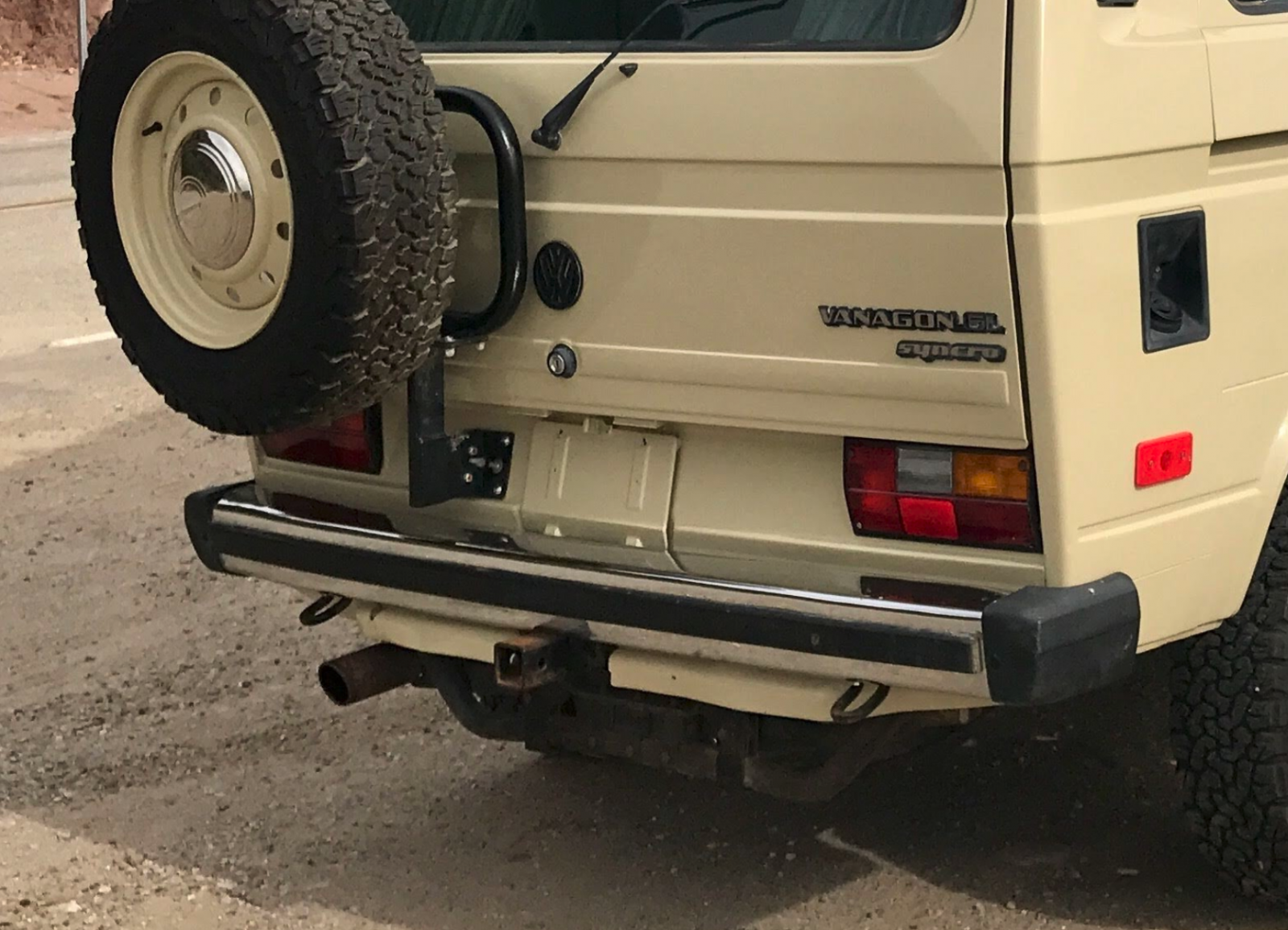

Not mine, but perhaps this photo might explain how the rear "bumper" is lacking:
How it's even called a bumper is beyond me; how that design passed crash testing is even more bizarre.

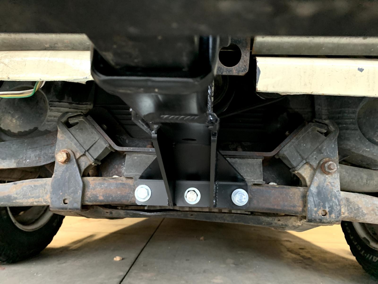

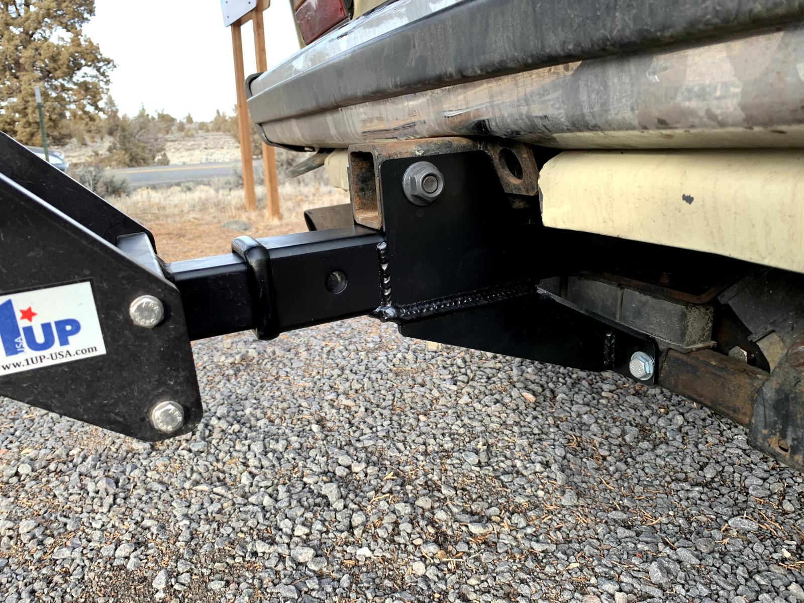

geoffraynak Samba Member
Joined: June 17, 2018 Posts: 33 Location: BEND OR
Posted: Fri Feb 22, 2019 11:49 am Post subject: Re: Bumper / trailer hitch receiver question |

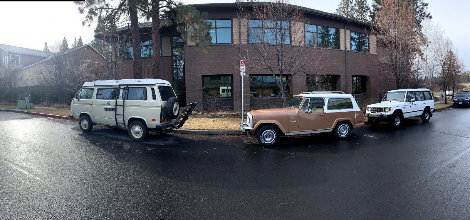

i have a 1UP rack
and a 4-pack for all our bikes (or a group shuttle)
at first it was attached via the hitch that came with the van from a P.O.:
there were three issues:
1: it was BOUNCY ... because the hitch bar is transversely long and attaches all the way out to the edge of the van's frame rails ... like a big torsion spring
2: the rack could never be brought all the way 'closed' because of the spare tire... (luckily the rack has a 'half-way' position)
3: the spare tire could not swing all the way out past the 'open' rack ... because the rack rails were too high ... i could swing the rack 'past open' and let the tire swing ... but that is a pain ... all just to open the rear hatch ....

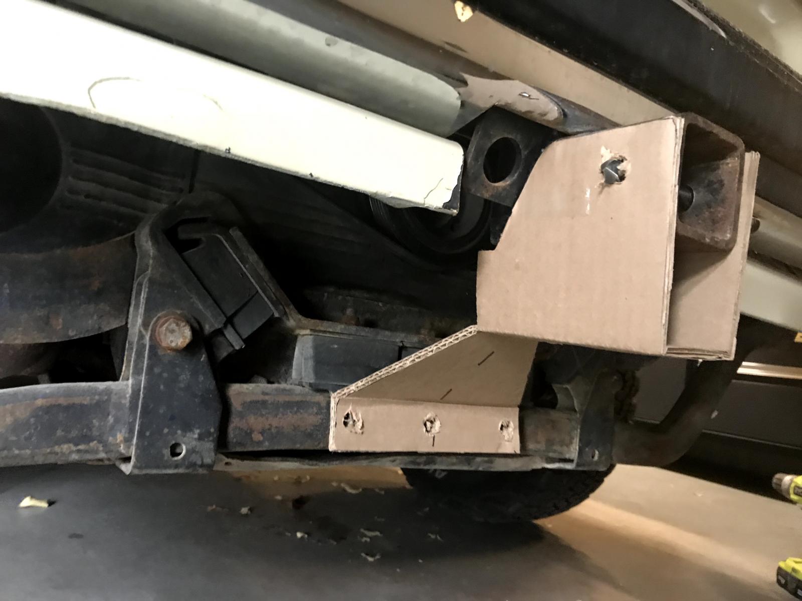

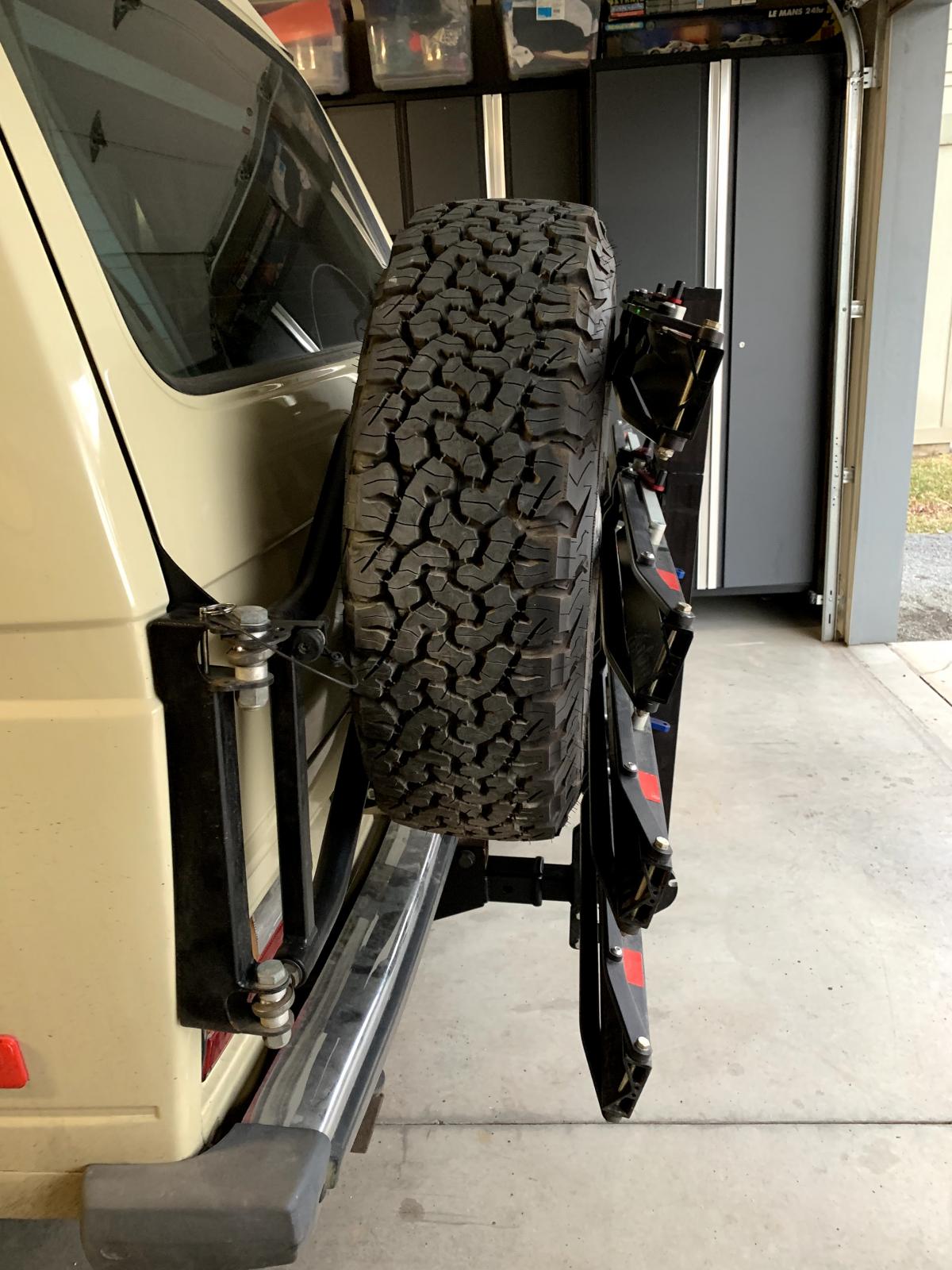

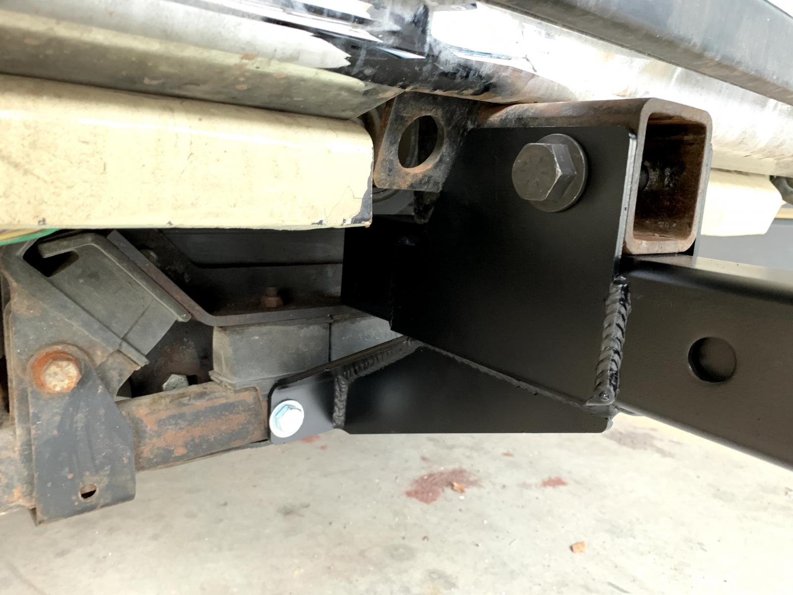

SO ... I fab'd a NEW receiver:
it bolts to the lower SVX motor mount bolts
and through the side-bolt-hole of the existing hitch
this does 3 things (to remedy the three issues):
1: it triangulates it to lower frame ... and is crazy rock solid ... more solid than any other hitch mount i've ever used
2: it pushes the new receiver aft a few inches to allow me to close the rack 100% when not in use
3: it is 2.5" lower than the previous mount ... and allow the spare tire to swing open.
win
win
win
sorry this may not answer your question exactly ... but a bit of welding and drilling ... and you may be able to make an amazing custom rack right out of the gate.
cheers
geoff
