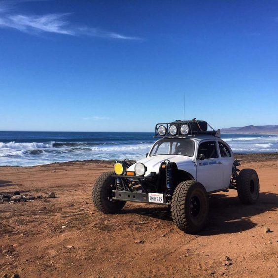

In the planning of building a Baja Bug for myself. Not sure if it even will hit a dessert, but it will for sure hit forest roads, gravel and snow on a regular basis and on top of this work as a daily driver stand-in whenever I feel for it. I have found a look I like and are looking for a decent setup to achieve this in a cost-effective way.
I have read tons of topics here and have a setup I'm considering. I need your input on how to make the most out of this for me. Welding and fabrication are not any main issues. But I try to avoid precision machining if possible and target most issues towards welding since I handle it the best. And my first option is to use as much stock components as possible before buying new parts.
Here are my engine and transmission topic. I know what to go for there already.
https://www.thesamba.com/vw/forum/viewtopic.php?t=711714
Front suspension
Will use a link pin front suspension to start with as I understand it will give me more future options. Can't decide if I should widen it 6" or 8". If possible I would like to keep the front trailing arm stock, pros and cons on that? I've read its quite common to use 2,5" extended arms. Not sure whether I should move the beam a little to the front or not, suggestions? I want more of the feeling of a modern car. The stock Beetle is around 150cm wide, a modern Volvo V70/XC60 is 180-190 cm. First I hade 6" in mind but now I'm considering 8". Would that alone be a proper change? Ofc I'll mount shocks and towers also. 8-10" seems to be a normal size. A-arms is not an option right now, its too much extra fabrication I feel compared to what I get compared to the link pin.
Rear suspension
A new trans and motor from my other topic will be mounted. Its a VW 1,9 TDI or a Subaru EJ20, haven't decided yet. I see its common to extend the IRS with 3x3, any opinion on this? I like the look of wider Baja bugs but I don't want them to go any wider than 190 cm. Perhaps 4x4 or 5x5 would fit me better. Ill also have RBGs on that will build in one direction, probably backwards.
General opinions on whats a good width for front and rear? Whats a decent axel distance? I'm considering to move the front suspension a little to the front, how much is common, and what's needed?
Other information that probably will be asked. Tires I'm looking at 29-31 roughly right now. Probably not so wide ones. 15" 4" rim in the front and 15" 6" in the back so that's what I somehow have in mind.
Some pictures of your setup and feedback regarding it would be fantastic!
This is my intended style:

Most of the pictures you are showing are of Baja Bugs used in the South West and Mexico where there is very little rain.
Not knowing where you are from driving without fenders covering the tires could be an issue. Some place even require mud flaps.
I don't know what your budget is, or your skill set for building a Baja like you want.
Expect to spend at least $10,000 and up to get what you are showing in the pictures. I seen Baja Bugs that had more than $50,000 in them.
Look at DustyMojave threads and pictures of his Baja and you can see what he has done with a modest budget.

I got plenty of rain and snow in Scandinavia so it might end up looking more like the TDI Baja. I understand it will cost a bit and that's fine. I'm a mechanical engineer and grew up on a farm. It will not be my first build.
My issue is that I don't know the setup on those pictures. I need to see some setups where someone can tell me what they used, then I can final my measurements. So far I know 6x6 is way too big for me.
For instance, it would be great to see pictures of a 3x3 baja, a 4x4 and a 5x5 or any other combinations and know their total width. Also a 6", 7" or 8" front beam with different arms.
