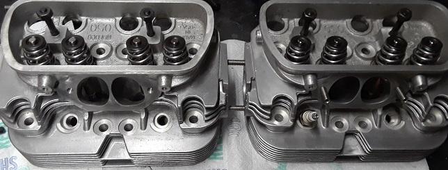

The Mofo's
See anything weird? So I guess im gonna be using thread sealant with the cylinder tin screws? No, I just put a set screw inside.
The feeling is like when you buy a loaf of bread, and when you get home you see that someone opened up the package with a box cutter that sliced through your bread.

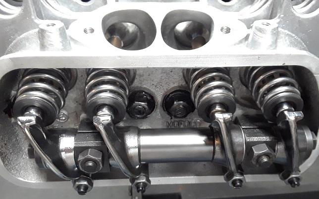

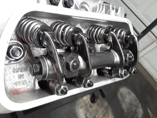

The CB rockers were same model that died early in my buddies car, so as a precaution I did some home grown heat treat and polished them up before they went to sleep in my closet:
Might as well clean up the whole thing. Yes I have issues
Lash caps and chromoly pushrod ends polished to match:
All installed:
Rockers all set up. No shims needed.

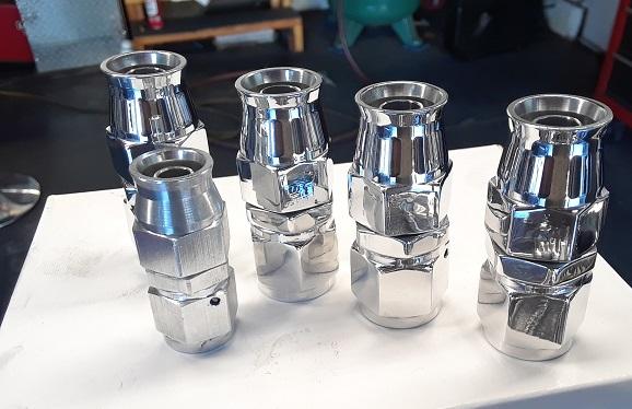

Lets talk fittings.
Ever seen one of these? its a 37 degree fitting surfacing tool:
See anything interesting here?
Oh, your gonna need these too:
So the fitting clean up ok:
Quick Polish on the buffer:
And do these too, notice inset one is not done to show how they come:

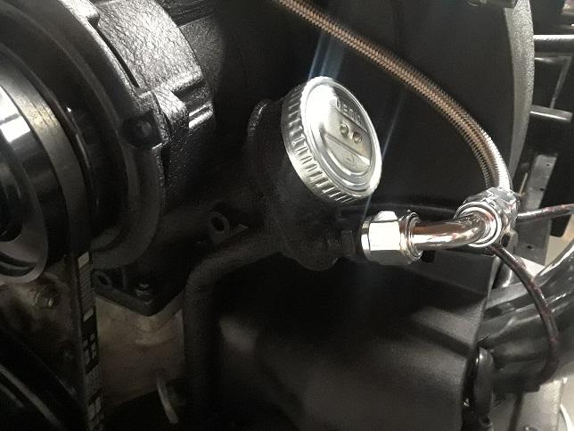

Breather to each carb top:
Welded a fitting to breather filler, and ran hose off of it:

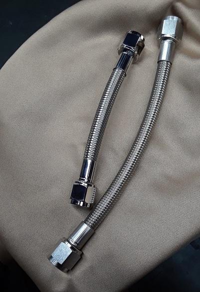

Full Flow hoses are too important to mess up, so I had those made:

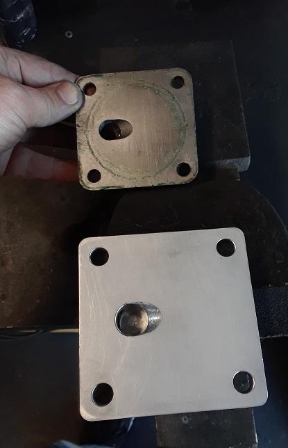

The Empi Cast iron cover had to be tightened down till it almost cracks before the dang thing seals, so I yanked it off in favor of a billet aluminum cover. I like the full length raised area of this cover. And check out the flanged titanium nuts, they have a 17.8 diameter flange that is PERFECT as it actually centers the oil pump cover! The largest flange on any other 13mm is 17.2mm.
Check out the backside of this she-devil:
Ok, so I added some curve for better flow, matching the cast iron angle:
installed now:

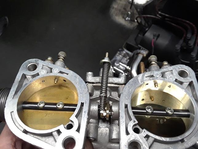

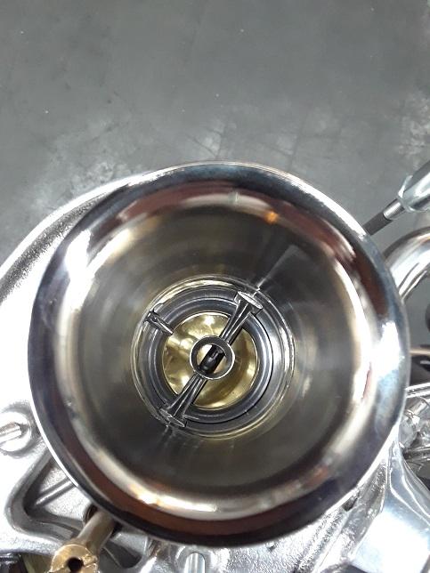

Lets talk Carbs:
This looks like it can benefit from some love:
So a little effort cleans it up:
From top of stack to butterfly is smooth for nice flow:

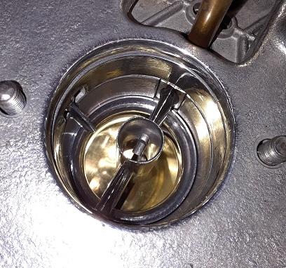

Even the accelerator jets yes:
And the venturies:
these too:
Done and not done, a lil difference might help some:

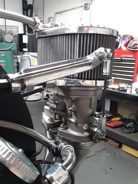

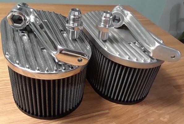

No sense on using towers to mount the linkage high, so I chopped and re-profiled:
Cleaned up the arms and carb tops too:
installed and added some stainless choke covers:

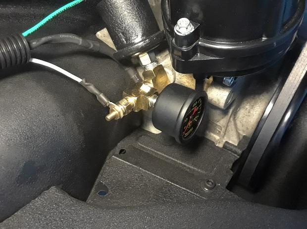

Little detail, use 2 of the brass tee's and it can all fit nicely. Oil Pressure sender, Oil temp sender, and a Mechanical Gauge:

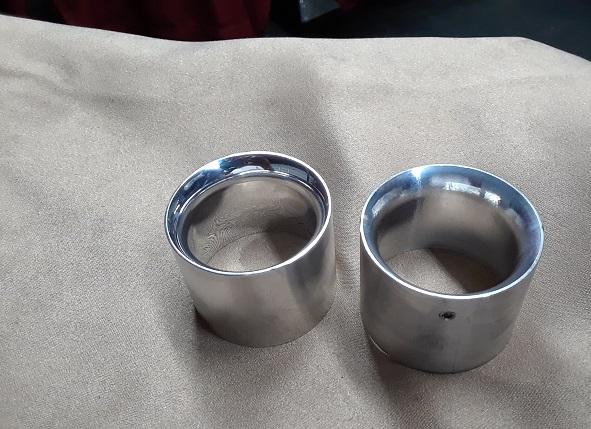

1-5/8 header, 3 bolt 1/2 inch thick flange, and made a custom dual exhaust using single chambered stainless muffler and 90's:
Welded together with stainless fluxcore wire:
And all together:
in case u wanna see what the inside of these look like:

jpaull wrote:
Lets talk Carbs:
Aux vents upside down
Looks great tho

PostPosted: Fri Mar 29, 2019 1:34 am    Post subject: Re: Unusual Sweep the Floor 2234 (With Dyno Video) Reply with quote
Good Catch Glen! I will flip it over

2. What is that 37 degree tool? It is obvious those an fitting are not all created equal.
