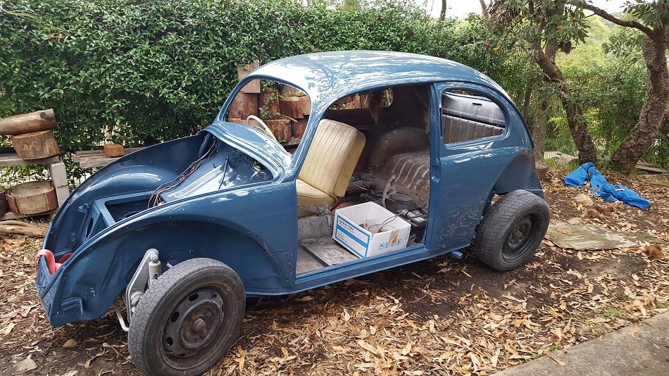

I bought this Oval in November 2018, I found it in a driveway abut 10 ks from my house, I used to see it under a tarp but then the tarp blew of so I saw it was an Oval. I just got it back from the panel beater, very pleased with how it turned out.
I was not sure what colour to paint it, but I went with a US colour Capri Blue. So I will get it back on the road some nice wheels and a little bit lower
It had already been modified a little,
1600 single port motor
later synchro trans
adjustable front beam with caster shims
KMac front sway bar
4 stud Beetle front disc brakes and Type 3 rear drums

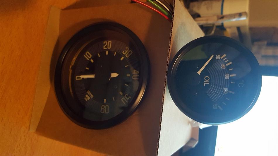

the dash has holes in for gauges, a tacho and fuel gauge, I bought some Smiths gauges to fill in the holes.

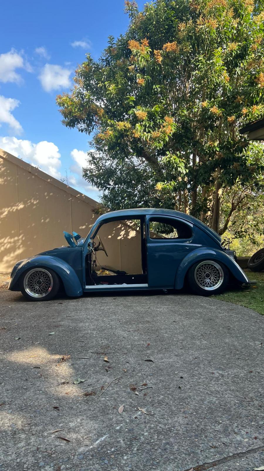

Hi
I'm going for a 4 inch narrowed beam from Skinned Knuckles in Melbourne Australia, it will also be an air beam as well using modified lower trailing arms and air shocks, going bags on the rear. With a narrowed beam I can wider wheels on the front and still have some dish on the wheel

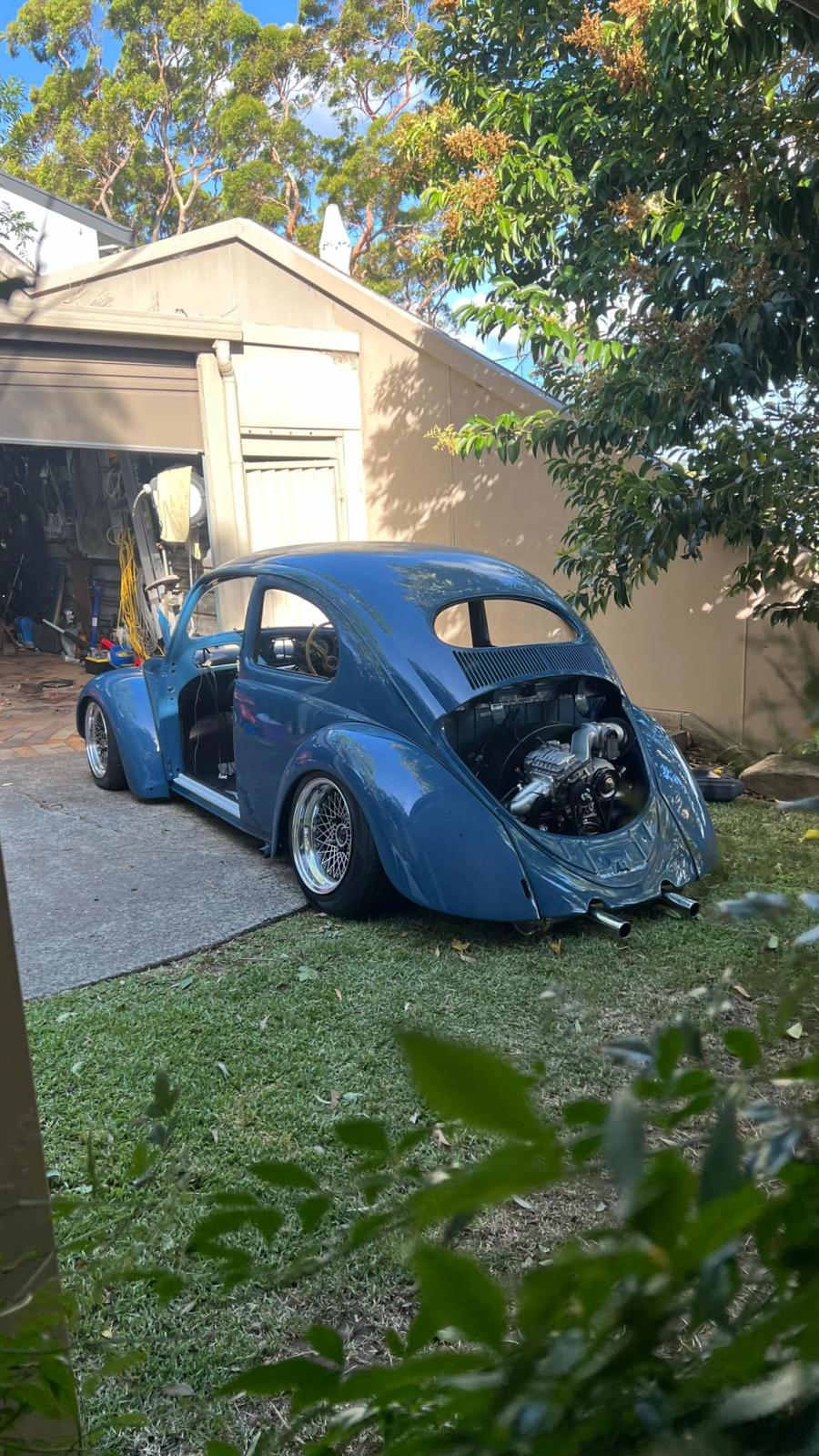

Hi
I retired last year so I’ve been spending a bit of time on my Oval.
Its now running a 1916 with a SC12 supercharger, Haltech Nexus2 ecu and drive by wire and a Flex fuel sensor to run E85.
Its running a 4-inch narrowed beam with Monroe air shocks and bags on the back

Thanks Dave. I'm taking it to Summernats on the 1st January. The heat is on.
Just fitted glass and lights today

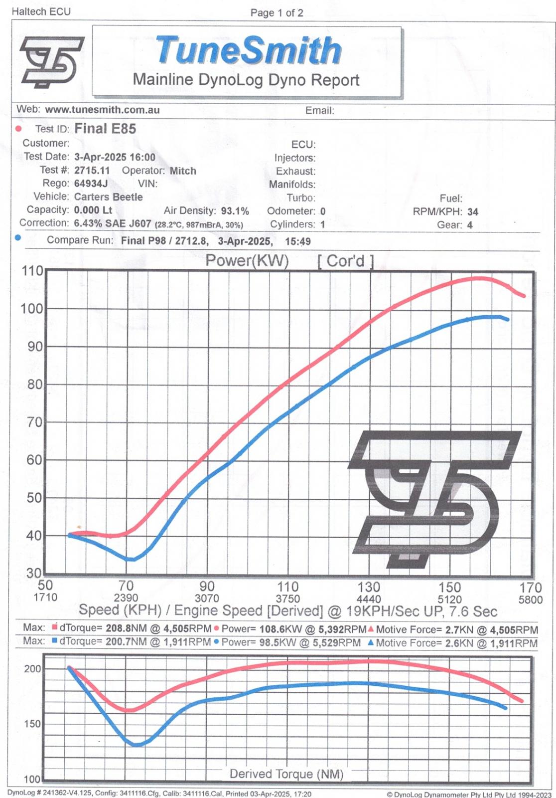

I had the Oval tuned the other day on a dyno.
Engine specifications
1916. Stock heads 110 Engle cam (not ideal for a supercharged) and 1.25 rockers, Vintage speed exhaust. 4 LS coils, Dubshop crankangle sensor and CB cam position sensor. Haltech Nexus 2 ecu. 485cc injectors with a 5th injector before the supercharger and drive by wire.
SC12 supercharger with custom pulleys.
Best 98 RON run was 98.5 kW or 132 kW at 5550 rpm and 80% throttle.
We then swapped to E85 and did a few power runs but a gasket leak at the inlet manifold prevented anymore power runs, but it still made 108kW or 145.6 hp at the wheels on 90% throttle.
The best thing about the drive by wire is that the throttle can be used to limit boost. The drive by wire is also used as a rev limiter, it rolls the throttle off near redline before a fuel cut

PostPosted: Mon Apr 07, 2025 9:27 pm    Post subject: Re: down under 56 Oval Reply with quote
Dyno chart
