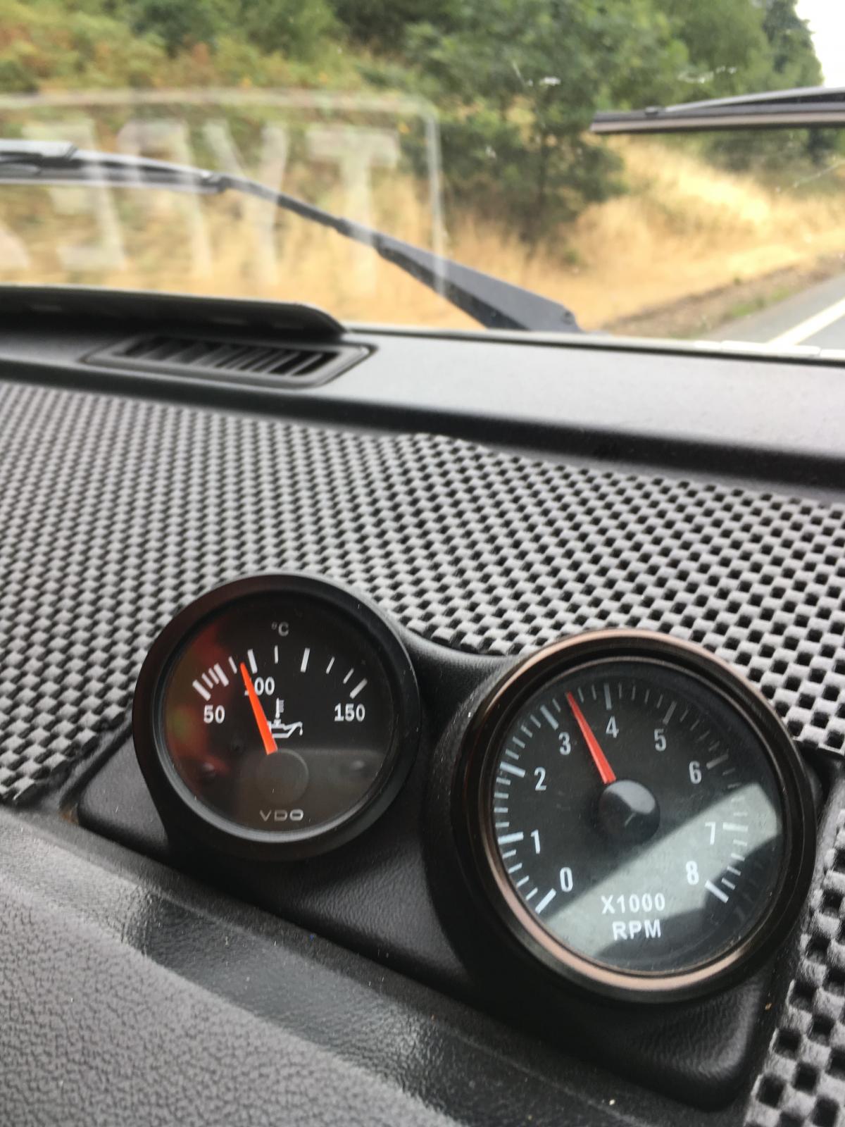

Brickwerks sell these nice pods LHD & RHD for early vans needing rev counters or for any other 52mm gauge for that matter.
Wire up to front from coil neg -
