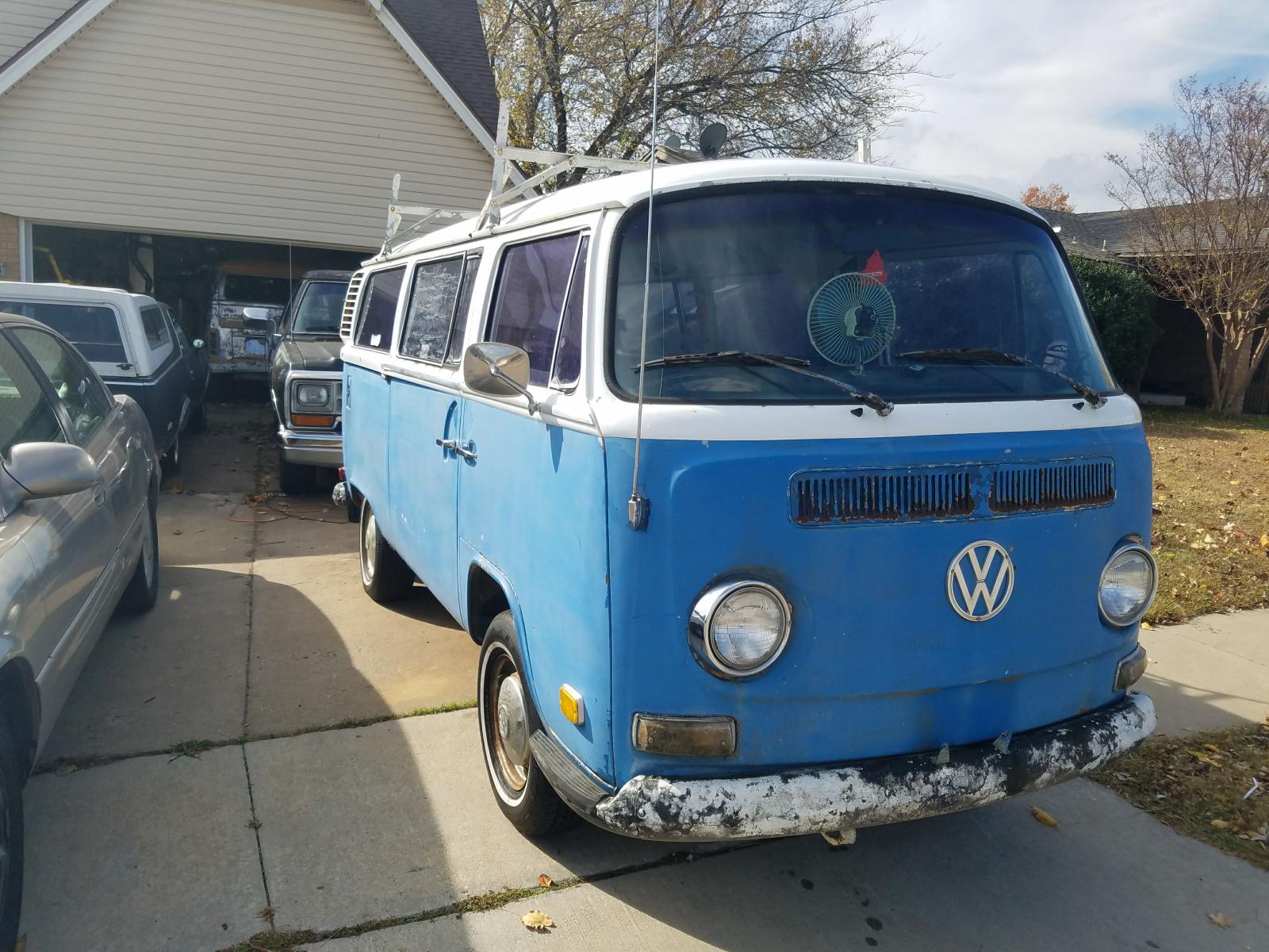

So we acquired a wonderful VW Bus last November 2017. Traded our 20 ft Procraft Fish/Ski Boat to a wonderful couple. Well we are finally getting around to being able to start bringing this bus back to Life!!
Sunshine is a 1972 VW Transporter Custom Deluxe 9 Seater from the factory. The Second owner used the bus to travel a lot so converted the interior to a home made camper. We are the 4th Owner. Still have the middle full bench in Practically New Shape as it was removed early in the buses life has ash tray built in to rear for third row seating. Will probably sell it, As well as the current camper interior to a fellow VW enthusiast as it is in great usable condition could use some stain though, We would love to do that for the purpose knowing the furniture will be continued to be used. As it is a solid and comfortable interior, Just not for multiple people sleeping inside... I am preparing for Travelling in my VW Bus with my girlfriend and our dog so the single bed interior that is currently in it is unsuitable.We have a 72 Westfalia weekender interior to switch over to minus the Icebox/Sink combo, so if you know of one id be very Grateful Smile.

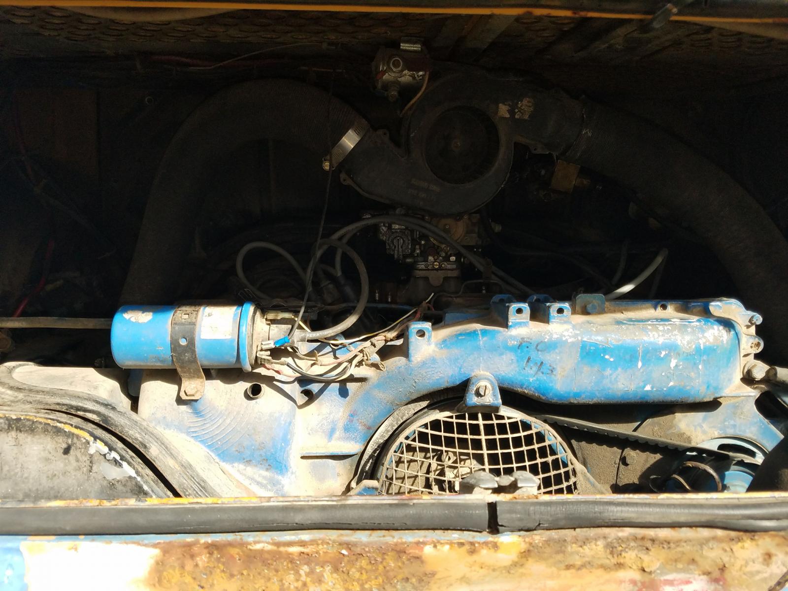

We have not decided Between the Dual Weber ICTs,
Dual Weber 40 IDF, or the Dual stock replacement Solex 34s. as i do not want to continue on with the Progressive Weber Carburetor setup. they cause the type 4 motor to run lean from my understanding? again correct me if i'm wrong as we are new to the Vw World, and run hot. both of which are very deadly to an air cooled engine.
We need this bus to be able to pull Our 1974 Starcraft Kingfisher aluminum 14 ft Boat to the lake Smile the hull empty weighs 350 lbs and that is without the motor that weighs an additional 200 lbs the overall weight of the boat loaded Estimated to be around 700 lbs max loaded with all fishing gear and everything. and again that is More than we'd probably ever carry. Need to find a suitable Hitch with a 2 inch ball to pull The little red boat, as well as find a Tow bar for Sunshine for if we ever broke down or whatever that could stow in the roof rack.
So Samba Community lay it on us. let us know what we should and should not use, and why? Smile

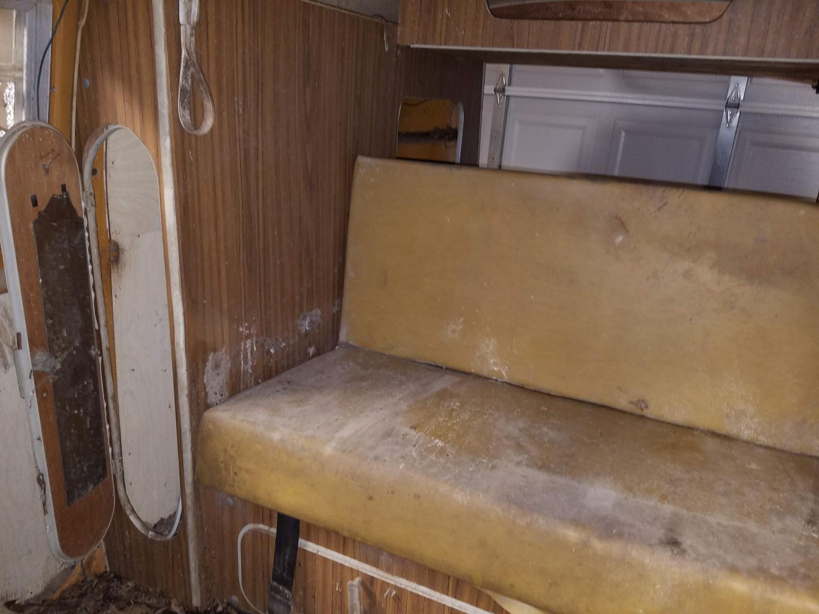

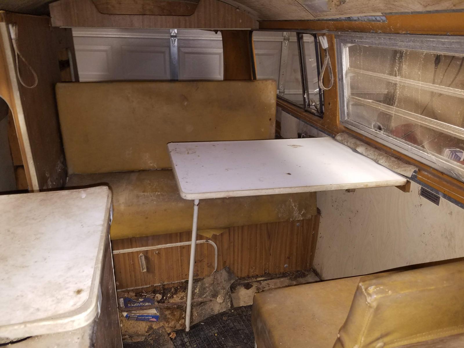

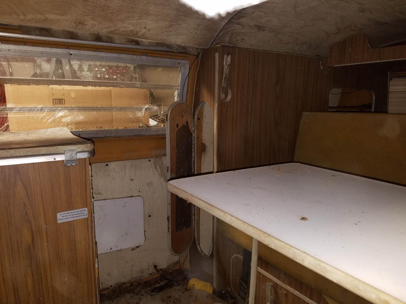

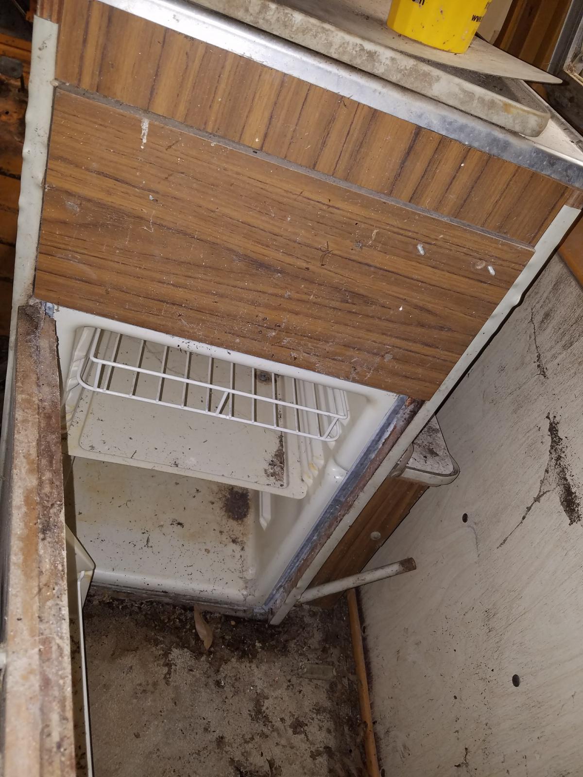

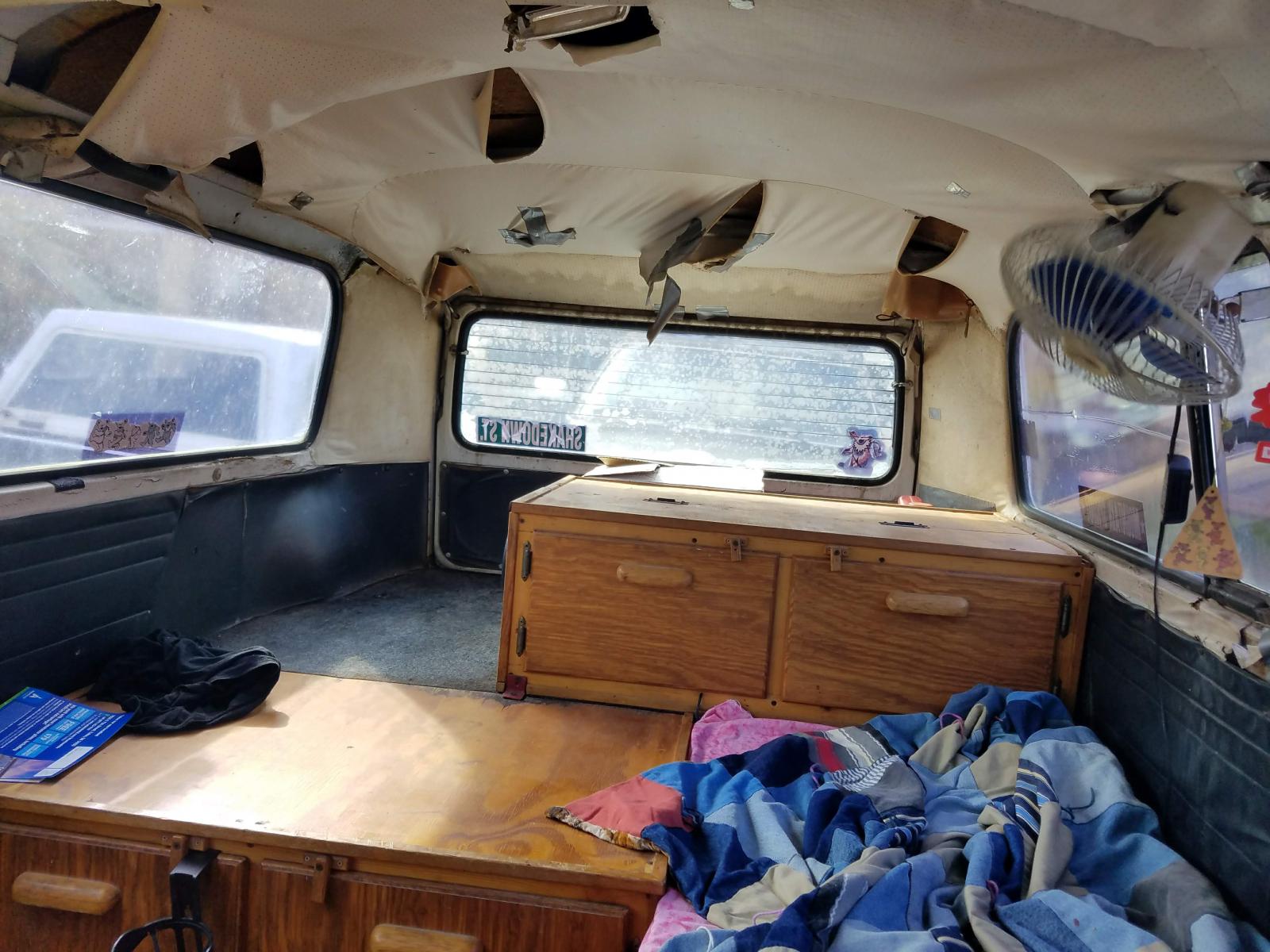

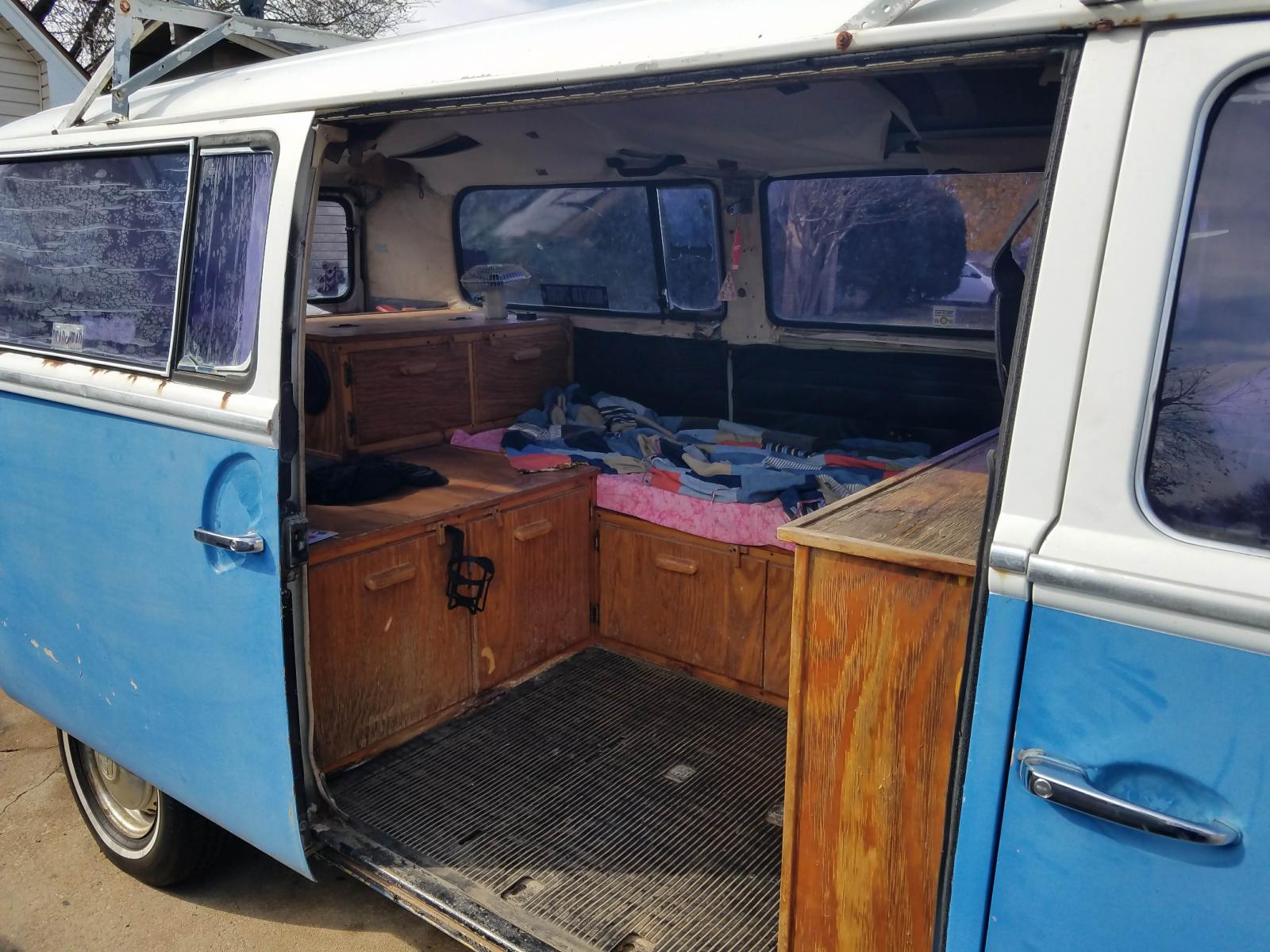

Here is the interior of the westfalia weekender I got ahold of! A buddy of mine got an old westy and wanted to go a different route with his build, Thankfully I was able to keep this interior in decent enough shape to transfer over once my bus is ready, But as stated earlier I am still searching for a Icebox Mini fridge/Sink combo for behind the passenger seat as the one in the pics was trashed by mice and wasps and water rot and wasn't able to be saved. Also need the rear cushion for the bed. If you can point me in the right direction in the classifieds or wherever to acquire some of these things I am looking for would be very gracious !!
busdaddy
Joined: February 12, 2004
Posts: 52672
busdaddy is offline
PostPosted: Tue Apr 16, 2019 6:25 pm    Post subject: Re: 1972 Vw BayWindow/ Sunshine :) Reply with quote
Welcome!
Not a bad looking bus, lots of potential if that blue paint isn't hiding big mud pies.
You'll likely want to gut that thing to evict the mice and other critters, some of those interior panels look pretty good, consider passing them on to an OG parts fanatic opposed to just throwing them out.
Sink/icebox units show up in the classifieds now and then, prepare to pay handsomely for a nice one. I hope you kept the old one for patterns, a local cabinet maker rebuilding it may be your best option.
Since it sounds like you are going custom anyways keep in mind that sink/icebox is a pain in the nuts when opening the door and getting in or out, many leave it out and use a portable cooler that can be moved easily (yet secured when travelling) in it's place.
The cushion foam can be found at any foam or upholstery shop, the vinyl is available from a few vendors, but cloth is much more comfortable to sleep on and far quieter.
Any type 4 can be converted to FI, you'll have to add a return nipple to your fuel tank (looks like it has to come out anyways), and a bracket from a later donor bus to support the air cleaner/AFM unit. If you lack advanced mechanical skills the FI is a better choice, anyone who can use a volt meter, fuel pressure gauge and read can fix it.
No doubt you have already found the FAQ's at the top of this forums index page, all sorts of stuff about tires, fuel lines and oil strainer nuts you need to know there.

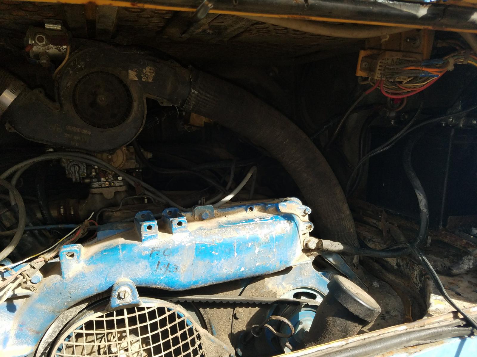

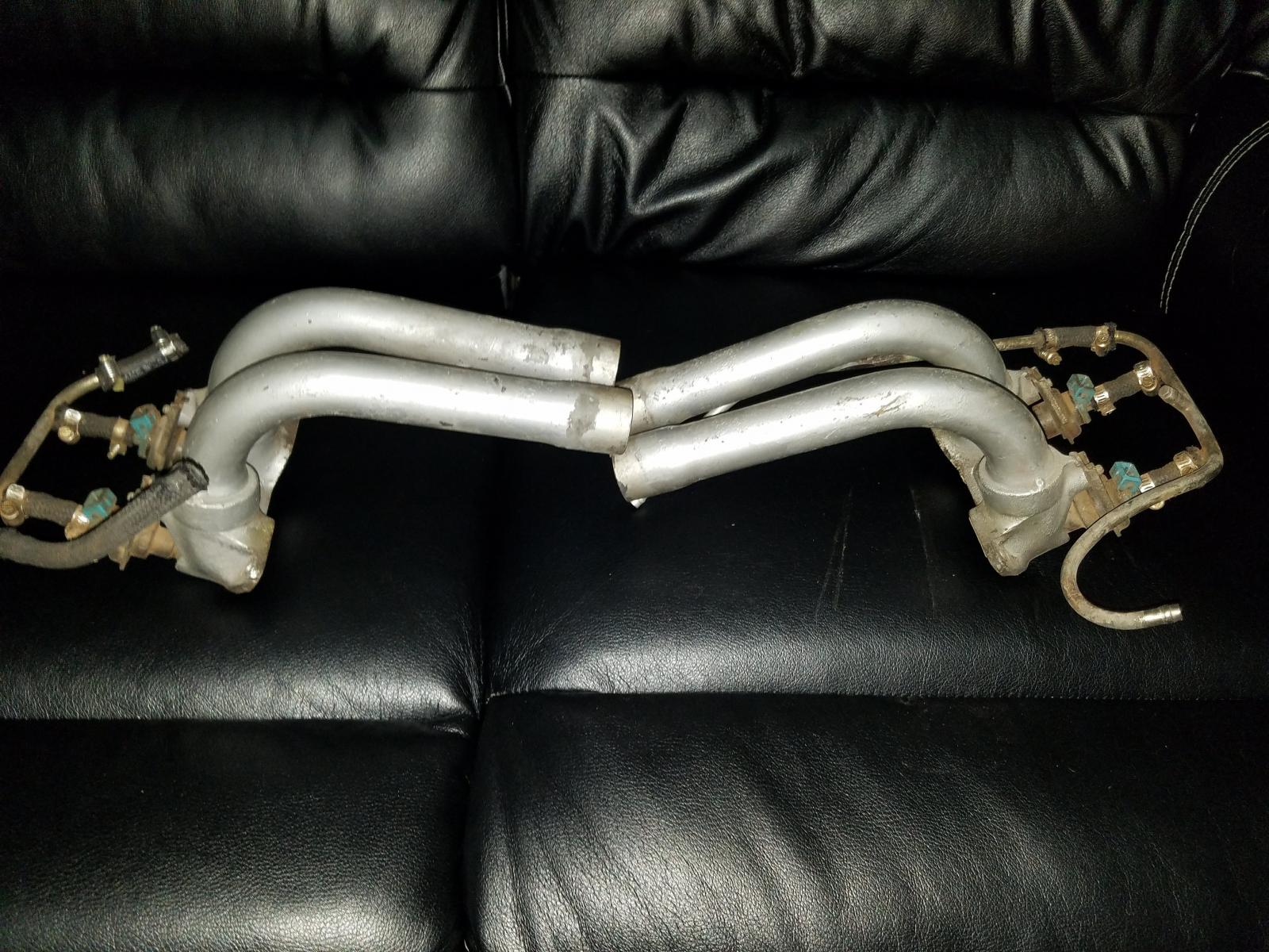

Here is the current fuel injection parts We have for the L jetronic system.
Intake runners, 4 injectors, and a cold start valve

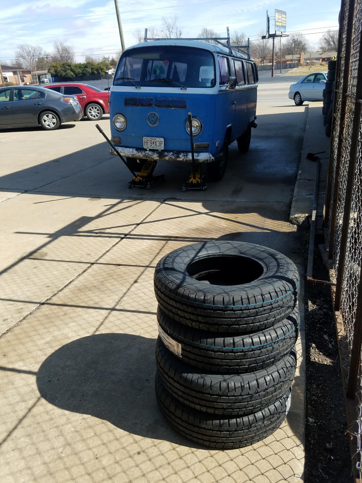

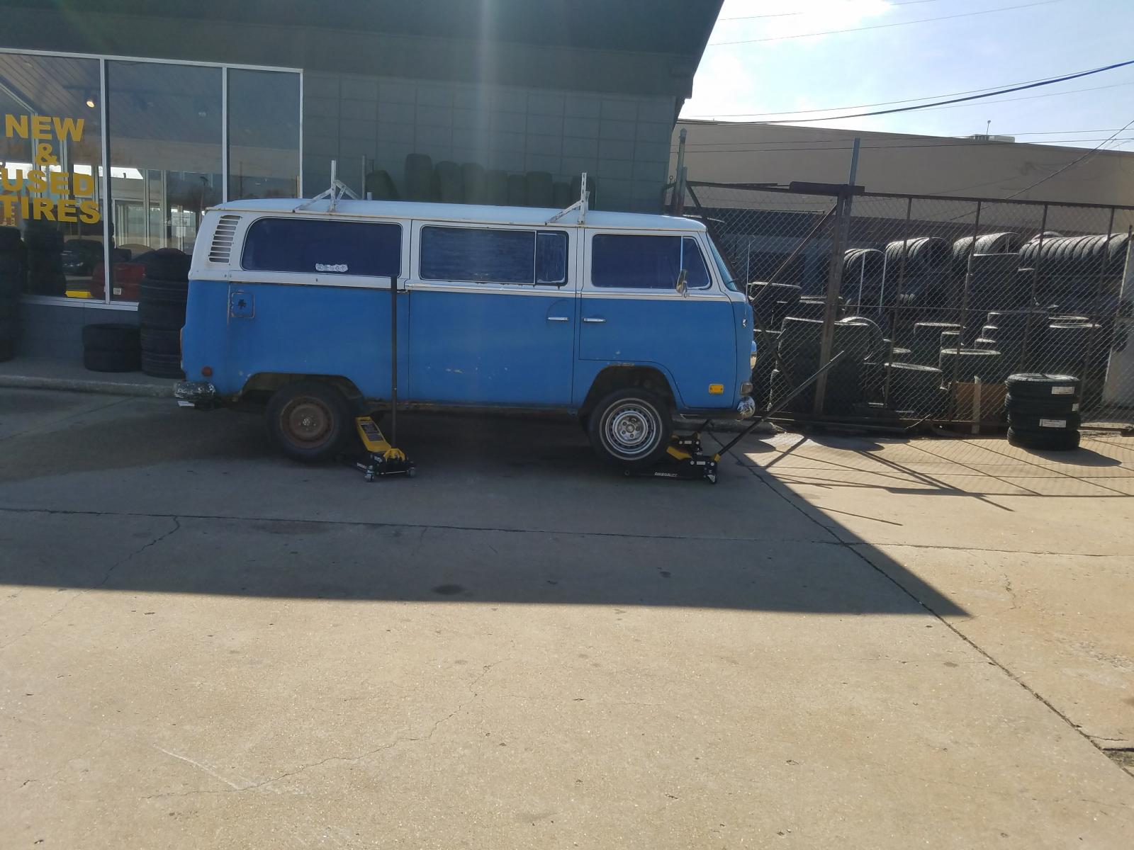

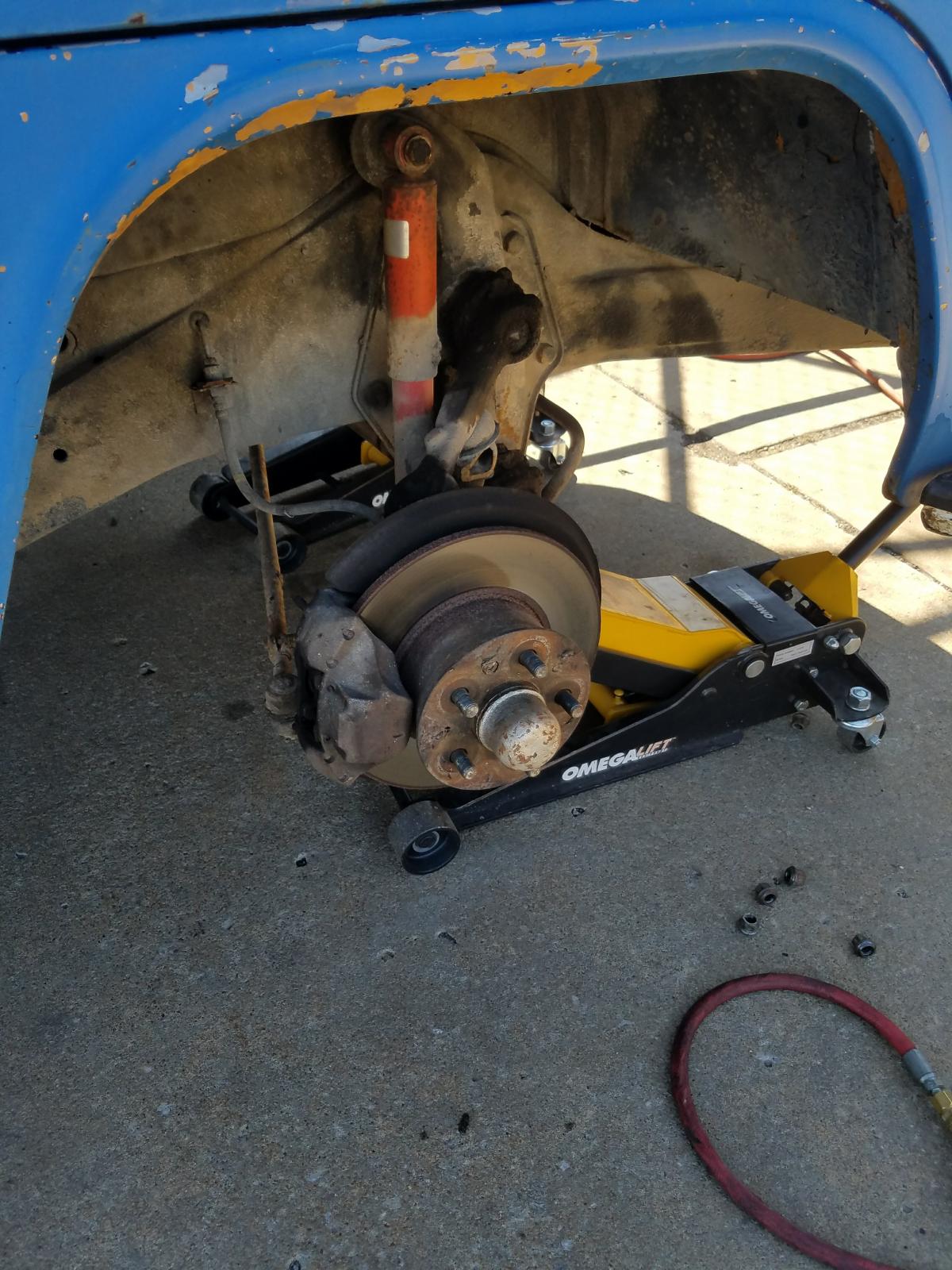

When we discovered Disc brakes up front upon getting new tires Hankook Vantra 205/75/14. The Factory rated tire for the bus was the R08 from Hankook these are discontinued and "new ones" are actually old production just not actually used yet. So the rubber is not as soft as a "brand new" tire, R18s from Hankook stock recommendation for the vanagon are still in production today so that's the choice we went with!
And after the Tires were put on check it out! Tires made a huge difference in the Ride Stability,Here's what Sunshine looked like with new tires.

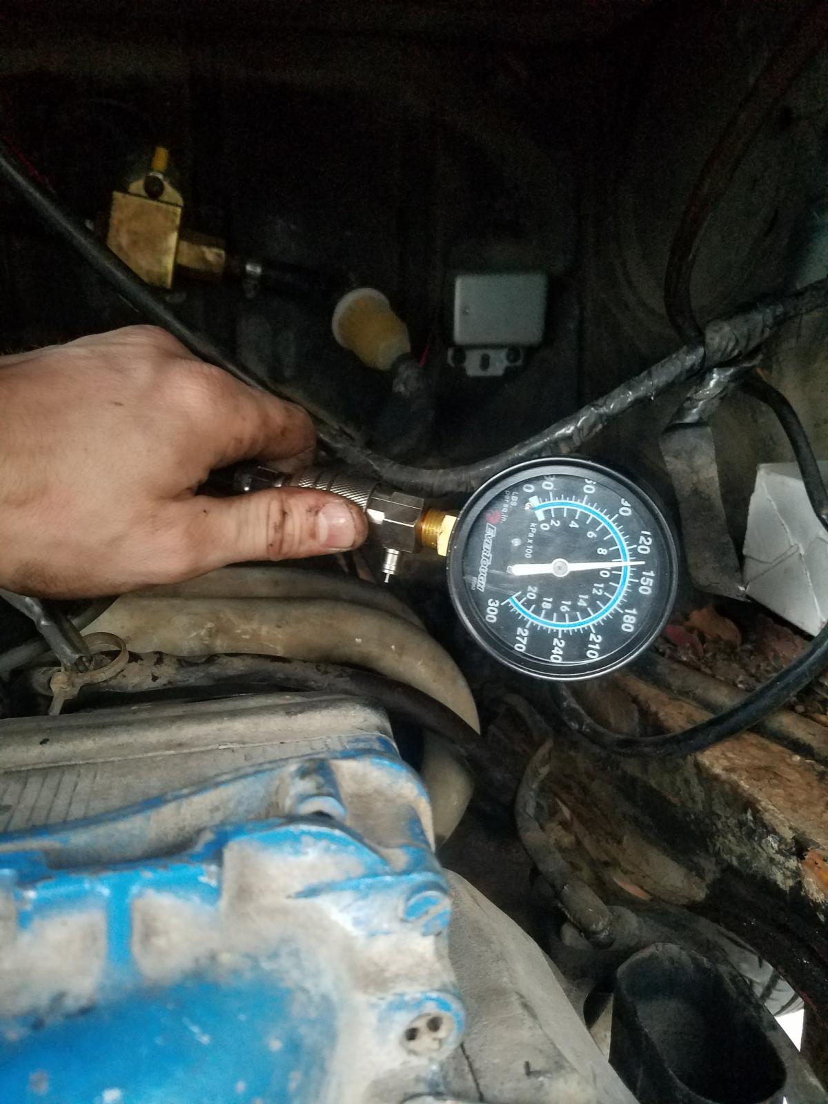

Did a compression Test results were

PostPosted: Tue Apr 16, 2019 7:07 pm    Post subject: Re: 1972 Vw BayWindow/ Sunshine :) Reply with quote
Greatful Bus wrote:
here is the current fuel injection parts i have for the L jetronic system.
Intake runners, 4 injectors, and a cold start valve.
Sorry to be the bearer of bad news.
But there are lots more parts needed for a running FI...
https://www.thesamba.com/vw/forum/viewtopic.php?t=670338&highlight=fuel+injection+list

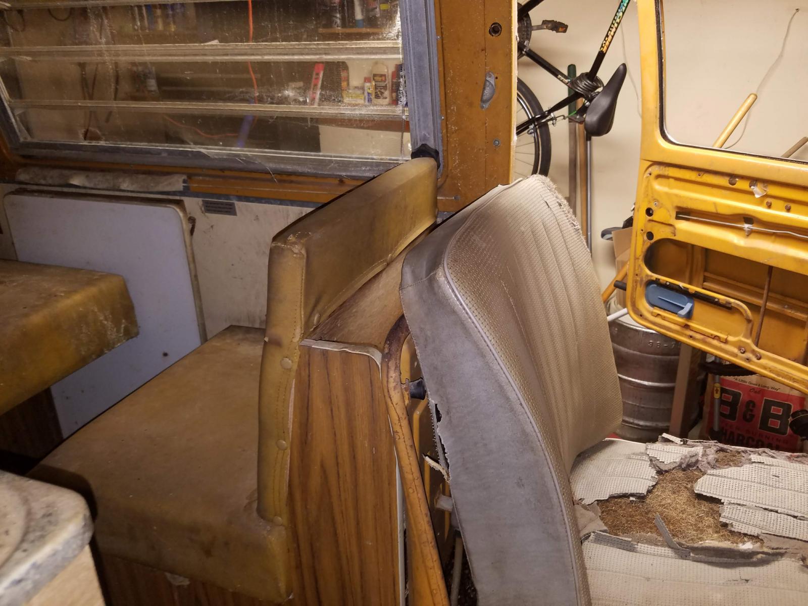

As for the plans on the build, We are going to use the interior from a Westfalia Weekender as pictured above. I have been able to save every piece except the sink cabinet was planning on converting the icebox in it to a dc/ac powered fridge if i can find a potential quality candidate. Might even keep it original if found in good enough shape, and have a separate dometic fridge and use the built in Ice box under the sink for drink storage while the fridge will be for food. The interior inside Sunshine currently is that homemade wood cabinet interior with a single memory foam bed that we will be restaining, and posting up in the classifieds one day probably soon. Especially if someone is interested in it! can get more pics up to just ask!, in the meantime we're waiting for my pc to allow me to upload the pictures of my engine internals. Just wait!! They are horrific. IDK how it ran the way it did. Guess engines want to be driven right? lol Smile

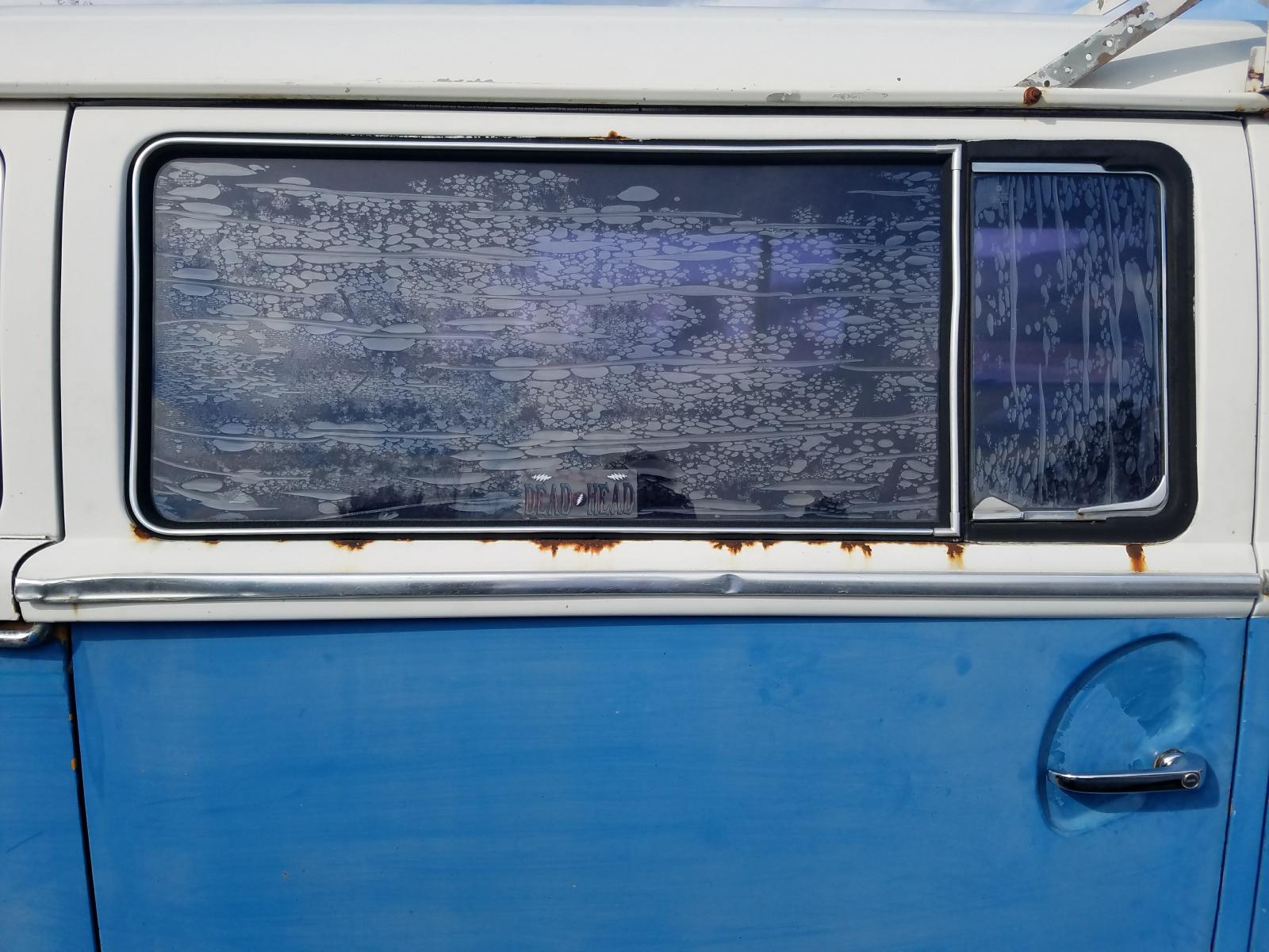

Also here's a good question, if you had the option of using any VW bus window for your center windows, would you choose the
Jalouse
Sliders
Or wing windows?
and why? serious question as we are looking for the best option for being in the Bus quite frequently and don't want to cause rust problems, or ventilation issues. Leaning towards louvered jalousie windows, But we know they dont hold in heat as well... they are better for the rain correct? are wing windows the best of both worlds? or are sliders the way to go? haha

PostPosted: Wed Apr 17, 2019 4:05 am    Post subject: Re: 1972 Vw BayWindow/ Sunshine :) Keep on Truckin' , Greatful Bus Reply with quote
Jalosie best for rain. Scour the classifieds To find some.

alman72
Joined: October 09, 2014
Posts: 2575
Location: MICHIGAN
alman72 is offline
PostPosted: Wed Apr 17, 2019 1:09 pm    Post subject: Re: 1972 Vw BayWindow/ Sunshine :) Keep on Truckin' , Grateful Bus Reply with quote
that chrome trim around the windows is a bugger when you put all new seals around all your bus. Unless the PO did it, you are going to have to do it. Others on here have the knowledge to do it with the trim, but it is just easier to put on new seals that don't have the trim.
I don't know if you can reuse your all your old chrome, but I believe I have read that the new stuff is just chromed plastic that does not wear very well
an option that I have been considering is a slider on the slider door, and joilisies on the back side. The joulsie that is on the slider now makes a horrible racket and flops around when I shut the door (you know about the door trick, yes?) slide it gently until it clicks mostly shut, then lift the lever door handle and it sucks the door the rest of the way closed!)
there is a also a trick to your westy bed, but if a PO did not know it, the tooth that grabs for easy fold down is prob broken)

I've found that the Truckfridge TF49 fits in place of the icebox very well.
nice efficient unit. though I for one am not a fan of the icebox at the sliding door location anyways.. ice box turned 90* behind the driver seat and jumpseat by the sliding door (if at all) is a much more functional layout.
Could you point me to some picture examples? as id like to make good use of the table for myself and company for when raining or weather isn't the best.

just don't pop the bed from the donor bus up and down. it is designed to lift up the seat and auto lock, to enable you to then pull the seat toward you folding everything down. When you used your big ol foot to lift it up u should have clicked and locked. Most people don't know how these were designed to work, and manhandle them around, bending and breaking the little tabs that make it easy to fold down. long story short, find and read up on it.
That is a very good point!! thank you for bringing that to my attention. is there anywhere with a demonstration of how the bed should properly work?
Vw For Life!! 1972 T2 Custom Deluxe/ Westfalia Weekender Conversion
https://www.thesamba.com/vw/forum/viewtopic.php?p=9052832#9052832
busdaddy
Posts: 52672
busdaddy is offline
PostPosted: Wed Apr 17, 2019 4:15 pm    Post subject: Re: 1972 Vw BayWindow/ Sunshine :) Keep on Truckin' , Grateful Bus Reply with quote
https://www.thesamba.com/vw/archives/manuals/aug72westy.php
Lift the bottom section until you hear a click, then pull it forward. To stow lift until it clicks and push it down and back.
