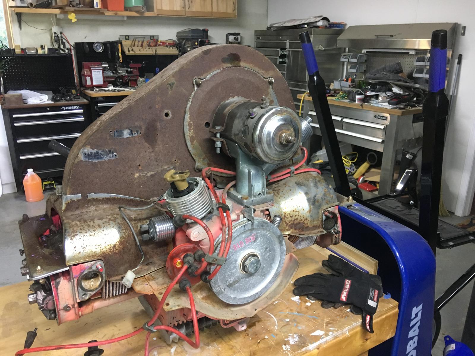

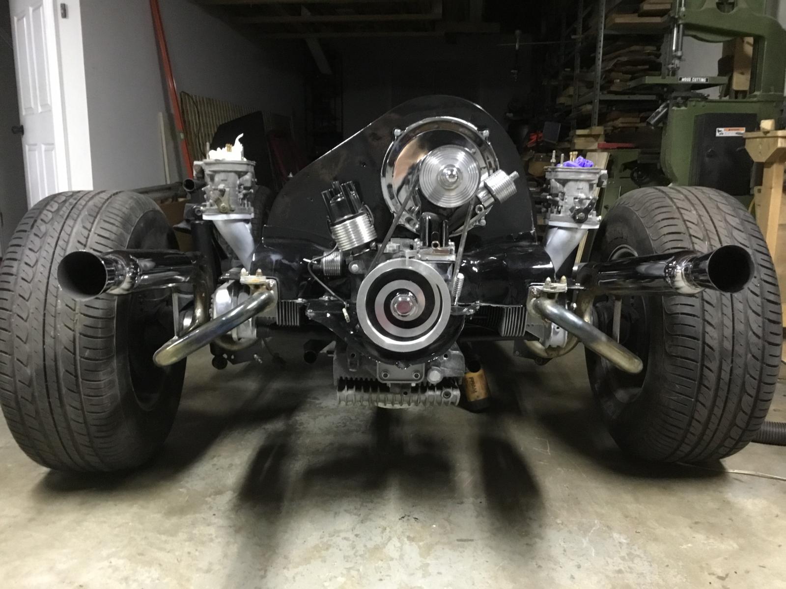

Some progress. Sorry that they are not in build order. Been working on it a lot since may. I decided to mount the engine back in. Still need to finish assembling the carbs and sort out some things, but it is off the floor.
Before as I removed it from the car.
Before taming the rust gremlin.
As it is sitting now. I Have the brake lines in and received the direct mount reservoir. I hope to bleed brakes this weekend.
MrGoodtunes
Joined: May 14, 2012
Posts: 1013
Location: South Florida
MrGoodtunes is offline
PostPosted: Fri Sep 20, 2019 9:37 am    Post subject: Re: Bad Bug Reply with quote
Major clean-up, top'd off with that mezmerising spiral paint job on the crank pulley. Nice!
